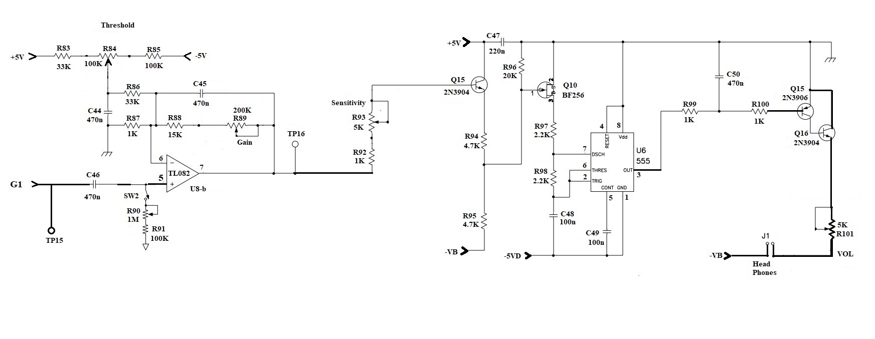

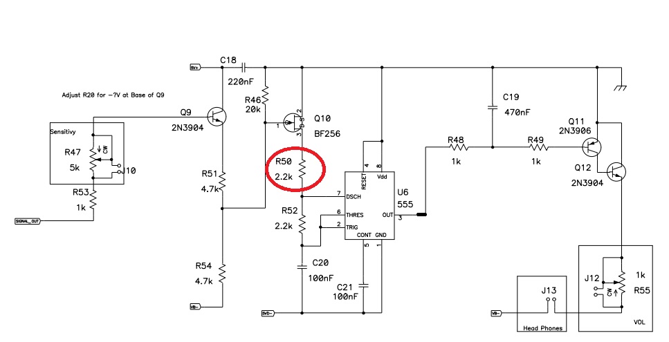

    Please see the attached, it's your Audio Part. I want to change your audio to pitch ... pitch (general pulse induction Audio, exactly like VCO in HH1).
    Do you think i can reach it if i remove R50, or it doesn't need any change?

      If you remove R50 then the 555 will not oscillate.
      Build that circuit and give it a try.

        My mean is direct connection R52 to Q10 and removing R50.

          That should change the Frequency the 555 oscillates at. It may or may not work the way you wish. Build the circuit and try.
          Also Web search 555 circuits, there is a tons of them, to learn how a 555 works. Go through the calculations of different resistance for R5/Q10 and see if the 55 oscillates at the frequency you wish.
          In the HH circuit the JFET, Q10 acts as a variable resistor which changes the total resistance (in series with R50).
