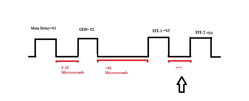

                            • Hello
                              Dear Walter.
                              Please see the attached, can you guide me time delay between S3 (EFE-1) and S4 (EFE-2), shown by arrow? I think it should be 5-25 microsecond, is it true?
                              Thanks.
                                Hello
                                Dear Walter.
                                Thanks.
                                [ATTACH]55243[/ATTACH]
                                Correct. Should be the same as delay between S1 & S2.
