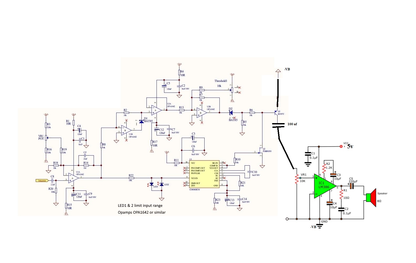

          Please forgive me for my questions. I want to add LM386 to Mickstv's Audio. Is it possible to see attached, do you think C and E of Q1 is true?!
          • Q1 connections do not look corret.
            That is a PNP bipolar so Base pulls current down through emitter (+E to -B) to product emitter to collector current.
            Also, you have it open collector so no DC collector current.
            In Mickstv's circuit R12 should be to a Voltage more positive than the Q1's base.
            Go back and wire per Mickstv's schematic. Place a 50-100 Ohm ressitor from Volume1 pot to Q1 emitter. Then connect the 100uF cap to emitter of Q1.
            Like I and others keep telling you, prototype the circuit to see and learn.

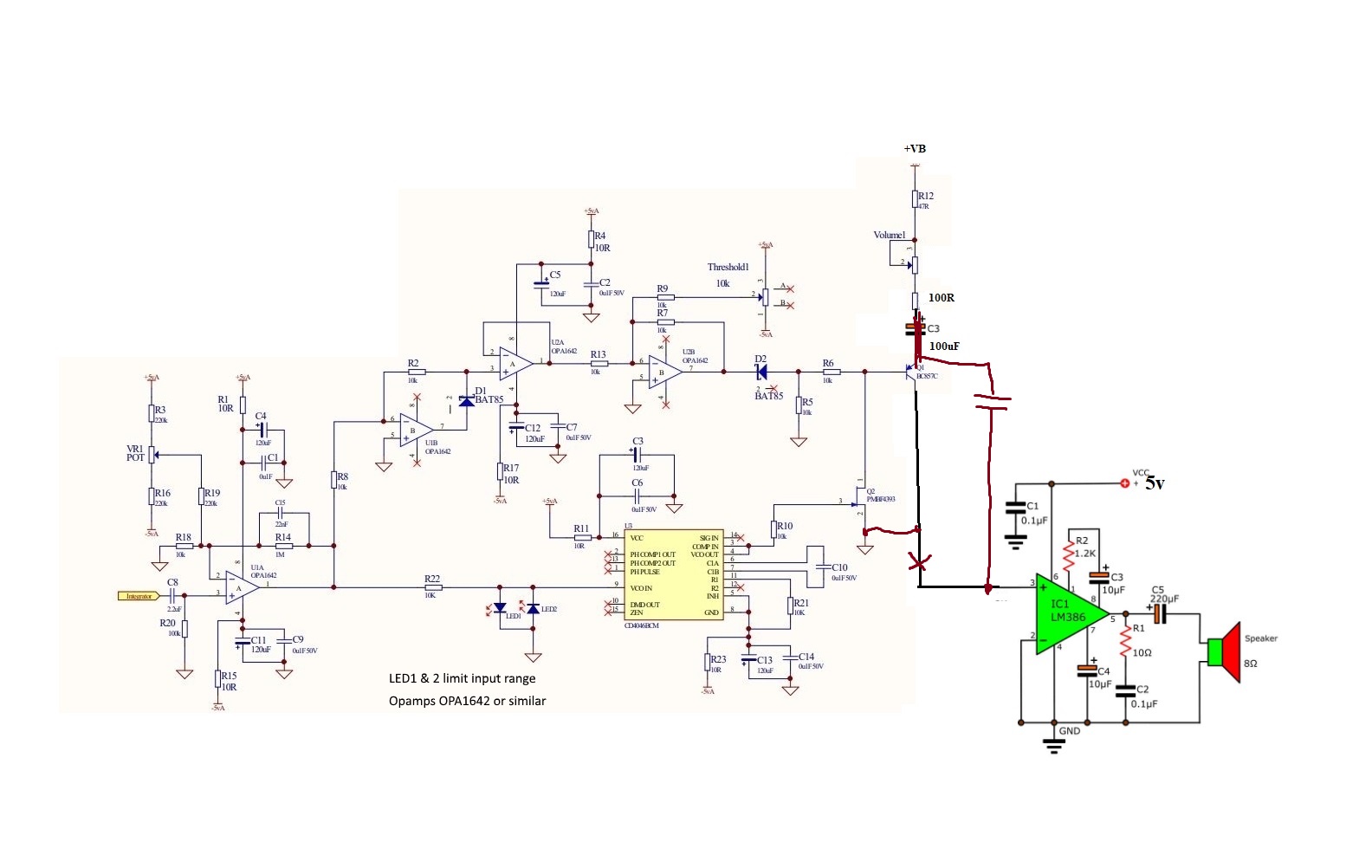

              Very Thanks for your tip. I again drawn based on your explanation, i hope i understood correctly. Is it true?

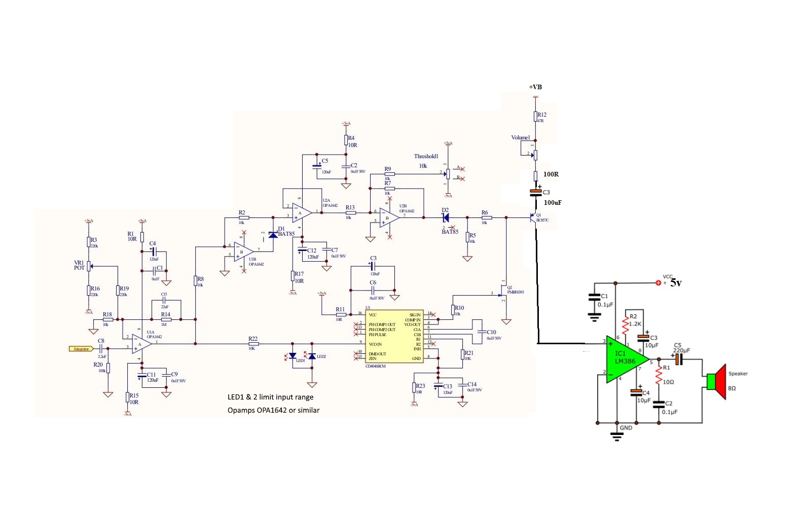

                No. Like this.Click image for larger version

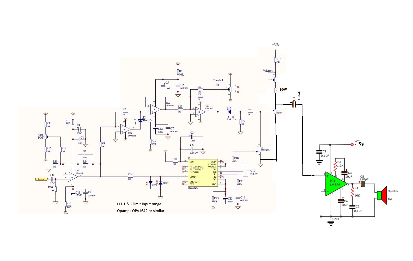

                  Is + and - of the 100uF true?
                  Should R12 be connected to +VB or + 5V?

                    I would use VB+ and connect cap as you have in schematic.
                    Ideally, one would use a non-polarized electrolytic cap.

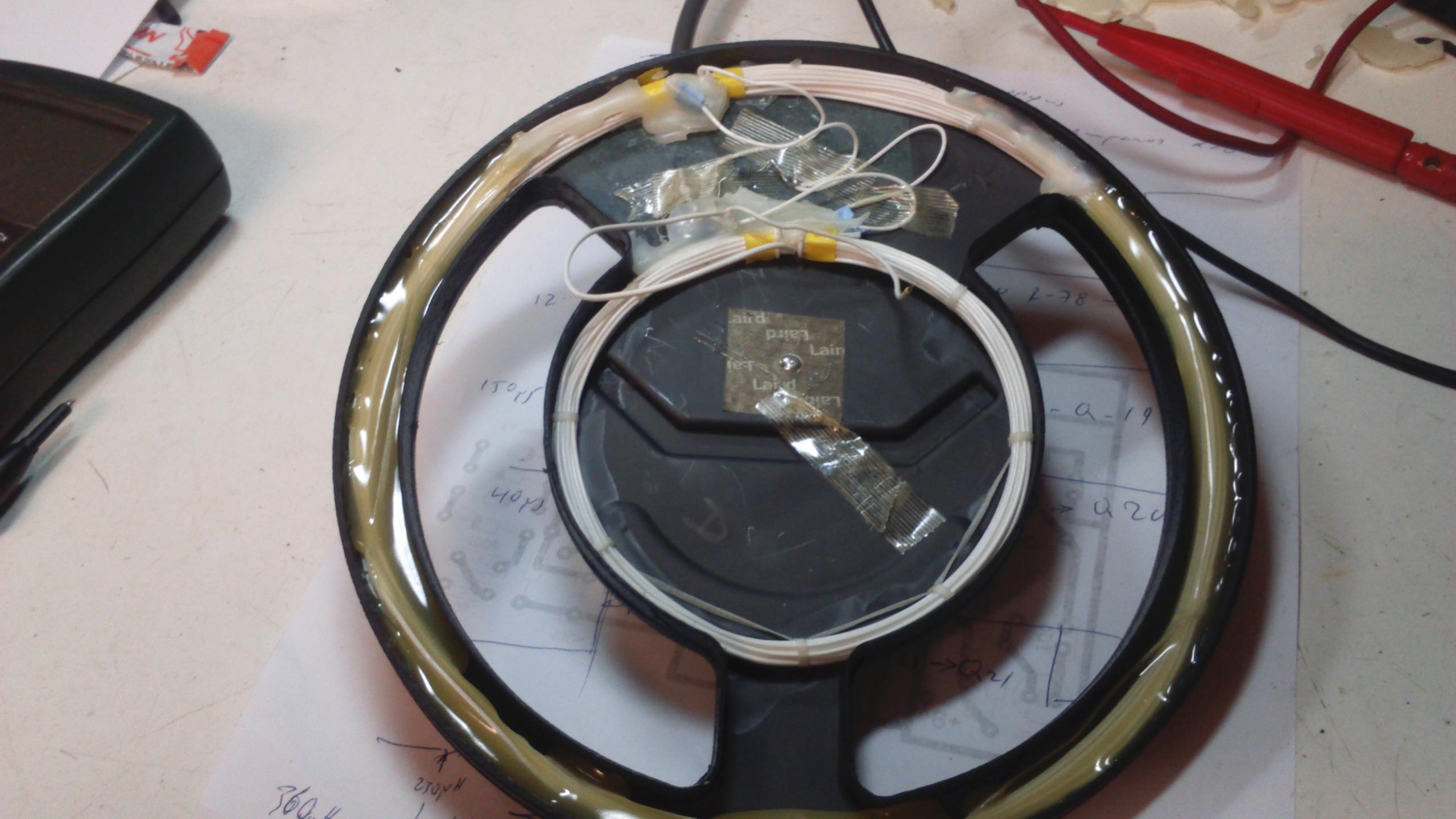

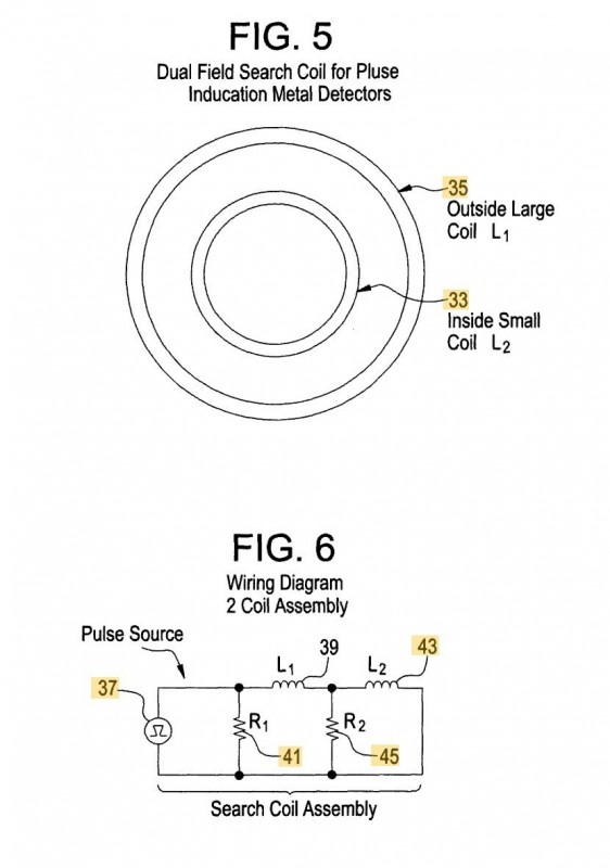

                      I had a experience with TDI with GPX coil and DF coil. My result shows that DF coil is able to detect more depth with high sensitivity.
                      I attached a schematic of DF coil and a pic from TDI DF coil (it belongs to Mr. Geo). Have you ever tested DF coil with your schematic?
                      I the schematic, R1 is damping resistor R2 is for internal coil for avoiding oscillation (White DF coil uses 4.7K). Actually, DF coil is mono just the two coils are serialized together.

                          I made a dual field coil for use on my Crossbow Classic which is a variation of the Hammerhead. I did a video on my Youtube channel of the construction.
