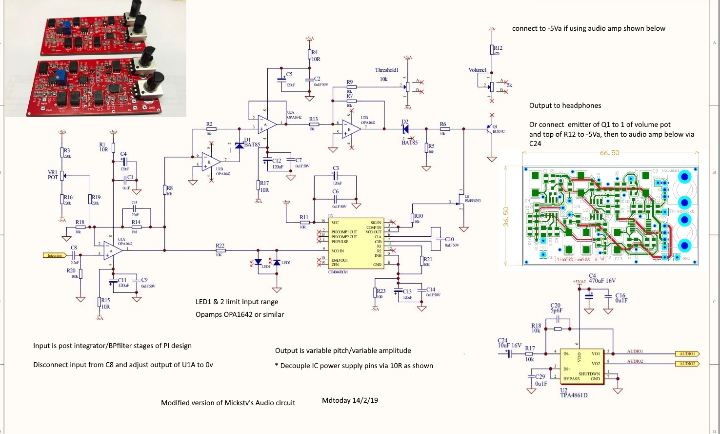

            I dug through my archives and found this:Click image for larger version

            This is the one I played with. Mickstv is a user here on Geotech who posted this. Search for original thread about this VCO.
            Other wise you simply need to build and experiment (well you need to do that anyway).

                I dug through my archives and found this:[ATTACH]55062[/ATTACH]

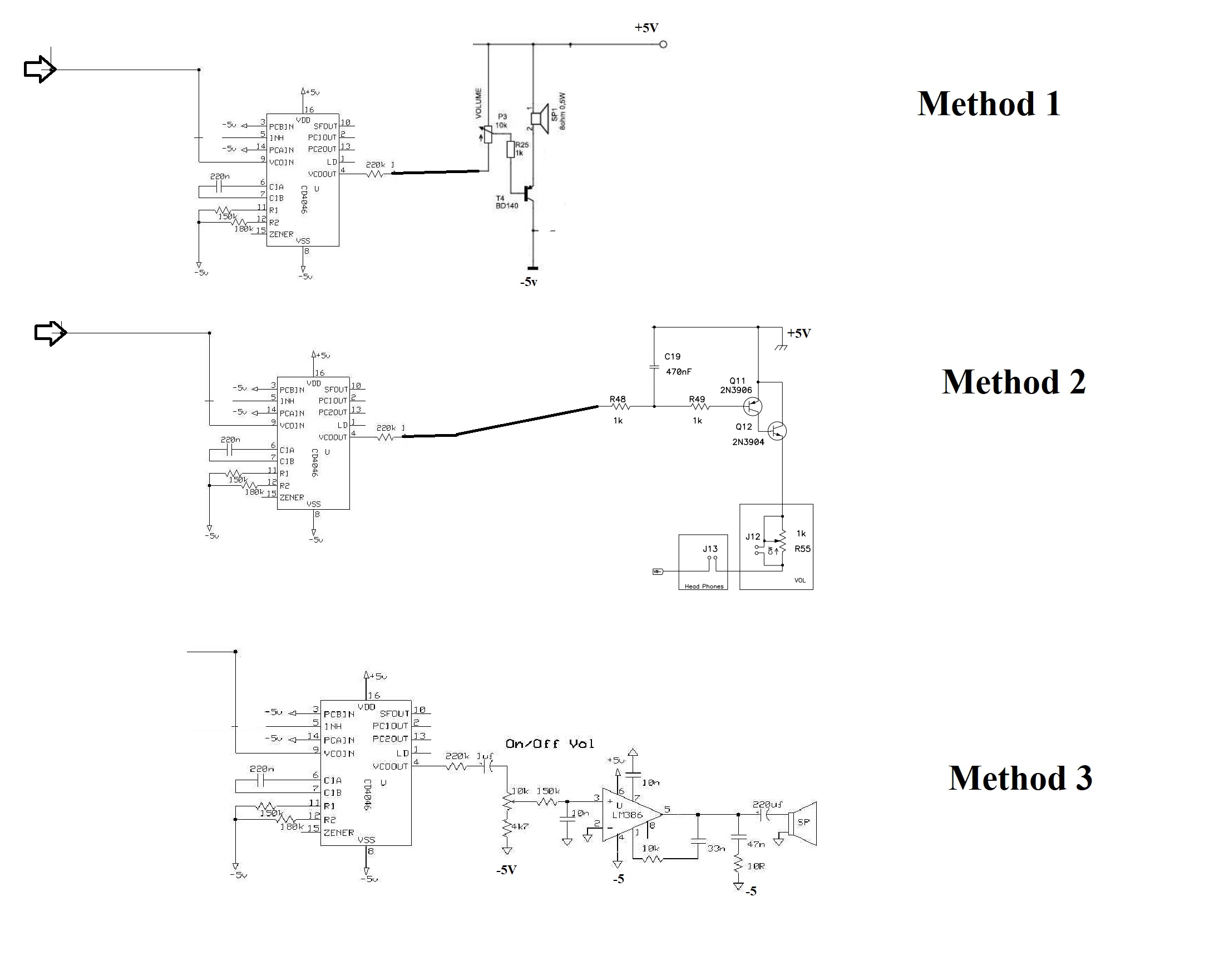

                    I'm going to use 8R, 0.5w speaker. Please see attached, do you think which of method is better?
                    I remember, LM386 (gain 20 ) is very powerful than such speaker and i have not good experience with the amp.

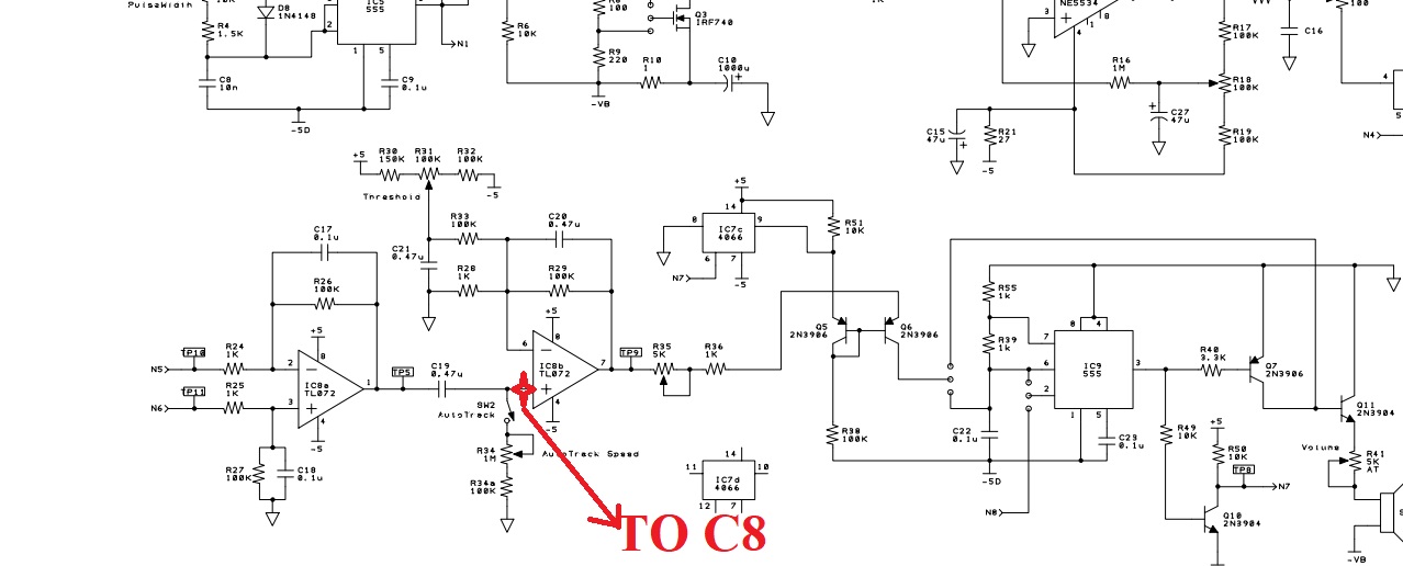

                      Can you tell me which point of HH1 must be connected to C8?
                        [ATTACH]55063[/ATTACH]
                        Any of these should work. You need to build them and test to decide which is best for you.
                        Output of the SAT stage.
                          Thank you.
                          Is that correct?

                            Is that correct?
                            [ATTACH]55067[/ATTACH]
                            That is correct

                              Originally posted by Mdtoday View Post
                              That is correct
                              That could be used but is the Integrator output.
                              The SAT output is what I would use,, at TP9.
                              You can try both and see which you like better.

                                I want to build Mickstv's Audio part. He used JFET PMBF4393 but i can't find the FET in our country. Do you think i can use BF256 as its replacement? Can you introduce me some through hole equivalent?
