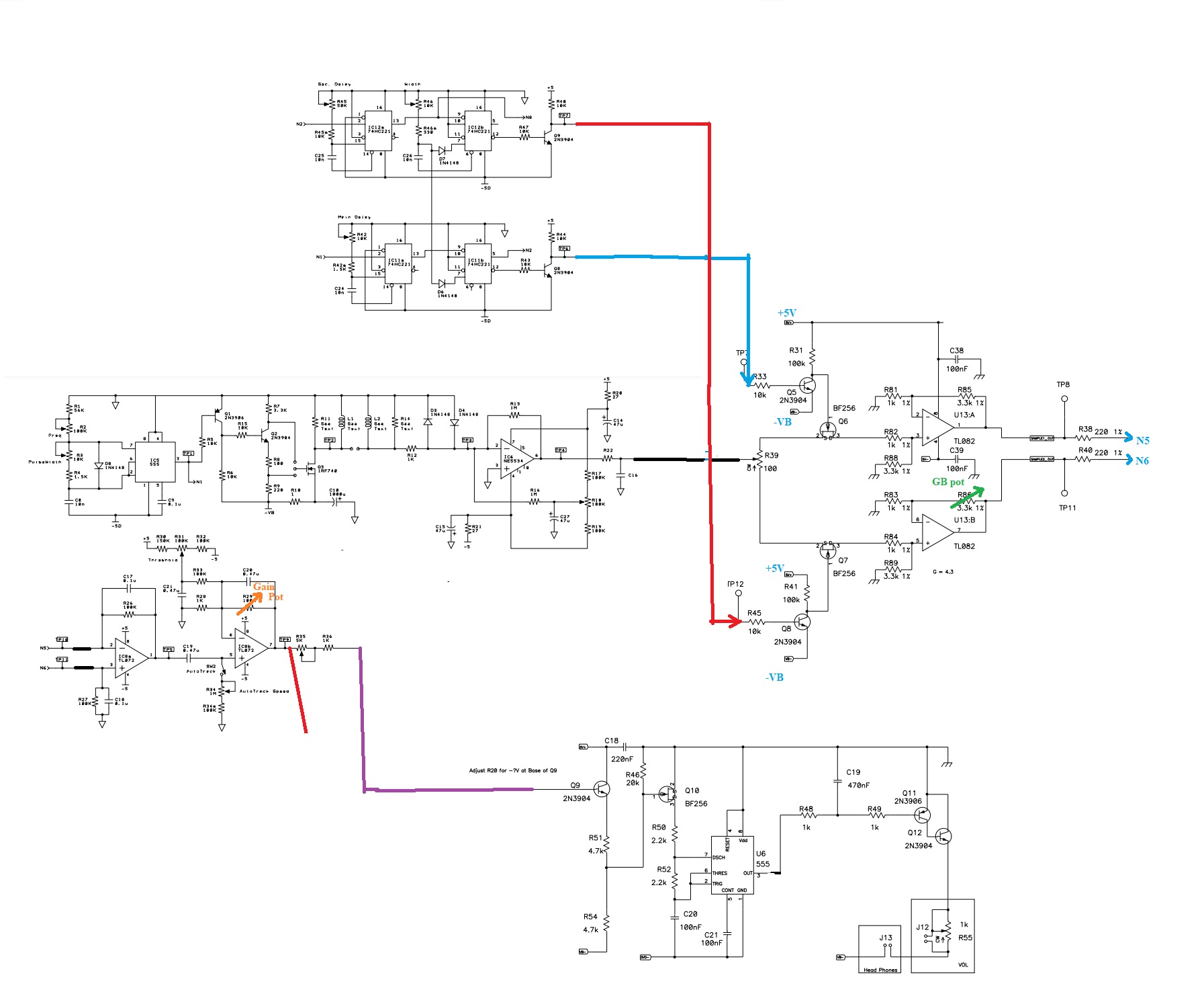

          • Hello
            Dear Walter
            Before everything, thank you for sharing your result.
            Please see the schematic, i used your schematic to edit HH1 Rev. D, added your GB, Audio part and Gain pot.
            Is it possible to see it and tell me your opinion?
            Thank you
            • You posted this is in multiple threads and I answered.
              The other thread is not correct place due to this is not within the thread's title and subject.
              Here is a good place.
              What you drew is NOT what I did to add GEB.
              In your schematic one of the FET switches is the target Sample the other one is the EFE sample.
              I did not look at any of the timing so unknown what this will do.
              My GEB uses Three Samples on the Two FET switches.
              Target sample, then GEB sample on other switch then just before the next TX pulse an EFE sample using the first switch.
              All timing is controlled by the PIC processor (you can use an Ardunio or other processor) or a third timing circut to do this.

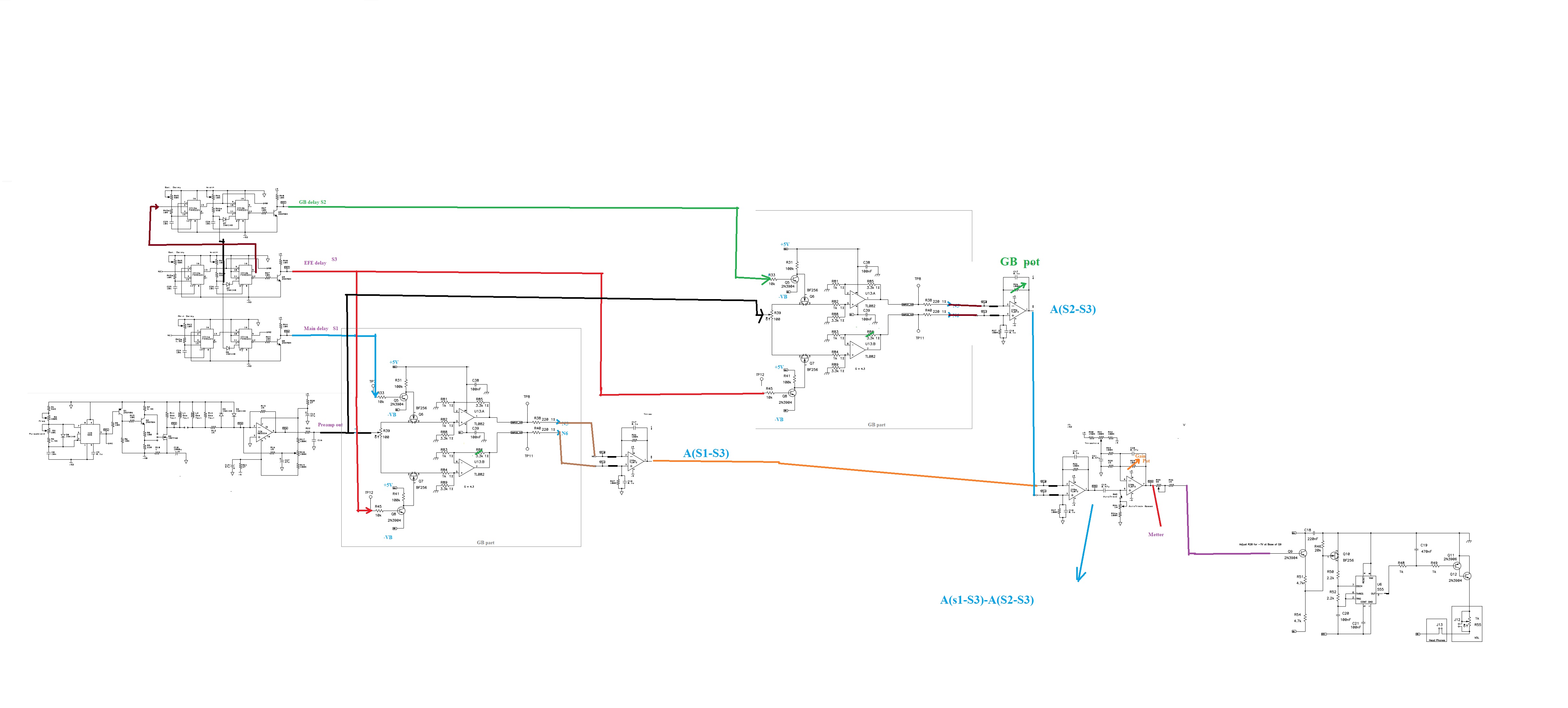

              • Thanks Dear walter
                Please see the new schematic, three sample, TC,EFE,GB
                What do you think?
                  Thanks Dear walter
                  What do you think?
                  [ATTACH]55040[/ATTACH]
                  On a quick look of the schematic that one should work.
                  Only way to really know is build and test.
                  Go back over my method and you'll see I did not need the extra switches, integrators, diff amp and timing circuits.
                  Plus very easy to adjust timing parameters when using a processor.
                  Also in this thread are links to GEB discussions. Follow them and read. These are where I learned what needs to be done.

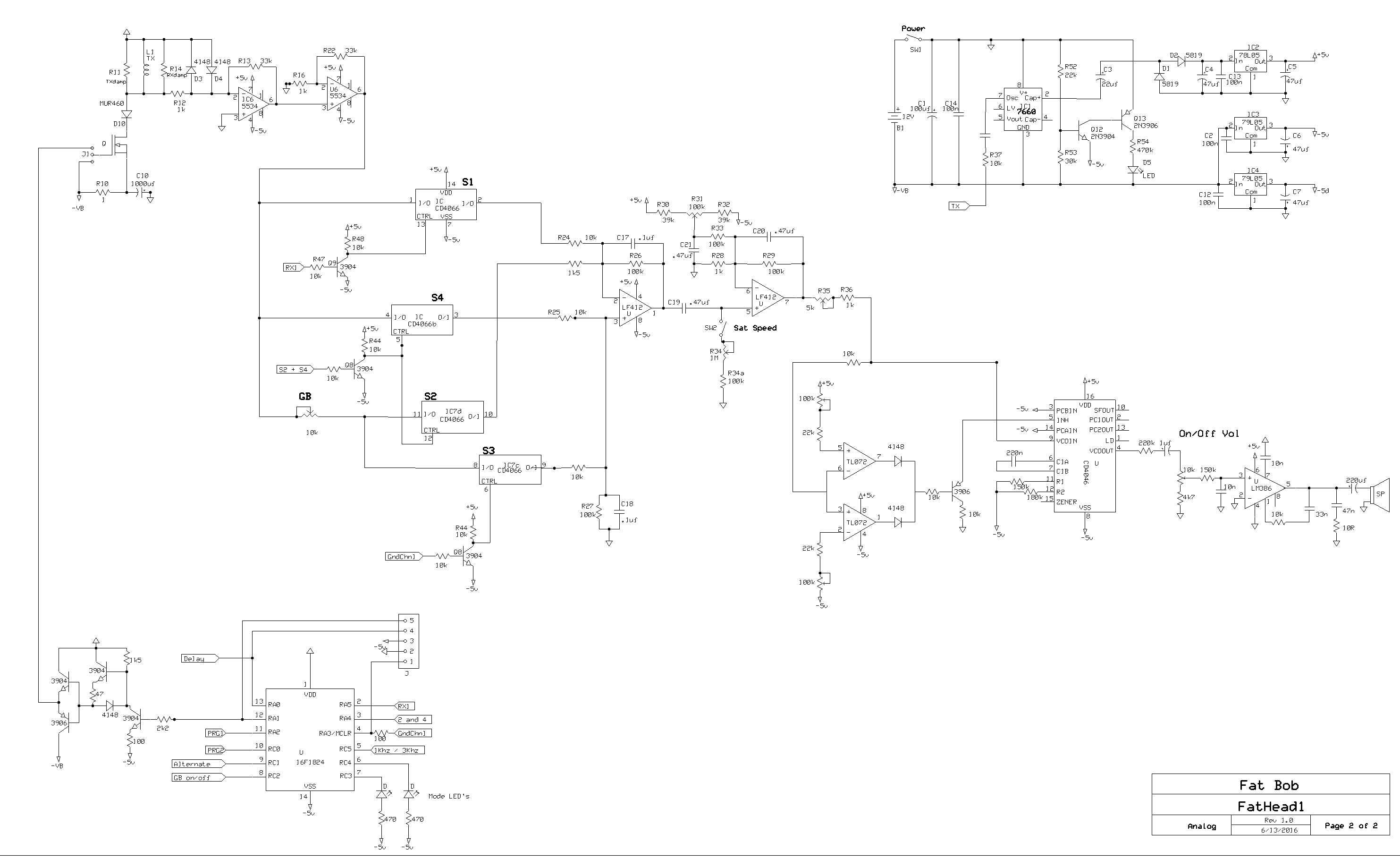

                                You right, using 8-pin PIC is very very easy, i will try it.
                                Yes, Mr. FatBob has used CD4046. As you see, there are two TL072 for generating two fixed tone (i think). Now suppose that i remove the two amp and out of HH is directly connected to Pin 9 of CD4046.
                                Do you think we will have different tones for different metals, size or etc?! I think GPX audio isn't using two fixed tone, i think it's a range frequency.
Name:	HammerHead With 14 PIN PIC GB Dual VCO.jpg
