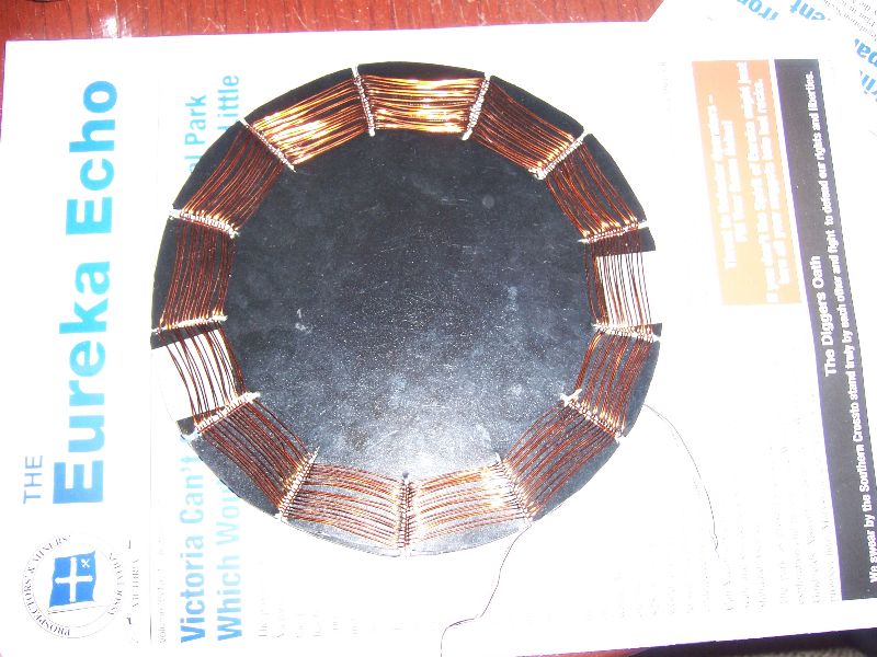

    just finished making a sniper coil running @239.1uh 3.6ohms with out cable and nulled with 60ohm which slightly under nulled for best response to gold ring, no hand movement gave a signal at all.
    Added cable type wb1510 mic type of 1.5m long change a few things 315uh 149.8pf 6.5ohm nulled with 55ohm for good null I still get no type of sig from hand movement, this coil has given me the best response to rings and small bean type sinkers to date hitting 15cm in air test for rings and 25mm squares ally heat sink when adjusted right 26cm good sig and 29cm very faint sig
ID:	350349 the one closest to the logo on mat is the best one I built so far, just trying all sorts of winding patterns to see what works the best, the heaver coil really good for iron and ally type of things but struggle on rings and bean sinker.

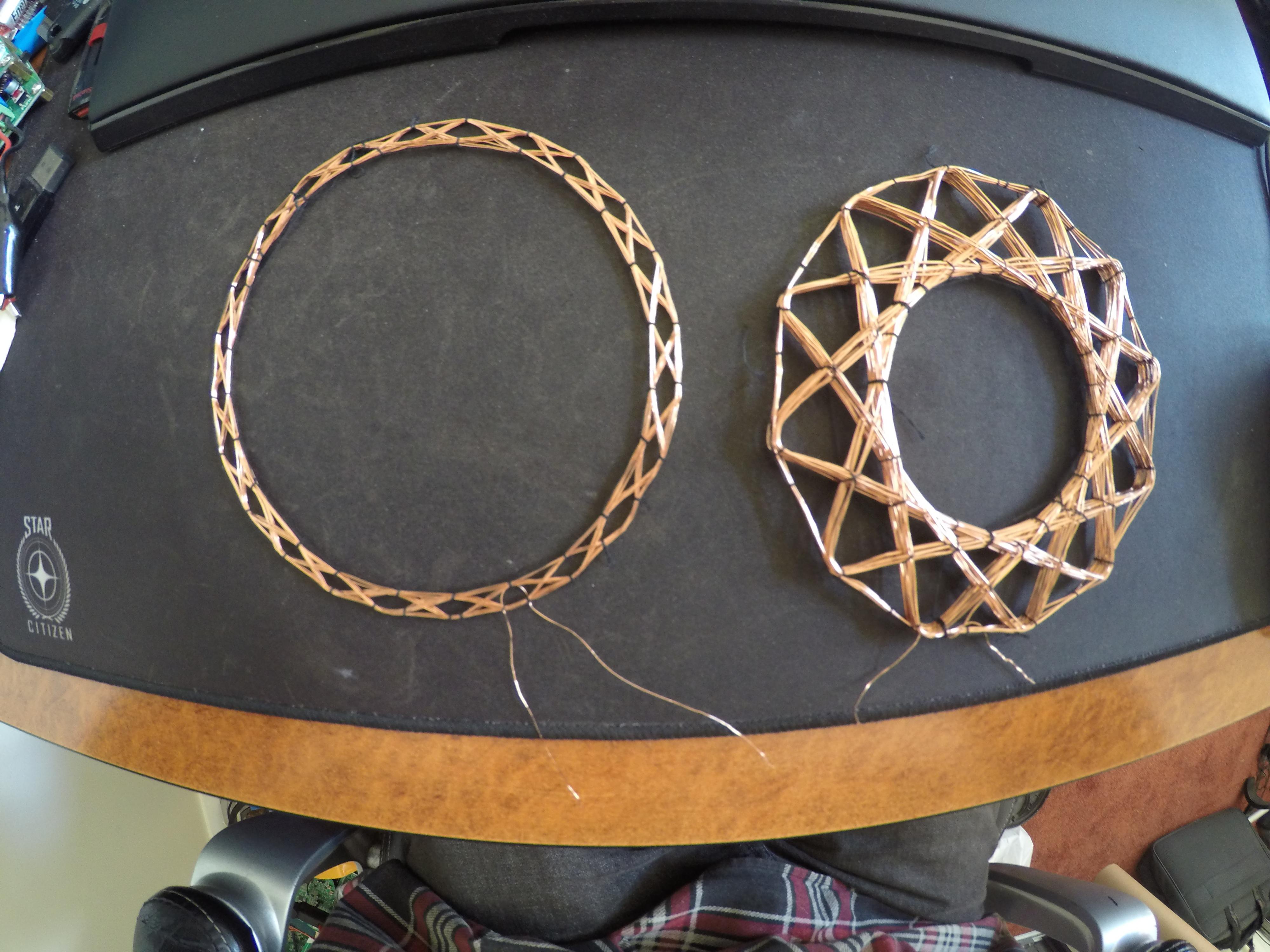

      Chiv this basket weave style may be worth a try for your experimenting. It is documented here somewhere. Very easy to make on a plastic-coated cardboard(or similar) form. Simply cut an odd number of slots at even intervals. Use thinner wire to increase resistance if necessary, depending on the R requirements of your detector. Not sure of the capacitive effect this will have, or damping requirements, though.
      Very skillful coil winding there Chiv.

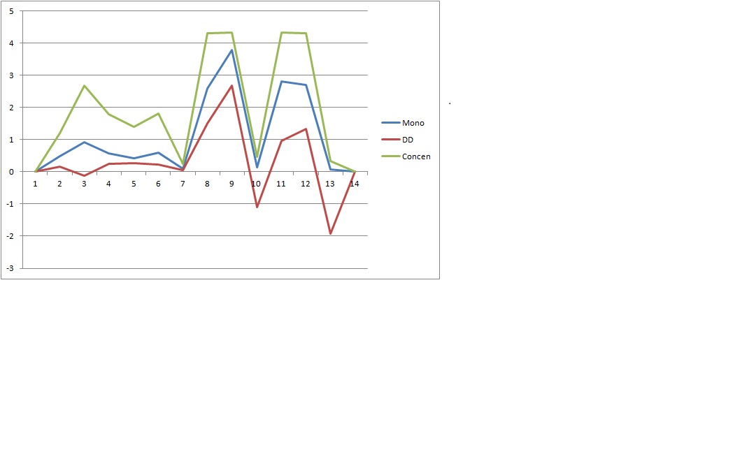

                    Experimenting with output response and different coils, settings.
                    I placed each target 1.5 inch (3.8cm) above the coil center and measured to Integrator output with a DVM. I subtracted the No Target Voltage from the Target Voltage to get the Difference. Delay Set to 15usec. Coils are: 10" Mono, 13" DD (Pictures in above posts) and an 8" concentric (Details on this coil coming).
                    Target list (number correspond to numbers on Chart.
                    1 No Target
                    2 Ag dime
                    3 Ag half
                    4 Cu penny
                    5 Clad dime
                    6 Clad quarter
                    7 sm Alum
                    8 Nickle
                    9 Gold ring
                    10 eye screw
                    11 Brass key
                    12 lg Alum
                    13 Nail
                    14 ferrite (chart 1) or Alum coin (chart 2)
                    First chart with GEB = 0usec. Note that Only the Steel eye screw and the Nail gave a Negative response and only on the DD coil.

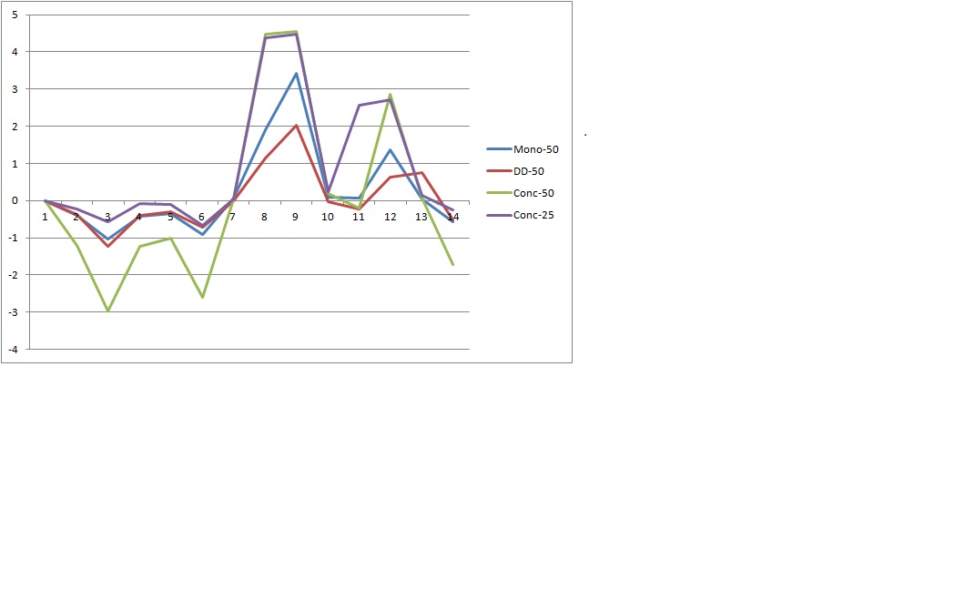

                    In the second chart the GEB is set to 50usec then to 25usec (only on Concentric coil). The big difference is more targets give a Negative response. This would be helpful to ID target types with a High/Low, Low/High (Dual) tone audio (still working on this 6666). Also, adjustment of GEB could be used for Target ID.
