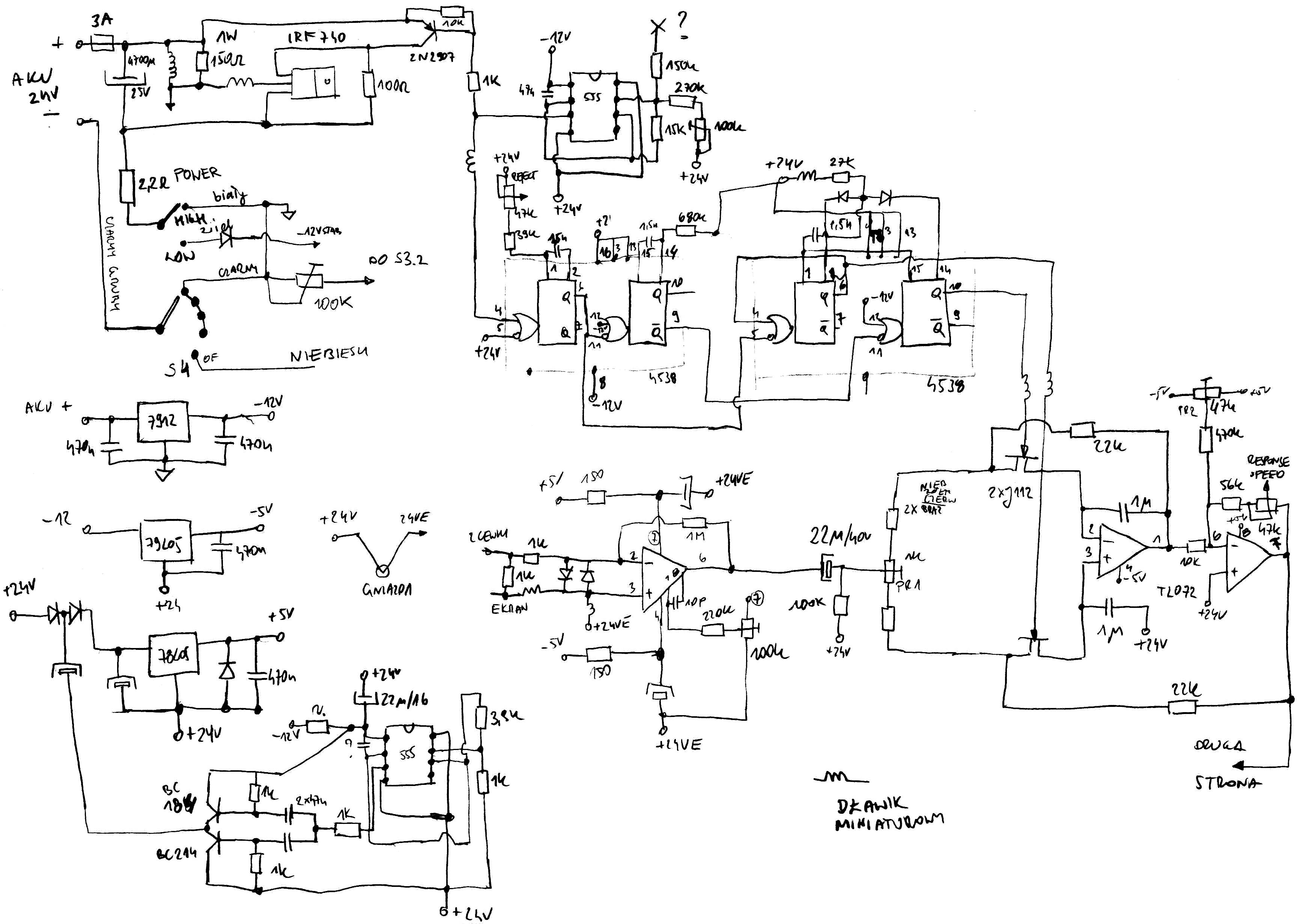

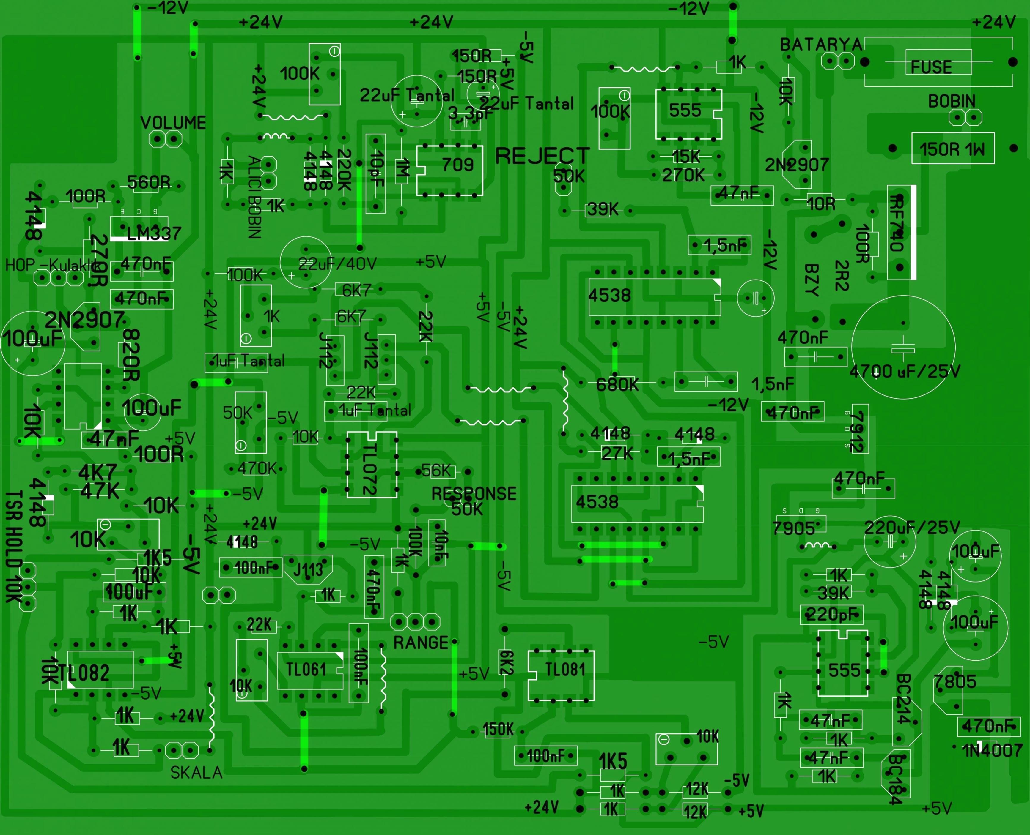

                            I found these in anouther forum and i think it is the same as the one in the pictures you uploaded Click image for larger version
Name:	Водолаз Пи 2 печа&.jpg
ID:	439114 Click image for larger version
Name:	Водолаз Пи 1 печа&.jpg
ID:	439116 Click image for larger version
Name:	SUPER SCAN PCB.jpg
ID:	439117 Click image for larger version
                            IS there a more clear schematics or should i try get it from here

                              oh Kuča Mala. vali vsio v odnu kuchu.
                              you took files from folder 'Eric Foster and his detectors_Goldscan'. ok, it is Eric's Aquapulse 1B. what your far action?
