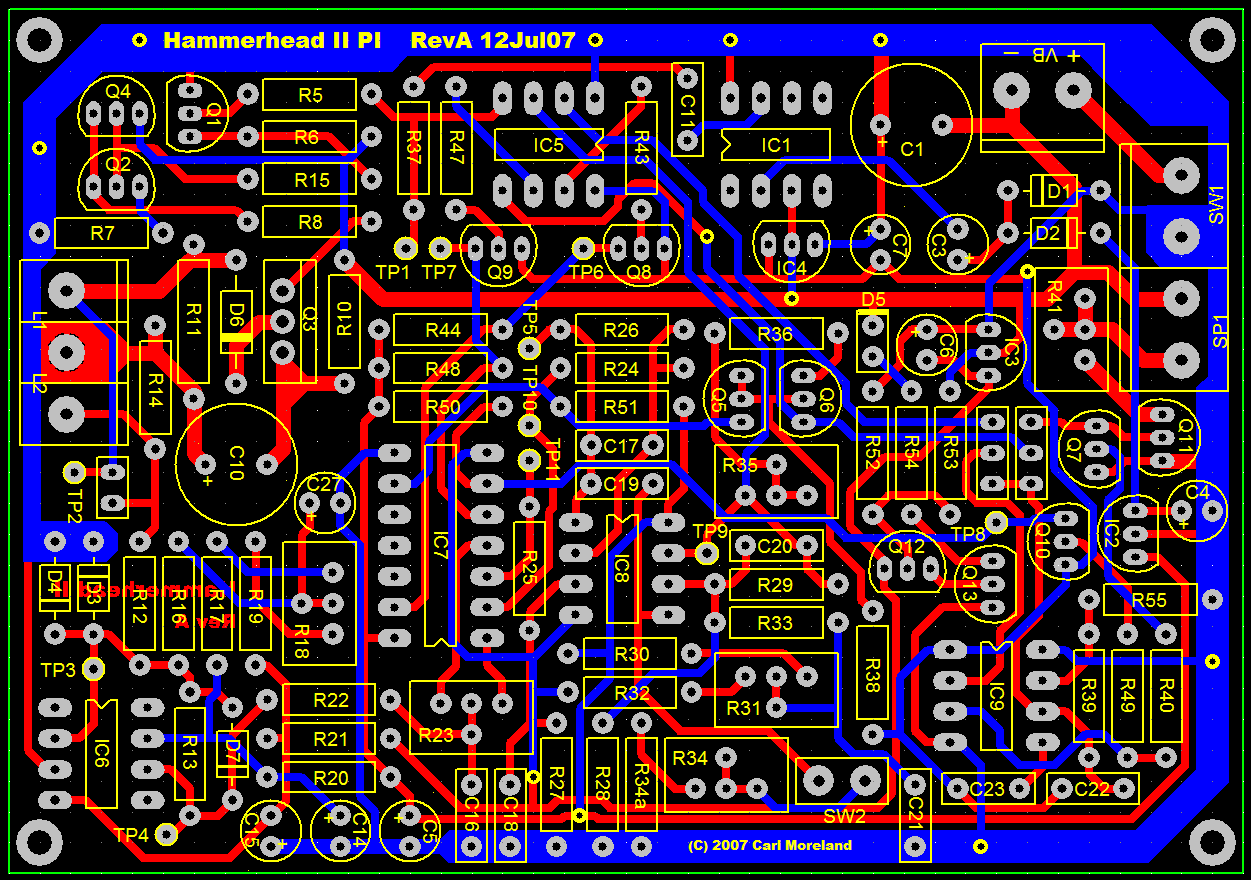

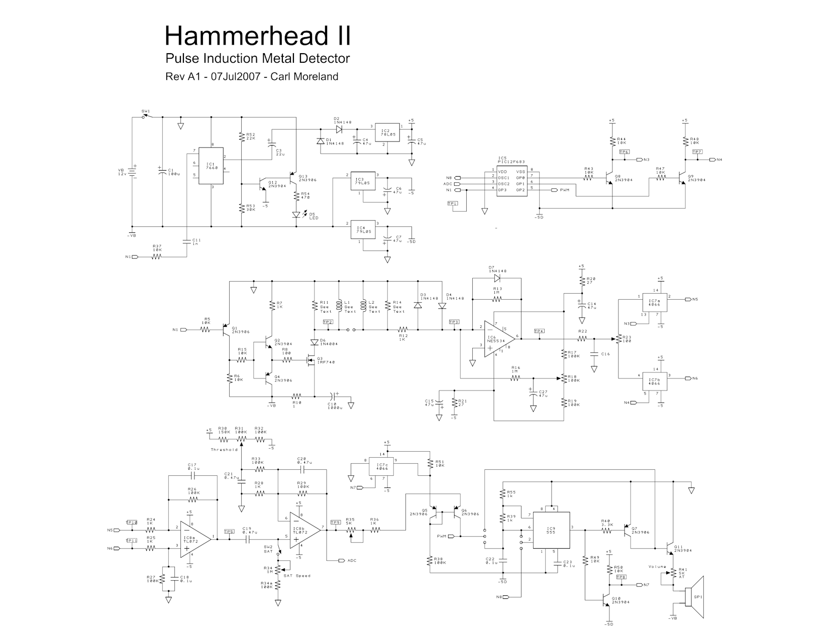

For the most part, HH2 is the same as HH1 except that the main 555 oscillator and 74221 chips have all been replaced with a PIC 12F683. Why did I chose this part? Because it is small (8 pins), and offers the option of trying out the ADC and PWM for audio generation.
Also, I did a few minor updates, namely adding a class B driver for the MOSFET, a drain diode on the MOSFET, and a feedback clamp diode. These should help those who are trying to wring out minimal sample delays.
