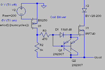

                    Hello friends,
                    here is the slight improvement of the low-cost PI MOSFET driver. By stacking the 2N2907 (Q1 paralleled with Q2), the circuit is able to switch off faster, be able to drive more paralleled power MOSFET's or a higher input capacitance MOSFET's. If you are using only one power MOSFET, then only one 2N2907 is enough. The resistor R3 gives a soft-on feature. I have reduced the R2 to make the Q1 faster for switch-off. The higher switching current through BS250 is a peanut compared to the potential for reducing the switch-on time due to faster switch-off of the power MOSFET. The switch-on time is delayed due to R3 to a few microseconds. The switch-off delay is just around about 200 ns. The coil current will be switched off in about 70ns until it reaches the avalanced state of the MOSFET.
                    If you stack the power MOSFET's, then ensure both devices are mounted on the same heat plate to have same temperature. Other PNP transistors for Q1 could be used. Just try it out.
                    I will enclose the whole spice simulation model for further experiments for you. Look for the improved version in the zip-file.
                    Why I did this effort?
                    I couldn't get the MOSFET driver IC's on my local shop or supplier! But all the parts used in the low-cost variant are most common, available and cheap.
                    Happy simulating..
                    Aziz

                          Hi Aziz ,
                          how are you ?
                          I am sure you remember that I am studying to make TX part for QED.BW's homework to me.
                          I want to use your improved driver ,but I could not understand how to control it.
                          in schemetic what is V2 ?
                          I can understand Carl's and BW 's drawings , but can not understand your simulation drawings.
                          according to your improved schematic ,how can I control TX.
                          where Should I put TX timing pin ( 18f4550 's control pin for TX (driver pin))?
                          Btw I want to use 18F4550 for QED. how can I do connection.
                          can you explain a little more ,please

                            The mosfet driver circuit is tailored for the negative supply voltage operated micro controller and coil. The coil flyback voltage will give a positive voltage response. If your micro controller and your coil supply has not the same supply configuration, then you can not use the schematics. QED uses a different supply configuration I think. So the schematics must be adapted.
                            V2 is the transmit trigger pulse from the micro controller and is used only in the simulation model for clearness. The micro is operated from system GND = micro VDD and system -5V = micro GND. The mosfet BS250 is for logic level shifting from 0/-5 into 0/-Ucoil (0=ground). It is also inverting the pulse logic (simple inverter). -Ucoil can be much more (e.g. -12V). A zero volt on BS250's gate means transmit coil off and a -5V means transmit coil on. So the micro has to support a negative transmit logic: I/O pin=0 => transmit pulse on, I/O pin=1 => transmit pulse off.
                            Giving a higher switching voltage to the IRF740 will lower the mosfets on-resistance. Therefore the full coil voltage rail is fed into IRF740's gate. Care must be taken to the two 2N2907. They should be matched together (= same characteristics). If not, they need an additional seperate resistor on each base. Usually one 2N2907 is enough to discharge the IRF740's gate charge quickly.
                            If the micro has tri-state I/O output on the transmit pulse pin, an additional resistor (e.g. 100k) from the gate of BS250 to source pin must be connected to force switch-off of the coil. Otherwise, it could have an undefined state and could switch the coil on/off arbitrary.

                              Hi Aziz ,
                              I can not program atmels ,I do not know assembler or C++.so I have to use pic.
                              I could not understand your below words
                              I/O = 0 => transmit off or on.?
                              thanks
                              so if my pic can give -5 when it is on ,I can drive your tx circuit.

                                micro output register set to 0
                                voltage at Micro output pin is -5volts
                                BS250 turns on
                                Coil Transmit on
                                micro output register set to 1
                                voltage at Micro output pin is 0volts
                                BS250 turns off
                                Coil Transmit off
