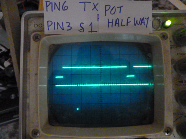

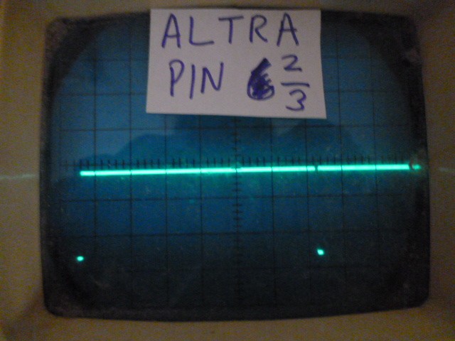

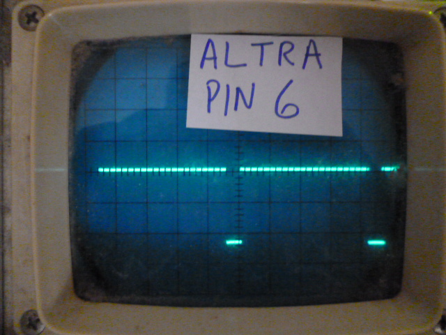

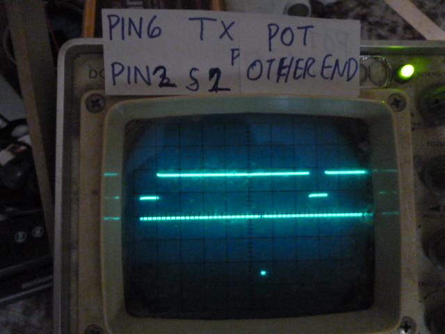

    Here are some wave forms from the Tx pin 6, and sample pins 2/3. and the delay between them.
    Here is the pulse on pin 6
      Here is the pulse on pin 2 and the same on pin 3, they look the same
      very short pulse.
        This shows pin 6 the tx pulse pin at the top of screen, compared to pin 3 the first sample pin, with pot at minimum delay.

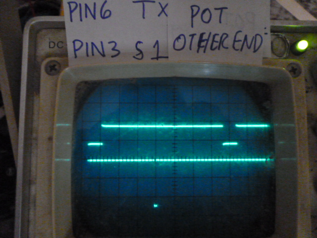

          This shows pin 6 and pin 3 with pot at half way, thats half the maximum delay.

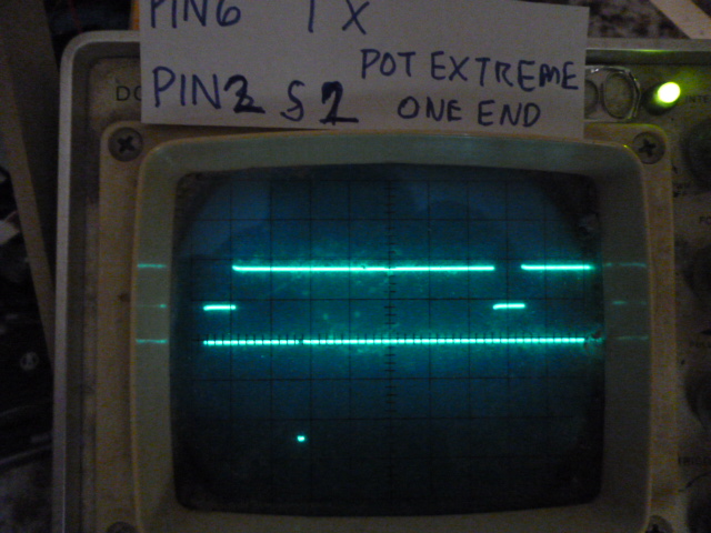

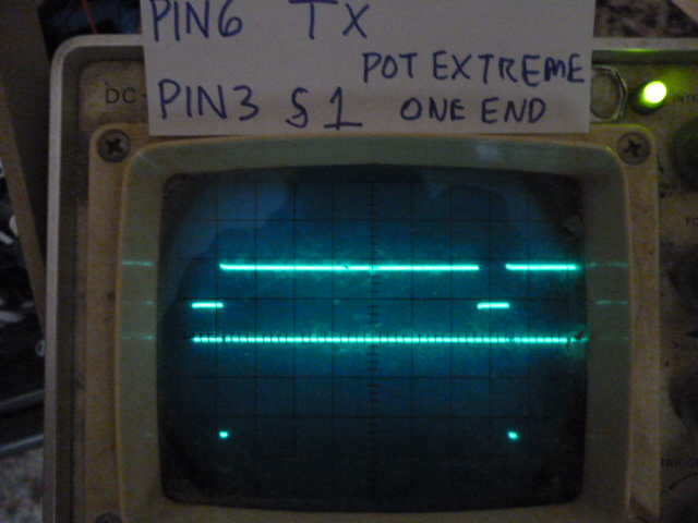

            Maximum delay, you will see the pulse has moved by 3 cm's
              Pin 2 sample 2, pot set to minimum delay
                Pin 2 sample 2, pot set to maximum delay

                    6666,
                    Good that you got it working. I reversed sample 1 and 2 in software to give
                    me a positive response on the output of the threshold amp. If you are using
                    Carl's original HH2 circuit then use my code which JLK modified.
                    Mark

                          Had a little win today
                          I have figured out what version of mplab was in use in 2009, seems it was Ver 8.00
                          anyhow have installed it and run carls asm code through the compiler
                          and this hex code popped out with no reported errors
                          I have yet to burn a pic and see if it works
                          stay tuned

                                Hi Ap
                                its alive, it works
                                I can see pulses from carl's code
                                will post pictures asap.
