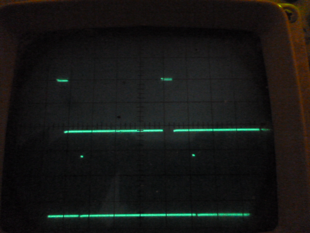

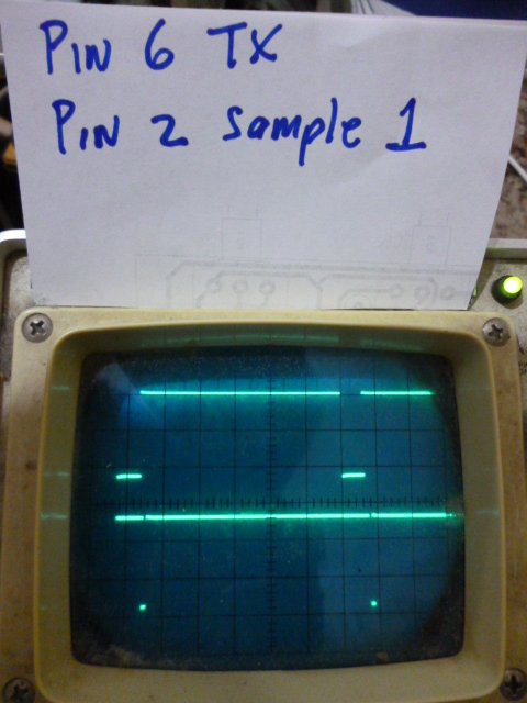

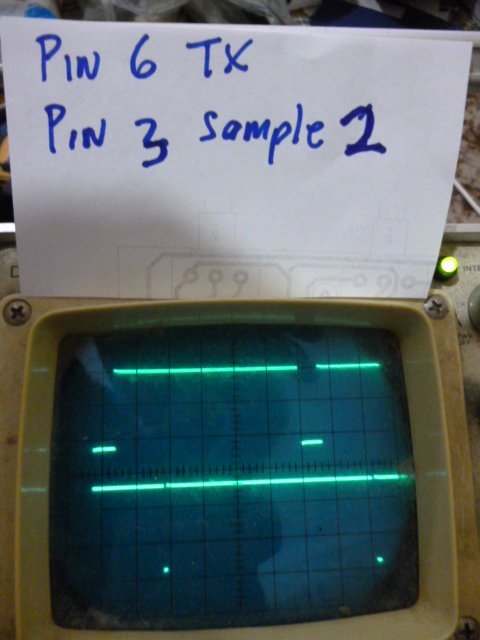

    Here are my results
    I am getting the main Tx pulse on pin 6 and the two samples on pin 2 &3

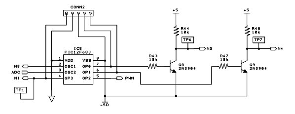

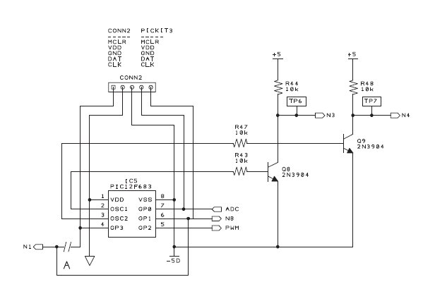

    there are TWO drawings labelled Rev A1 20 June 2009
    The first drawing is the old one
    drawing 4 matches the code, see pdf

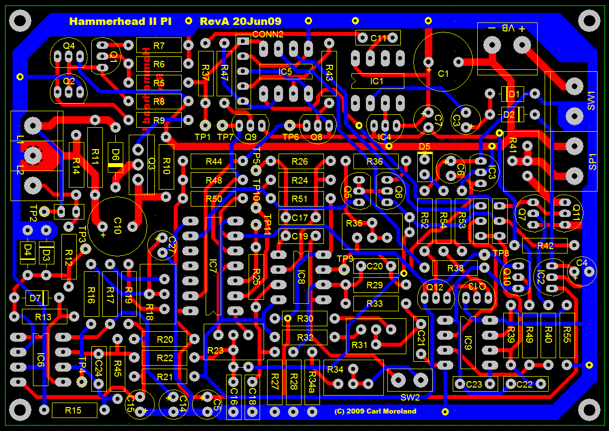

            the pcb mods are in the post above in the pdf
