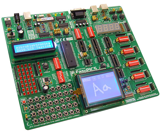

            I have the EasyPIC 5 ->
            http://images.google.co.uk/imgres?im...a%3DG%26um%3D1
            ... and now I see they've brought out EasyPIC 6.

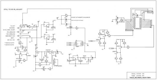

                              Hi Goldfinder,
                              I would be interested to work on this project. Attached is a PSU&TX board that I am getting ready to etch. Do you have any suggestions for improvements?
                              Tinkerer

                                Tinkerer,
                                I couldn't get a version of this picture with any clarity to read it. You need to post a better picture.
                                Goldfinder
