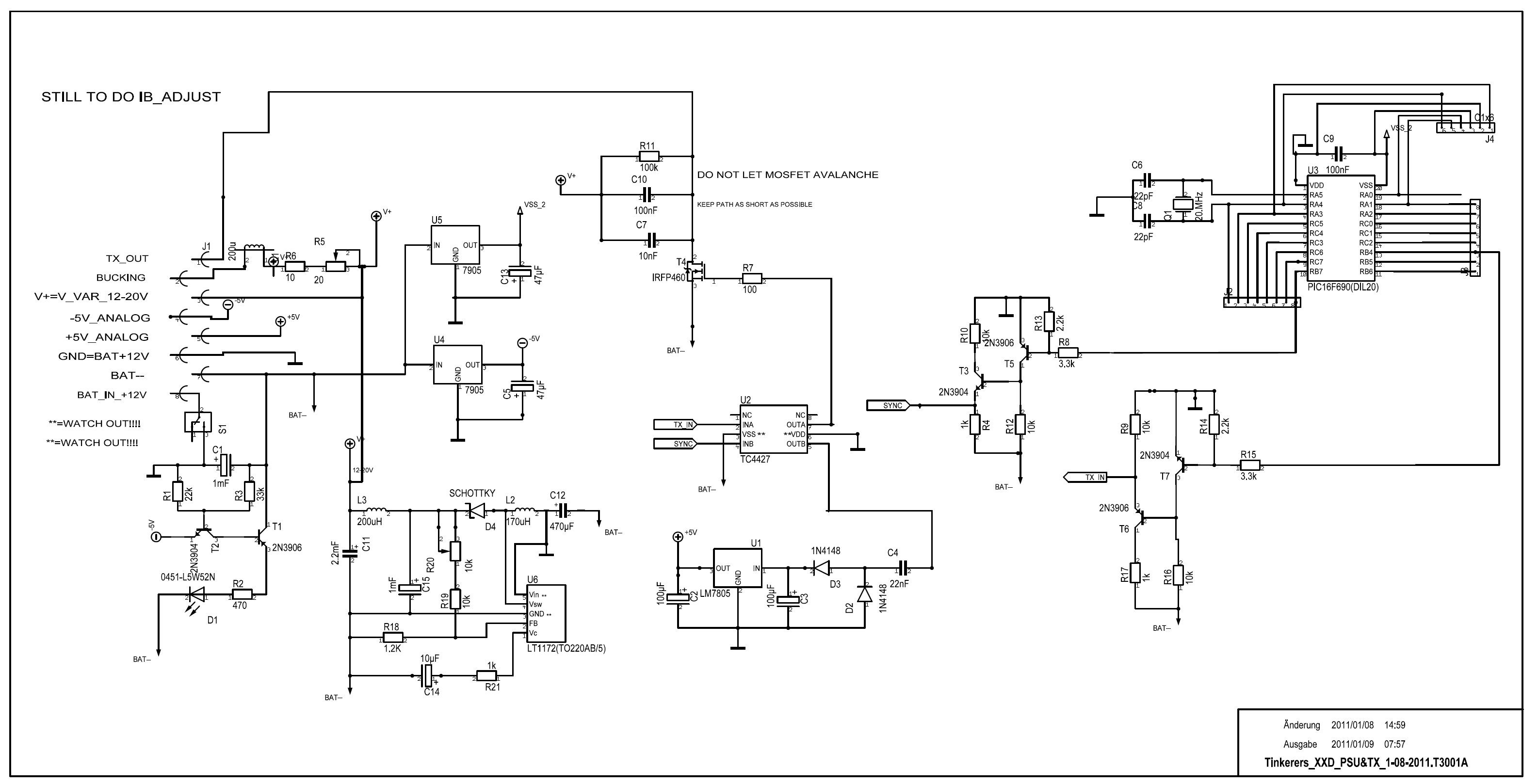

      The board is a basic PSU with a TX and a PIC used as timer. I use the PIC16F690, because it comes with the PICkit2, that I use to learn. However, I admit that my programming learning progress goes very, very slow.
      I also have a PIC18F4550 that has some advantages. I think it would be a good MCU to use.

        This might be easier to read.
        Tinkerer - There are a few strange component values that you might want to take a look at.
        For example, 2.2mF and 1mF. Presumably these should be 2.2nF and 1uF.

            I am still in the struggling phase with this CAD software. Actually I have not decided yet if I will stay with it or look for another one. It is free and unrestricted for 250 pins, but I have some difficulties with the components.
            The Capacitors C11 and C15 are 2200uF and 1000uF. The TX delivers 5A pulses.
            On the 3 D picture some parts are not represented (C11) or with the wrong shapes like the toroid inductors L1,2,3, there are no toroids in 3D available.
            The choice of components used on the board is conditioned by what I have in my parts box or can cannibalize from old equipment. Once the board has run and proved itself, I will redesign it for the final version, using good quality, easily obtainable components.
            Any suggestions for design and layout improvements are most welcome.
