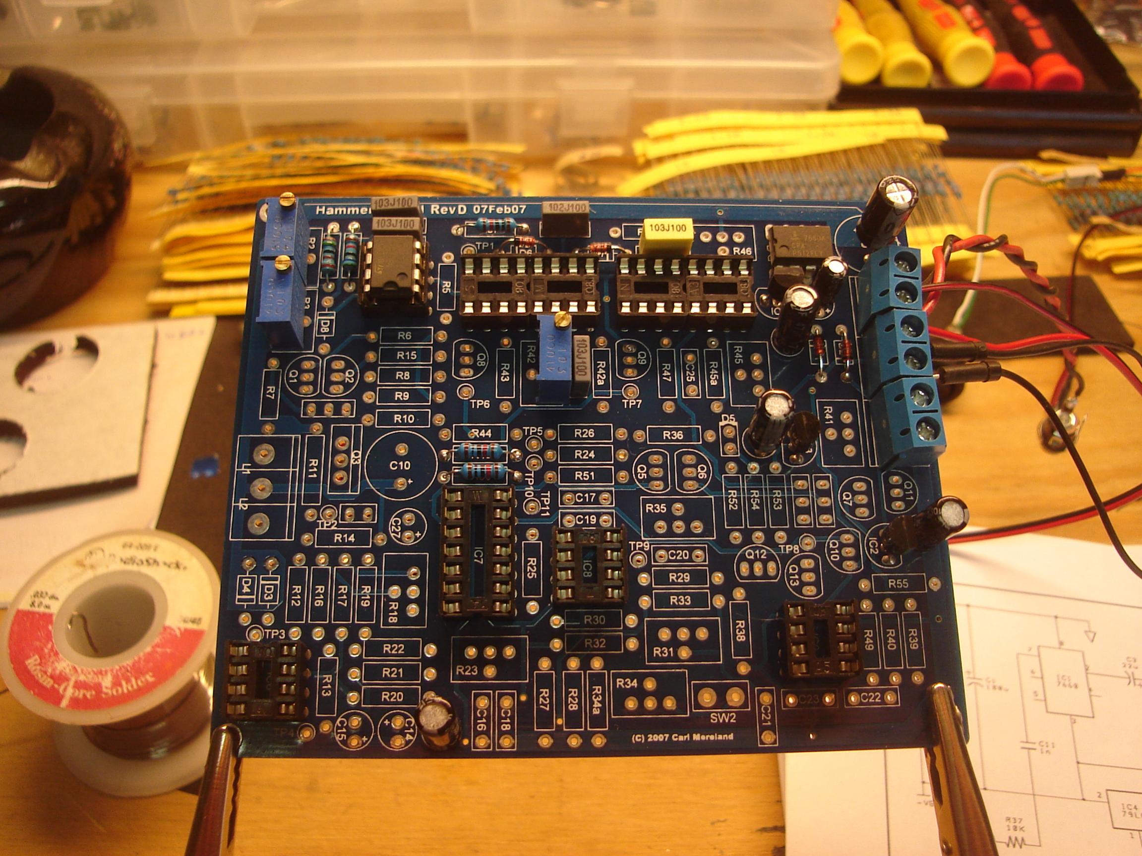

    Well, finally decided to build this project, something I bought quite sometime ago but never got to it because I just didnt have the knowledge when I got it. I now understand the components better, how the pi operates and have a better understanding of using my scope so decided its time to build the venerable Carl Mooreland Hammerhead.
    At this moment, the build is started and per the build doc have just finished steps 1 & 2 the power supply & oscillator section. Step 1 and step 2 both check out nicely with all voltages correct. Will add pics as I go so to log the process for everyone to follow along that may be interested.
    Anyhow in the mean time, I would like to ask anyone that has built this project, what option did you choose, option 1 vco or option 2 non vco, which option is the better choice in your opinion. I have been leaning towards the VCO but every unit I've built to date so far has been vco other than the surf or cuda. After reading about option 2, non vco, it doesn't sound to bad either so am stopped in the build procedure until I make a choice.
    Will post some pics in a bit.
    Geo
    Ok, just ran into the first issue, the option 1 & 2 documents do not match the rev D board or diagram so is there a Rev D option 1&2 doc anywhere, I am not finding it...
      7660A and power supply
      Power supply built. 7660A is the 12v version and that is what was used here.
      Ic2/pin1 = +4.98v
      Ic3/pin3 = -5.02v
      Ic4/pin3 = -5.02v
      Ic2/pin3 input = +10.7v (using 12.6v supply)

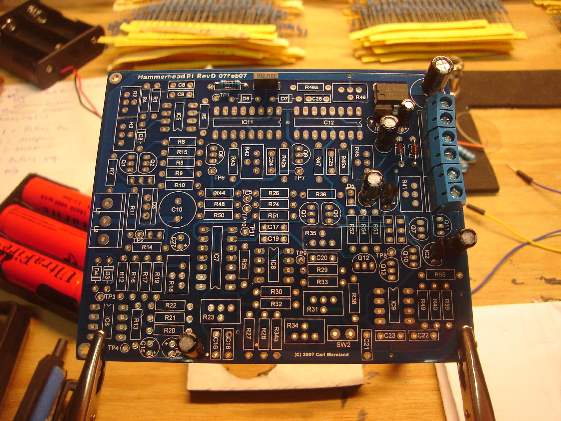

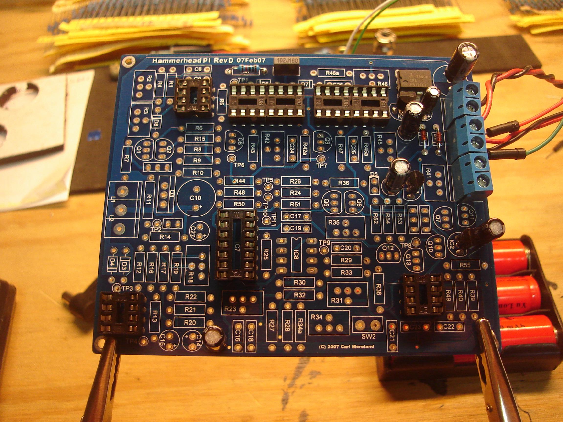

        Clocking Section with 555 & components
        Clock oscillator section installed, tested and good to move on.
        Ic5/pin1 = -5.02v
        Ic11/pin8 = -5.02v
        Ic12/pin8 = -5.02v
        Ic5/output TP1 = -0.8v (w/R3/R4 centered)

        NOTE:
        After installing this section and continuing to read on in the build doc, I noticed it says "Do not install Q8-Q9. Make sure all appropriate shorting wires are placed for this option." (somehow I did not see this the first 11 times I read this)

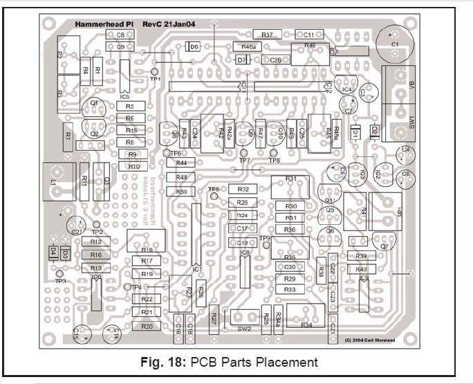

        What and where do any shorting wires go, I looked over the doc and am not finding that info anywhere, help at this point would be appreciated.
          The Jumpers are not shown in documents for Rev D. Use Rev C Placement.Click image for larger version
            The Jumpers are not shown in documents for Rev D. Use Rev C Placement.[ATTACH]37501[/ATTACH]
            Thanks homefire.
            I have looked the drawing you posted over numerous times but my RevD board doesn't have the holes for those jumpers in it, it doesn't even match up to that. In fact, it looks like a couple of the spots have the jumper trace already in place with no need for using a jumper.
              Not followed all the changes. Just went by the project list and comments on only a few changes for the Rev D. They must have redid the board at some point.

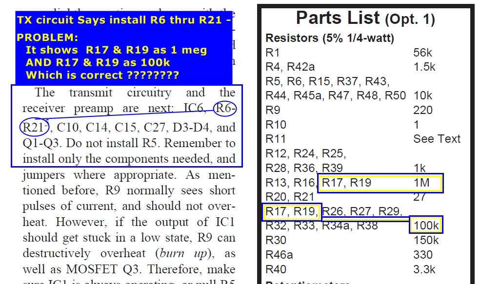

                BIG PROBLEM - R VALUES Labeled Twice ???
                Well, started into the TX portion of the circuit this morning and low and behold, found an issue within the doc for the transmit section of parts values.
                See image below, R17 & 19 is shown in option one parts list as 2 different values, which is correct for this application.
Name:	TX circuit incorrect values.jpg
                It would be great if Carl or George could chime in with their advice....
