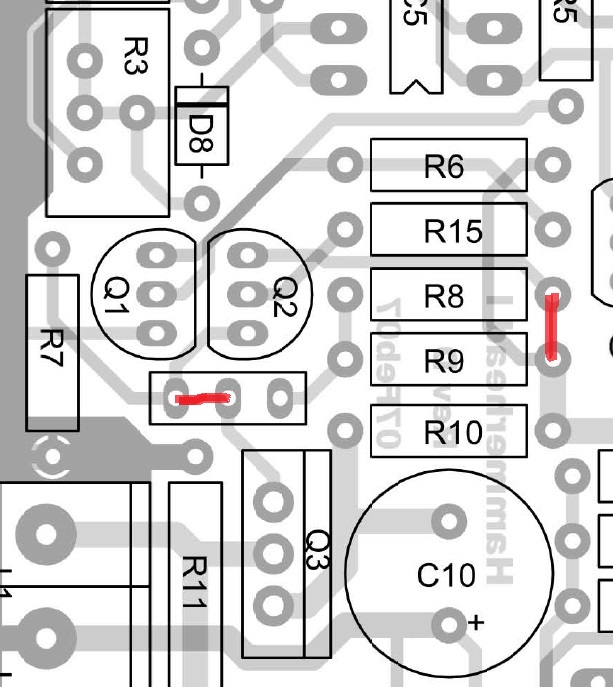

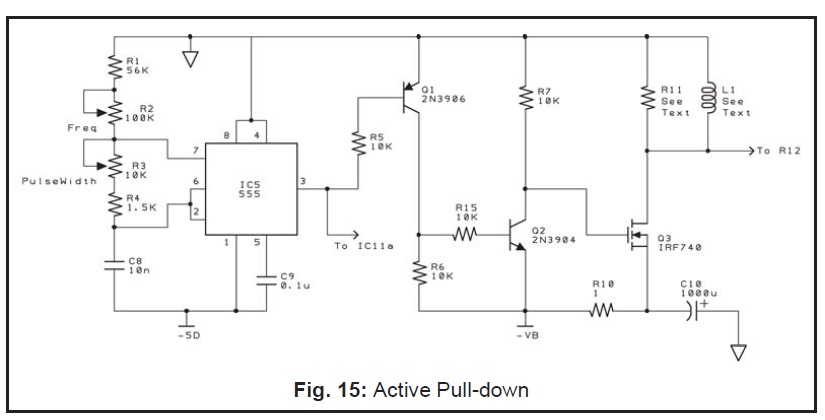

For aktive pulldown you have to build it to this picture.Originally posted by geoscash1 View PostOk, I am stopped for awhile until I can sort out the TX section, very confusing with understanding what the active pull down, passive pull down, R7, R8, R9, R15, which parts to add which to leave off .... uhhgggg.....
I want the faster turn off of Q3 but am not quite understanding which parts to leave out or to add to get this correct.
I think I am understanding this as, Quote - "however, an active device pulling down the gate/base of Q3 will achieve faster turn off than a resistor" , so using Q2 as the active pulldown then I leave R7 off and jumper it or short it and then use R15/10k for Q2 base, still keeping R8 to divide down the voltage at the base of Q3 or is this incorrect.... good gracious, I am seriously confused now.....lol
I think I need a drink, oh wait, that probly wont fly with my chemo....never mind, maybe just a strong cup of coffee and a pain pill for the massive headache I'm about to get.....
Change R7 from 3.3 k to 10 k; make shorts (see picture in red)
Leave out R8 and R9

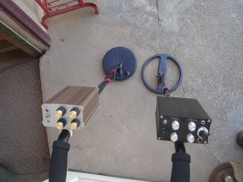

I would highly recommend the minipulse plus for sure especially with some of the mods that KRinAZ did. My second MPP build turned out awesome and has some great depth with the mods. Around home the air tests are good but I have lots of emi or interference because of flo lights, solar panels on the roof and 500kv powerlines right outside on the street. But when away in the mountains it adds another 1 to 1-1/2 inches to air test depending on test item.
I'm getting 5 inches, good signal on a 1.2 gram nugget and 3 inches on a .47 gram (8 grain) at home testing but away it improves to 6 inches and 4 inches respectively. I am super happy with it, using a 3dss 7.5 inch coil wound with 250/46 litz single cover @ 312uH and 2.2R.
I am not sure how the hot ground of Australia will effect it but its worth a shot and I think one of the members here has made an addon circuit for GB for the mpp, its in here in the mpp forum somewhere.
here is a quick vid I shot the other day and loaded to youtube because one of the members here asked and wanted to see how it worked.
Video isn't that great but you can see it is working well. My MPP#2 on left and my Mirage#1 on right.
Hi Michael,Originally posted by mschmahl View PostFor aktive pulldown you have to build it to this picture.[ATTACH]37531[/ATTACH]
Change R7 from 3.3 k to 10 k; make shorts (see picture in red)[ATTACH]37532[/ATTACH]
Leave out R8 and R9
Wow, those images/drawings don't match mine at all.. and it looks like I shorted R14 and R7 misunderstanding the info I have. I think I have R8 & 9 installed as well based on the drawing I am using.
Well it looks like I have a mess goin on so will probably try to pull components at least back to step 2 or 3 and start again, not sure that will go to well, been a bit shaky the last couple days so will probably shelf it for awhile.
thanks for chiming in and helping with that, much appreciated..
Hey Geoscash,
This may be a little belated but just found this thread.
I did the vco option 1 on my hammerhead. I have the jumpers in place and it worked great until I knocked it out of cal. I set it aside untel I get better with diagnostics ahh and everything.
Ok found them.
http://www.geotech1.com/forums/showt...erHead-Problem Post # 14 shows the where the jumpers should be.
I had a hard time with that as well, the only way I was able to figure it out was to cross reference both options of the schematics.
Hope you get feeling better.
Hey thanks godigit1, much appreciate the close up shots of your board, that will help immensely when I do get back to working on my hammerhead. Now I have something to compare and see what resistors I may have installed that shouldn't be on board.Originally posted by godigit1 View PostHey Geoscash,
Ok found them.
