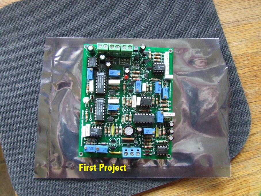

                        MY HH
                        I hope all of the componets are correct?
                        Buzz
