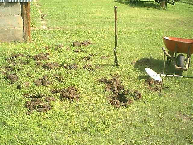

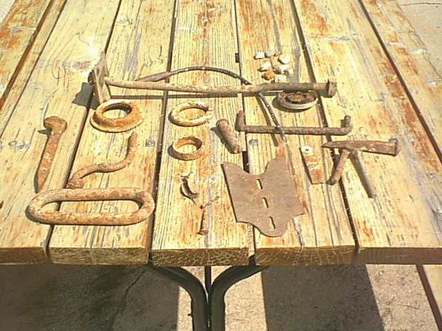

    I finally have it finished enough to take it out for a test drive. I live on an old farmstead, so there are a LOT of targets in the soil. Most of them are iron. Many of them small; pulltabs, bits of wire, nails. I tied the coil between 2 trees and swung a couple of targets.
    Beer can 2 feet
    shovel 4 feet
    55 gal drum lid 5 feet (18" dia)

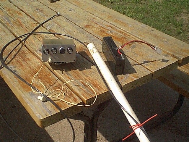

    I think I could do better, but I had to use what I had on hand. The coil came from multiconductor shielded cable. Its about 396uH 9 or so turns. Non VCO, passive pulldown. Subject to change.
    Here are the changes I made to the HH
    R3 - 1K
    R4 - 680
    R45 - 100K
    C24 - 20nF
    C8 - .1uF
    C17,C18 .47uF
    Here are the ranges.
    Freq 100 - 266Hz
    Main Pulse - 52 - 375uS
    main delay - 24 - 160 uS
    Sec Delay - 95 - 850uS
    Sec Pulse width - 5 - 55uS

      On my first test drive, I didn't find any large targets. As I walked, I could hear small targets go by. I didn't find anything large but I got into a field of "smaller" targets. I could hear that it was a bunch of small targets

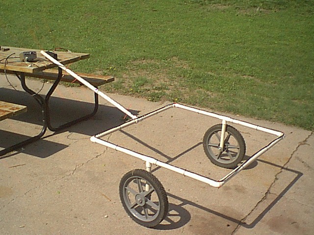

          Any particular reason for placing the coil above the wheels, instead of just below the axles?
            I know I'm losing a foot by having the coil so high. I'm looking at this wheat field. They use "no-till" farming so the stubble is still standing. It goes pretty well in tall grass. I didn't glue the wheel posts, so I can make shorted ones.
