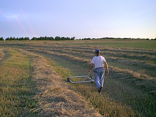

      I've been having too much fun pushing this thing around!! I haven't made any changes to it yet. I want to add some turns to the coil. I did lower the coil a few inches. I can't go much lower, it starts dragging on the vegetation.
      They cut my hay which opened up about 25 acres. The ground is fairly smooth and the hay is cut off about 4" tall. Nice and easy to push. I've been finding quite a few relics.
      Here is something interesting, the smallest thing I have found is part of a bolt. 5/16 dia and 2 1/2 inches long. I'm surprised I got such a strong signal for such a small target. It wasn't but 3" deep. I dug up a piece of sheet metal at about 12". The wrench in the pic was about 9".
      No meteorites yet

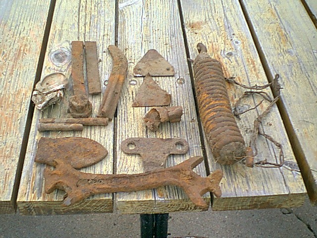

                  I did manage to find some relics in the field. 75 targets total. Quite a bit of can slaw, some nails and bolts, a horseshoe, pieces of farm machinery. And what I think is a small meteorite. I haven't found any hot rocks around here so I don't think its hematite,etc. Its magnetic and has a density of about 4 as near as I can measure. 1.2 g and displaces about .3mL Its density isn't high enough to be a piece of iron. All this in a 200' x 200' section of the field.
