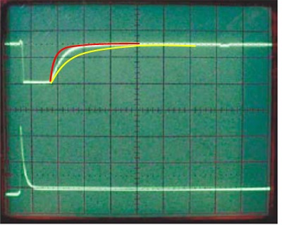

                      • #56
                        Hi Exciter,
                        You are correct if you increase the damping resistor too much the circuit will oscillate. However, if you are careful you can increase the value a little and not have any oscillation. Sometimes, just increasing 50 ohms or less and even as much as 20 ohms makes a big difference. If this resistor is too low in value, it takes too long for the signal to recover and doesn't allow for a short sample time. So, if the resistor is too low of a value, then the signal droops and takes a long time to recover.
                        So, the key is to find the right resistor that lets the signal rise or ramp back up to 0V as fast as possible. This can take some experimenting.
                        For the time being you probably shouldn't change yours, but you will not be able to reduce the delay as much. That is ok if you are hunting relics and coins.
                        If you can find a Philips NE5534A, you will probably see things are a little better. So, this is one way you can improve your PI. You might also try the ON Semi NE5534A also to see which ones seem the best.
                        Just so you will have an idea of what can happen with just a little damping resistor change I have attached a pic of will happen, or can happen. You will see that the original pic has the white trace. The red and yellow traces show what happens if you change the damping resistor. The if you increase the resistance, you should be able to get a pic that looks closer to the red trace. If you lower the value of the damping resistor, the signal will droop more like the yellow trace. If you increase the resistance too much, then you will get the oscillation you mentioned.
                        Ideally, you want to sample when the trace is at or near 0V, so you can see that if the signal rises faster, then it is possible to sample sooner. That is the reason for trying to adjust the damping resistor.
                        However, for the time being, you can leave the damping resistor alone and concentrate on the rest of the PI

                          If you are using a screw-type terminal block for the coil, you can easily swap damping resistors without soldering. I have also used pin sockets for components that I want to swap out. With either, you can also hold the damping resistor in your fingers (without touching the leads) and touch it to the coil wires, while watching the oscope decay. In just a few minutes you can find the right value.
                          - Carl
