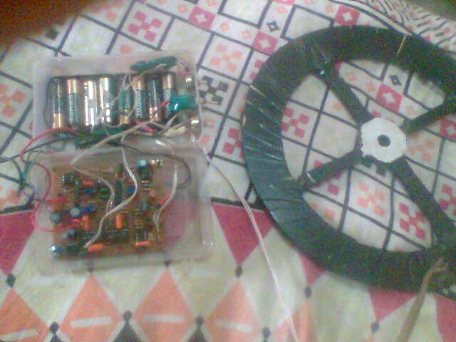

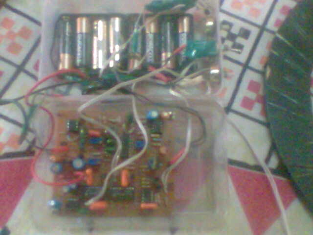

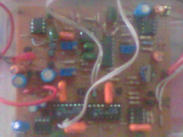

                i built this hammer head im sending some image

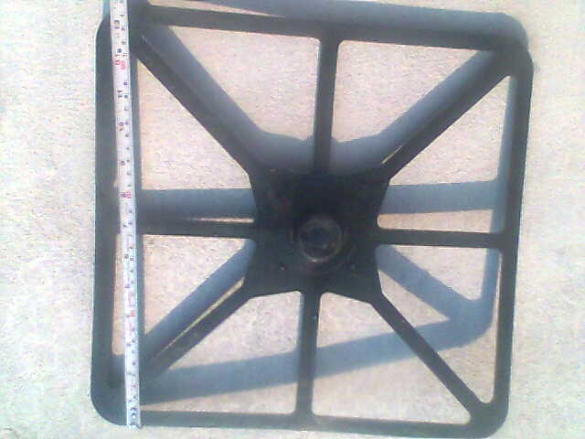

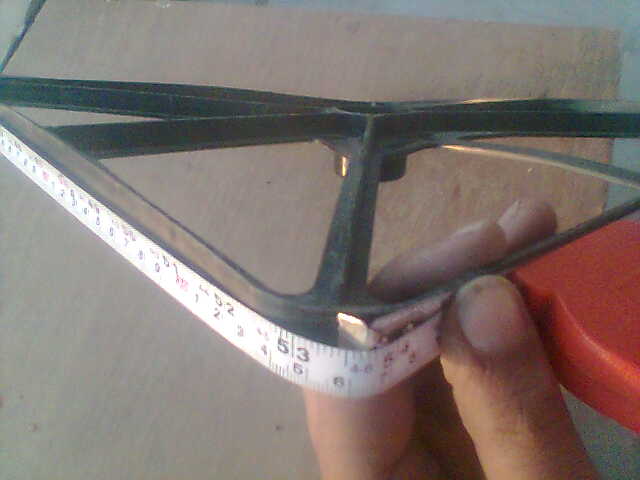

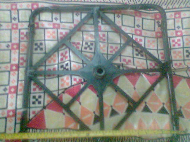

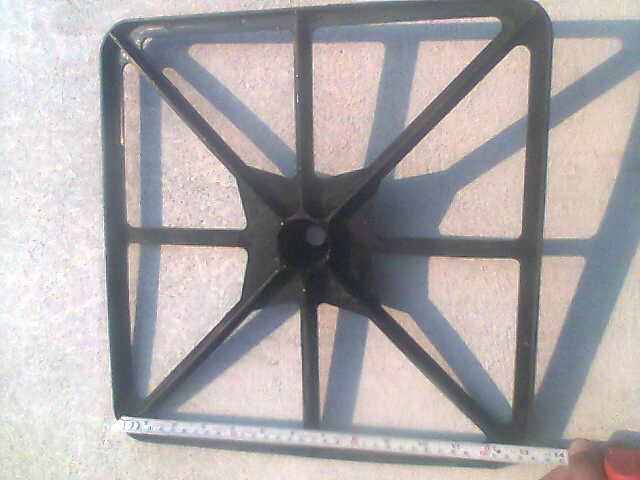

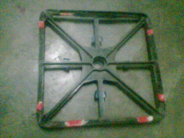

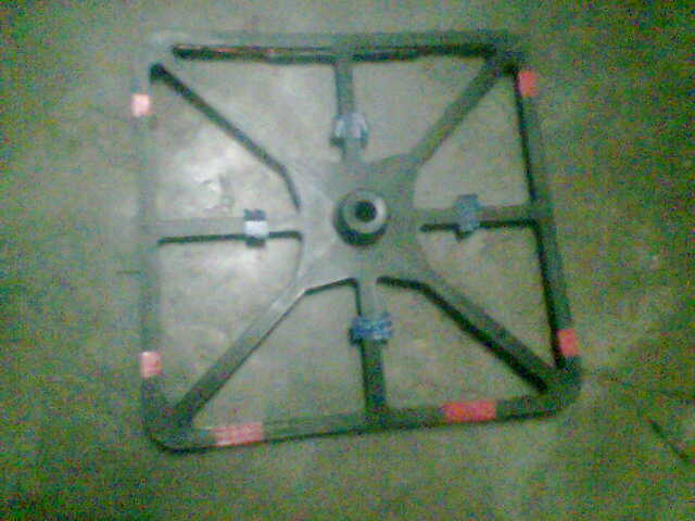

                  hi bbsailor actually im planing to built a medium size object detector no coin shooter. i built a coil 13.5 / 13.5 inch square 26 awg wire 320 uh mono coil inductor calculator calculeted a round coil 10 inch dia meter 68 feet wire i determine 15 turn can you tel me better result
                    hh
                    this is my coil cover i need to knowe how many turn will be 320 uh ..........
                      rajesh
                      15 turns is about right for this coil with a 53.5" perimeter. This is equal to a 17" round coil.

                          hi bbsailor thank in advance i read your article i request to you please tell me a fix value of r3 and r4 for my this coil .......rajesh
