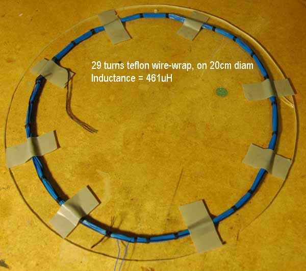

Hi All,

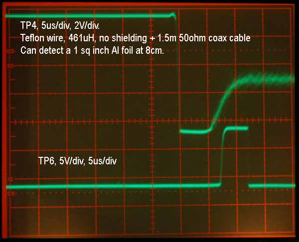

I decided to build a coil using wire-wrap insulated with teflon. The coil has 29 turns on 20cm and an inductance of 461uH. At this stage it doesn't have any shielding. Initially when I connected the new coil I was expecing to see some reduction in the width of the pulse. I was surprised to see that nothing changed! I realised from my previous experiments, that the key to get a narrow width, is to increase the resistance in parallel with the coil as much as possible. At this stage, I have a 1.5 meter coax cable (50 ohm) and the coil. The total resistance in parallel with the coil is 1150 ohm. I got the pleasant surprise to see that my pot R42 is set to the minimum, and I need to bring the pulse at TP6 even closer! I decreased the value of cap C24 to 5.6nF and now I can adjust it very close.
It can detect the 1 inch aluminium foil at around 8cm. The voltage of the flyback pulse was 290V. I increased it to 400V, but it didn't increase the detection of the aluminium foil. There was little difference in the width of the pulse at TP4 by changing the flyback voltage.

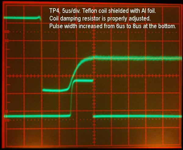

Based on the CRO image, is this defined as a 6us coil or as a 10us coil?
