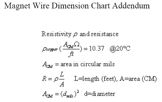

                      The "Magnet Wire Dimension Chart" from Allem Inc is a very useful tool. Starting at 6/0 ending at 60AWG, lists SWG, BWG, MM, in incremental diameter. It's great but it does not include resistance per unit length, so, I made an addendum, showing the basic resistivity formula. With that (and a simple calculator) we can do the math ourselves.
                      http://www.allem.com/wireengr.html
                      Your 6Ω 30AWG coil has got to go. You should use 26AWG or better. For a really good PI coil stranded 18 would be better. Tin plating is preferred for stranded wire because you do not want low resistance between the individual strands. Think about why we'd prefer Litz wire.
                      You are attempting to create a flyback pulse waveform of ZERO duration. I think that zero duration equates to infinite frequency. It's unobtainable, but you get closer to that goal as you minimize coil resistance and coil capacitance.
                      You should also try to find some lower capacitance coax. Try RG6.
                      I may be able to help you with LTspice in the future but I don't feel up to it today. I will entertain specific requests, just don't get impatient.
                      Oh, I edited the equations shown here for better readability. If anybody sees a problem, please let me know.
