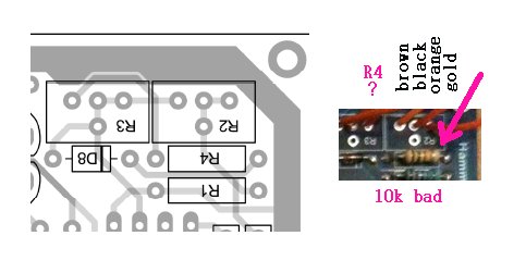

    This is a pic of my pcb.
    this is a pic of my board...
    Do you see anything wrong?

                      Hi, TP1 have the same look as carl's photo, but I think that my frequency is too high.
                      TP2 is really not good...

                        Your picture is fuzzy, and between your camera and my PC the color rendering is not accurate, but in your photo, R4 looks like 10kΩ, 5% (brown black orange gold). It should be 1.5k. A 10k resistor would cause pulse-width to be wider than normal.
                        Also check R1. The picture is so fuzzy that I don't want to hazard a guess what those color bands are but don't like what I see. Should be 56kΩ or ther'bouts.
                        If either or both resistors are wrong it could make your power consumption skyrocket.
                        Like I said, color rendering is imperfect so I can't tell for sure. I'm just calling it the way it looks.

                          I've verified R1 and R4 but they are ok.
