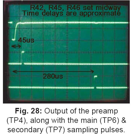

Hi, good news!
Now my IRF740 is cold, and my pcb is stable.
I replaced both 74HC221, and I think that one was not working good.
But I still have a problem... My HH only detects Medium to large Iron items.
I have nothing for a 30x4 cms alu part. It's the same for a coin.
Somebody have an Idea of my new problem?
please!!!
please!!!
