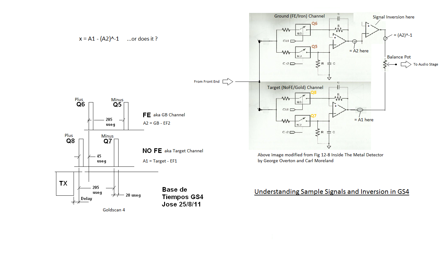

          Hello Carl,
          I'm looking at ground balance on the goldscan IV, which appears at first sight very similar to what you have described above. I'm having a difficulty (not uncommon for me) in understanding the way the GB channel aka Iron channel value is inverted before being fed to the balance pot connecting to the output of both channels.
          A1 = Target - EF1
          A2 = GB signal - EF2, but becomes (GB -EF2)^-1, as it is fed through an additional inverting opamp with no gain.
          So in this instance, x = A1 - (A2)^-1
          Or have I got it wrong ? I have attached an image to try show what I see ?
          • #50
            The "inversion" stage doesn't invert as in x^-1, rather it makes it negative so the output at the pot is a subtraction instead of addition.

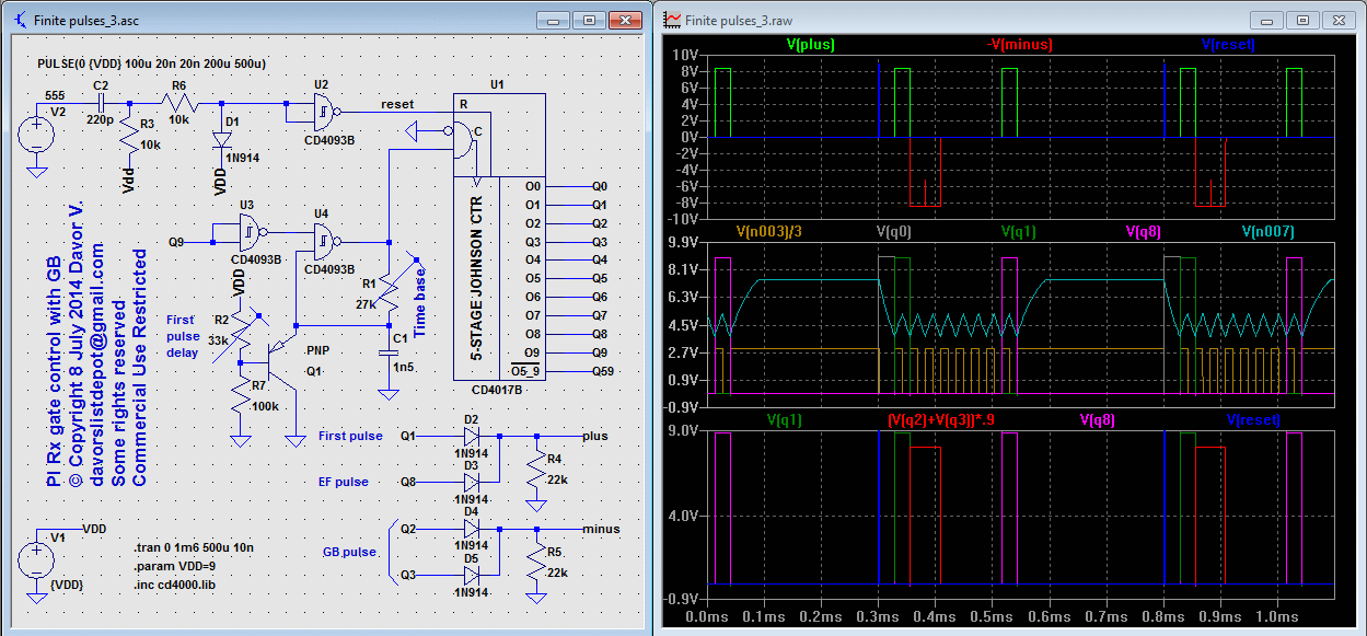

              As mentioned before, here is the solution with independent initial delay and the time base, by virtue of a clamp. Also is attached a LTspice project folder in a zip file.
              For the time being I'm only concerned about GB for minipulse. This is not tested, but math says it should work. There is no practical reason why this approach would fail on other devices.
              The math also implies a way of removing the problem of a "hole" in response typical to the PI machines with GB. It is only slightly more complicated. With increased number of samples in a geometric series duration and alternating polarity, the hole-less range of useful tau targets vs. sample duration becomes larger, and without harmful influence on target response. That would be point-on with Aziz' FFT solution, but to realise this one should go a bit deeper into FFT theory. In a way it truly is a WBGB system as he often advertised. Too bad he got banned.

                Cheers Carl,
                I guessed I made a fundamental error. By using the expression (^-1), was trying to show the inverting opamp would multiply by a negative to what ever it sees on its input.
                As a rule, what is coming out of the differential integrator (iron), before hitting the inverting opamp is a positive value ? As simple as that ? I complicated everything by assuming too much.
                How could I translate the formula to use a single channel (with differential integrator at the front ), but continue to be able to exploit the means to see or balance to different metals like the original does ? Is it possible ?

                      Cheers Carl,
                      As a rule, in a simple PI everything (ferrous, nonferrous, salt, ground) responds with a positive value. The difference is the curvature of the response (1/t vs exp) and the time constant of the exponential response.
                      A 2-sample subtractive GB can be adjusted to exactly cancel ground, but that setting will also exactly cancel a particular exponential tau. If you take 3 samples then you can exactly cancel a 1/t response but not cancel any exponential taus because they have a different curvature. Regardless of the method, subtractive GB on the decay always reduces target depth.
                      You can use a single differential integrator by appropriately sampling on the inverting and non-inverting sides and adjusting either the gains or the sample widths. You can also do all this with a non-differential integrator by running some of the sample switches off an inverted preamp signal.

                            Good work Davor, where do you plug it into the mini pulse ?
                            • #59
                              At the FETs gates. Timing circuit must be powered with 0 and -5V for FETs to work properly, same as originaly in minipulse.
                              I'm considering scribbling an overview of ground balance with this approach in mind.
