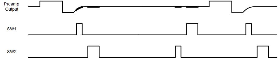

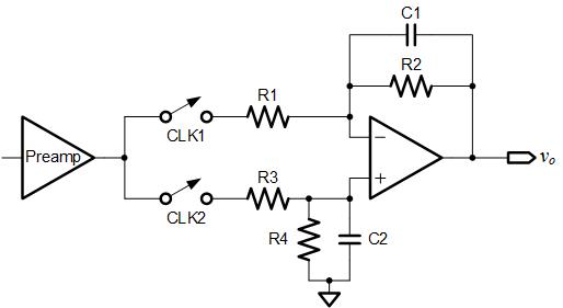

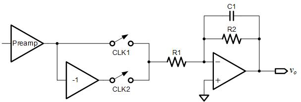

                  OK, I found my round tooit so here are a few drawings to clarify. First, in a common non-GB PI (Hammerhead, SurfPI, etc) we often see the differential integrator:

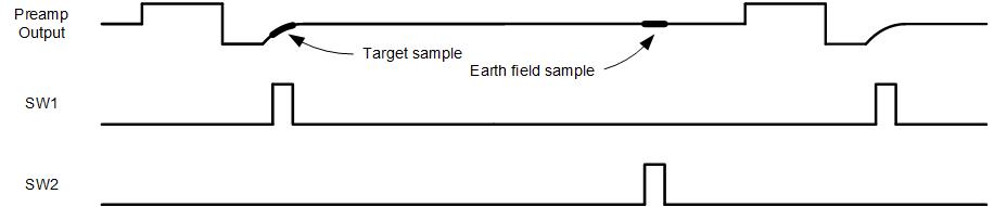

                  Most of these designs have a target sample and an Earth-field sample:
                  The differential nature of the integrator subtracts the Earth field from the target signal. For best results you want good matching between the time constants, which usually means getting well-matched caps.
                  You can do the same thing with a non-diff integrator:
                  Now both samples use the same time constant. The gain of -1 is pretty easy to make sufficiently accurate. Timing is the same as above.

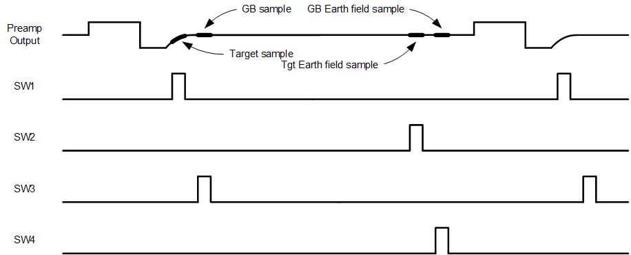

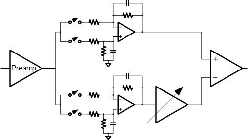

                  When we implement subtractive GB we normally sample shortly after the target, amplify the GB sample, and subtract from the target sample. This is usually done with a completely separate channel and its gain is the GB control. Again, matching the taus is critically important, and if the target sample has an Earth-field subtraction then so must the GB sample:
                  Timing is now:
                  Subtractive GB does not require diff integrators, you could use the non-diff integrator above for each channel (target & GB). You also don't have to use a variable gain stage. Instead, sample the ground with a variable sample width and now the width is the GB control. And since the ground channel no longer needs a different gain, there is no longer any need for a separate channel... you can do everything in the single non-diff integrator channel above using this timing:

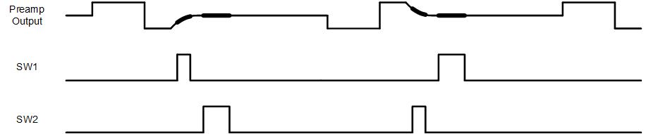

                  Finally, I've mentioned before the benefits of bipolar pulsing, namely getting rid of the Earth-field samples:
                  This potentially allows for much faster pulse rates.

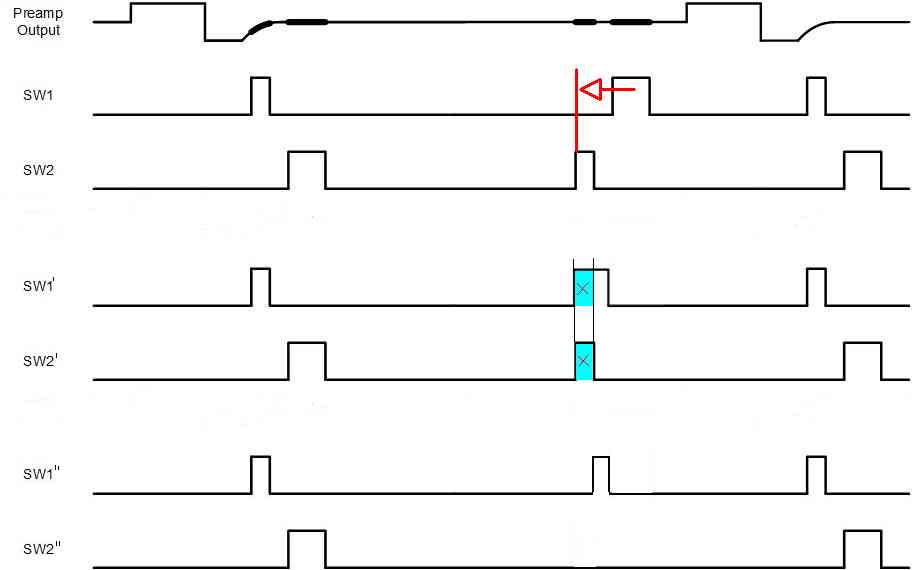

                          I may have an addendum to this one:
                          [ATTACH]30591[/ATTACH]
                          You can also overlap Target and GB channels' EF samples, and notice that in a case of equal gain in positive and negative subchannel thea cancel each other while they overlap.So instead you may also use a single shorter EF to the same effect. That's basically what the scheme I proposed earlier would do, and the arithmetic is simple as all the samples are quantised.
                          • #73
                            Yep, that's true, and pretty easy to do when you use PWM for the GB sample instead of variable gain. When you move to a 3-sample GB scheme this makes even more sense.
