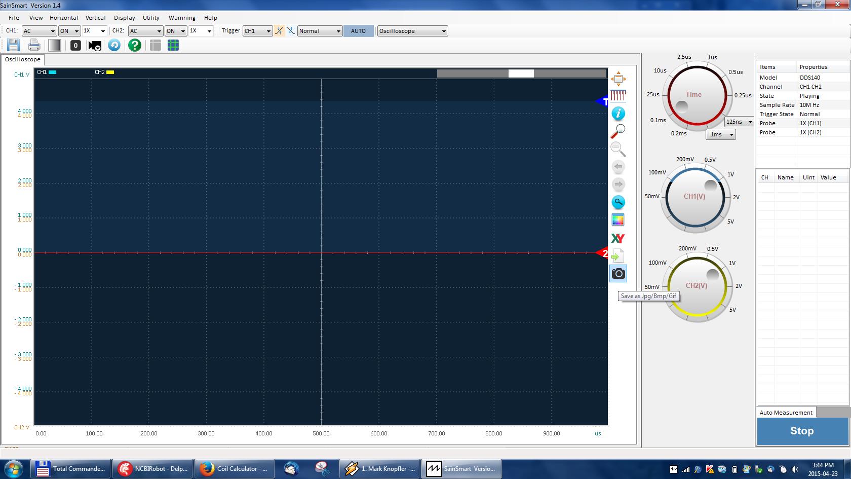

    Step 4
    The voltage on coil is about 40V. The coil is 52 turns, 23 cm diameter. If I am not wrong this should be 400uH.
    I have a weak high pitch sound in phones when I put them 15-20 cm to coil.
    Oscilloscope image:

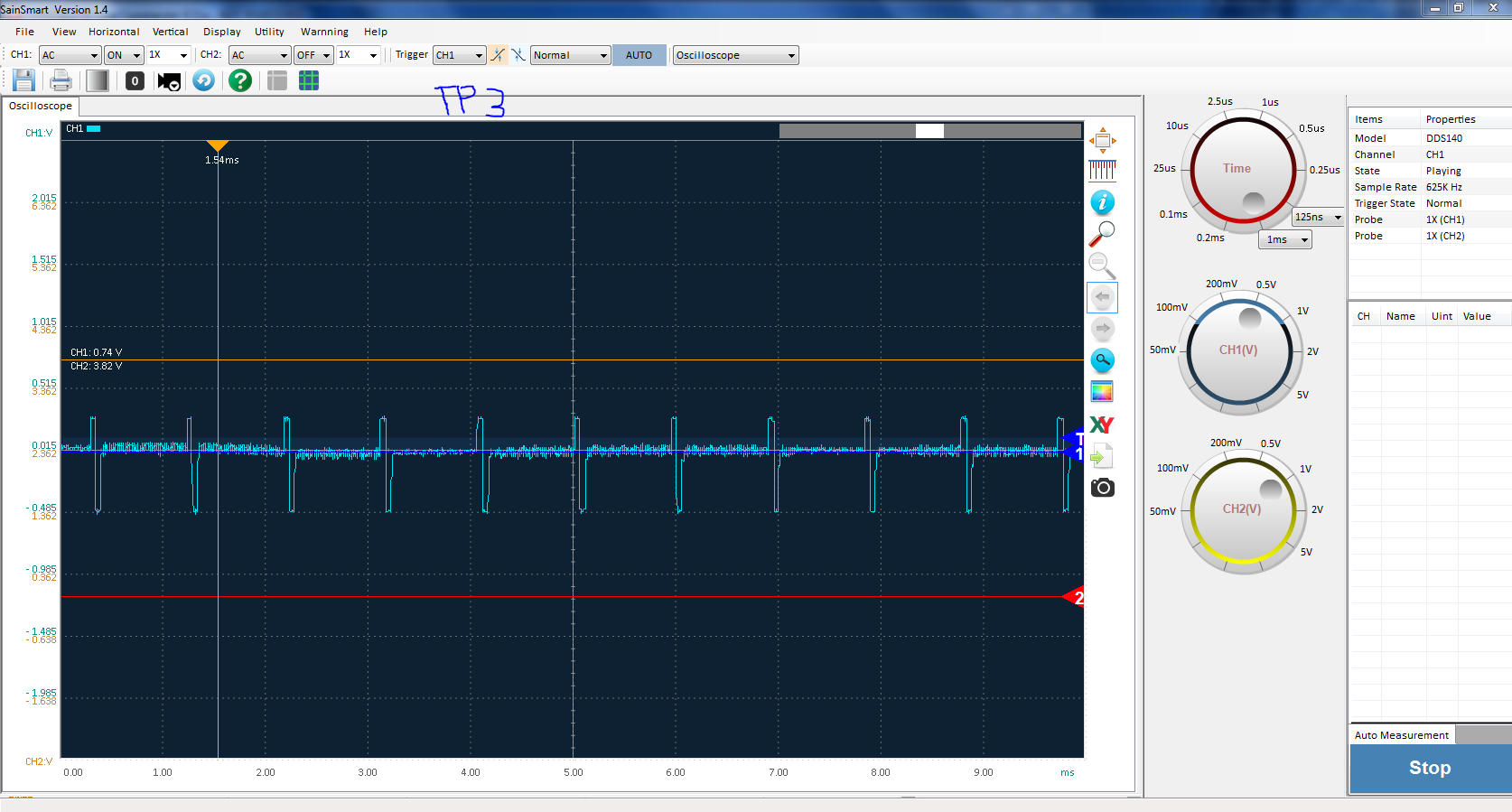

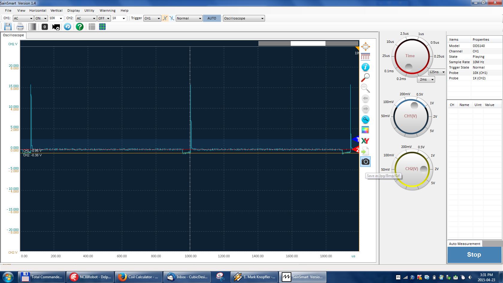

    The voltage here is not DC, as shown by my oscilloscope.
    HOWEVER, when I measure the voltage with a multimeter on TP3 (with the other multimeter wire connected to TP10), I have 3.6V, dropping to 3.1V when I put a pot top (thin stainless steel - 15cm diameter) near it.
    (Sorry, I don't drink cola so I don't have a cola can - but I will buy one - I haven't done it in years).
    Oscilloscope image:
Name:	step 5 tp3.PNG

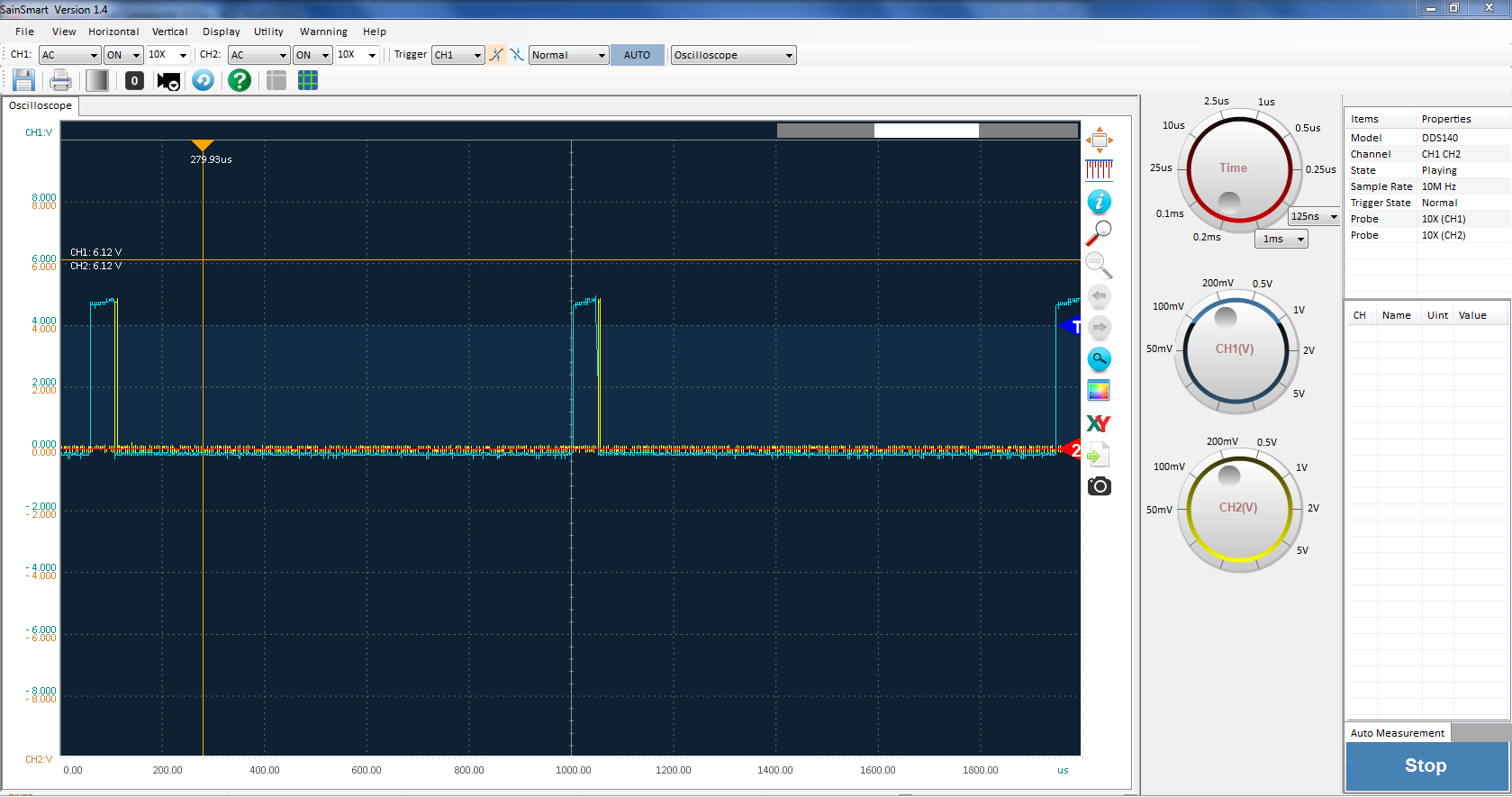

    Step 6
    No matter how much I turn R6 (100K trimmer) I cannot change the sample delay. The main sample starts always immediately after the TX pulse. Adjusting R6 only makes the main sample wider.
Name:	step 6 tp5.PNG

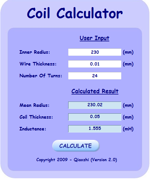

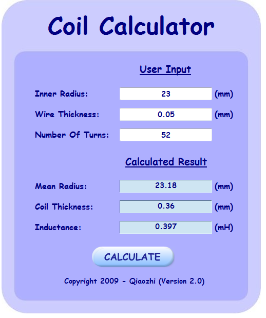

    52 turns is far too many for a 23cm diameter coil. This will give an inductance value of around 1.69mH.
    Please use the Coil Calculator here -> Coil Calculator
    For 400uH, you will need 24 turns.
      Thanks Qiaozhi for such a quick answer!
      I used exactly that calculator.
      Index.html doesn't work (the calculator doesn't load properly) so I used coilcalc.html
      I have no clue about the thickness of the wire I use so I put 0.05mm. It seems a decent value. I will measure it as soon as I will get a micrometer.
      I took the wire from the a coil located on the cathodic tube of a monitor. You know... those 2 red deflection coils with strange shape and big ferrite core that make together a cylinder.
      Now I re-downloaded the program you linked too and this is what I see for the number of turns (24) you gave me:
Name:	coil calculated.PNG
      So, for the same input numbers it gives me a different result.
      (Please see the inline image and ignore the attached image which is wrong).
        Are you trying to build Minipulse pinpointer?
        Or you have problem with metric values?
        Namely you calculate almost micro-coil.
        There are set millimeters (mm) in calculator form.
        Probably should be centimeters (cm).
        Par example 23cm = 230mm (not 23mm).

          For:
          Wire diameter: 0.45mm (is this thick enough?)
          Coil diameter: 230mm
          Turns: 16
          I get inductance of: 0.42mH.
            You are supposed to launch the calculator using coilcalc.htm
            It does actually state that in the Coil Calculator thread
            0.05mm is only 50um thickness, so I doubt that is correct.
            It's more likely to be something like 0.56mm.
            [ATTACH]32802[/ATTACH]
            You've made two mistakes here. As WM6 pointed out, the first field is in millimetres, not centimetres.
            And ... this is the value of the radius of the coil, not the diameter.
            The value you should enter is 115mm.
              WM6 sorry for uploading the wrong image. I updated the correct image.
              [ATTACH]32803[/ATTACH]
              For:
              Turns: 16
              __________
              Update:
              Now I know the diameter of my wire. About 0.45mm
              I am going to test the new coil.
              Try entering the correct values:
              Inner Radius = 115mm
              Wire Thickness = 0.45mm
              Number of Turns = 24
              The answer should be: Inductance = 0.407mH (i.e. L = 407uH)

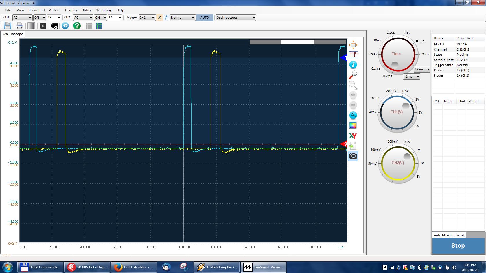

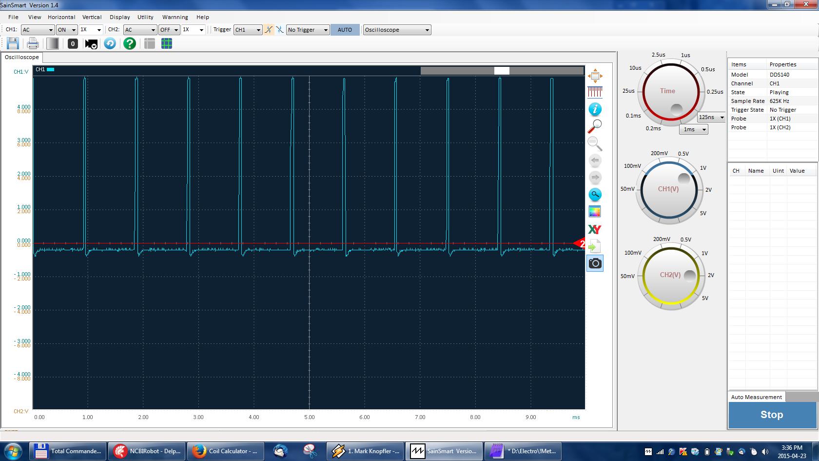

                    still not working
                    I built the proper coil (I really screw up the calculation of the first one).
                    The parameters have improved now but still not OK.
                    For example:
                    TP1:
                    Frequency: 93ms (instead of 100mS)
                    Pulse width: 48uS (instead of 58uS)
Name:	step 3   tp1.jpg
                    TP3:
                    1.5v drops below 1v for a 15cm steel pot top
                    Voltage on coil is now 150V. Much better but still not 350V.
Name:	step 4 voltage on coil.jpg

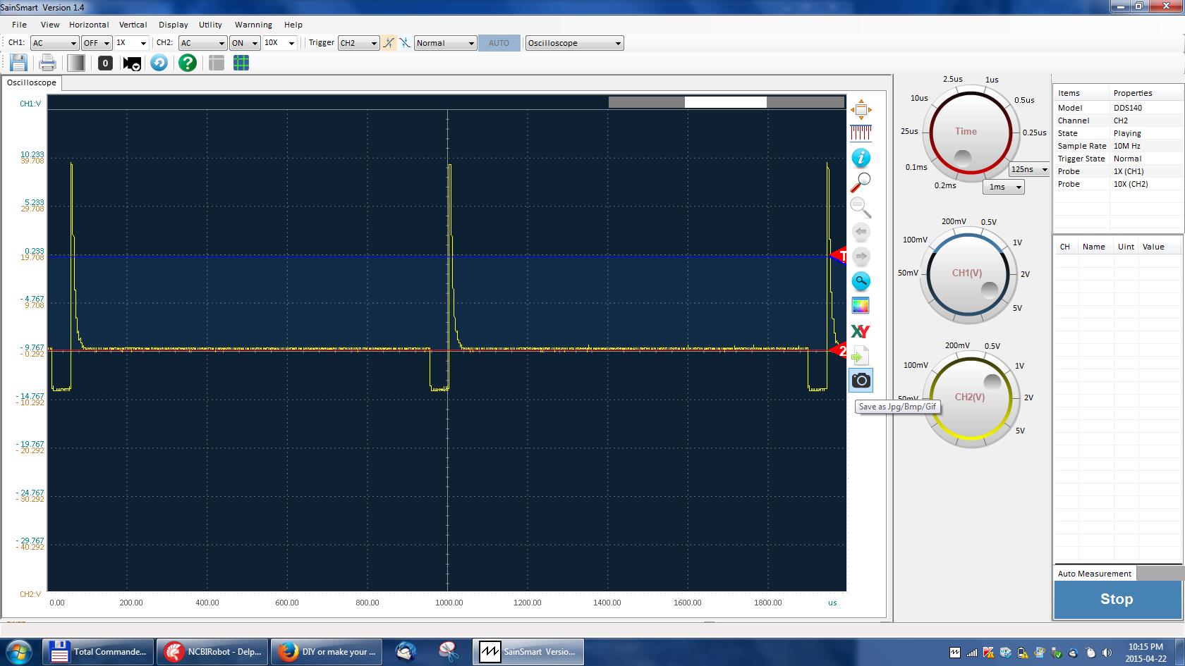

                    And most importantly I still cannot change the sample delay in step 6:
Name:	step 6    tp1 + 5.jpg
Name:	step 6    tp1 + 8.jpg
                    Please I still need help.
