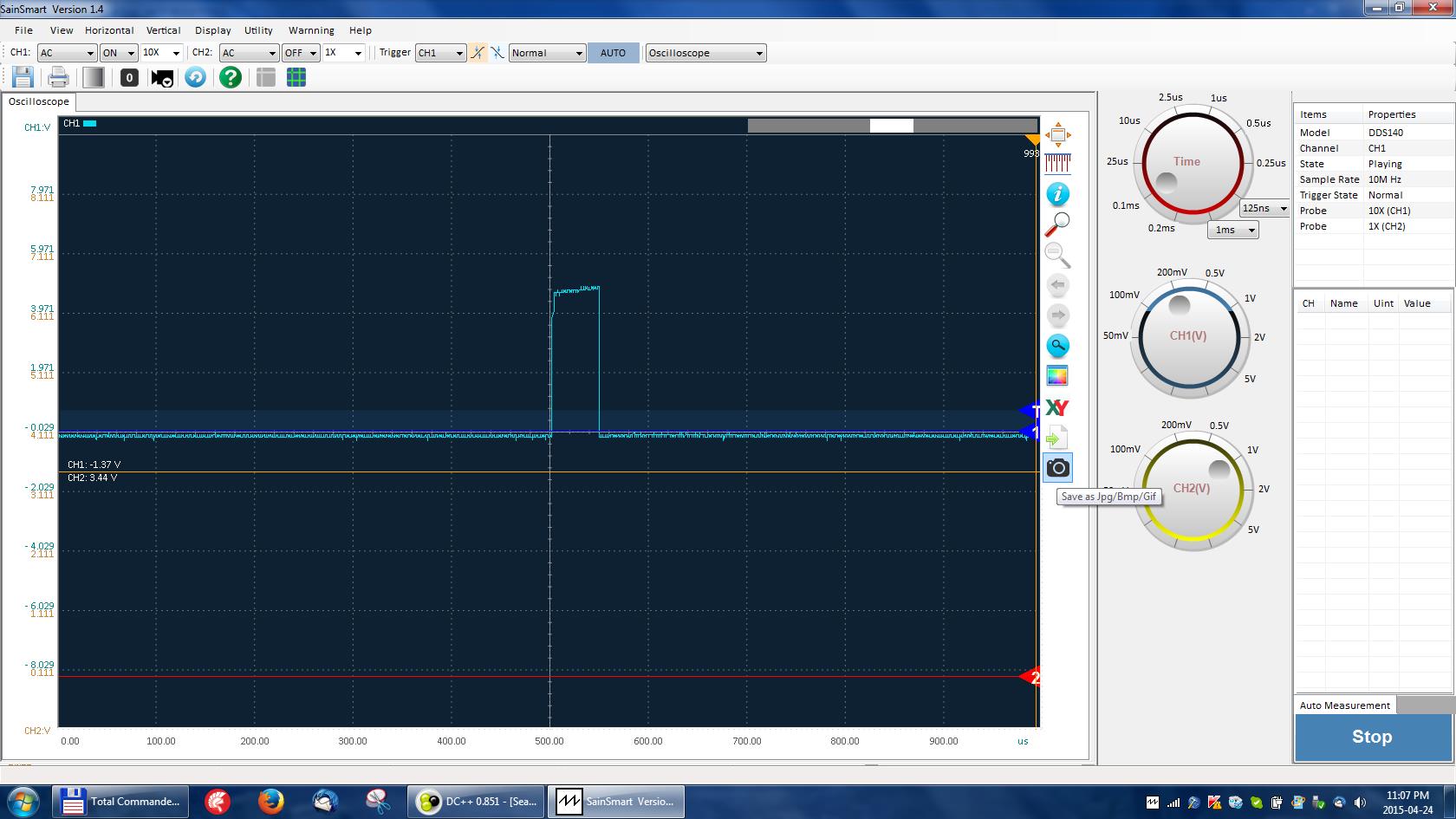

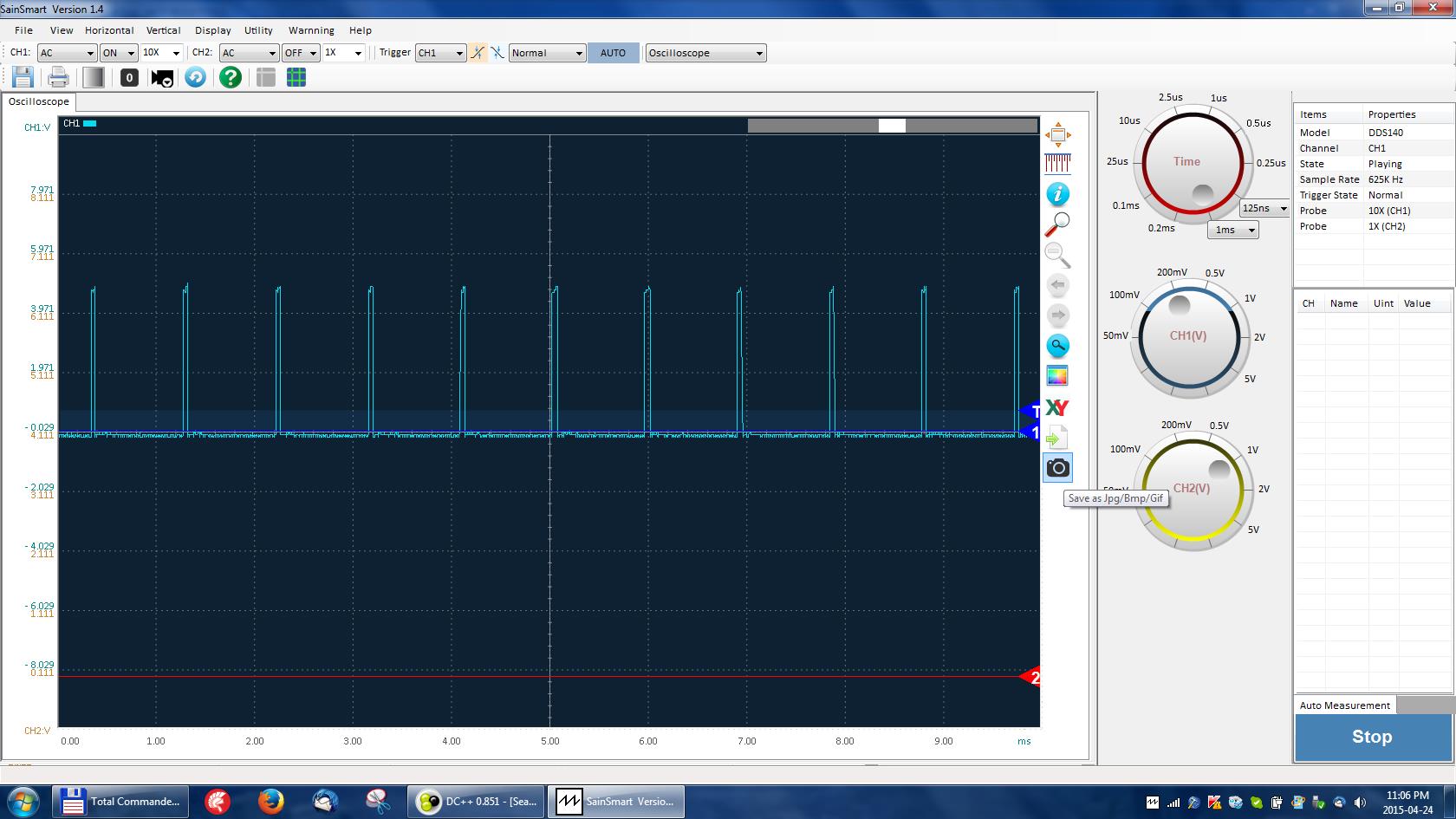

      TP1:
      Frequency: 0.93ms (instead of 1mS)
      Pulse width: 49uS (instead of 58uS)
Name:	step 3 - 950us.jpg
Name:	step 3 width 49us.jpg
      TP3:
      1.5v drops below 1v for a 15cm steel pot top

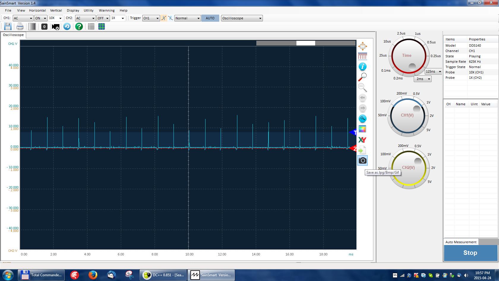

      Voltage on coil is now 160V.
Name:	step 4 voltage on coil.jpg

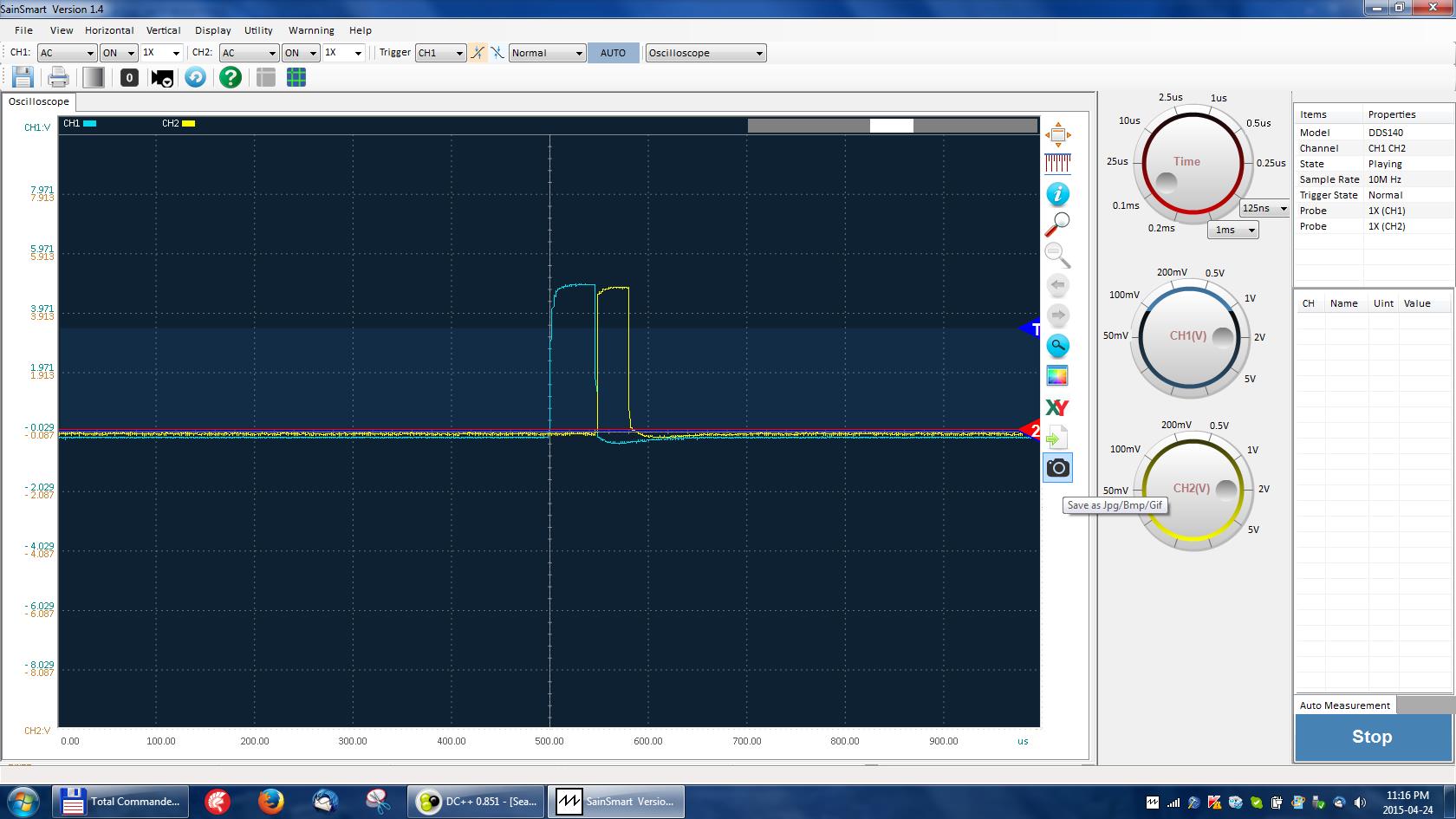

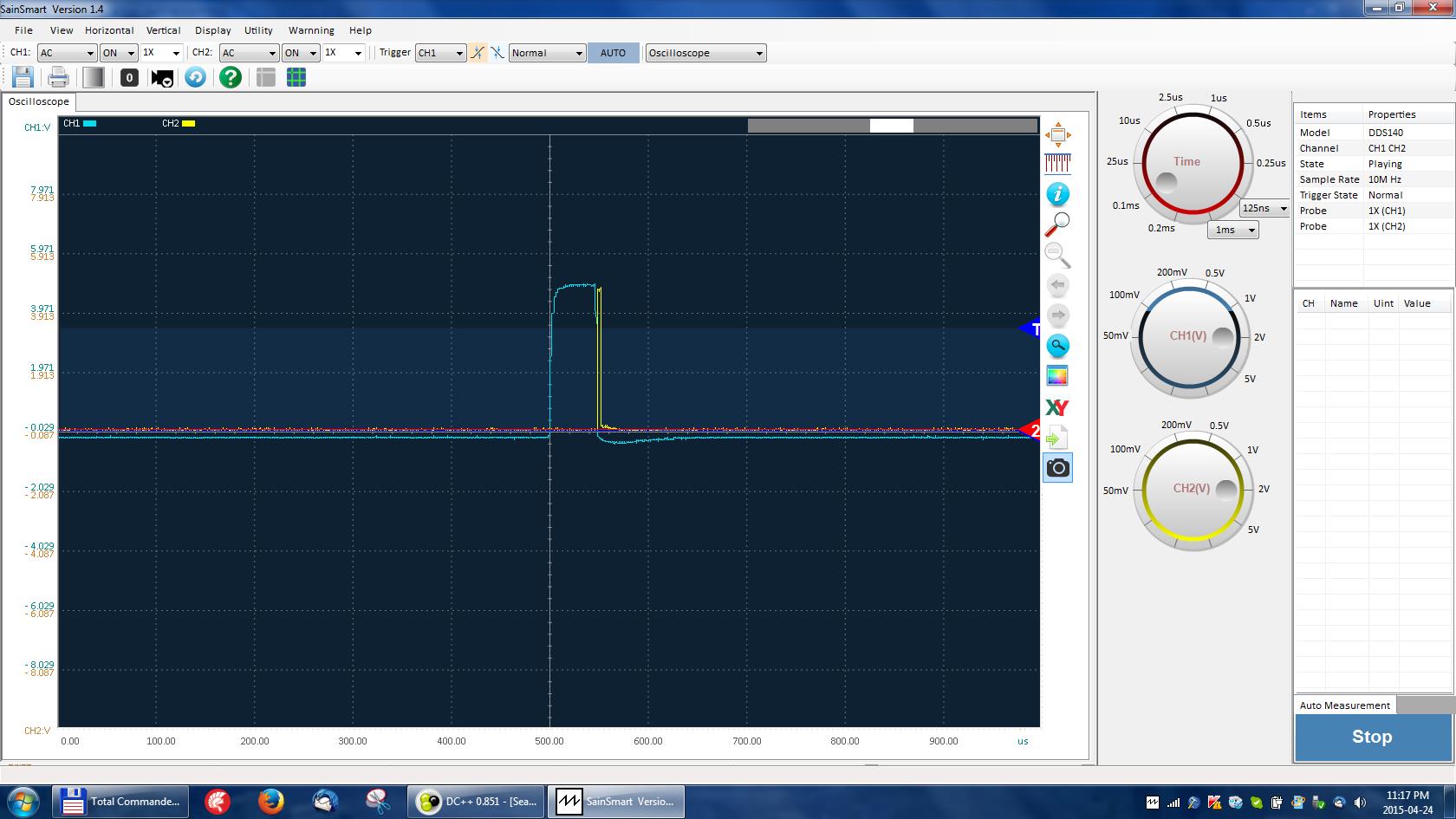

      Step 6:
      I still cannot adjust the distance between TX and main sample. This is the wave form with the trimmer at min and at max:
Name:	step6 cu trimmerul la min.jpg
Name:	step6 cu trimmerul la max.jpg
        The flyback voltage level is most likely not being displayed correctly by your PC scope due to lack of bandwidth. Clearly there has already been an improvement from 40V to 160V by switching over to a battery pack, so I would ignore that as a potential problem. Since the TX pulse width is also lower than expected, the accuracy of your scope measurements appear to be suspect.
        As far as the main sample delay is concerned, this is working correctly. TP5 should show a pulse that changes in width as you adjust R6, The main sample pulse can be monitored on TP7. When you adjust R6, the pulse position (relative to the TX pulse) will change. Have a look at Fig. 10 in the Build Document.
          My oscilloscope is SainSmart DDS140. Bandwidth 40MHz. 78euros.
          Small correction. The voltage on coil was 40V because I had the wrong coil. After installing the correct coil the voltage increased to 160V.
          After switching from transformer to battery pack nothing changed.
          I GOT IT NOW!!! I followed the manual (build document) EXACTLY and this caused the problem. The manual says that I should monitor TP1 and TP5 and (without mentioning TP7) I should adjust R6 until I get the right delay. But the delay is measured on TP7 (which again is not mentioned in that paragraph.
          Monitor the TX oscillator at TP1 using an oscilloscope (channel 1), and TP5 (channel 2). Trigger off channel 1. Short pin2 of PL3 to either pin 1 or pin 3, and adjust R6 for a minimum sample delay of 22us.
          You may want to adjust or rephrase this in the manual for other novices like me
          Thanks for clarifying this. I think I am on the correct track again! Thank again!!!!!!!!!!!!!!!!!!!!!!

            The main sample delay is measured at TP5, whereas the main sample pulse width is measured at TP7.
            Perhaps you're not used to the PI terminology, but the Build Document is correct.
            I wouldn't be too concerned about the flyback voltage, as your mileage may vary depending the coil construction.
            Glad to hear that you're now back on track.
              Ok, now I am confused.
              So, if I hook the oscilloscope at TP1 and TP5 and adjust the R6, I should be able to change the delay between the two signals I see on screen. Right???
              But when I adjust R6 I see no change in the delay between the signals!
              (I am speaking strictly about TP1-TP5 here.)
              This is what I was showing in my previous screenshots: as I adjust R6, the yellow signal (at TP5) changes its WIDTH but NOT its DELAY (distance to blue/TP1) signal:
              What I don't understand?
              Where am I wrong?
              Well, it might be that I am using the oscilloscope wrong (I used an oscilloscope 15 years ago. I purchased this one 1 week ago especially for this project).
              The trigger is set to channel 1 (blue).
              But anyway, if you say that what we see in the screenshots is right and I can proceed to Step8, I will do so. You are the guru here.
                Just remember that TP5 is just the clock input for U6b and U7a. TP5 does not show the delay in reference to the TX pulse /main clock pulse. The width of the pulse at TP5 is the delay. Varying R6 will alter the width of the pulse at TP5 therein varying the delay. Have a look at the circuit and see where TP5 is located and you will see what I mean.

                    dotniet does not have a problem with his MPP. It is working correctly. Your issue is being caused by a either a component failure, an unintended short, or perhaps a wiring error.
                    CAS has already explained how the timing generators work, but I will reiterate here:
                    The MC14538BCP ICs are monostable multivibrators, which are used to generate a single pulse of a defined width when a negative-going pulse is applied to the CLK~ (B) input. U6a is triggered by the TX oscillator so that, when the MOSFET is turned off, a pulse is generated at the Q output of U6a with a width that can be set by adjusting R6 (minimum sample delay) and the REJECT pot (when fitted) to set the sample delay when in use. This is the main sample delay (TP5). This signal is then fed into the CLK~ (B) input of U7a, which triggers the monostable on its negative-going edge to produce another [delayed] pulse at TP7. This is the actual main sample pulse, which has been delayed by the preceding pulse at TP5.
                    The main sample delay pulse (TP5) is also fed into U6b, which generates the secondary sample delay (set by R10 and C10), and can be monitored at TP6. This pulse triggers U7b to generate the secondary delay pulse. The components C11 and R11 set both the main and secondary pulse widths to the same value, with the help of D7 and D4. This is because the main and secondary pulse widths must be the same width for effective Earth Field cancellation to occur.
                    This is all shown very clearly in Fig. 10 on page 15.

                      In the end I figured out a different way to measure all the signals: I measured one signal relative to the previous one. More exactly main sample to TX signal and second sample to main sample.
