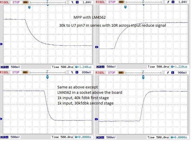

              Put the LM4562 in a socket above the board to isolate the board. Appears board capacitance is slowing response. Step time to flat close to calculated(40/55e6=.73us)
              MPP rev D

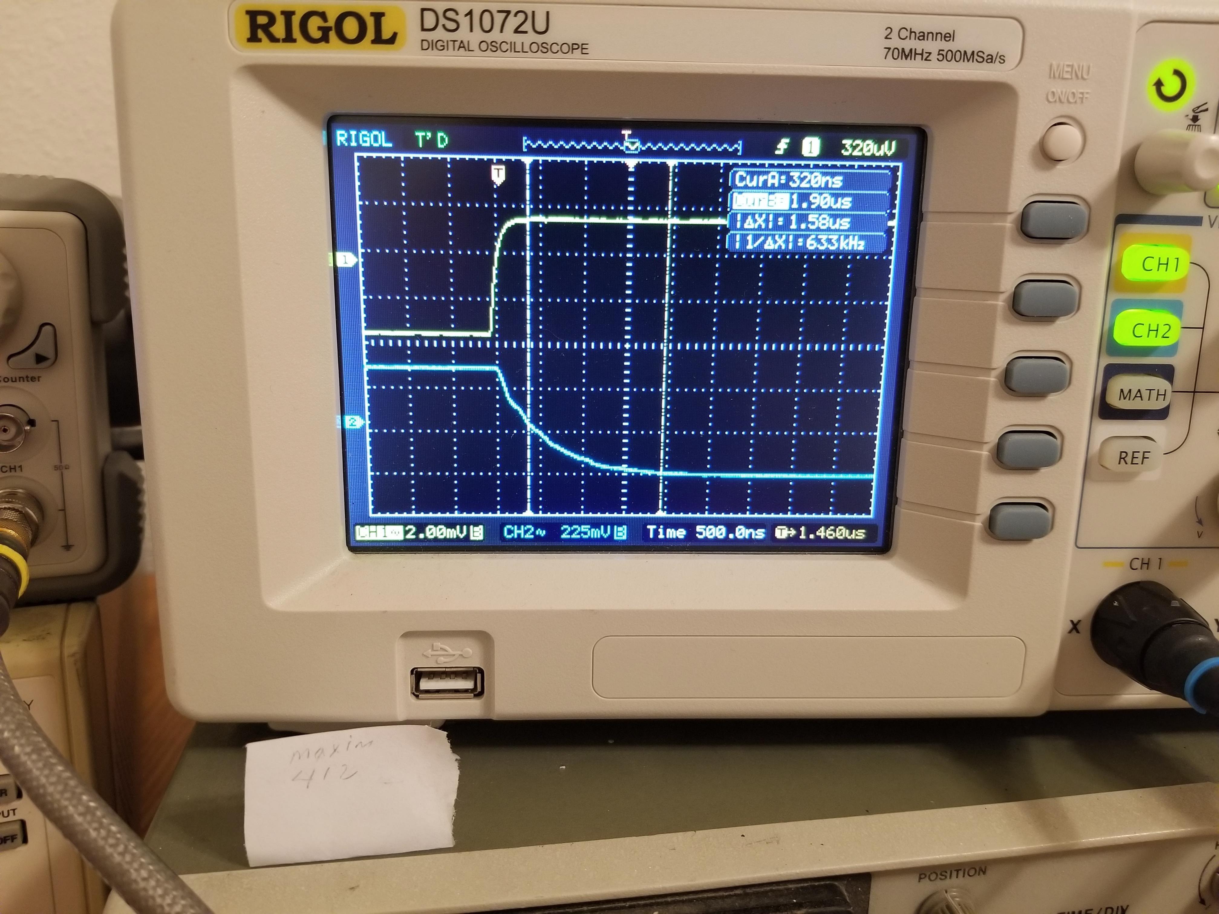

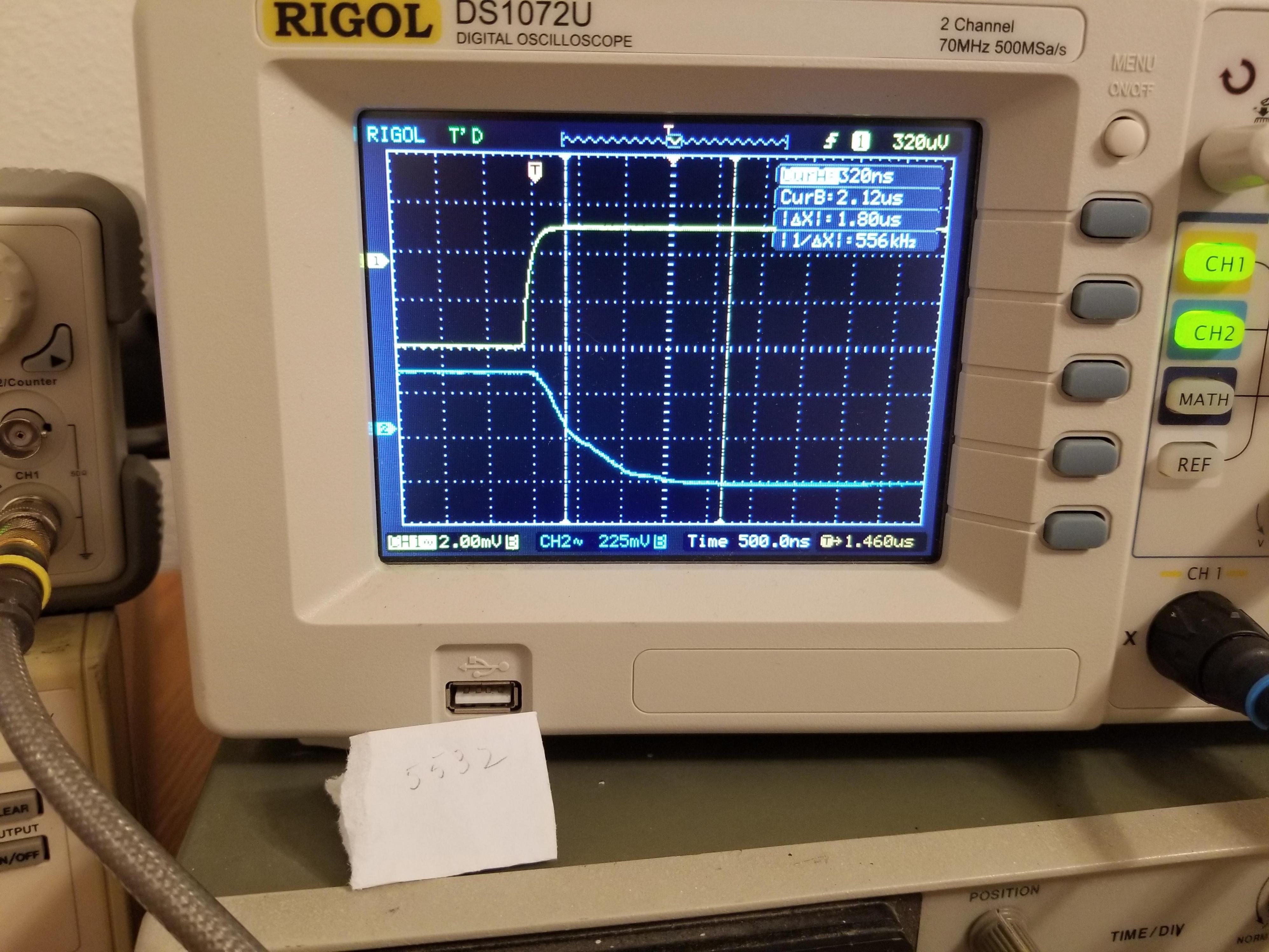

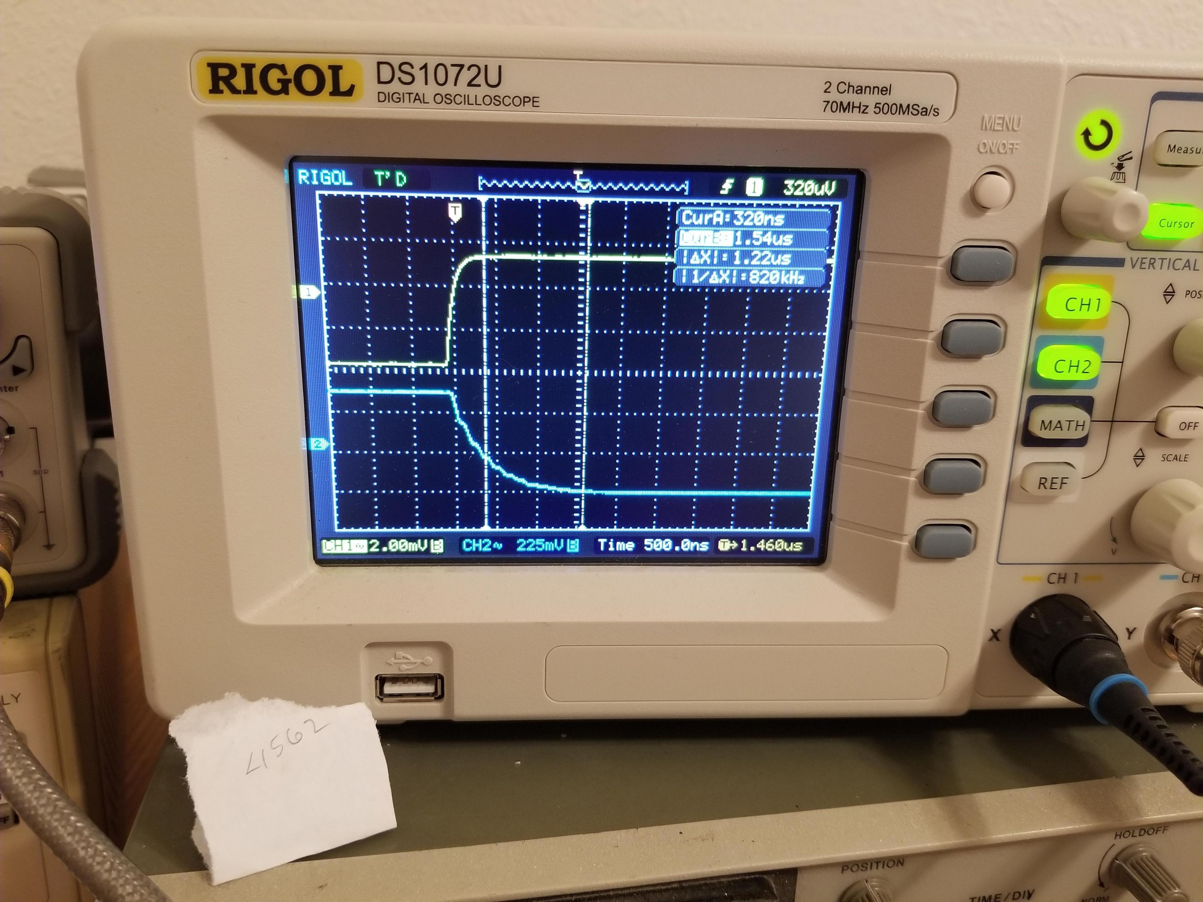

                Hi Green,
                Thanks for posting the spice simulation.
                In your last post the top scope shot.
                I was having problem with a very large curve as well, for me it was connection problems from my breadboard and scope probes.
                I was able get my voltage divider problem figured out it was a bad scope probe really strange behavior.
                I tested with 10khz square wave using the set up in your post #70.
                I tested 3 amps with the same set up only changing the b cursor for measurement.
                The yellow channel is the genny in. Its 320ns before flat. The cursors are set between where both signals o out after that.
                The frequency on the cursor scale is wrong it was all done at 10khz
                Lm4562

                1.54 us to flat
                1.22Us lag
                5532
                2.12us t flat
                1.80 us lag
                Max412
                1.90us to flat
                1.58us lag
                looks like you may have it figured out but let me know if I'm missing something or another way you would like to see me try to set up.

                    Thanks for the test. I get about 4divisions, 2us to flat for each of your amplifiers. I would start time when it first starts changing. Appears faster amplifier doesn't help, still fast enough for most targets. My only question, is circuit card capacitance causing the longer decay time or something else?

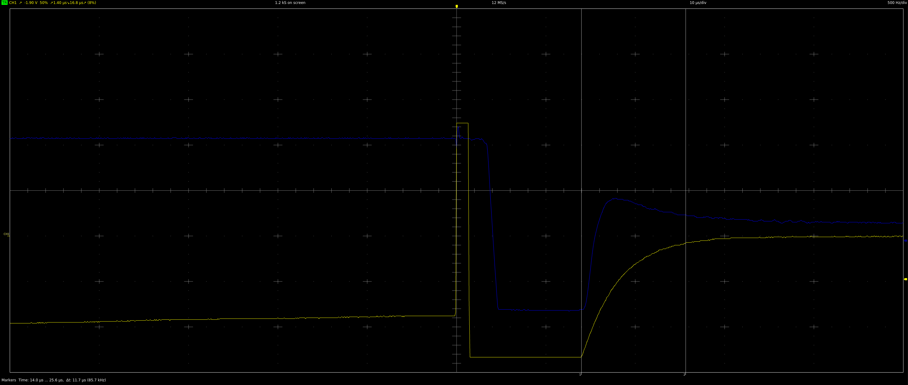

                            Hi All,
                            I have scop'ed the preamp in (pin 2, yellow) to output (pin 1 blue) and notice quite a bit of distortion in the signal, especially overshoot (this is with NE5532)
                            See attached image ... will a faster opamp fix this?

                              The overshoot could be the result of capacitive loading on the output pin. Or it could be the front end doesn't like the coil. The noise looks minimal.
                              • #90
                                I'm not sure what you think is wrong, or what you mean by distortion. A little bit of overshoot usually indicates slight underdamping and that's where you want to be.
