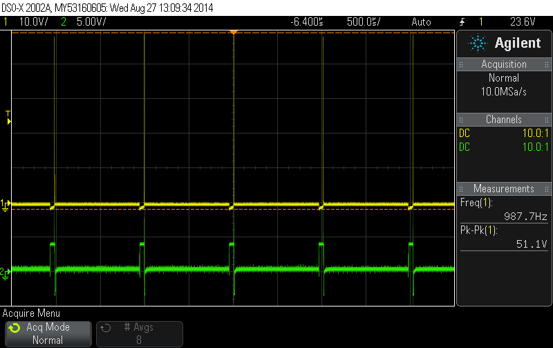

    Thank you Chet,
    Excellent, got home from work and tried it at 0.2ms/time div and it ends up approx. 4.5 divisions between the pulses so a resistor change may be in order to up the freq pps to get closer to the 1000hz/1000pps.
    Other than that it looks like its close to spec so may move on to step 5, I'll jump over to KRinAZ's thread and see what if any changes/mods were made to this portion
    of the circuit to get it closer to build doc spec.

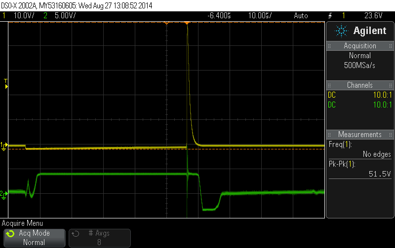

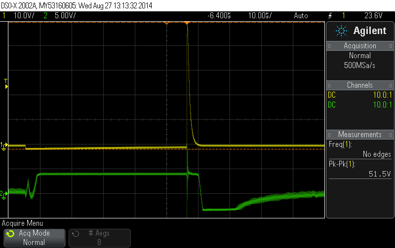

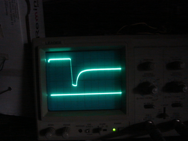

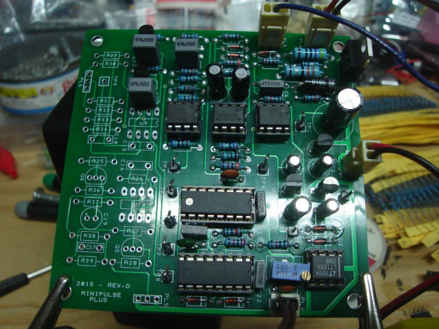

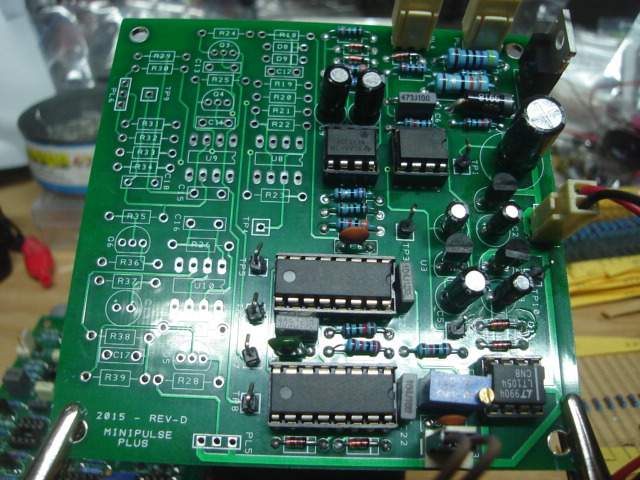

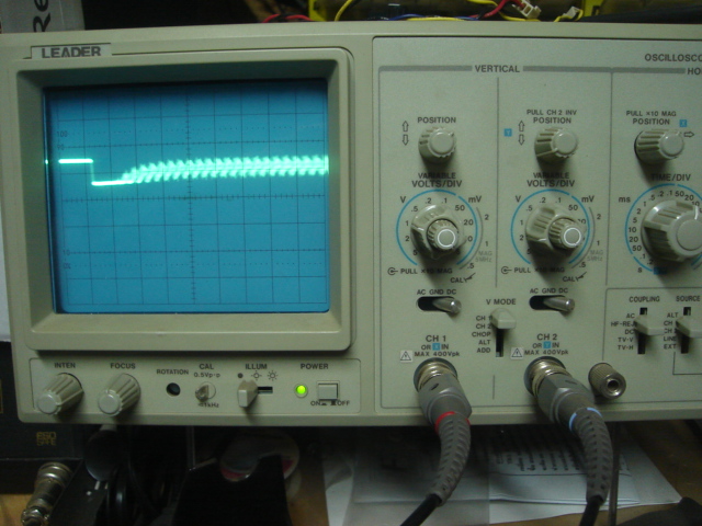

      Step 5 - RX pre-amp

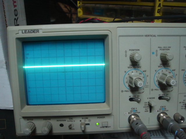

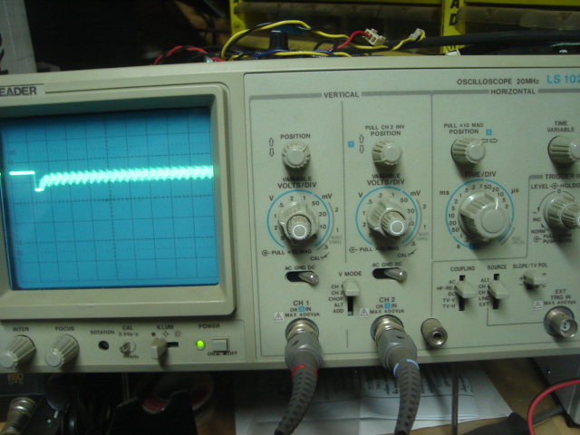

      Step 5 RX pre-amp components installed, tested tp3 using scope channel 1 set to 1v/div at 50us/time div. Soda can makes a nice smooth low voltage change to wave form.

      Good to go on to step 6....
        Be carefull when you get to step 6 the wording is talking about the width of the pulse, which gives the delay.

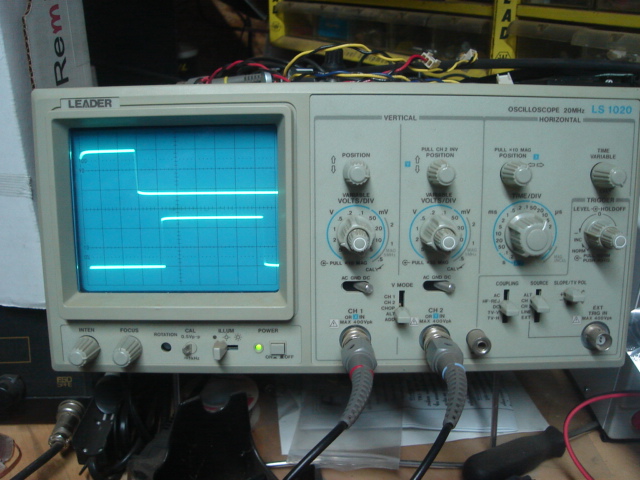

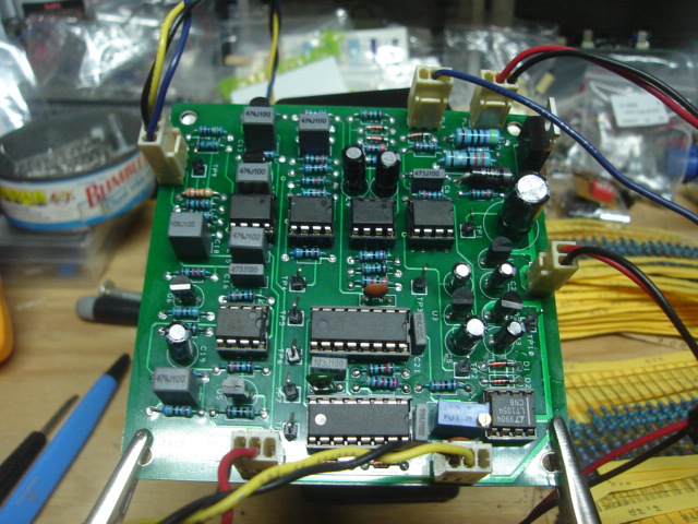

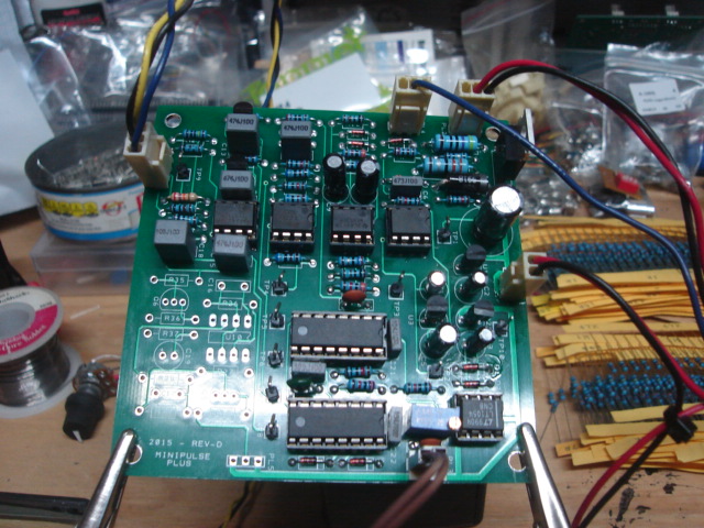

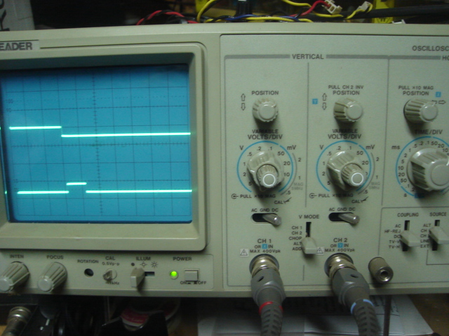

          Step 6 Sample pulse generator
          Hey thank you 6666 for the heads up, much appreciated... I have been reading thru the manual on my scope and playing with different settings just to get a better feel for what it is showing me, I'll get there.. Its hard to teach old dogs new tricks but with a little patience and practice, it can and will happen...

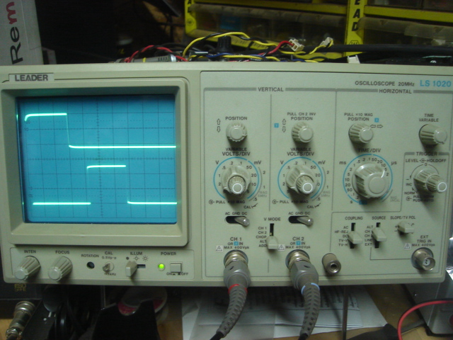

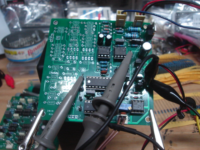

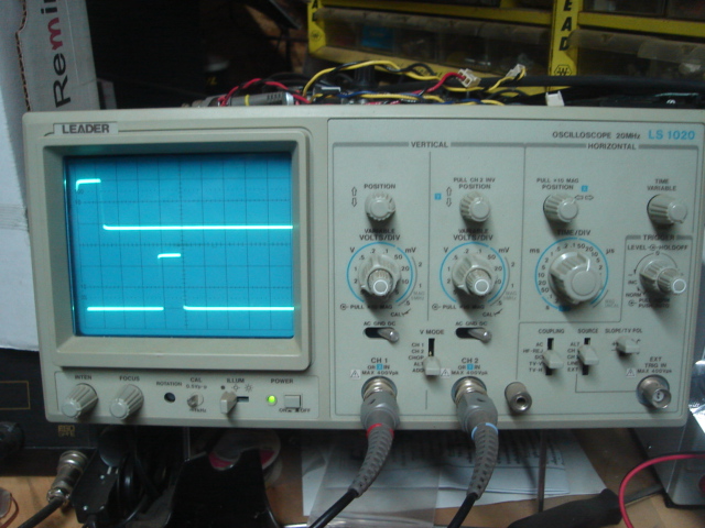

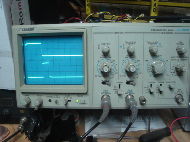

          Step 6, Sample pulse generator components installed, tested TP1 w/channel 1 @ 1v/div/20us time and TP5 w/channel 2 @ 1v/div/20us time, PL3 jumpered from pin 2 to 1, triggered off channel 1. Adjusted R6 to give 22us width on channel 2 width. Everything seemed to go fairly smooth to this point and looks good on the scope, everything is working so far...

          Done for tonight, will take it up a bit more tomorrow after work. Hope everyone has a great day,
          Geo

            Hi Geo
            You have some high frequency noise that shows up after the receiver signal is sloping up. It is probably from florescent lights, computer or some other electronic device. Try turning things off and move your coil away from your work area. I set mine on a plastic waste can on the floor to elevate it above any nails and away from metal table legs.
            Have a good day,
            Chet

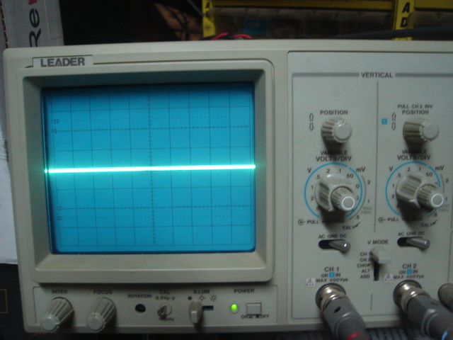

              Followup to high frequency noise
              Hi Chet,
              Yep, you are correct, I have a twin tube florescent above my work space and that definitely creates havoc at times when trying to do stuff. I turned it off and took another pic and shows it clears up and cleans up the trace/wave. And thank you for the scope shots, very helpful.

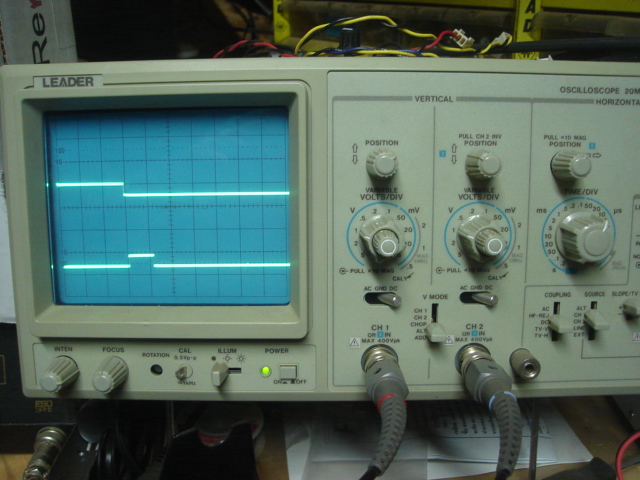

              Tested the following from step 6:
              Main sample delay = 22us (scope settings 2v/div 20us/time delay - TP5)
Name:	main sample delay 22us.JPG
              Secondary sample delay (EFE) = 100us (actual 102) + main sample delay 22us (scope settings 2v/div 20us/time delay - TP6)
Name:	Secondary sample delay 100us + main sample 22us.JPG
              Main sample pulse width = 58us (scope settings 2v/div 20us/time delay - TP7) Approx 57us
Name:	Main sample pulse width 58us.JPG
              Secondary sample pulse width = 58us (scope settings 2v/div 50us/time delay - TPeight)
Name:	Secondary sample pulse width 58us.JPG
              Moving on to step 7.. Have a super night, see ya tomorrow evening.
              Geo

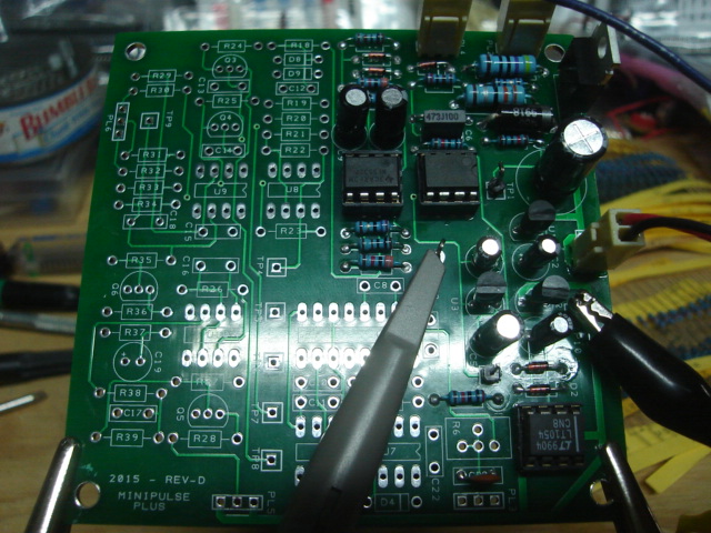

                    Step 7 Sampling Integrator
                    Step 7 Sampling Integrator components installed, tested TP4 with scope, pin 2 of PL3 jumpered to pin 1 and confirmed a nice DC voltage increase when target was swung/placed over coil. Scope settings used, channel 1, 5vd/20us/time delay (time delay not needed for test). The voltage change measured with my multi meter was from 0.8v to 4.0v (I misplaced my meter alligator clip so couldn't take a pic of meter at the same time but will tonight when I find it).
                    Step 7 components installed

                      Step 8 Second Integrator
                      Step 8 Second Integrator, components installed.
                      Test TP9 with PL3 still jumpered from pin 2 to pin 1 and with scope set to channel 1 @ 5v/div. Adjusted trace so it was centered on scope, turning the threshold/audio pot increased the DC voltage on screen to +5. Adjusted scope accordingly to center again, retuned the threshold pot to 0 then turned the board back on to see the DC voltage swing from -5 to +5.
                      Tested with soda can and can see good voltage increase. Then held soda can over coil for a few seconds and the +DCv settled back to the zero line on scope so the SAT is working perfect.
                      Perfect and just as explained in the build doc.
                      I tried to adjust it so the voltage level was approx. -1.5v but had difficult low stuttered tone. Lots of EMI in garage and such so getting a slow steady "growl" was difficult but definitely can be adjusted properly once out and away from the local EMI. Set to approx. 1.2/1.5v for time being.
