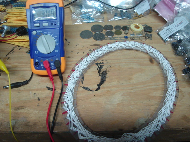

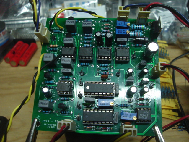

              Added Some of KRinAZ's mods
              Well I got to work on the board a bit today and added most all mods, only one's I haven't changed yet is R10 (wont fit so will need to add some
              wire or something to get the trimmer installed) and still need to do the audio/threshold mod as well.
              Now have the SAT front panel pot, sensitivity front panel pot, added trimmers to R7, R8 and R11. Also swapped the 5532 for the LM4562 but it seemed less sensitive so I switched back to the 5532.

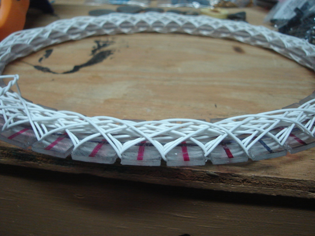

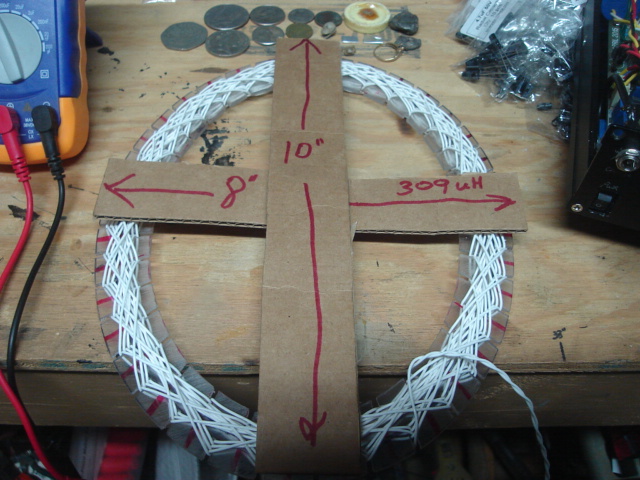

              Used KRinAZ's pdf template and made the 8"x10" spider coil form today as well and ended up winding it with some 600v PTFE Teflon coated 7/32 - 24awg, final was 309uH, had over wrapped by a bunch and ended up removing quite a few wraps but it is right about where I want it now.
              I reset most of the timing according to KRinAZ's specs except for the 5000 pps, for whatever reason the 50k trimmer topped out and the pps is right at 2400pps.
              With the new mods and the new coil the test depths improved quite a bit though without fine tuning it other than resetting the sample delay to 8us.

              I still am not able to detect a 15 grain nugget (it's probably closer to 5 to 7gr as it is laced heavily with quartz) but will keep messing around with settings until it does though.
              Will add the other mods when I have a chance and continue to play with the settings. I'm also building another coil form as well but it will be 7-3/4" round and using the 250/44 litz wire for comparison.
              Some pics with the board mods and the new coil.
Name:	Minipulse plus with KRinAZ mods.JPG
Name:	Completed spiderbasket coil 600v PTFE 24awg.JPG
Name:	Spider basket coil 8x10.JPG
Name:	Spider basket coil  side view.JPG

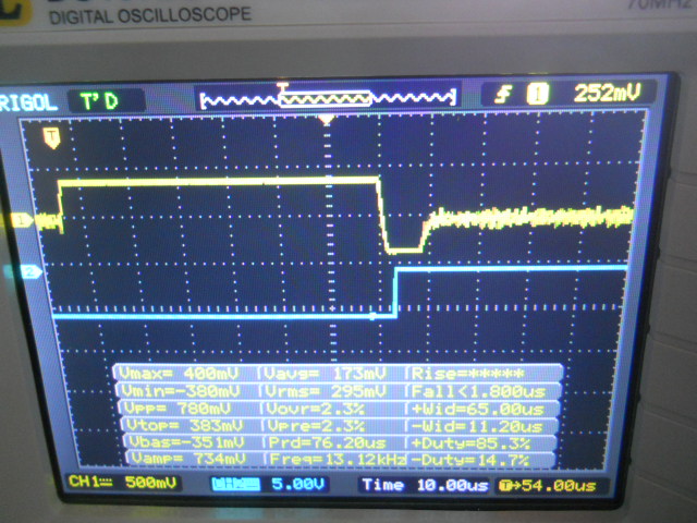

                  From KRinAZ mods list:
                  1) "TX freq at 5000 pps via 50k trimmer pot (which replaced R8 [from the project spec of 1000 pps])" = Could not adjust to 5000pps, only 1700pps maxed on 50k trimmer.
                  2) "TX pulse width (main sample pulse width?) at 30uS via 3K3 trimmer pot (which replaced R7) (from the project spec of 56uS)" = 5k trimmer, set tx pulse width to 30us. (TP7)
                  3) "Sample pulse width (secondary sample pulse width?) at 22uS via 50k trimmer pot (which replaced R11) (from the project spec of 48uS)" = Set to 22us (TP eight)
                  4) "EFE (secondary) delay at 140uS via 33k trimmer pot (which replaced R10) (from the project spec of 160uS)" = Used 50k trimmer set to mid range then adjusted EFE to 142us (134us+8us=142us) TP6
                  5) "Primary (main sample delay?) sample delay adjusted to minimum of 6uS (from the project spec of 22uS)" = Set to 8us @R6 (TP5)
                  From minipulse build doc:
                  Main sample delay = 22us (TP5)
                  Secondary sample delay (EFE) = 100us + main sample delay 22 = 122us (TP6)
                  Main sample pulse width = 58us (TP7)
                  Secondary sample pulse width = 58us (TP eight)
                  Wording is different between the build doc and mod list so I may have something screwed up as far as adjusting at the correct test point.

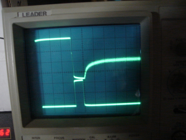

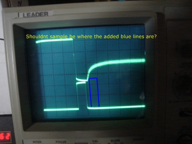

                  After all is said and done I hope some one can clarify this, looking at the flyback with the sample on the scope, it looks wrong compared to what I have seen and read elsewhere (see pic attached). The sample should be close to or be near touching the flybacks rising edge to get short TC or sensitivity to small targets/gold shouldn't it ???
                  Incorrect ?
Name:	Sample Delay Not right.JPG
                  Correction in blue
Name:	correct sample delay.jpg
                    Hi Geo
                    The Blue trace that you want to display and move to the right is available at TP7. It can be moved right or left by adjusting the pulse width of TP5 which is the pulse that you are displaying. Reference figure 10 of the build document.
                    Have a good day,
                    Chet

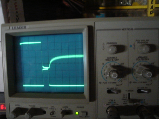

                      Hi Geo,
                      I have the same first sample location on both my and a friends minipulse. I ask the question is this right and Qiaozhi said basically. Have you been able to adjust the sample to look right?
                      I seem to be operating pretty well out in the field but was really unsure of the first sample as well.

                        TP1 is the TX pulse width.
                        TP7 is the actual main sample.
                        TP5 is the main sample delay pulse, which I think you're displaying in your scope image.
                        Look at Fig. 10 on page 15 of the Build Document.

                          godigit, I tried to move the pulse shape to the right of the rising edge but it does not move, only able to adjust its width, as well as the delay and main pulse so not sure if there is another place to R&R a resistor to make this adjustment.
                          I have the build doc at my bench with me while working and have adjusted accordingly to what it says on page 15 and used figure 10 for visual help but with these new mods the board is now not working correctly in my mind. It does work and detects fine but the sensitivity is no where near what it was prior to the mods and the audio cannot be correct at all (fast high tone with no adjustment).
                          I am going to reduce the resistors from the mods that surround the audio/threshold to see if that fixes my audio issue (currently 150k high/82k low/5k pot). Everything else seems to be ok except for the frequency, unable to adjust it to 5000pps (1700 with trimmer maxed) with a 50k trimmer at R8.
                          My front panel delay adjusts from 8us to approx. 30us but when adjusted to lowest setting of 8us it seems to sample before the rising edge of the flyback based on what the scope is showing me (That's channel 1 @ TP3 and channel 2 @ TP5) which I believe is not right, was always under the impression that the sample should be just touching the right edge for best sensitivity to small items and small gold. I could be and very well maybe wrong though..

                            Hi Qiaozhi,
                            Indeed you are right. That is Tp 5, I kept looking at the graph but as one of my lady friends says I man looked it. I kept missing that tp 5 was only shown by spacing only.
                            Thanks for your patience and expertise with this great project.

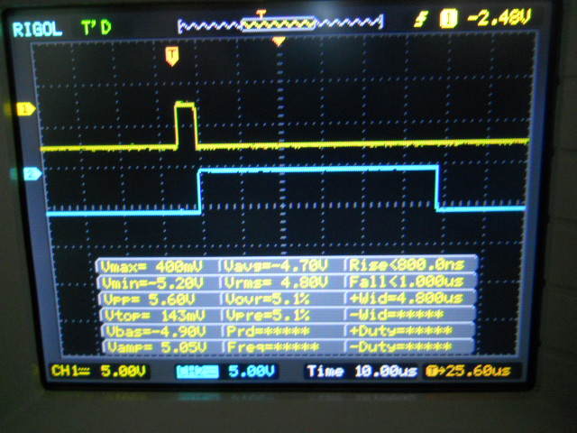

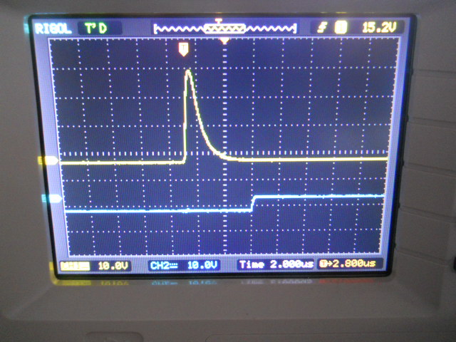

                              Hi Geo,
                              I was looking at the graph wrong I kept thinking tp7 was tp5. It took me a while but I finally got it.
                              So tp7 is our actual sample.
                              But I am still unsure of actual sample speed. Do we add the delay of the pre amp to tp5 or is that our actual sample time?
                              The reason I ask is it seems I should not be able to sample as low as I am without mods?
                              My delay adjusts from 4.6 to 30 us, the only changes I have made are the 555 and the 5532 as mentioned before and I had a large stock of resistors so I chose exact values or just lower, nothing higher than specs.
                              Here is a picture of tp7 next to the flyback.
