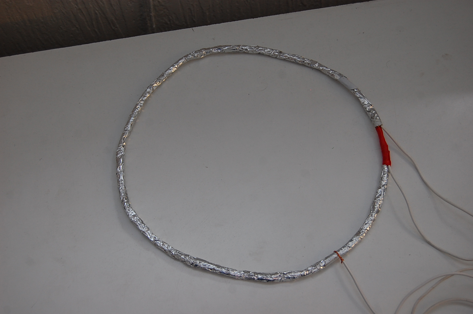

    Discard the basket coil for the moment, and simply jumble wind 20 turns of wire on a 10" (254mm) diameter former. Then secure the loop with electrical tape. This will give you a coil with an inductance of approximately 300uH.

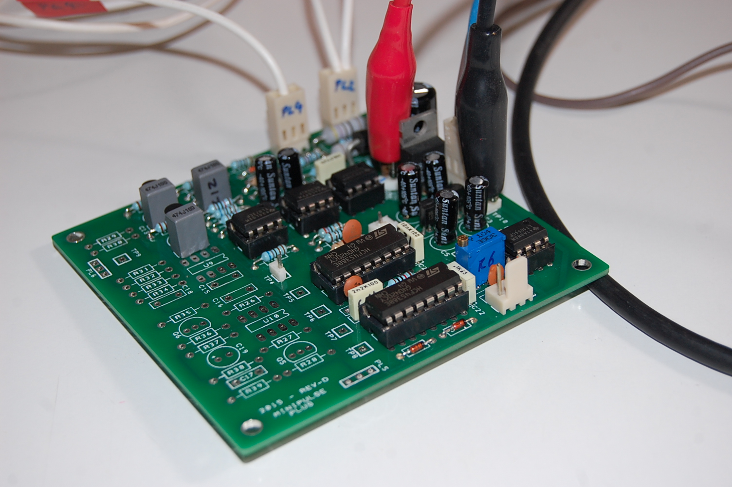

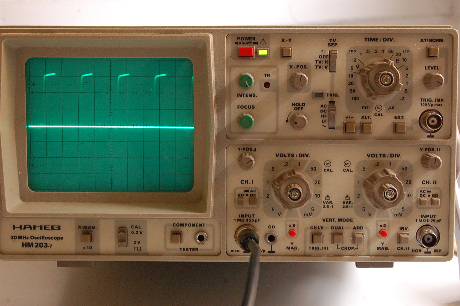

          I am building the MPP and following the build document (ref. 2015022. I got slightly carried away and built to step 7, but I’m having second thoughts about the test for step 4.

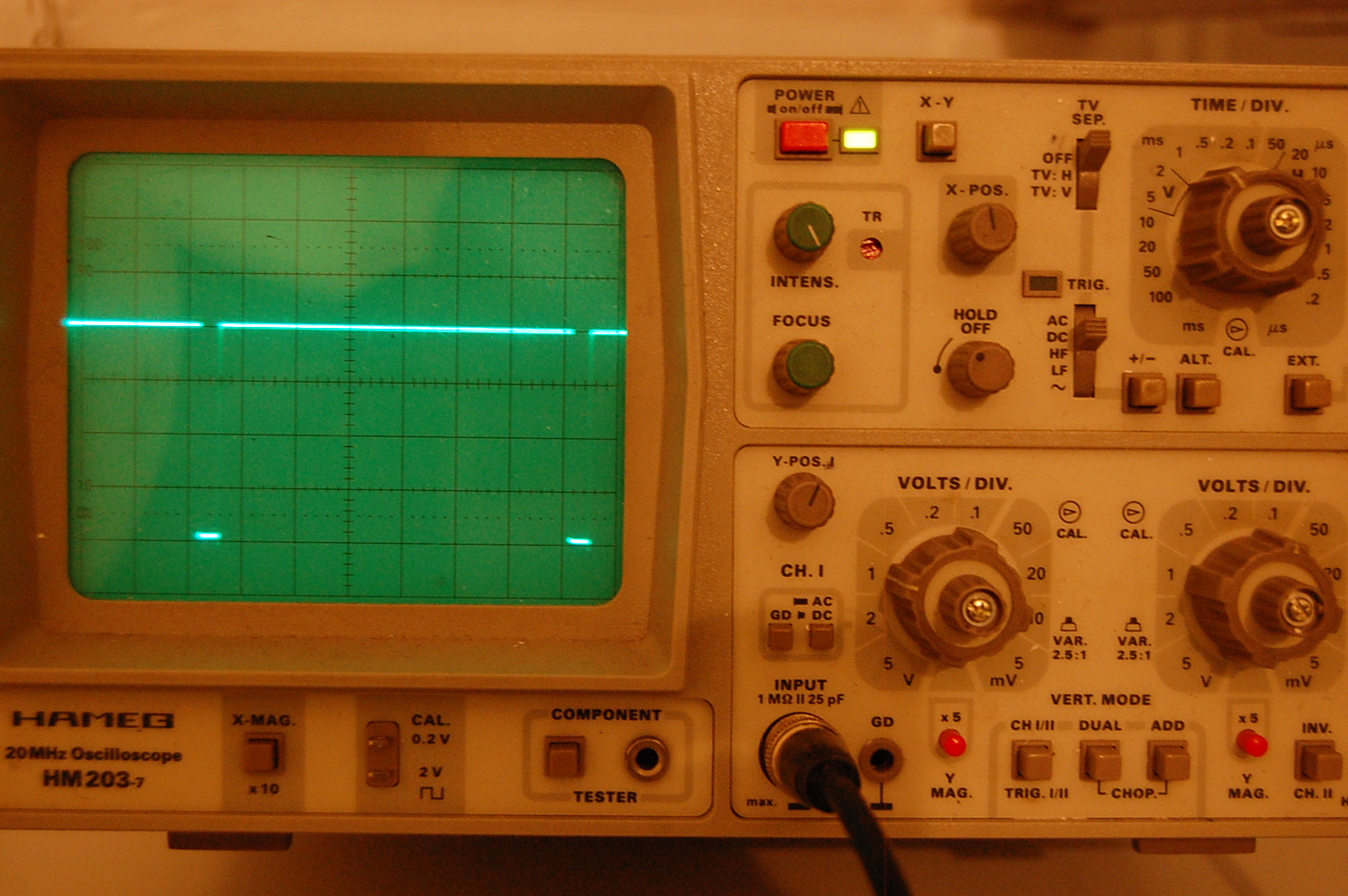

          All tests ok until end of step 3, but no headphone noise at test 4. Since then I have managed to borrow a scope so am posting some pictures that hopefully an experienced eye can have a look at (I am a beginner).

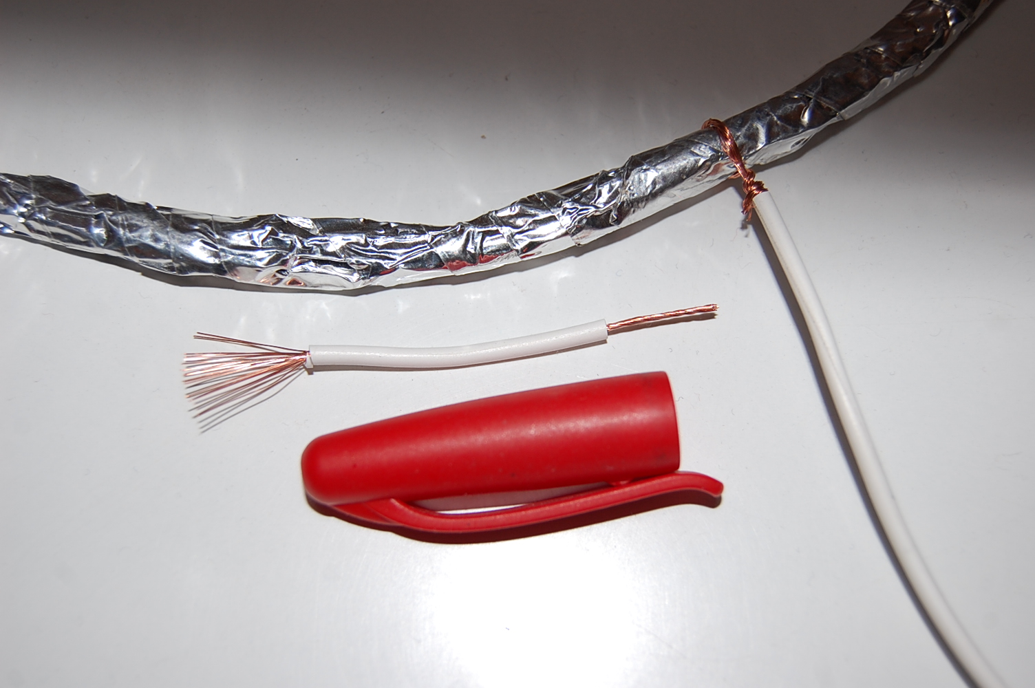

          I have made a coil in accordance (I think) with the Making a Fast Pulse Induction Mono Coil By: Joseph J. Rogowski advice. It was some time ago so I cannot remember the exact number of turns, it was covered with insulation tape and an aluminium tape as a shield, gap around 2cm.

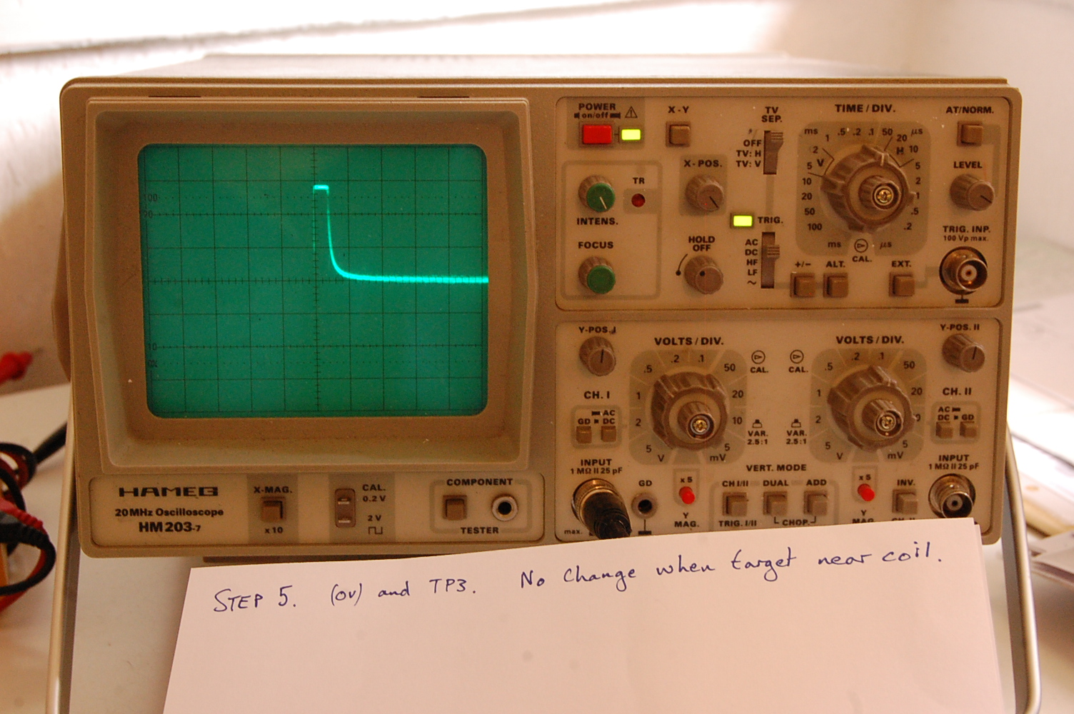

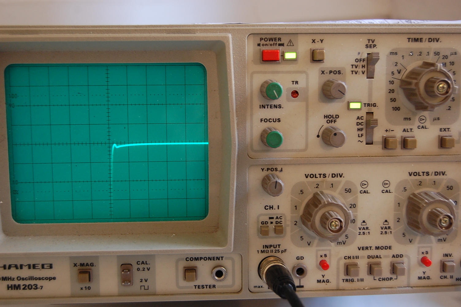

          At step 5 test I get a voltage at TP3 but no drop when a target is presented.
          Hopefully the attached photos will help.

          So any advice most welcome, many thanks in advance.
            Any advice on the previous post would be most appreciated.
            I am trying to learn some of the basics but I'm a beginner so not really sure what the tests are telling me.
            Thanks, B.

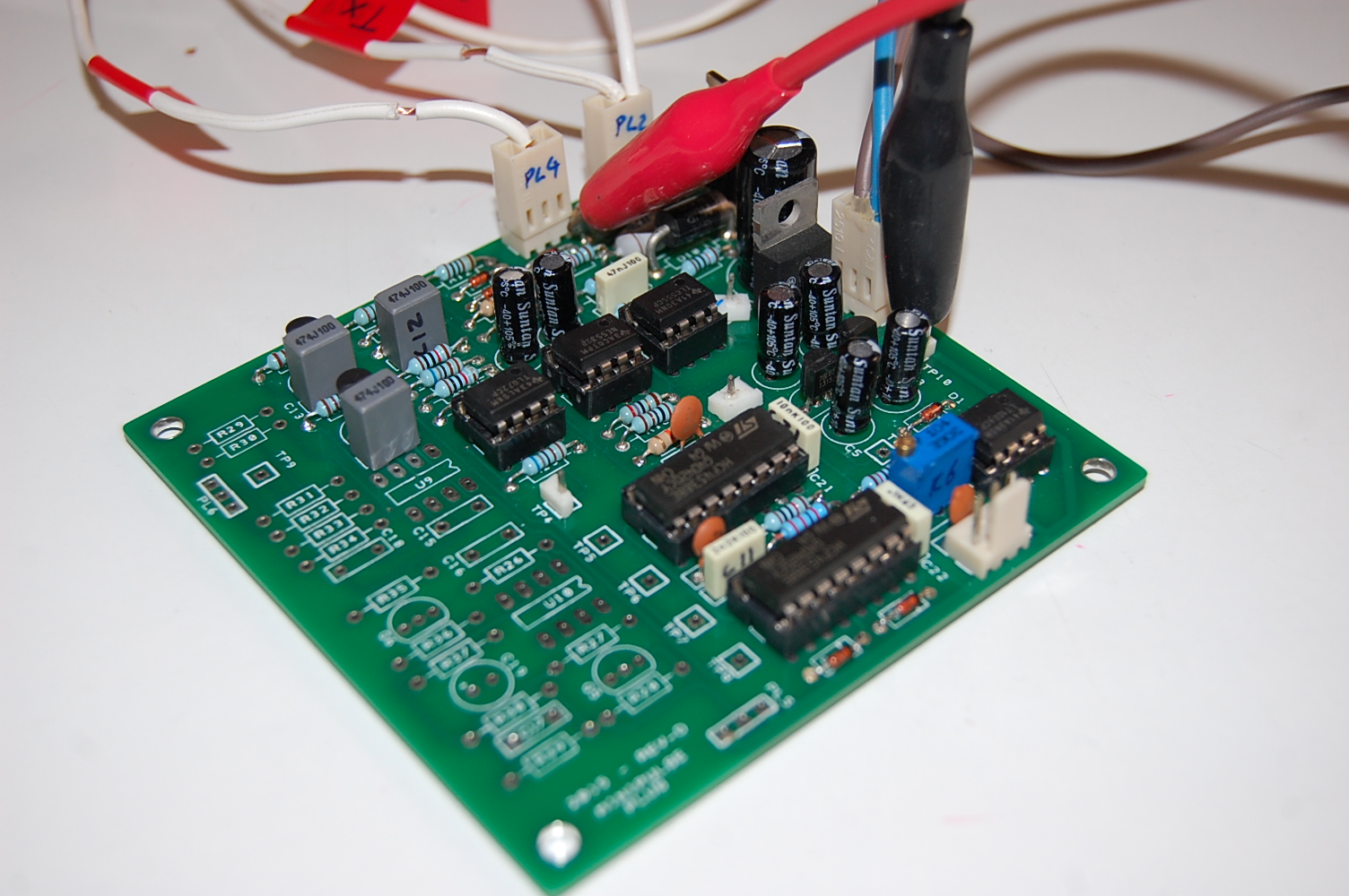

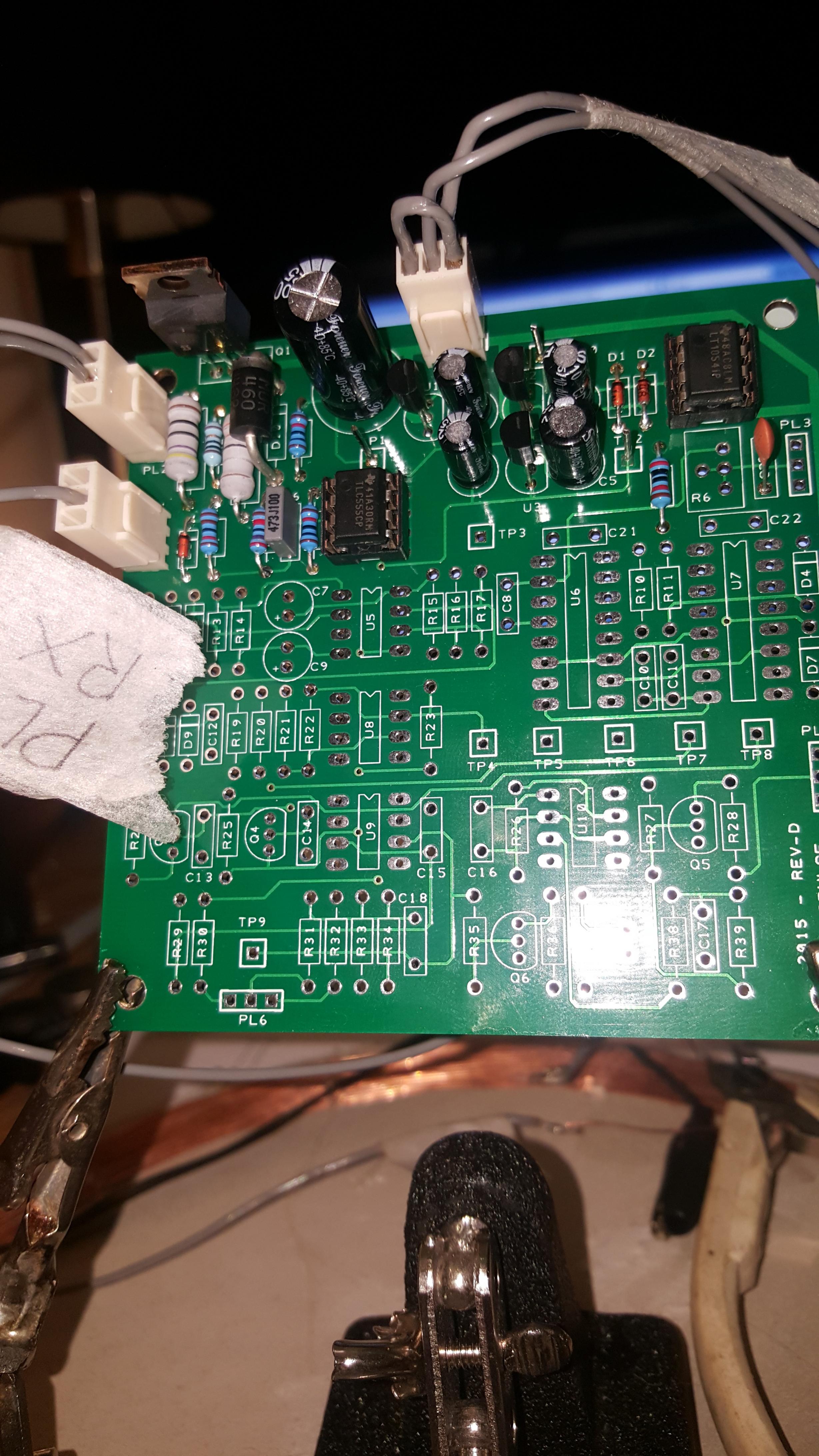

              Hey Borisimo i am new to this electrickery too! but i can see that for c21 and C22 you have 2 different values? as per the build doc c21 and 22 are the same value (100nF) (i am new to this too so please correct me if i am wrong) also c6 i have a 473j100 not a 47nj100? i had no tone in the headphones because i had connected the tx rx wrong they must be together then 0v on the other side. also in position U1 what is that? i have a 79L05 as per the build doc, it looks like you have a mosfet there? also i have a rev D board 'kit' did you get the board on its own then order the parts?

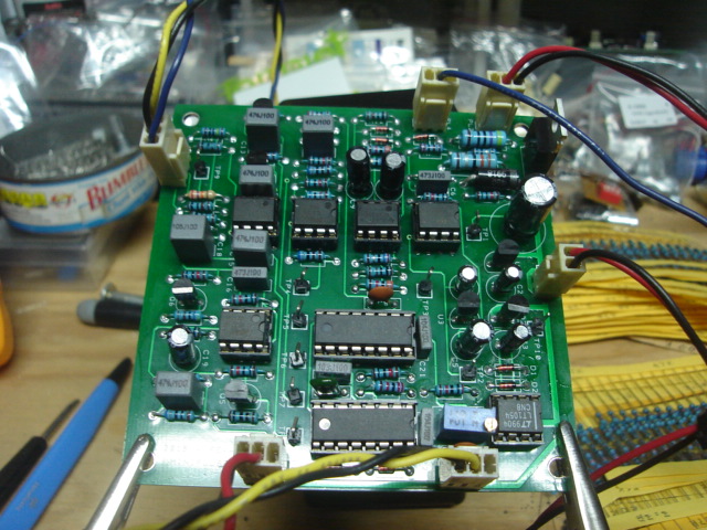

              heres a pic of mine at step4 Click image for larger version
              i have read so many posts and learnt so much on this forum and they all say DO NOT move on untill you have confirmed that the stage you are on is correct and i have learnt SO much from the kind people here on this forum that it is invaluable knowlege (the barracuda is ongoing IT WILL LIVE! )
                473 may mean 47*10^3 pF eg. 47 nF. Also not all TO-220 housed parts are mosfets.

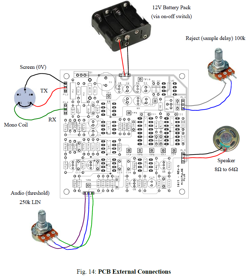

                  So, (Impulse) when you say…
                  ‘i had connected the tx rx wrong they must be together then 0v on the other side’.
                  Does that mean the both ends of the coil connect to the Tx pin on PL2 and the shield connects to pin 3 on PL2?
                  Do my scope photos throw any light on this ??

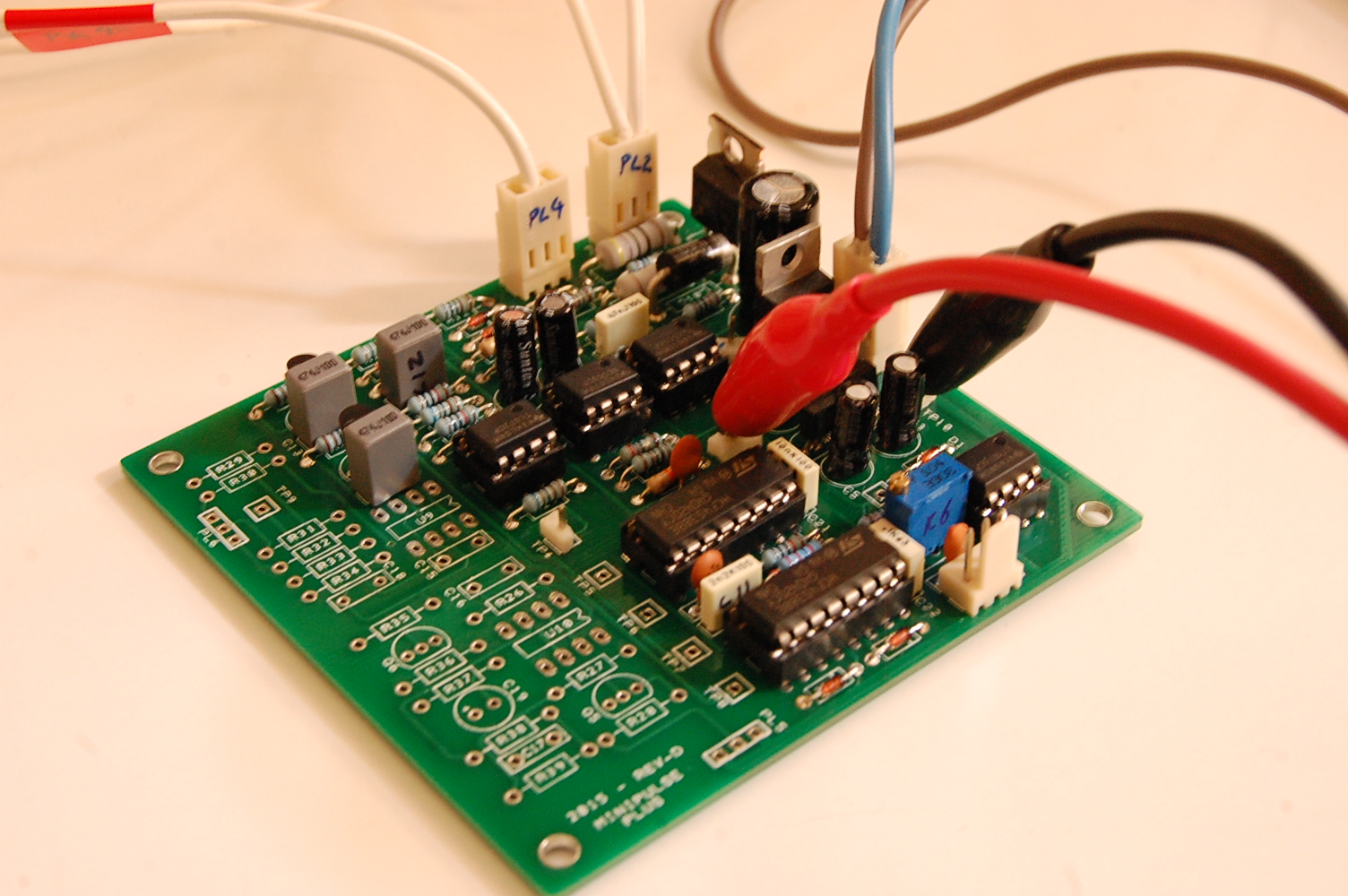

                    Check out figure #7 in the build document. It looks like by your pictures you do not have the tx and rx connected or I just cant see it.
                    Good Luck,
                      Thanks for your reply Godigit1,
                      You are right they were not connected, presumably a simple jumper across the plugs should do it...
                      Stupid question no.43...do the headphones need to be special in any way? presumably switched on and in close proximity to the coil ?
                      Cheers

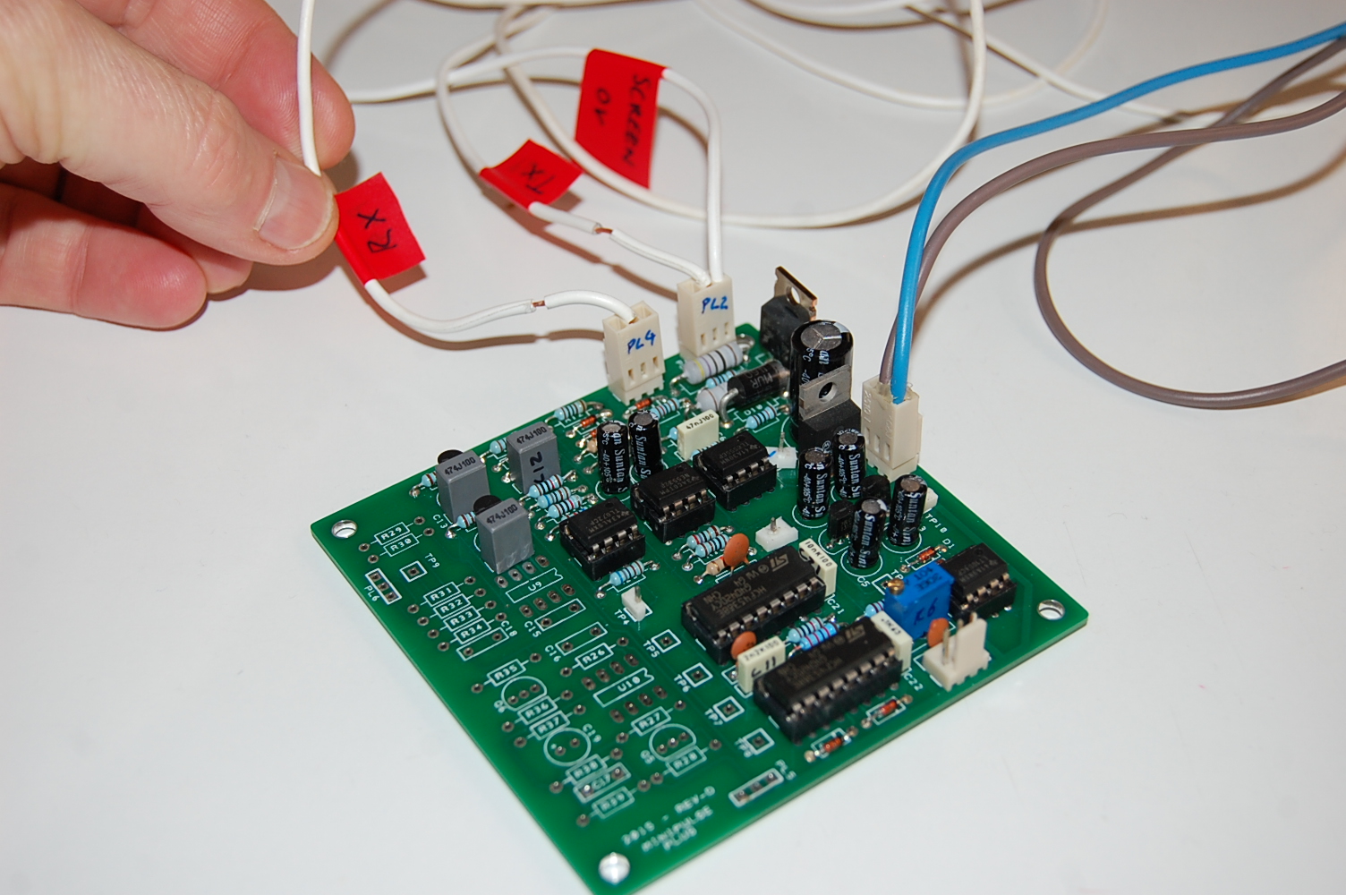

                          I tried again with the Tx and Rx connected (see photo) but no sound in the headphones. Maybe I have gone deaf...
                          I also tried with another very simple coil but could hear nothing, I'm going to check the connections on the board.

                            coil connections for mono coil

                              Are my eyes deceiving me, or do you not have the coil connected in the first attachment?
                              It just looks like you have a loop of wire connecting the TX and RX pins.
