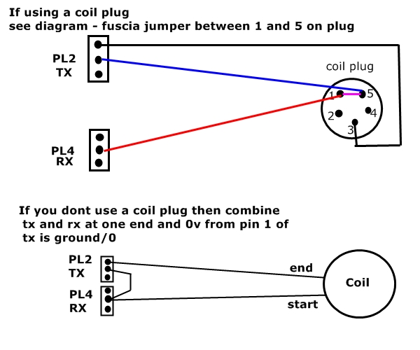

    The coil is connected (coil is the white cables) and the yellow cable is being used as a jumper to connect the Rx and Tx pins. The photos in #5 of this thread might help show the coil more clearly.
    I am asumming that one end of the coil cable goes to the Tx pin and the other end to the Tx pin. This is how I interpret the diagram in the MPP build document.

      Well ... that's why it's not working then. Have a closer look at the diagram (Figures 7 and 14 in the build document.
      For a mono coil, pins 1 and 5 on the connector must be shorted together. The coil is connected between 1/5 and 3. The shield is also connected to pin 3.
      Study the schematic and it will become clear that connecting the coil between pins 1 and 5 will not work. At the moment you basically don't have the TX driving the coil.

        So…..when I said 'I am assuming that one end of the coil cable goes to the Tx pin and the other end to the Tx pin'.
        What I meant was, 'I am assuming that one end of the coil cable goes to the Tx pin and the other end to the Rx pin. (Where Tx pin = pin 2 on PL2, and Rx pin is pin 2 on PL4). Screen connects to pin 3 on PL2.
        There is no connector as such….like on a five pin connector on a Tracker 4. My coil ends just connect into the PL socket connectors, as per the picture in the previous post.
        So my understanding is that I have it connected as per figure 7 and 14 in the build document.

          Connect the coil between pin 2 and pin 3 on the TX connector.
          Then add a wire between pin2 on the TX connector and pin2 on the RX connector.
          Connect the shield wire to pin 1 on the TX connector.

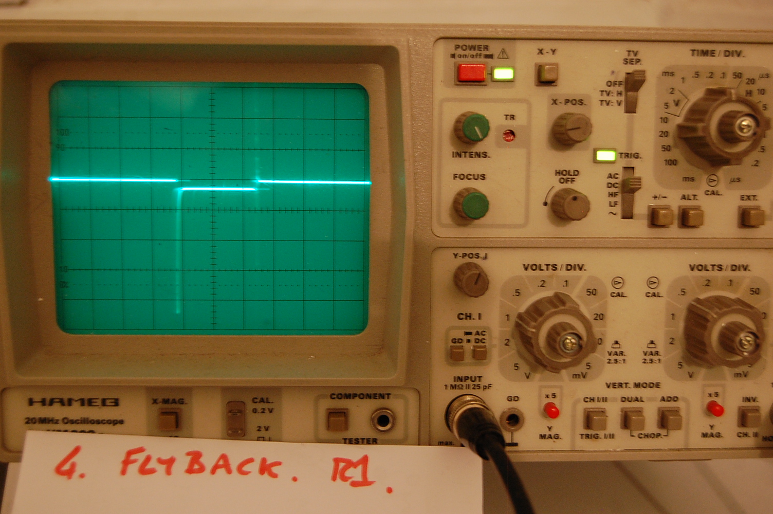

            I connected the coil as specified, but still have no headphone noise (for step 4).
            So inspected the board, re-soldered any questionable joints and cleaned off any spatter and flux residue, but still no noise.
            I do get a fly back signal shown in the picture.
            Could I have damaged (fried) a component when soldering?Click image for larger version

                  What information could I provide that would help anyone to understand the problem,
                  does it make sense that I'm getting a flyback signal (as per the picture), but no sound.

                    Take a close up pic of how you have wired the coil plug and the wiring to the PL2 and PL4.
                    As for sound, do you have the correct chips in U8/U9 and U10 and are they inserted correctly?
                    how to wire your mono coil
Name:	coil wiring minipulse plus.jpg
