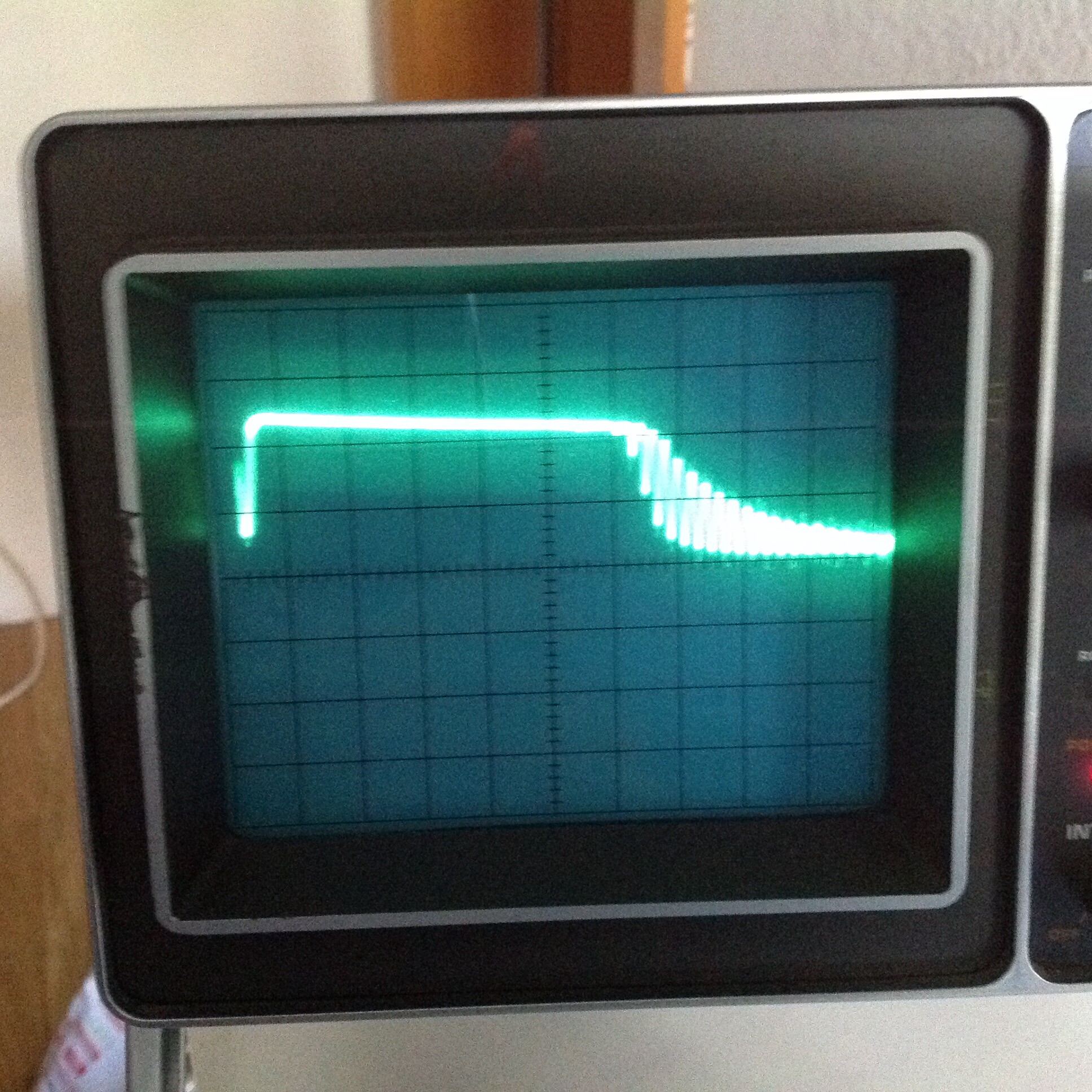

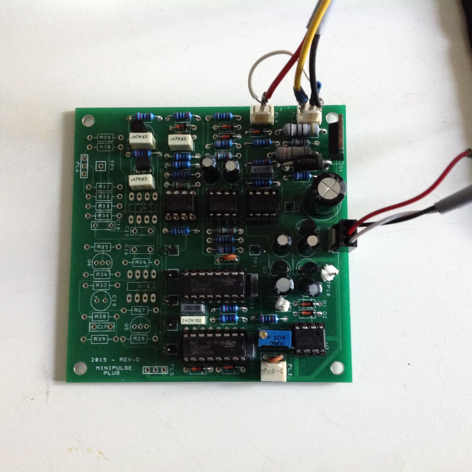

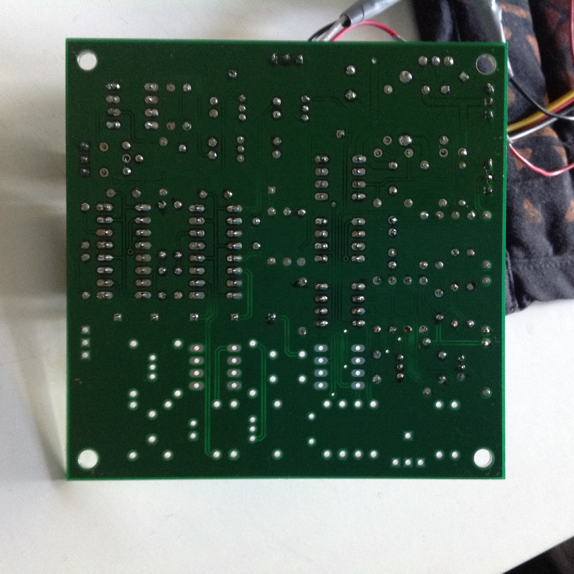

    Hy, ordered the complete mpp package and im stuck now. Everything worked fine but now i get strange readings at tp3. Im at step 7. had a bad solder at r10 if this caused the error. But rechecked and resoldered everything

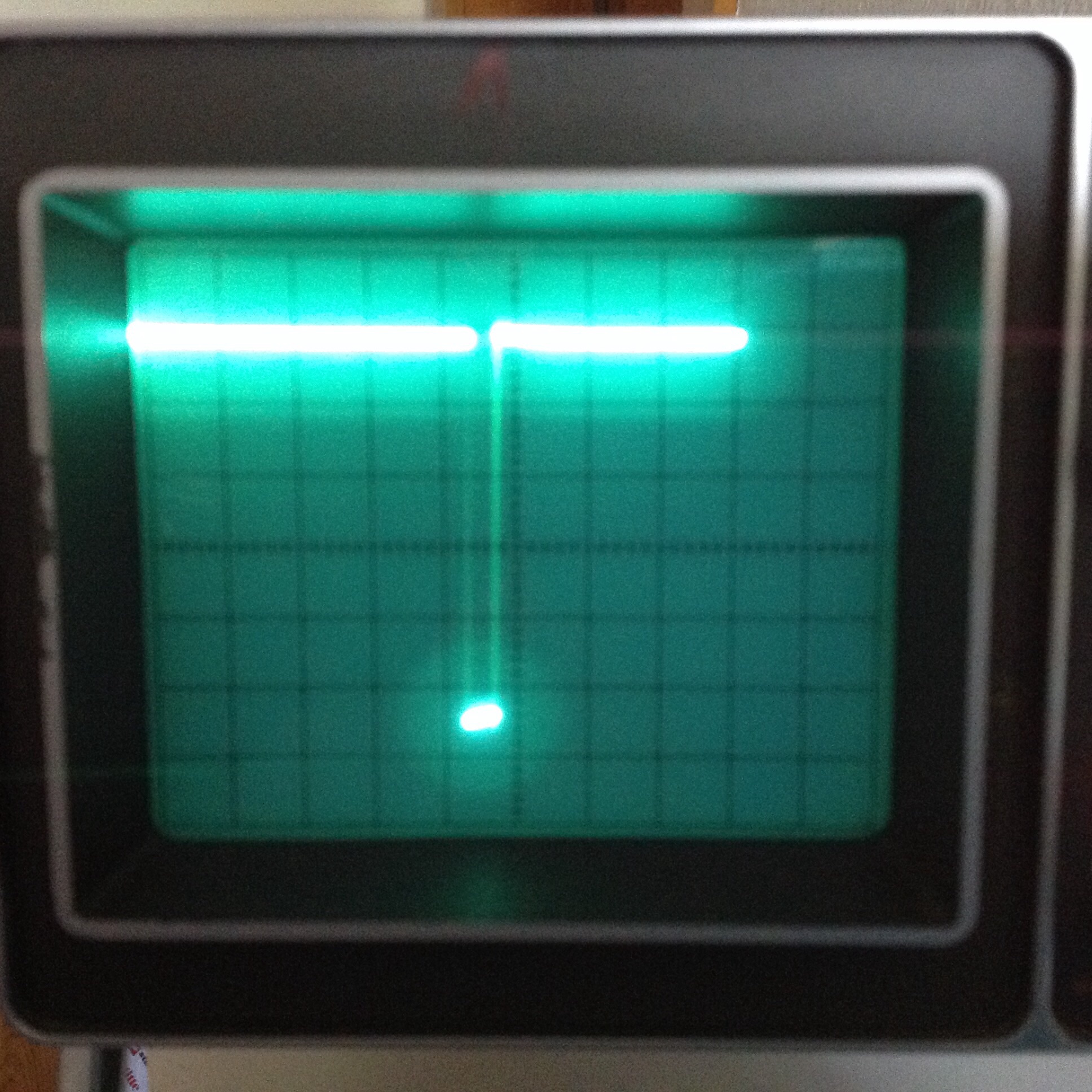

          post a pic of the board, close up and clear, both sides. Also, a bit better pic of the scope settings. Cant read what the settings are in the pic posted.
            Wrong coil connection. Guess i fixed it. But cant hear any coil ringing with earplugs.
ID:	345678 top view
ID:	345679 bot view
ID:	345680 dampening resistor div .2 / 50us / x10
ID:	345681 tp3 div.2 / 10 us / x10

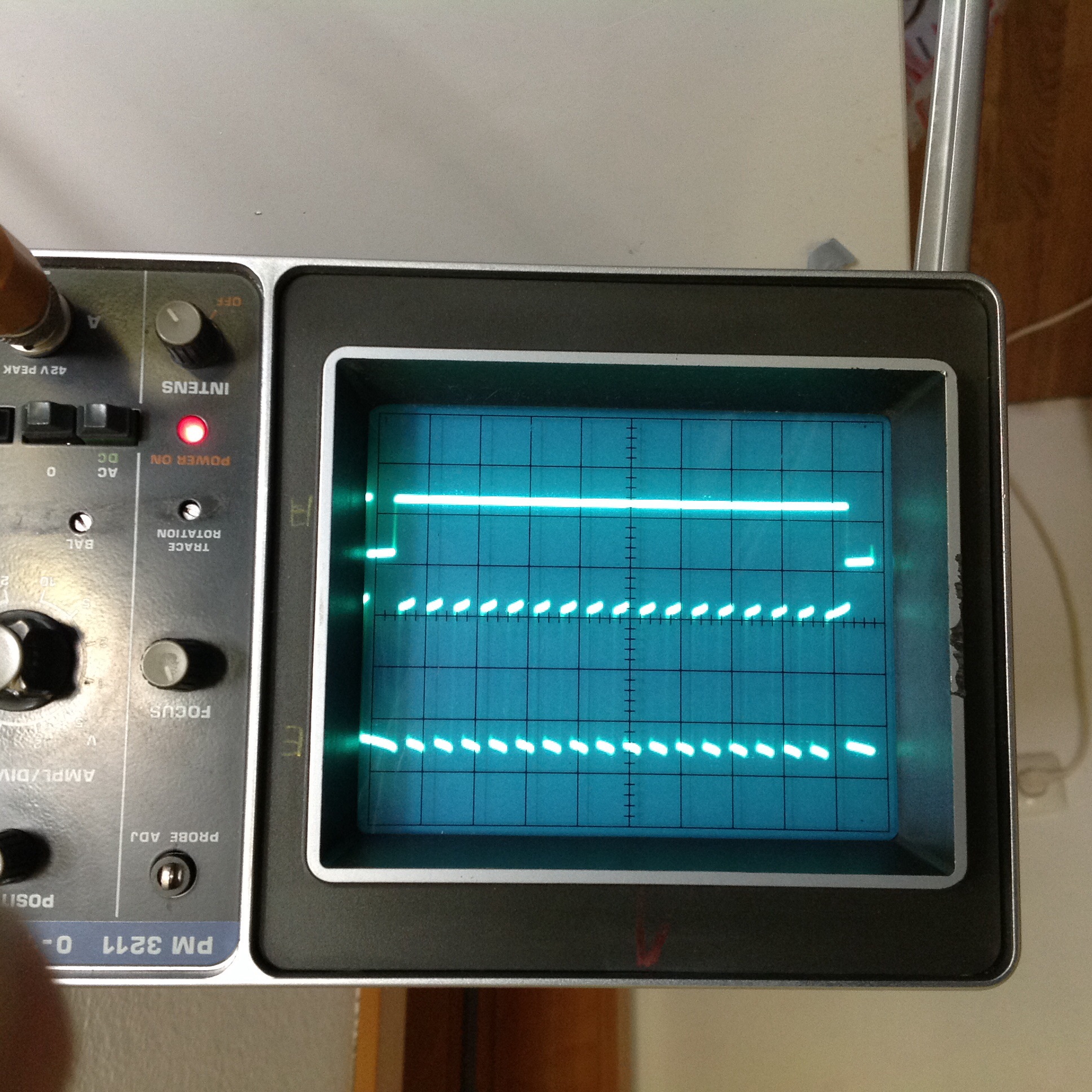

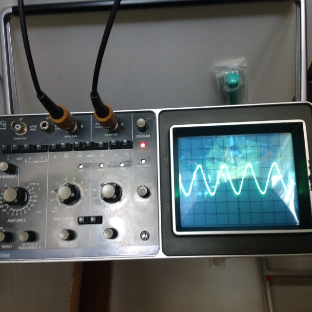

              tp1 and u2-pin2
              u2 probe top .5 ampdiv / .1 timediv
              tp1 bot .5 / .1
              both x10
              line is channel b
              should be diffrent.
                What are the 3 wires going to the power (red/blk/wht)? should be only batt+ to middle pin and - or batt neg to one or the other outer solder lugs. Also (sounds like you may have found or fixed it already) the coil wiring doesn't look right in the pic.
                Also, Looks like R13 and R14 need to be re-soldered, along with D3 and the dampening resistor, the solder pads don't look like they have a good meld to them.
                Try setting your scope to 2v div and 20us with probe on x1. Use the x10 when scoping the dampening resistor for the flyback test (350v+) so make sure to use the x10 for that.

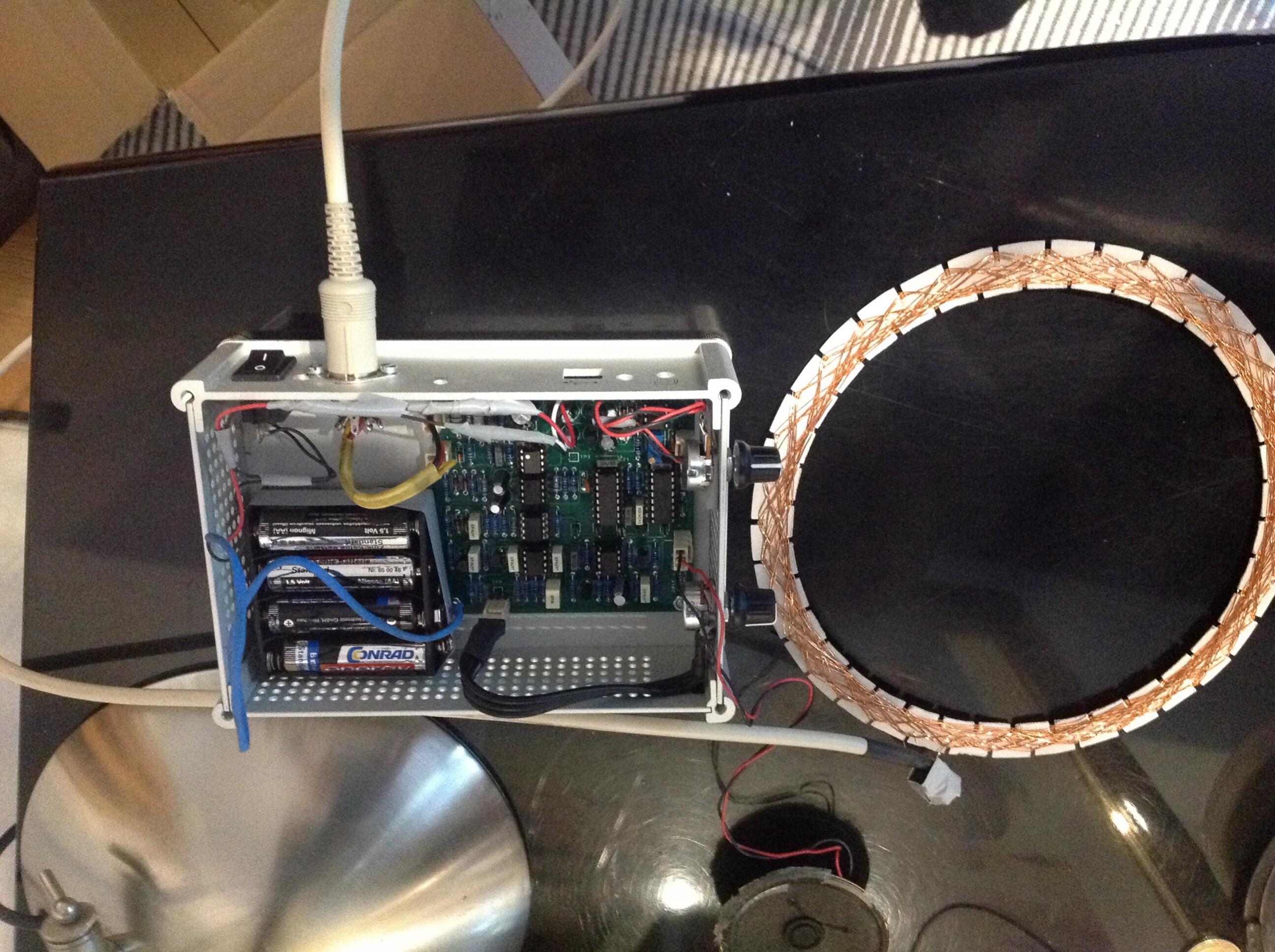

                    Its alive!
                    Just finished my mpp and works like a charme.
                    still need some fine tuning and better coil.
                    12cm for 4cm metal plate
                      Awesome, nice job. Glad the links were a bit of help. What is the inductance of your coil? Its a bit hard to see in the pic but it looks like it may need a few more winds to reach the correct inductance, you should try for 300uH or just above, seems to be the best performing wise (between 300 and 350).

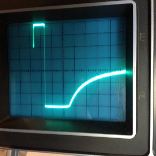

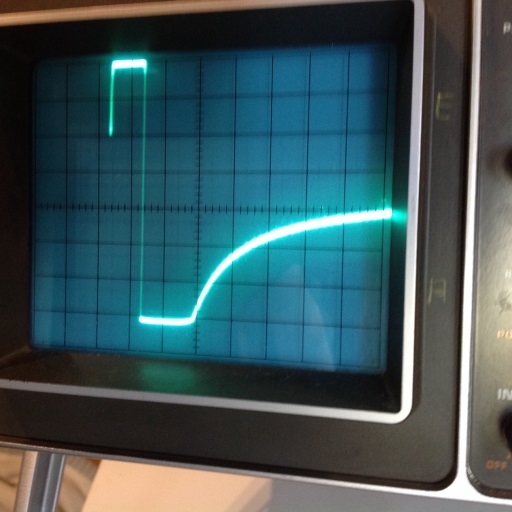

                          Finally i finished my mpp.

                          coil is 320uh at 2ohm.
                          Put a trimmer in series and its just above ringing.
                          delay is set to 14us.
                          but the detection depth ....
                          like 10cm with a golden ring.
                          exspexted a little more.
                          Ill get my teflon wire next week. Was the last time i ordered from china
                          any suggestions how to increase the depth?
                            Hi Ogoun,
                            Your trimmer should not be in series with the coil but should be across it in parallel. 10 cm is definitely not enough for a gold ring and an 8" 3DSS coil.
