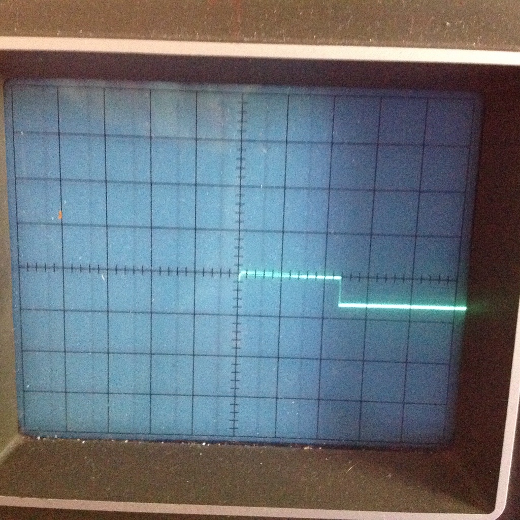

Help with mpp rev d
    +5v TP2 = 5.05
    -5v U8 Pin4 = -4.95
    Check.
    TP 1 Frequency ~ 1200
    Pulse width 51us
    Is this an issue?
    R3 50us 0.5v

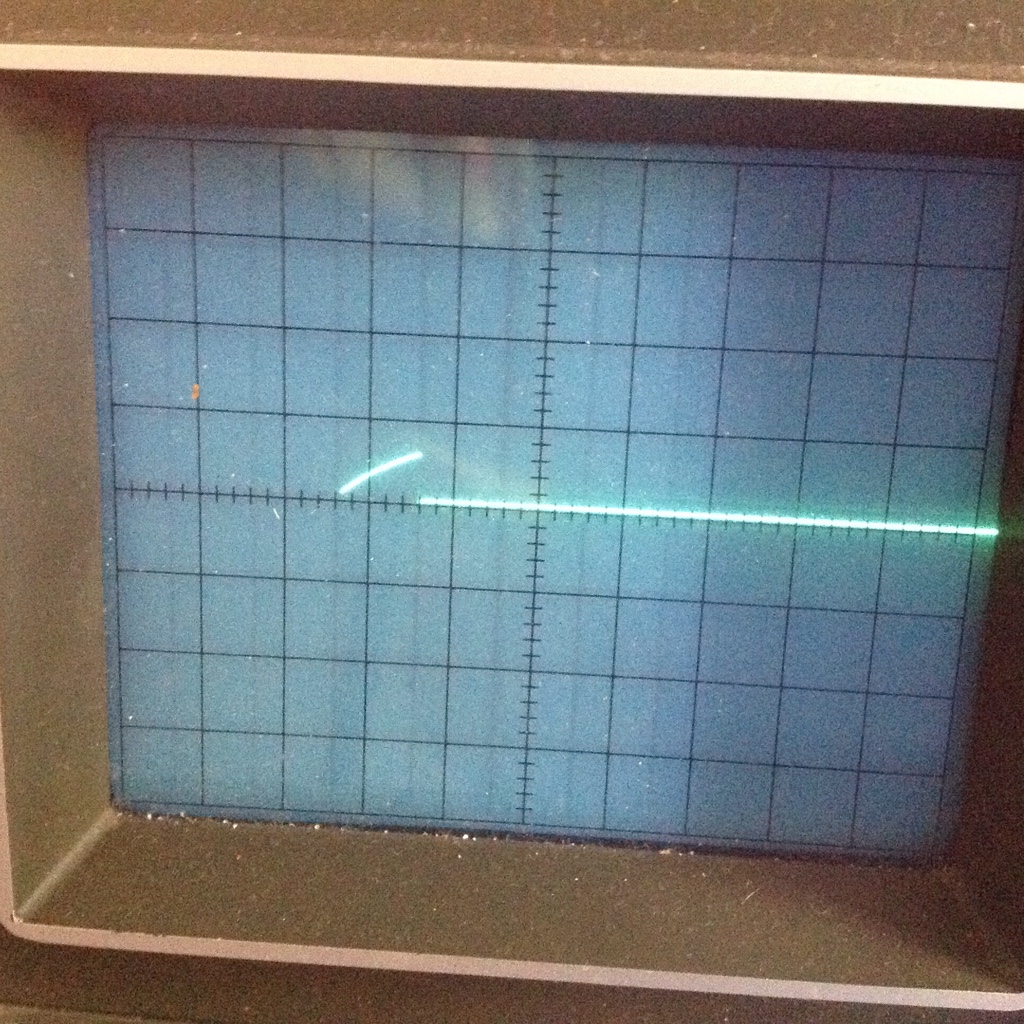

    TP1 Pulse width 20us

          Put my Oszi at TP 9 and it swings from ~+2v to ~-2v although no metal is near coil.
          Any advice?
          Audio threshold VR doesnt change anything. DId i frie the Integretor? or VCO?
          But why can i still "detect" something. Maybe SAT? ;/
            Was a faulty pot connection
            Another question :
            Where do i measure "coil ringing"?
            Output of opamp 1 right? U5 pin 1?
            Because even with a dampening resistor < 200 there is no ringing at all.
            Coil is 321/2.1 dont know cap. (i sticked to easy fast coil pdf)
            x10 probe over resistor shows the same : nice spikes no ringing.
            Hard to get the critical dampening.
              In theory as you adjust the coil damping it should look something like this animated gif.
                Soldered a 100ohm resistor in series with a 5k variable resistor.
                No matter how low i set it, just get the "last" picture from the gif.
                Ill try it without any Resistor.

                  So can you set your scope so that you see just one pulse? The ringing should be just after that one pulse.
                  Dan
                    http://www.geotech1.com/forums/attac...8&d=1341095735
                    This is a very good animation to illustrate the adjusting of the damping resistor
