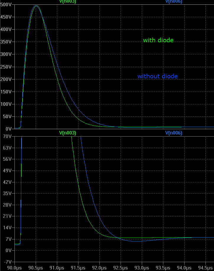

    A chart from another thread awhile back. The diode reduces the capacitance. Higher damping resistance to critical damp allows earlier sampling. The peak current in the example was higher without the diode because of the diode drop when charging the coil. With equal peak current there would be a greater signal difference with the diode. Maybe not a big gain in signal strength but without the diode I couldn't sample sooner than 10usec.
    The voltage avalanched with and without the diode. Have you tried to critical damp the coil in spice with and without the diode?

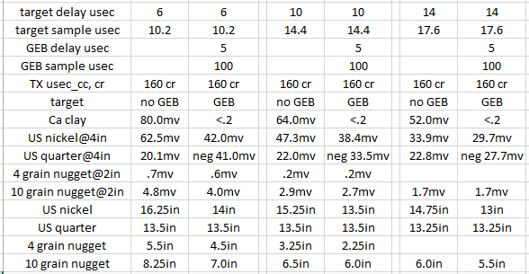

        Chart I posted awhile back. Sample delay time 6, 10, and 14usec. Sample time was adjusted to cancel ground signal so the sample time was longer for the 10 and 14usec delay times(GEB sample time 100usec). The diode was used for all of the tests. Just shows the effect delay time has on detection distance for different targets. The 4 grain gold nugget showing the most effect. Targets were swung from a pendulum and detection distance was recorded with GEB on and off.
          That statement does not appear to be correct, as the diode is never reverse-biased. At least, I can find no evidence that supports the theory.
          It is true that (with the diode inserted) you can use a higher value damping resistor. But that's because the diode has increased the decay time, and not reduced it. Therefore you have to compensate by increasing the damping resistor value.
          I have tried decreasing the maximum coil current with the diode inserted, in order to match the test without the diode. Best results were obtained without the diode. Both SPICE and real measurements agree with each other.
          In fact this observation tends to confirm what I said in my initial post. All the diode is doing is to reduce the time the MOSFET is in avalanche mode. Hence the [apparent] result is that it allows the current to decay more quickly.

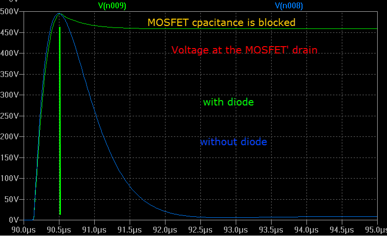

            The voltage transient has two parts: a rising part before the HV peak (Vp) and a falling part where voltage drops back to zero after the peak.
            During the rising part the output capacitance of the MOSFET (Co) gets fully charged through the series diode. Once Vp is reached the voltage starts to drop, but Co remains charged to Vp because the series diode is reverse biased (blocked). In these conditions, the MOSFET capacitance gets isolated from the coil during the falling half of the transient, which speeds it up a little bit.
              Actually it's because the diode blocks the MOSFET capacitance during the fall part of the transient, reducing the average capacitance seen by the coil.
                Good answer.
                However, at the moment that's not what I'm seeing in practice. Perhaps there's a difference in the actual circuit I'm using for testing. I need to investigate this further.
                More later ...

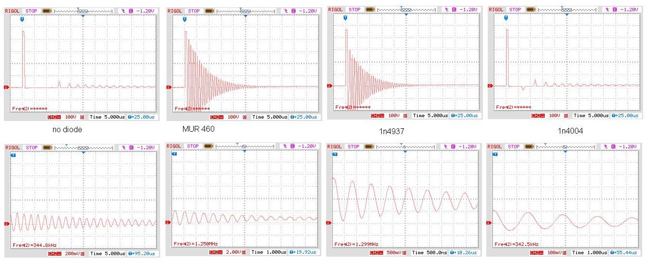

                        What Teleno said. Scope pictures of coil turn off with no damping resistor. Resonance a lot higher with diode in circuit. Damping resistance=pi*L*resonant frequency, the higher the resistance the faster the decay.

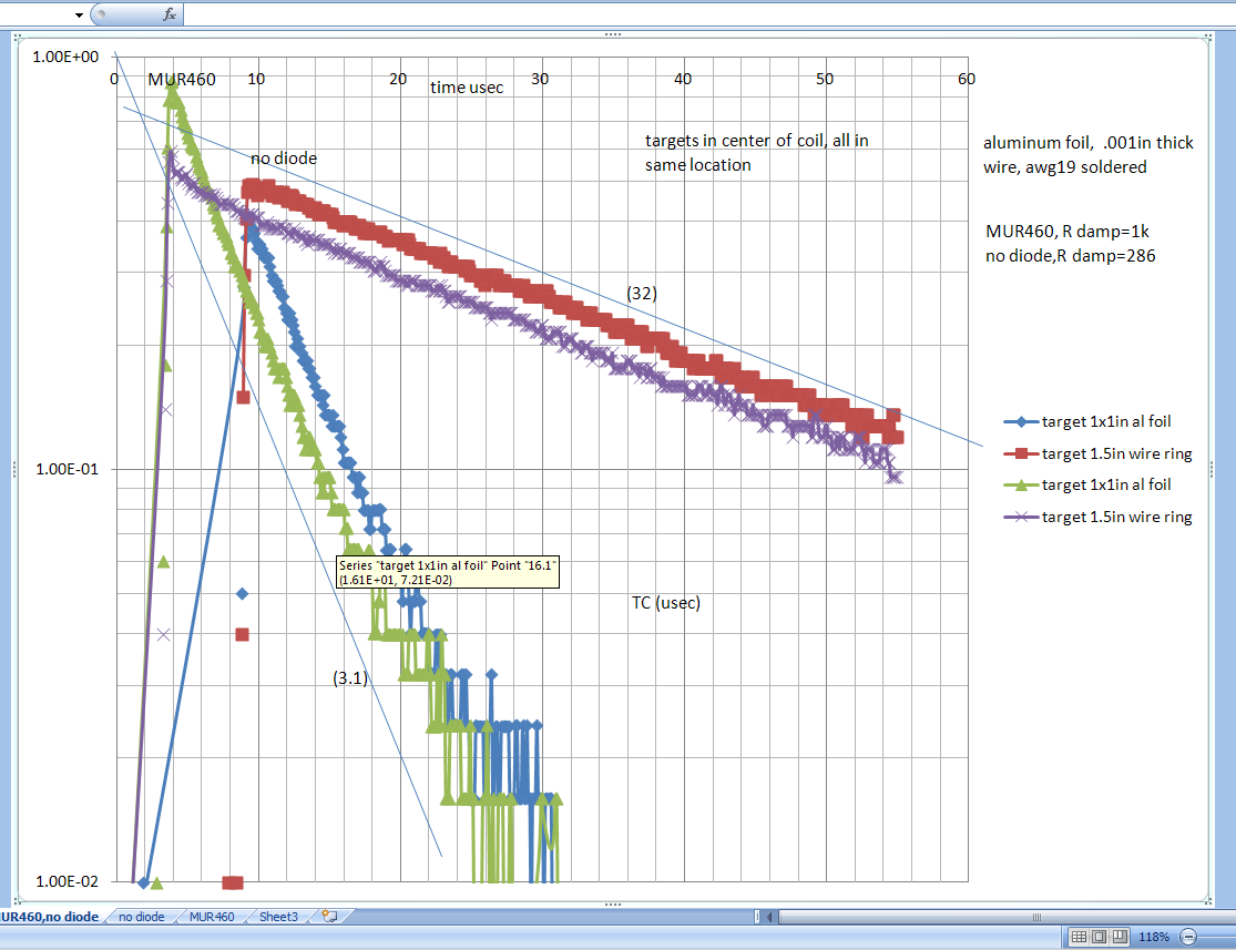

                            Back when I was doing PI design at PriorJob I played around with the series diode trick. Like Qiaozhi I found that the diode made settling slightly worse. The "theory" that it should help made sense, and I can run simulations that show an improvement, so I chalked it up to the rest of the circuitry not being fast enough to show an improvement. I never got back to look at it again. In any case, I've yet to build a working circuit in which the diode improves settling.
