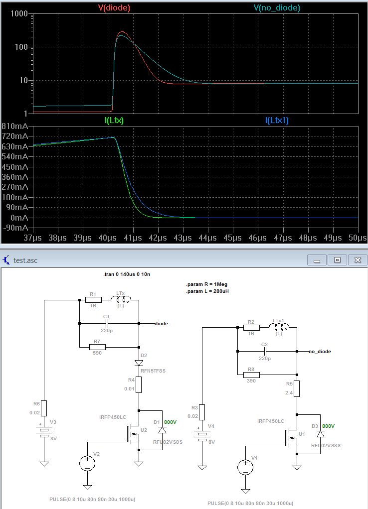

What is the purpose of the series diode?
    Back when I was doing PI design at PriorJob I played around with the series diode trick. Like Qiaozhi I found that the diode made settling slightly worse. The "theory" that it should help made sense, and I can run simulations that show an improvement, so I chalked it up to the rest of the circuitry not being fast enough to show an improvement. I never got back to look at it again. In any case, I've yet to build a working circuit in which the diode improves settling.
    300 ns advantage (what you get from the diode trick) doesn't make a difference if the amplifier cuts off at 200kHz.
      As Carl said, the theory seems to make sense, which is why I decided to investigate further.
      From simulation it is clear that the MOSFET output capacitance appears to get disconnected from the coil by the diode. You can see that by examining the shape of the coil current after TX-off. There is a small hump in the decay curve where the coil's parasitic capacitance initially becomes charged and then subsequently discharges. This hump is reduced in amplitude when the diode is present. Also, the amount of reduction is related to the ratio between the MOSFET's output capacitance and the coil's parasitic capacitance.
      But ... in practice (on a real circuit) the opposite appears to be true.
      I currently need to rebuild my test circuit, so it might be some time before I can do some in-depth testing.
      Please keep up this interesting discussion.

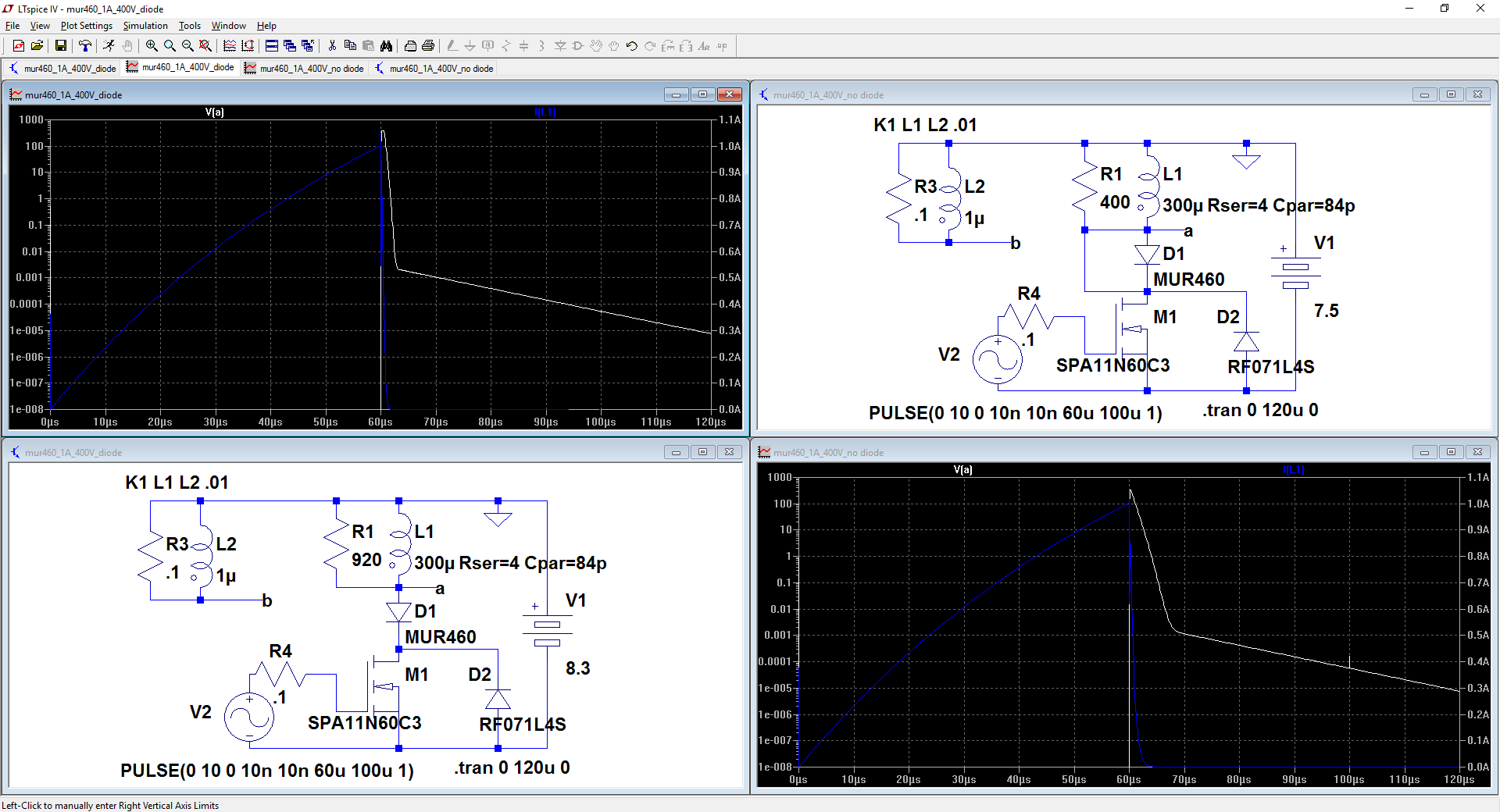

        The thought was to use a diode to allow earlier sampling. Maybe we should define the desired delay. I've been using the diode to allow sampling starting at 6usec. Is 6usec low enough? The chart I included in reply #4 showed a big gain in distance for the 4grain nugget. The nuggets were tested with the flat side towards the coil. The difference in detection distance would be greater for the 4grain and 10grain nugget if turned on edge. Coins were better at 6usec but not a lot better. Might be a lot better with coins turned on edge? If we can start target sample at desired delay with better S/N without the diode all the better. Including chart from reply#4. Different coil or circuit might show different.
          Is your MOSFET going into avalanche mode at TX-off?
            I've run a simulation using the MOSFET model below (IRFIBF30G, 900V, 2A) and there was no difference whatsoever between diode or no diode. But then again it seems the model's capacitances are too low? (CGS 54.8p, CGD 69.5p).
            According to the data sheet the output capacitance at 25V is 320pF. However, the total gate-drain charge at 360V is 42nC, equivalent to 116pF (42nc/360V). I wonder if there's anything in the model below that adjusts the capacitances according to the voltage, caus I can't spot it.
            When I use the defautl LTSpice model
            .model IRFIBF30G VDMOS(Rg=3 Rd=5m Rs=1m Vto=3 Lambda=0.0031 Kp=1.7 Cgdmax=1.5n Cgdmin=150p Cgs=1.2n Cjo=320p Is=2.3p Rb=6m mfg=Vishay Vds=900 Ron=3.7 Qg=78n)
            I do get a clear difference in timing.
            What gives?

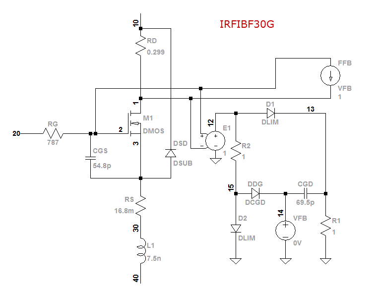

                I have drawn the SPICE model of the IRFIBF30G and it seems that it is actually modelling the non-linear capacitances using current/voltage ources and Miller effects:
                The result of a simulation diode/no_diode when the damping resistors are adjusted to get the same overshoot, is as follows:
                This was for a larger MOSFET IRFP450LC with more capacitance using similar non-linear model.

                    There's definitely some sort of modelling going on there using controlled sources, and your back-engineered schematic is correct ... except that RS should be connected between nodes 3 and 40, whereas you have it connected between 3 and 30. Actually, there appears to be a mistake in the subcircuit, as the inductor LS is connected to node 30, which doesn't exist anywhere else. Basically, it's floating. Your interpretation may in fact be the correct one.

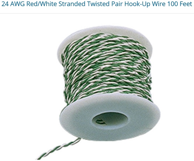

                          Relax, it's not an actual project, just a simulation to verify the point of using a diode.
                          The coil's L and R values are from a Minelab's GPX coil that I own. C is just an educated guess.
                          By the way, what do you mean by "twisted pair for lead"? do you have a pic or a diagram?

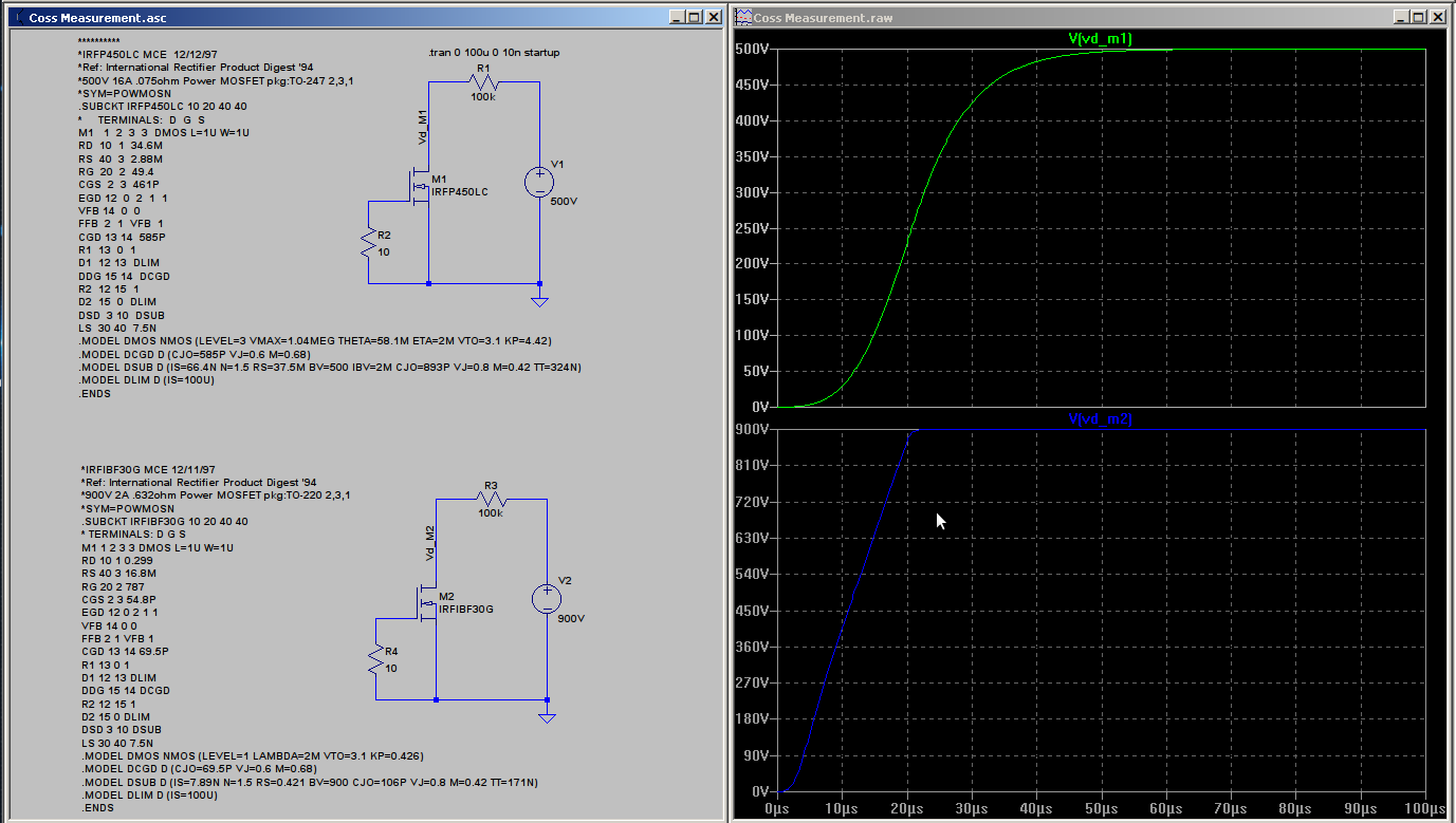

                            It appears that the MOSFET subcircuits posted by Teleno are modelling the nonlinear variation of Coss as a function of drain to source voltage Vds. The value quoted in the datasheet is specified at 25V, which is not that useful for our purposes. It is more useful to know the value of Coss effective, which is defined as a fixed capacitance that would give the same charging time as the output capacitance of a MOSFET while Vds is rising from zero to 80% Vds with Vgs = 0V.
                            The attached simulation shows two test circuits (one for each of the MOSFETs). If you measure at the 80% point (480V for top circuit, and 600V for bottom circuit) the Tc is 27.9us and 16.6us respectively.
                            Then, using:
                            we have: for the top circuit,
                            and: for the bottom circuit.
                            Note that the voltage sources are set to the maximum voltage for each MOSFET. If you raise these voltage to 600V and 1000V, you can readily see that the avalanche voltage is also modelled correctly.

                            Green - this may also answer your question about how to attach third-party subcircuits. You can also use the .lib directive to point to a file.
                              The attached simulation shows two test circuits (one for each of the MOSFETs). If you measure at the 80% point (480V for top circuit, and 600V for bottom circuit) the Tc is 27.9us and 16.6us respectively....
                              Very educational, thanks!
                              The (theoretical) conclusion is that the diode would be useful/noticeable when the value of Coss is near the coil's capacitance or larger, which is not the case for quick and dirty home-made coils above 300uH with capacitance in the order of 200-300pF.

                                Including a picture of twisted pair stranded I purchased(pvc coated, each wire about 1.38mm OD, measures about 1.3pf/inch). Purchased some AWG24 stranded hookup wire, pvc coated, about 2.1mmOD). Cut a piece about 65 inches long, wrap around a small fixed dowel, evened ends and wrapped, taped both ends, cut end around dowel. Measures about .9pf/inch.

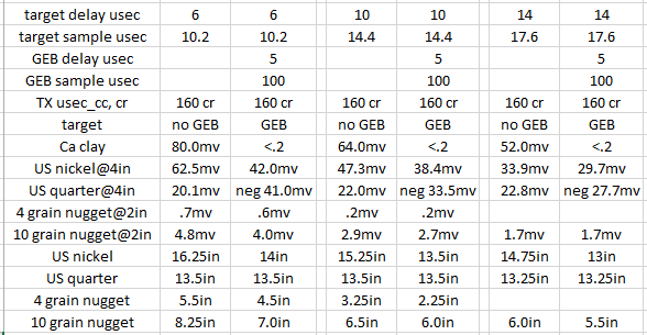

                                Changed the amplifier and integrator circuit in my detector last week. Used some 25x25mm aluminum foil targets(1,2,3,4 and 5 layers) Carl suggested in another thread to compare signal loss for short TC targets at 6, 10 and 14usec delay times. Included 4 and 10 grain nugget to compare with prior test. Coil stationary, target swinging from a pendulum, threshold adjusted for a minimum of 10 sec. between noise flashes, target lowered until led flashed a least 5 target crossing in a row.
                                Target sample time was about 10usec for all of todays tests.
