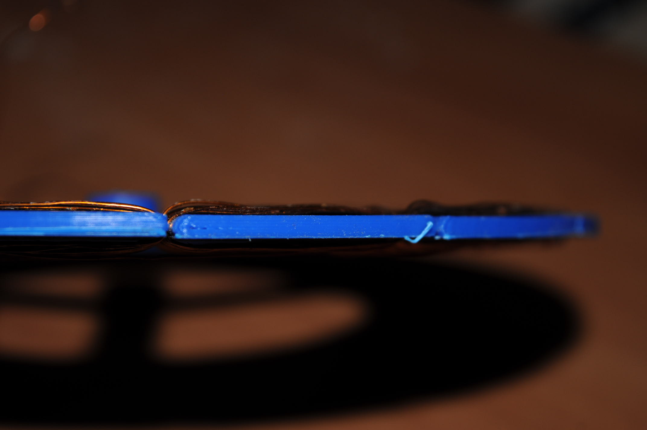

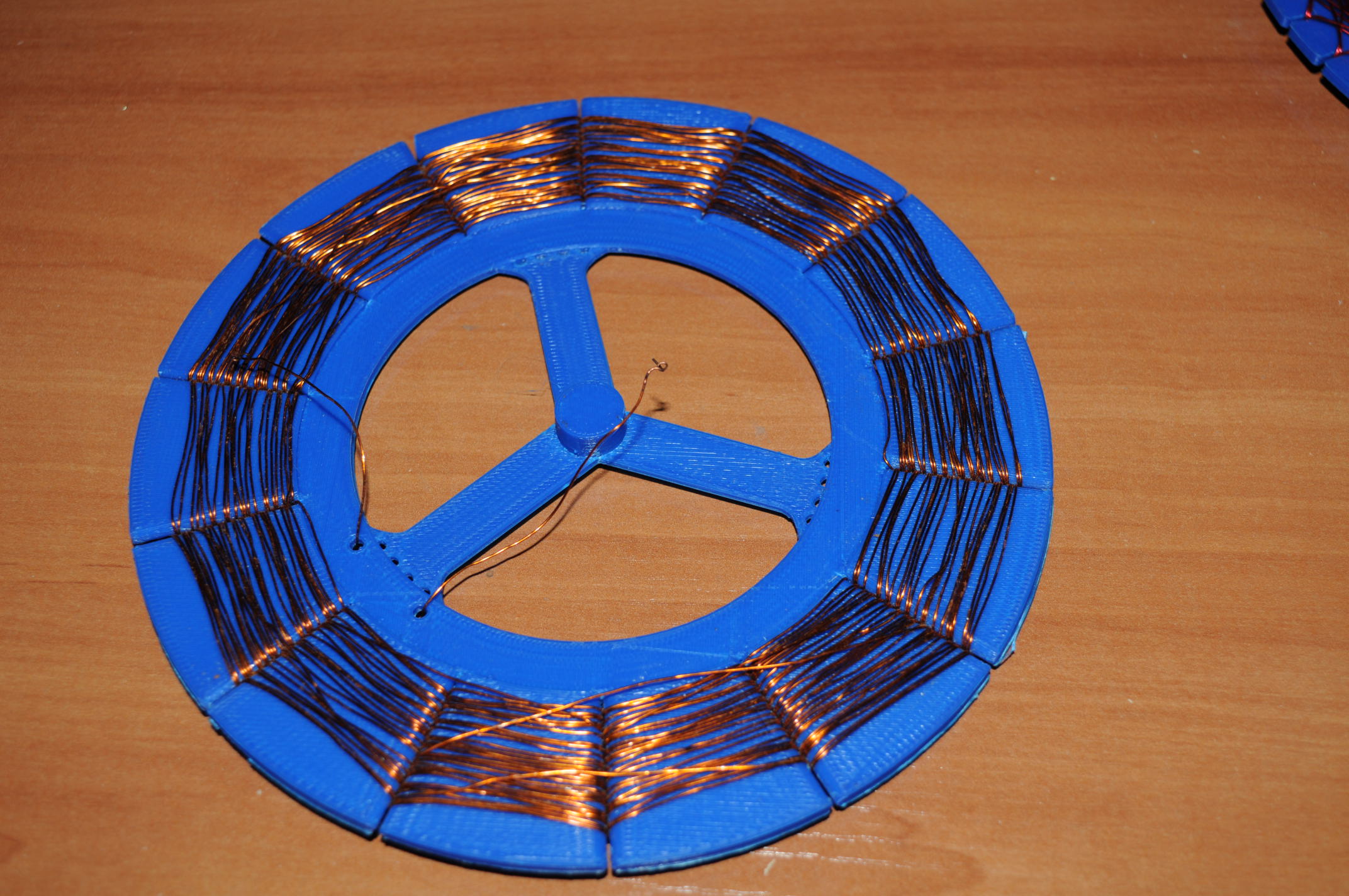

    Ive done a bunch of tests with different coils and so far the best working coil is 300uH (300 to 320uH) in the 7 to 8 inch range. I as well as other guys here have used a multitude of different wires.
    For my particular setups (modified for gold only) the 250/46 litz wrapped on a 3dss form has been the best performer (see pic below) with 175/46 litz coming in second then 24awg Teflon coated 7 strand silver plated last. All 3 perform well but the 250/46 with double sleeve seems to be best for my particular boards.
    Depending on how you build the MPP, that will be the deciding factor on performance. lots of testing is the only way to find whats best for your board.
    Just make sure and follow the build doc step for step and check each stage with a scope if you have access. I would recommend building it to spec first like in the build doc then modify later or get another board to modify.
    example coil = 3dss 250/46 litz 309uH

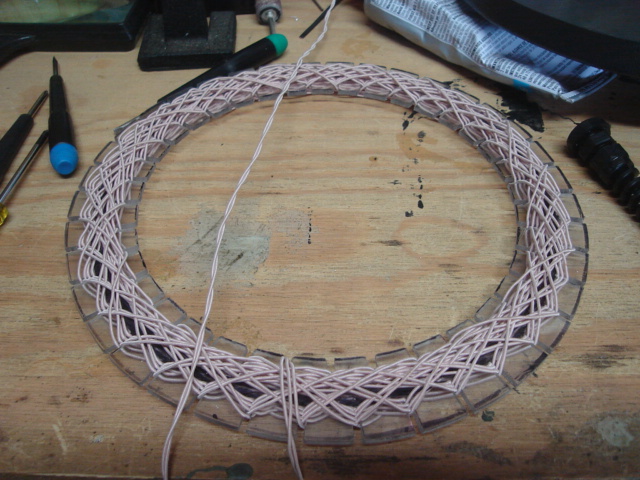

            what is ideal FAST coil. you try to get basket coil but use plexglass and plastic. while ideal is a wire IN AIR just cause
            nothing more the dielectric constant is lower of there is. ITS RULE BUDDY. so GOOD material NOT plexglass
            you doing big capacitor with, but simple fiberboard. JUST CAUSE F PHYSICS.

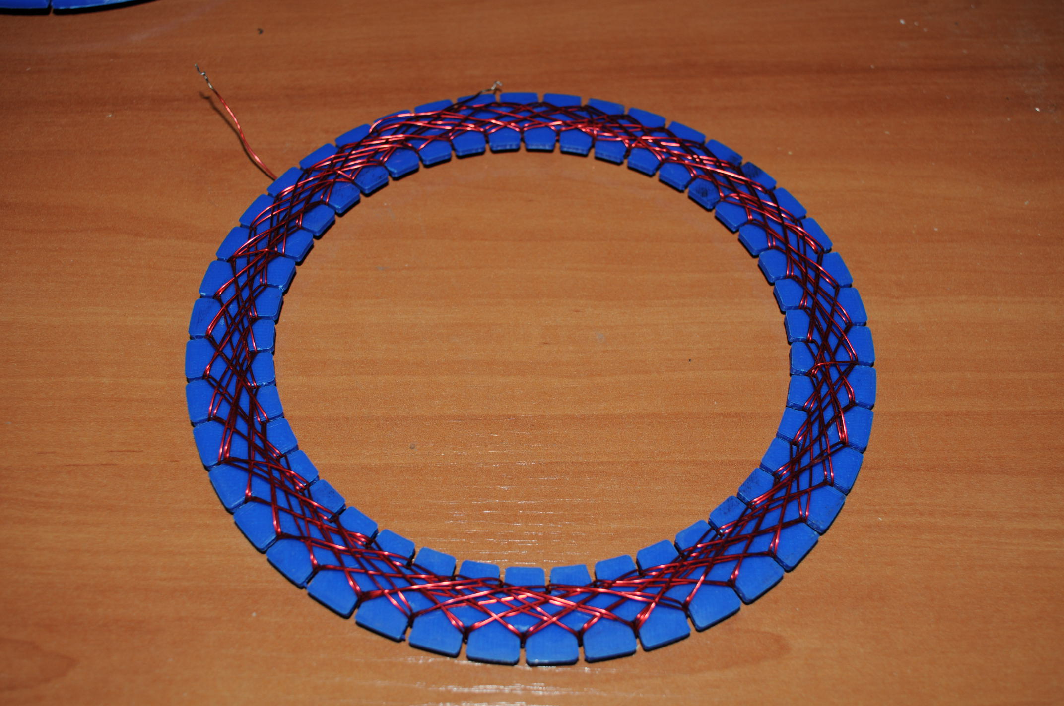

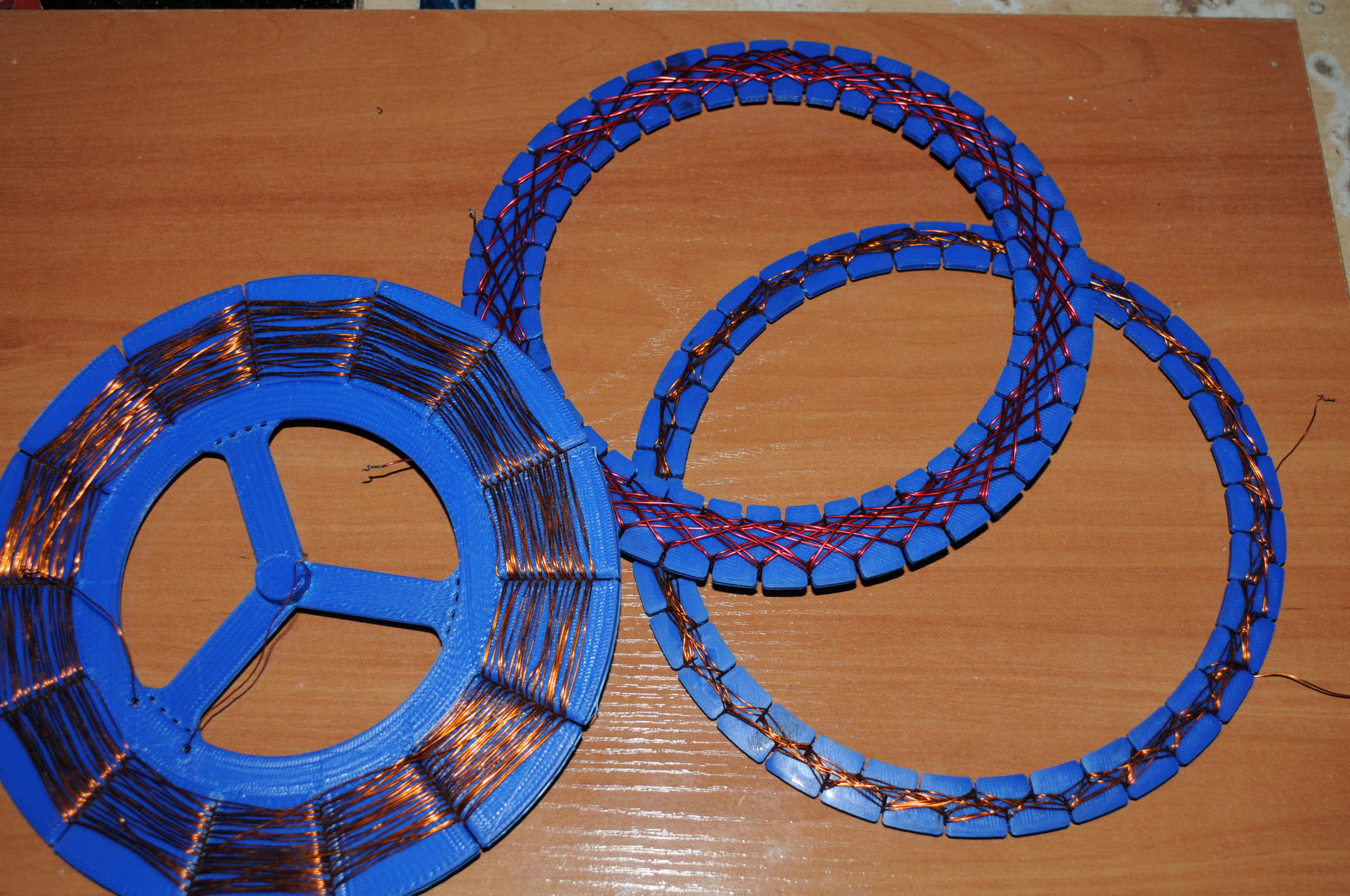

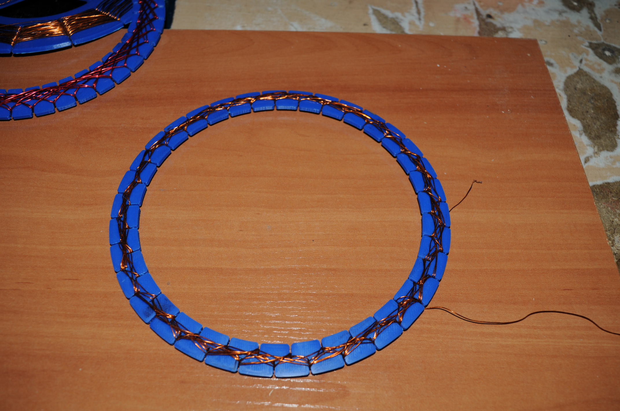

                    I see the basket coil you made, Is there a mono coil inside ? i have tried making a few but the thing is , im not smart enough to figure out what uH it comes out with, Example, Making a mono coil calculations is simply a matter of knowing the radius and wire thickness and number of turns, But i have no clue how to calculate for a basket coil, All three coils work ok with the surf pi, and Barracuda, with exception of the red coated aluminum magnetic wire, It simply over heats the mosfet on the Cuda, however they work no better but no worst then the mono coil i ended up, but much more time consuming to make.
                    As far as I know there is no calculator available for basket weave coils due to complex shape. You would have to measure some test coils with an inductance meter, and guesstimate how many turns are needed to create a particular inductance. Either that or you could simply copy someone else's existing coil which you know works. I assume that the one you tested on the Baracuda had a really low inductance, as that design does not possess a series current-limiting resistor. The maximum current could get quite high, causing the MOSFET and the coil itself to get hot.

                          You will need an LCR meter to measure the uH.
                          with the spider or 3dss coil (like I pictured earlier) it has 6 layers of 5 turns for each layer, x6 = 30 turns give or take, I measure after winding more than needed then removing a layer at a time, not cutting the extra but leaving it connected in one length until I am close to the 300uH I am looking for. usually it ends up close or in a range from 300 to 315uH and around 27/30 turns depending on wire used which in my case is perfect.
