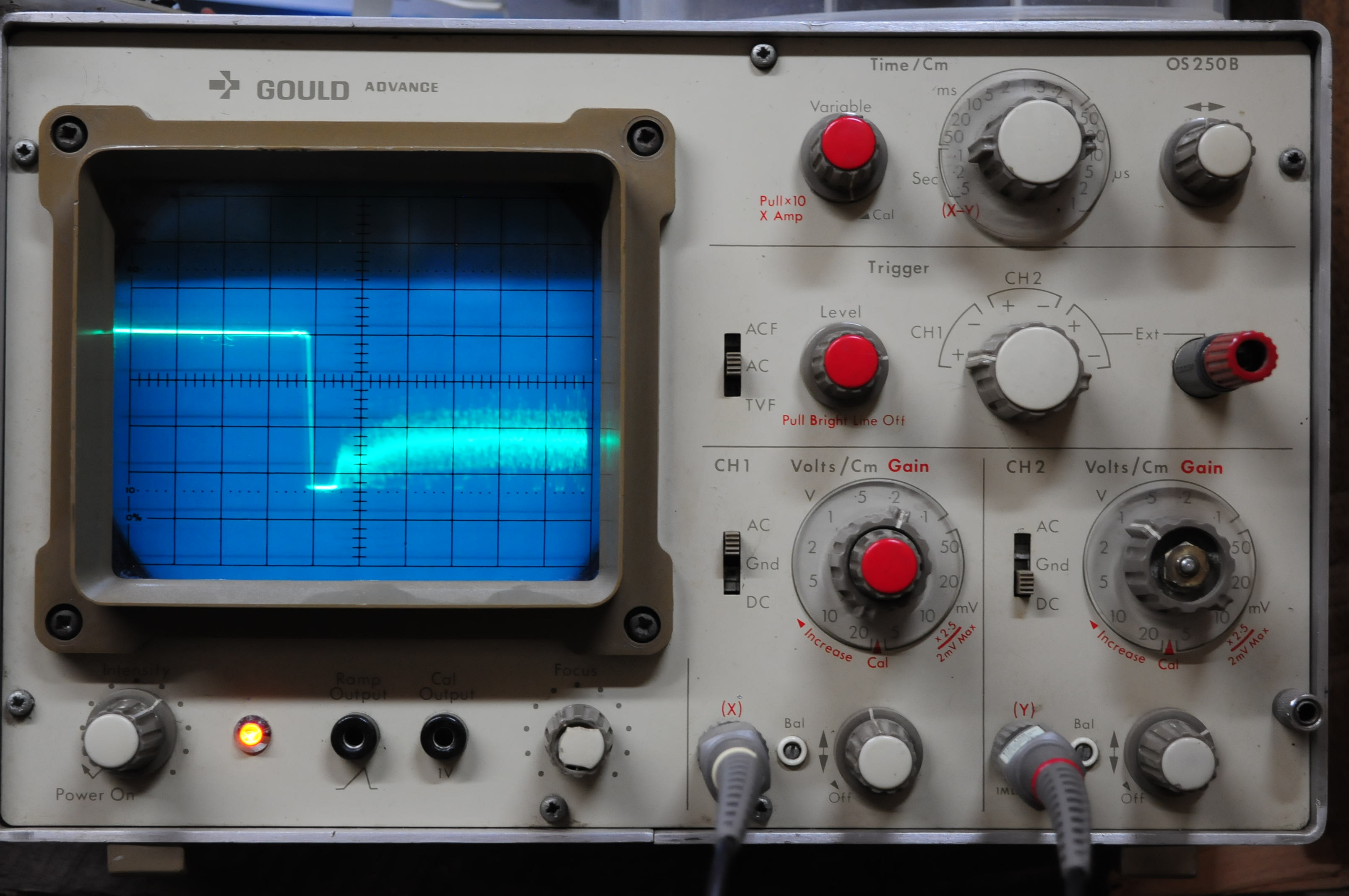

                    Yes Pin 4 Of u8 is at -5V , I replaced the 78L08 and it is also the same at 7 V, EDIT: Also the tail end of Tp4 on the scope is very dirty meaning the line has lots of noise in it passed the dip , I ll poste a photo in a few mins

                          Emmm Looks like some other signal is riding on your intended signal. Not just noise. Try to figure out what frequency it is. Stretch it out and see if you can figure out the freq.
                            would explain the poor performance, when I had put it all together a while ago I could swear I was getting more depth, hens is why I want to make a concentric coil. I will try to figure out the frequency.
                              Possibly to high damping R.
