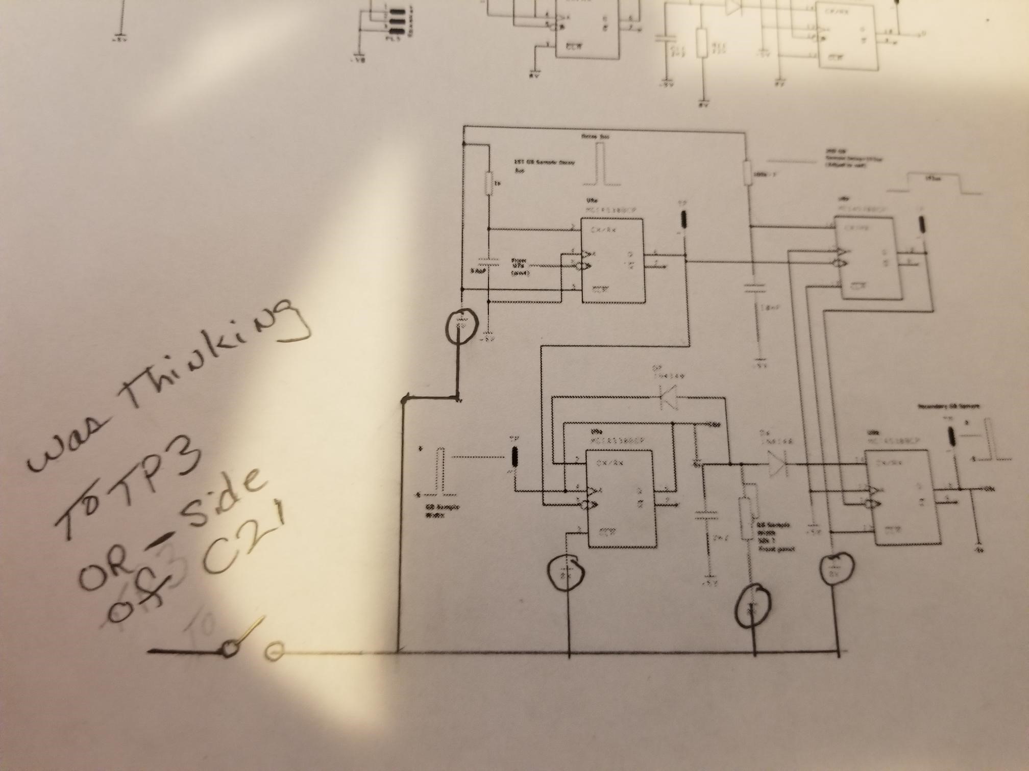

    So here is what I was thinking for the switch.Click image for larger version
    If we tie The 0 v in at a single location it will shut down the whole circut.
    Maybe a couple diodes at the transistors but that might slow things down too much???
    Hopefully someone with engineering knowledge can help answer that one for me .
    Pretty Please

      So here is what I was thinking for the switch.[ATTACH]44802[/ATTACH]
      Pretty Please
      That looks like it will work perfect, it would kill all voltage to that side of the circuit.. My brain dont work as good as it use to, didnt even think of shutting off voltage to it like that.
      I think youre right as far as diodes at the switches, that would change the timing if Im thinking correct..
      Nice job...
      Im probly not much help, just been feeling better so gettin back in to the swing of things...
      It would be nice to hear from one of the gurus though, maybe just to help sort out these little details.
      I dont think having the board a little bigger will matter to much. Even at 4×4 or a little longer one direction it will still be a decent size..

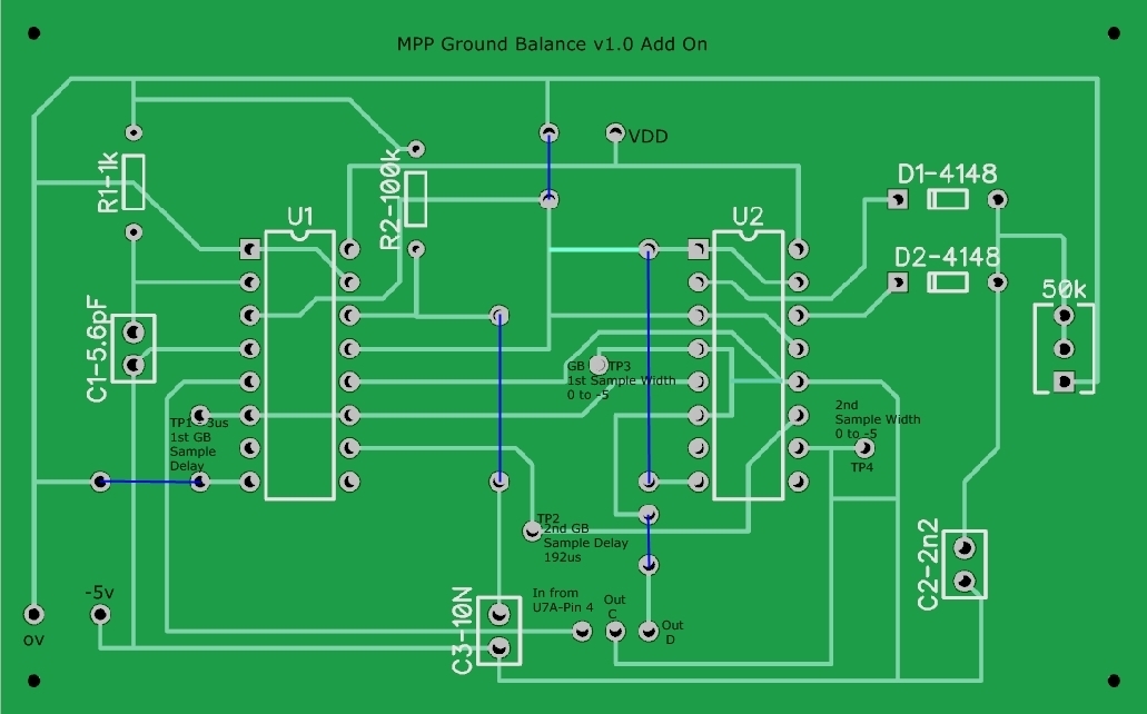

              Well, this is my first try at using a pcb software so it aint pretty and by no means perfect but I think I got it. This is just the 3d pcb of the circuit from Digger429 along with what he described as the changes he was making. look it over and let me know if it you find errors or if it looks good to try out. it is just made as an add on board for now.

                Hi Geoscash,
                Thanks for doing this .
                I took a quick look at it looks like you got it all. I just see one thing , on the signal input pin 5 u1 would be from B on the schem, Is that going ot a switch or pot there?
                Looks like maybe just a row of input pins and or testpoints.

                  Those 3 pads are, from left to right are:
                  In from tp7 (pin 4 u7A on primary board)
                  Out to C (addon transistor j113)
                  Out to D (addon transistor j113)
                  I just wanted to put them all as close together as I could to make wiring it easier. Hope thats correct. The way Im reading it, you would take your signal wire from tp7 (u7A pin4 on main mpp schematic) to pin 5 of the GB addon board which in my other mockup I labeled u8. I should have put "from tp7" instead of pin 4 maybe.
                    Ok my bad I didnt see your 3d view I was looking a the circuit trace pattern on the gerbers you sent. I should have pulled all the layers.
                    Looks good to me much more organized than mine was I was just trying to get as many traces without jumpers as I could.
                    Figured I would make another after working out the bugs.
                    Thanks again

                                Also, just caught 2 errors, I missed two 100n caps, between pins 1 & 16 on both uc's so I'll correct them tomorrow.
