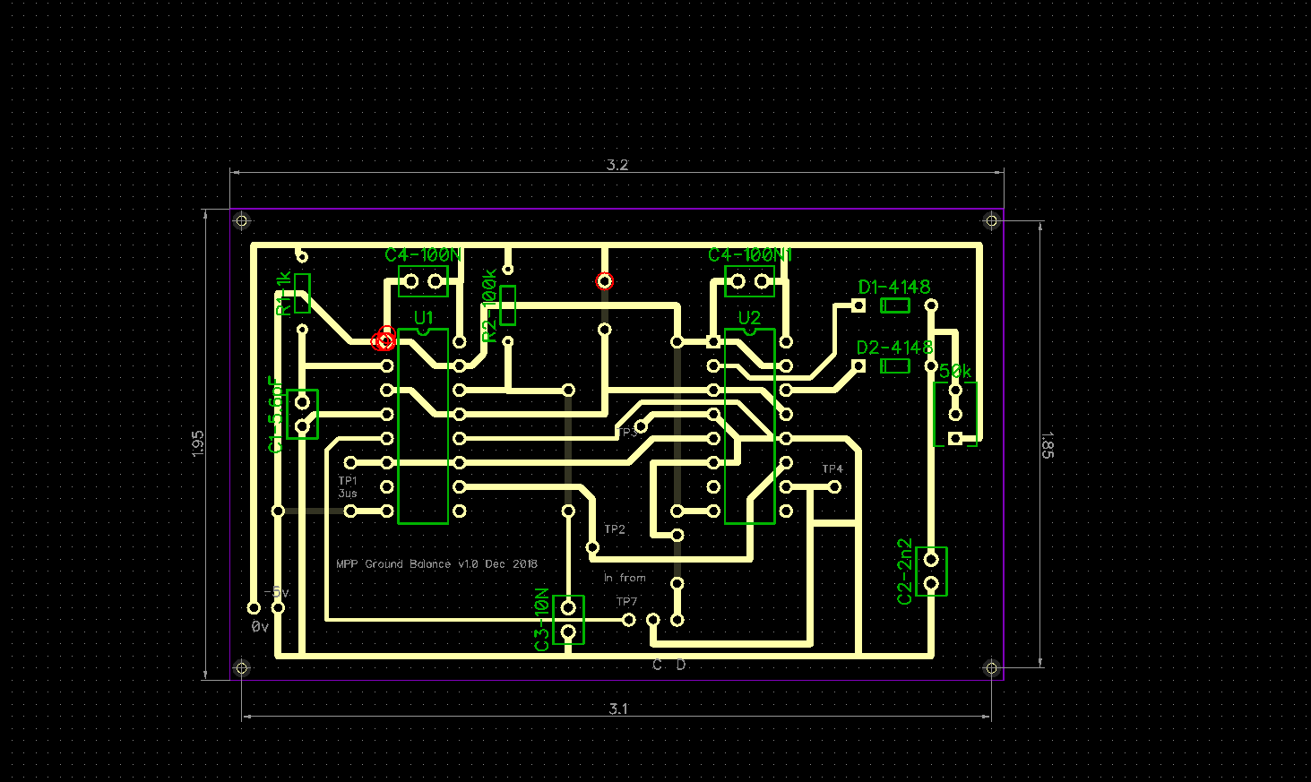

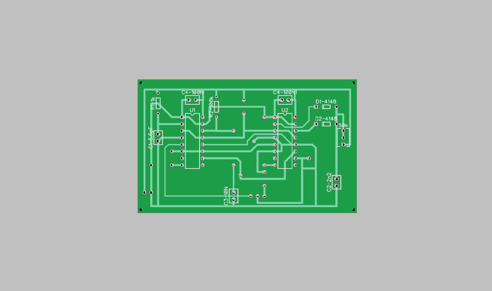

                    You guys been busy....lol.. all the while I was fixing my mistake on it too... So, I added the 2 caps that were missing, double, triple and quadruple checked it this time.. all connections are based on Digger429's hack and using the minipulse plus rev D as the base.
                    Check it over using diggers draw and the revd mini pulse schematic.. No guarantee it works, just wanted to help try to get this project working.

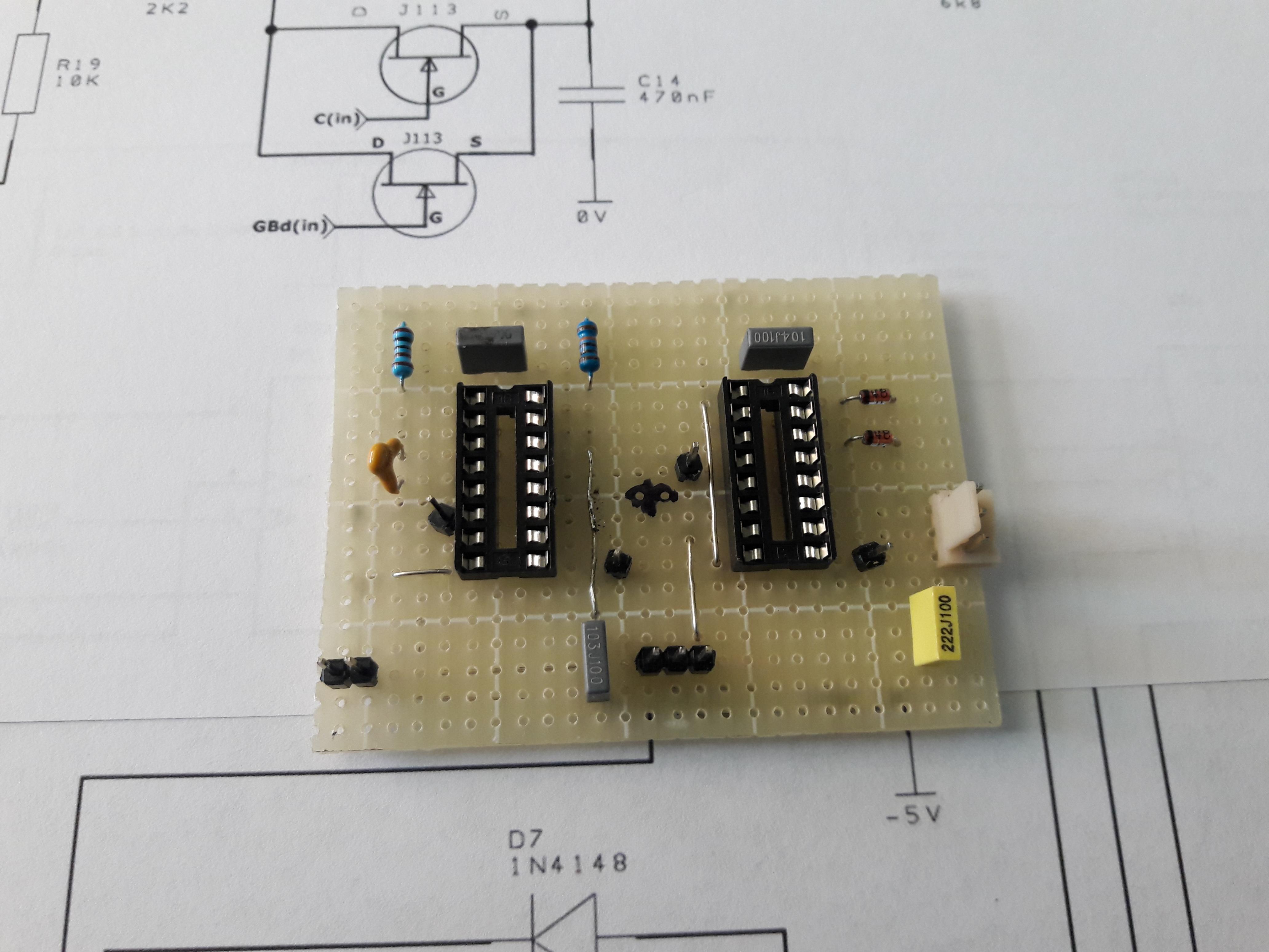

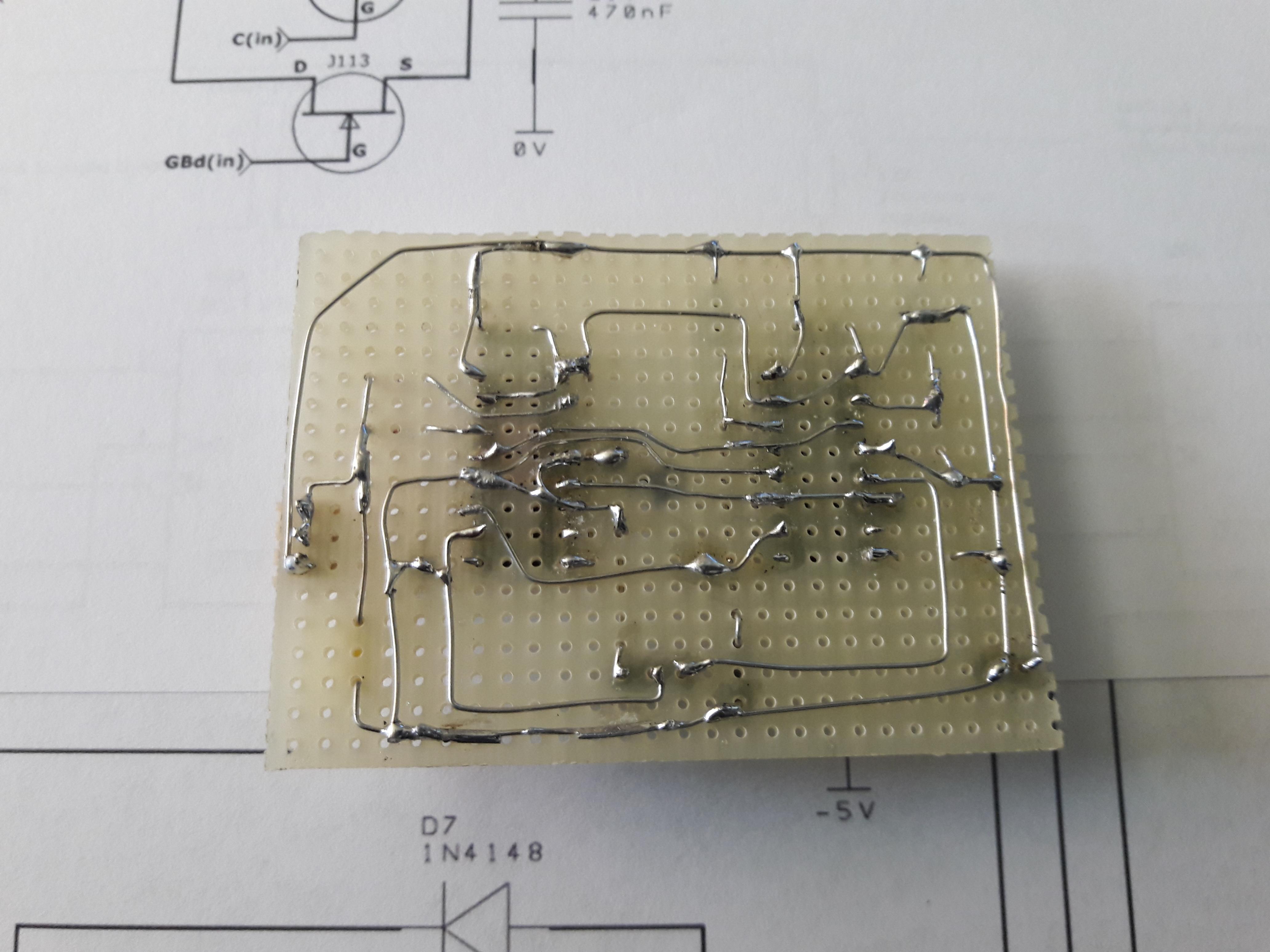

                      Well, was finally able to finish up getting this handwired up.
                      Will try to get it wired to my mpp and see if/how it works.

                        Do you have a 3d printer ? I was looking at the bottom board, It gave me an idea for a easy bending tool, for your wires that would give them straight lines and perfect 22, 45 and 90 degree bends. Not that I'm saying there is anything wrong with yours, I just gave me a idea that's all.
                        • #42
                          No, I don't have a 3d printer but have been looking at a few of the smaller units and will more than likely get one one of these days.

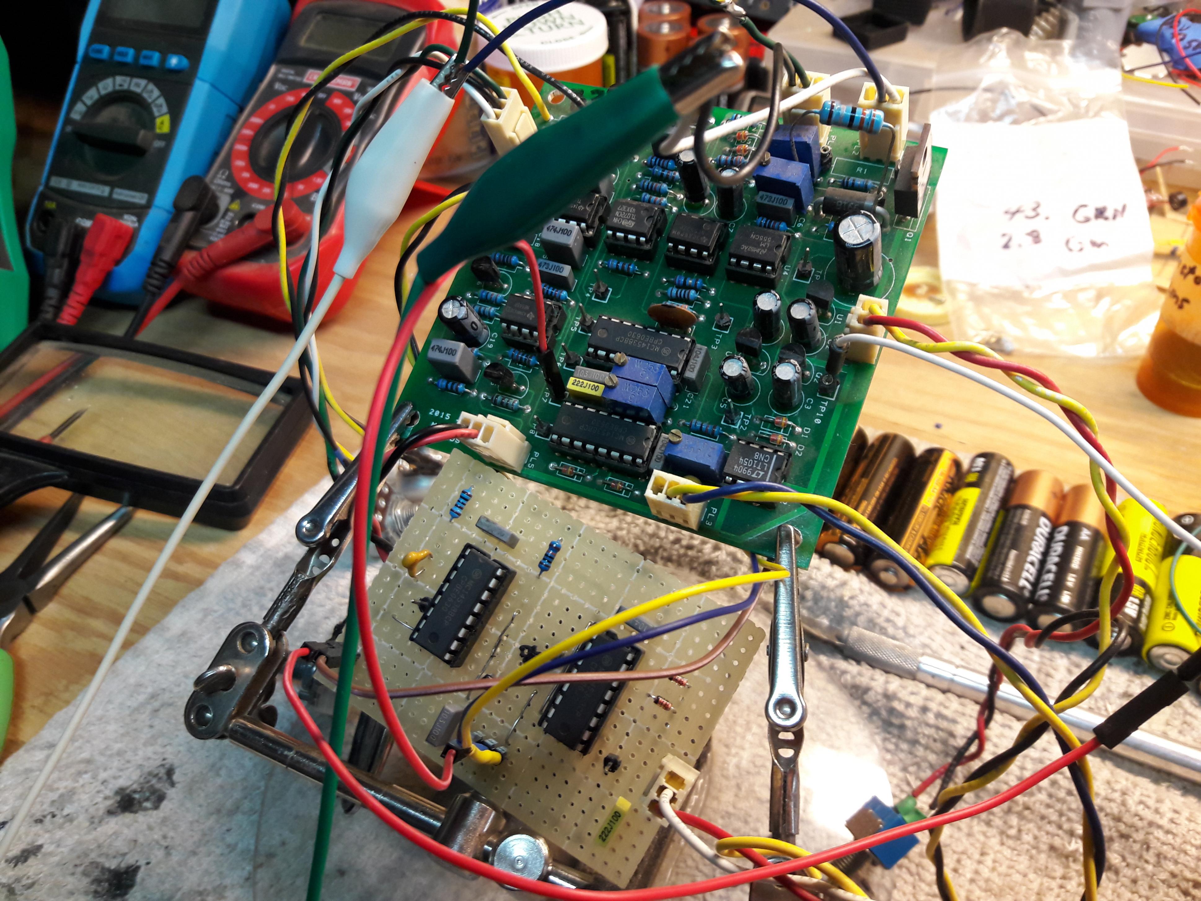

                              hey godigit, nah, I just did the final mod that digger did. removed the 1M trimmer and left a 1k/5.6n for the 3us on the first sample and used a 50k pot for the panel for the 10us to 150us adjust. I got it all hooked up and it is working as we speak. Although, using a board that is on the bench and a coil hanging from the ceiling isn't going to be good for testing. I will check the measurements today sometime to double check that it is at the estimated 3us/190us and check the pot adjust for its range as well.
                              It definitely changed how my bench mpp operates and it seems very touchy to adjust with the krinaz mods I have done to it. At full open on the 50k pot it seems to give it a similar sound to a minelab, it wobbles somewhat and seems to have a higher tone as the object being detected gets closer then it disappears. At full closed it definitely loses depth in detection and almost acts like an SAT pot but super fast. Detection lost is variable depending on the target used but it seems a fair compromise if it handles hot ground. My air detection depth with a US nickel without the ground balance plugged in was at 10 inches. With the ground balance plugged in that drops to right around 5/6 inches so roughly half lost.
                              I think really the only way to test it is to box it up and take it out to the field for a true ground test which unfortunately I wont be able to do right now. It would be easier to modify one of my other mpp's that is already done then to box this one up...lol
                              I'll keep messing with it though.. Anxious to see how your board comes out too. I assume you have left it with the original digger drawing with the trimmers on board???
