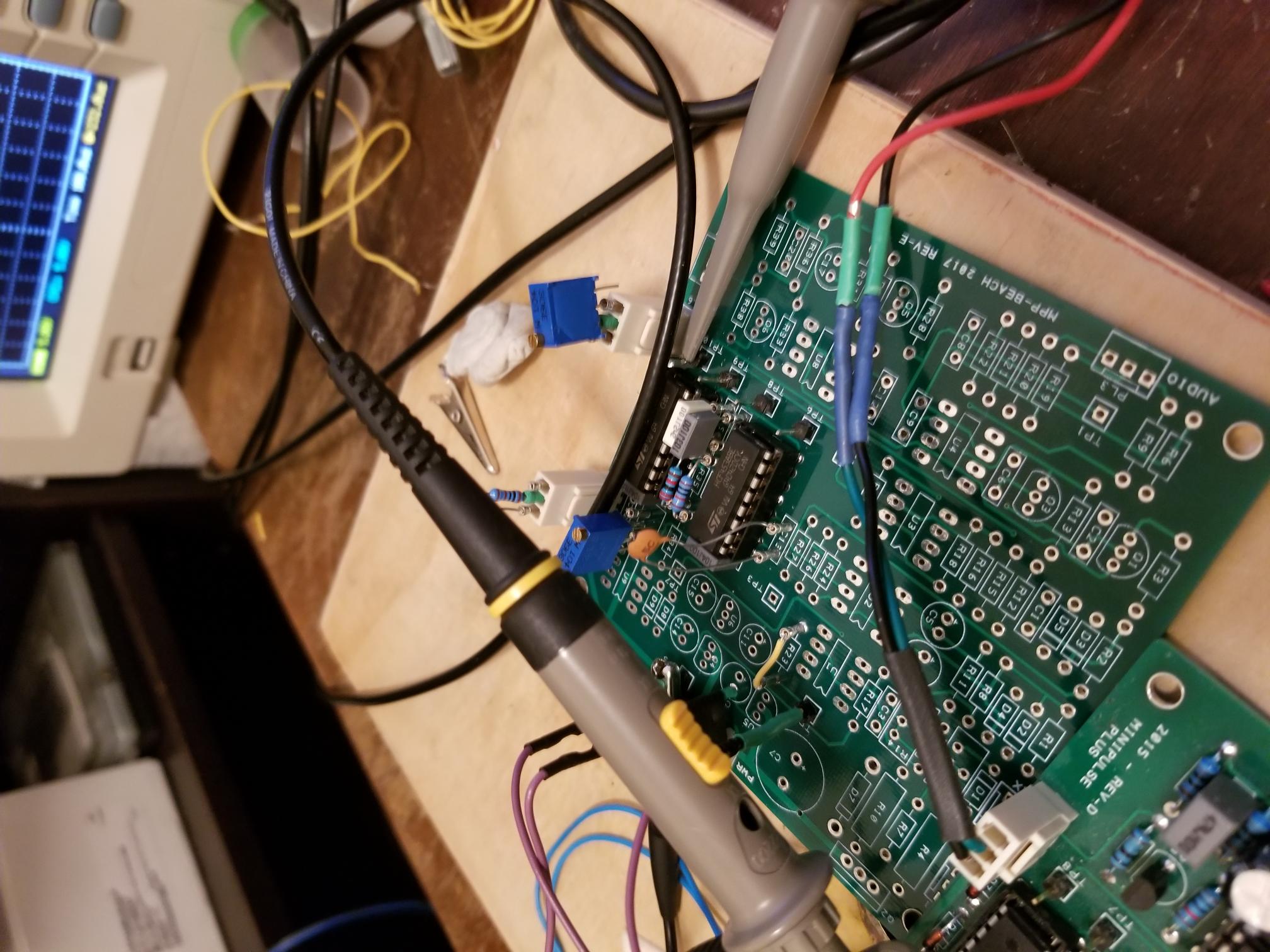

                Hi Geoscash
                I think I may have figured out at least one of our problems.
                I finally have a working sample generator.

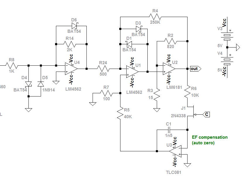

                I had a extra MPP beach board I had bought when I ordered my kit so I figured that was the perfect proto platform for working out this circut.
                With the Mpp Beach board adding another integrator may be easier if needed.

                Triggering at tp 5 with my MPP 1st sample delay set to 10 us and second delat at 114us with a sample duration of 52 us.
                On the GB board my first sample delay is at 16us and second sample is at 128us. Sample widths are adjustable from 58 us to 234us
                The other benefit to using tp5 is that the sample delay is adjustable in unison with the sample delay pot.
                I still have to dial in the timings to get the 3 us delay, right now its at 6 and the sample withs are a little fat.
                Can anyone tell me what the pulse duration should be of the ground balance samples? On diggers drawing it shows a -5 ?
                Im not sure if thats a error of we want a 5us pulse.

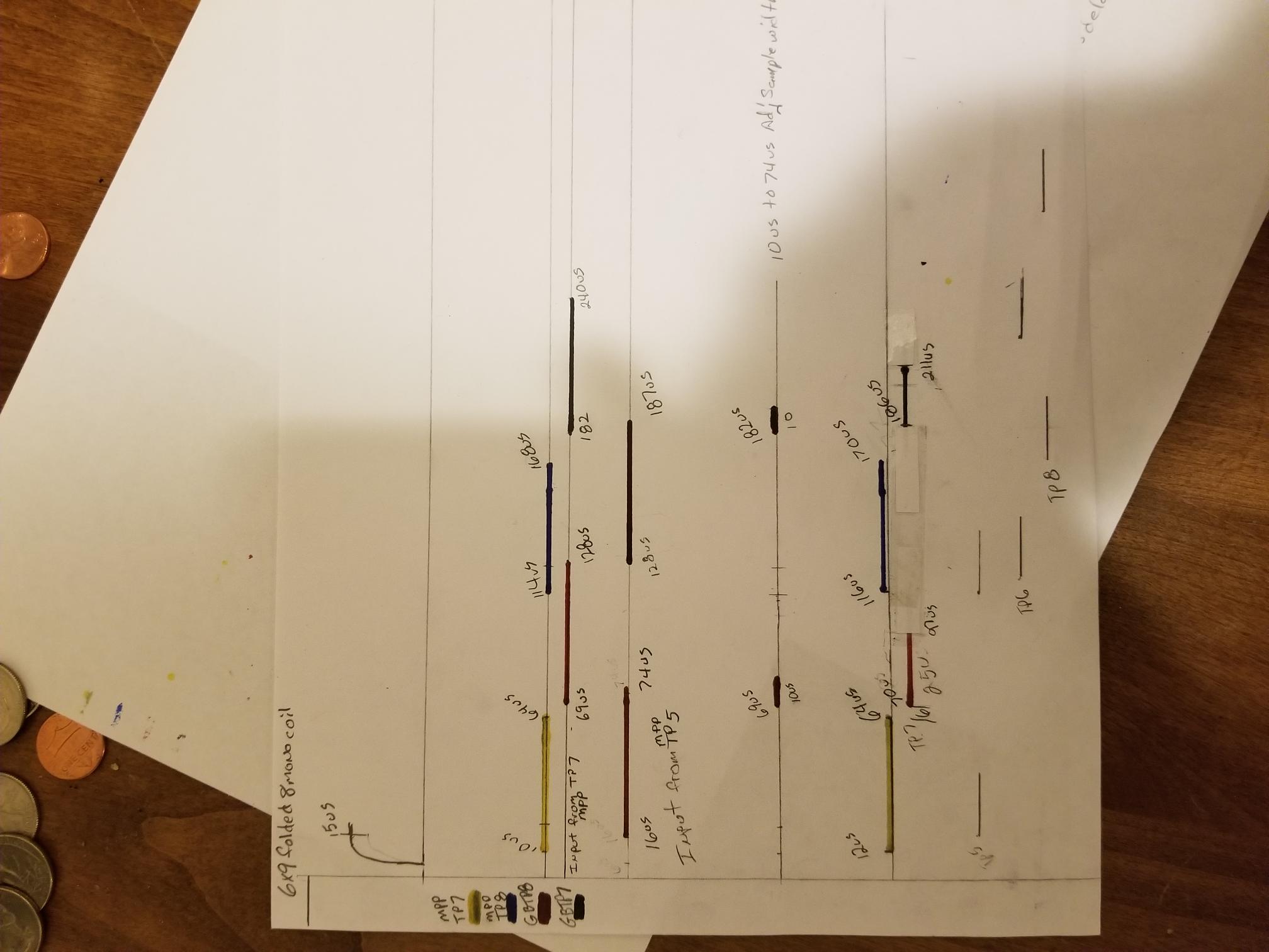

                    Ive got it all hooked up and it works but I know the timings are not right .
                    Also was wrong about triggering off tp5 Im still trying to learn all this.
                    Ive tried moving samples around a bit and so far I cant get it totally correct.
                    Here is a drawing of where I have the timings at now!
                    The top row is where I started out with diggers component values.
                    Bottom row is where things are now.
                    I changed the R11 resistor to 2.2k and made the Gb sample abjustable down to 10us with a range to 74us.
                    Added a 10 k pot in place of R10 but, this gives me some adjustment to second sampe spacing but I need to be able to move it more.
                    Im using a MPP beach as the Gb board everything works but im not able to get any adjustment from pl 6. Ive added the 1 k resistor as suggested and kept the pot and for c8 I have a 5pf cap.
                    Unpluging this cap makes no difference with any of the timings.
                    Performance actually seems just slightly better with the GB turned on but with the GB turned off the MPP samples are being broadcast to the GB board. Doesnt effect performance but a half amplitude timing matched signal is feeding back to the GB board. Someway to isolate them would be good or maybe a switch there as well.
                    I still need to get some hot ground to test with as well so I dont have any results for if its actually working or not .
                    My guess by the timings is its not.

                    I would like to get the timing as close to Carls example in post#68 of the Ground balance Thread where Davor introduces his GB solution.
                    Post#
                    Im still trying to learn just how things work so if someone could help me with a couple questions It would be greatly appreciated.
                    What components should I adjust to specifically move sample spacing both for target and EF independatly?
                    And not so related but related On Davors GB circut,
                    Does this gb module completly replace the sample timing on the minipulse or just piggy back on?
                    And on connection of his GB circut is VDD reference to -5?
                    I have all the components to build his balance module as well and it looks really good so since Im in learning mode, might as well try that as well.

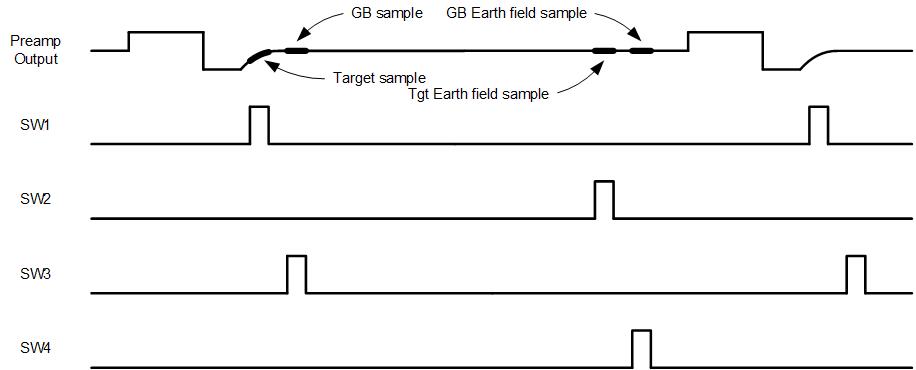

                      Hi guys, long time...
                      Just a quick note. All GB schemes, including mine, work by means of splitting the tau range into two, one positive, one negative, and a zero in between them. Because of dual polarity, the simple detectors that have only a positive signal detection will not see the negative values. Detectors that come with GB all have an absolute value circuit prior to sound generation, but all of them have a zero. Fighting a zero is possible if there are two signal paths, so zero in one path will not affect the other channel. It all makes things more complicated, and detection near a zero loses sensitivity.
                      In case you are after small gold, a simple scheme without absolute value will be good, since all detection happens on the positive side of a signal.

                          Too many pulses. Within 1 period the EFis actually equivalent to amplifier offset. Cancel the offset when SW4 is high and you don't need any iffy differential integrators that require tight tolerances. A simple integrator is then good enough. You also don't need to separately cancel EF for the ground balance.

                            There has been much discussion of various GEB methods.
                            I used the Three Sample method on my HH2 and it works very well without any mods to the analog differenctial integrator.
                            Read about his method (with links to original discussions) in my thread here:
                            https://www.geotech1.com/forums/show...ake-on-the-HH2
                            I do use a microprocessor to generate all timing pulses and user adjustments. This allows easy to change methods without messing with all those hardware timing chips, multiple channels, etc.
                            I do not understand why everyone keeps using these timing chips that are a mess to make changes.
