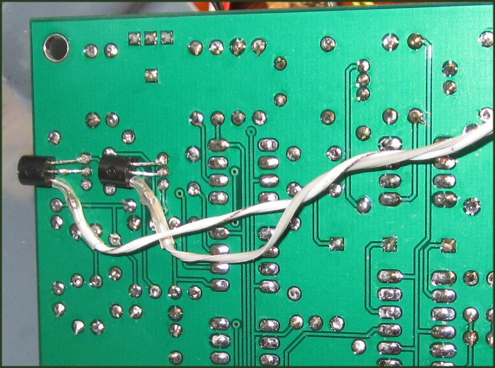

          Having been away from the forums for a few months, I come back to some questions being asked. Hopefully I can clarify here.
          The on/off switch for the GB is indeed a two pole switch that just switches to ground. That is, the grey and white wires going to the FETs in this picture here...
          ...are switched to ground.
          The two potentiometers (blue circle and pink circle) that geoscash1 asked about in post 6 no longer exist. Neither does the potentiometer at top left, which is now fixed timing by a resistor.
          Here is a diagram of the timings I've setup, so I can run the machine at about 1000 pulses per second:
          After two trips into the goldfields of Victoria, I've decided its about as good as its going to get. Anything from here on would be a complete redesign from the ground up. It is now able to completely cancel out the ground, but it comes at a great cost of reduced sensitivity and the "hole" where gold samples can completely vanish from detection. In practise I found myself having to turn the ground balance amount down to as low as possible without the ground interference becoming too annoying. Aside from the on/off switch, thats the only GB control - the potentiometer "GB sample width" that can provide 8 - 245 uS of sample.

          • #65

                Second attempt at images. This time I'll just link externally to imgur.
