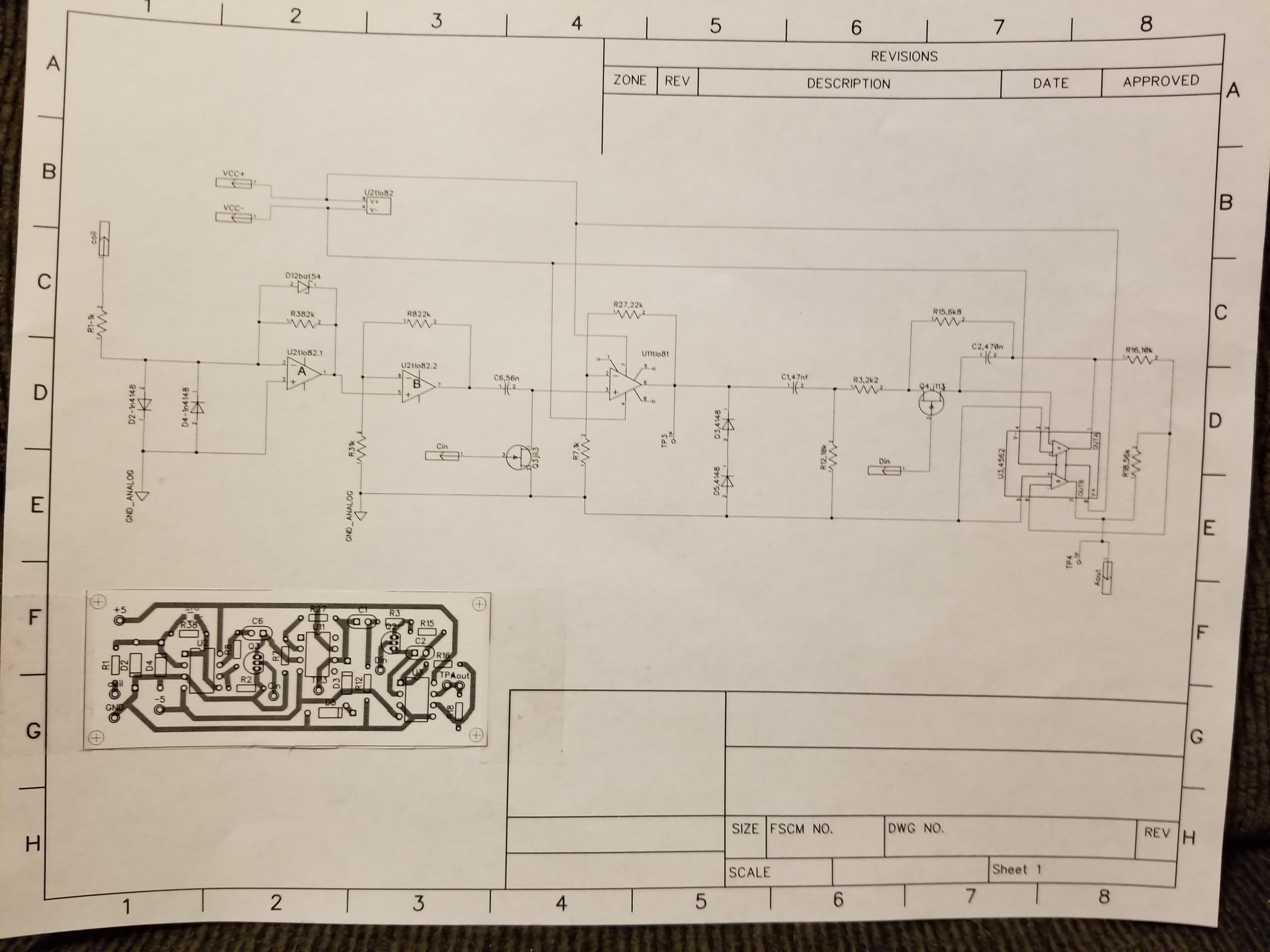

        Thanks for doing this it looks very good on the scope.
        I was trying to put together a pwb and when drawing a schematic I found a question.
        Im not that experianced but dig following along with you guys so pardon my inexpertiese and spelling.LOL
        On u11 is that a second tl081 ? I cant see it on the datasheet Maybe a tlo84?
        Thanks again

          U11 should be a single op-amp with low noise and at least 10MHz GBP (Gain-bandwidth product in the datasheet), I had the TL081 in mind.
          The trace is a simulation. Unfortunately I haven't got the time to tinker with hardware, if some of you care to try this please report your results.
            MAX412 would be great for this preamp.

                Here is a pwb for your new integrator design and for anyone who wants to follow along.
                I wanted to make it easier to try different amp combos.
                I still have to get some parts before I can build it and test it but Ive double checked it twice and it looks good.
                If anyone else could give it a eye that would be great. I will post the schematic i used in the next post I forgot to compress it.
                I have not been able to find a bat 54 that is not surface mount so I placed it on the back side of the board.
                Thanks again
                  Here is the Schematic.

                    You can use BAT85.

                        Interesting. The two stage pre-amp should be an improvement.
                        What is the timing of the FET switches?
                          The timing of Q3 is the same as the timing of Q3 in the MPP (signal "c")

                            I woudl swap U3 (LM4562) with U1 (TLC082) because the LM4562 has lower noise and higher bandwidth, which are ideal for the input stage. TLC082 has JFET inputs and low offset, ideal for integrators.

                                Thanks Teleno,
                                I will fix the legend on the board Thanks for catching that . Good thing there the same pinout.
                                I already added thru hole connection for a bat 85 as well.
                                I will also post a connection schem to the MPP when I can.
                                I have the board etched but have not had time latley to do much else.
