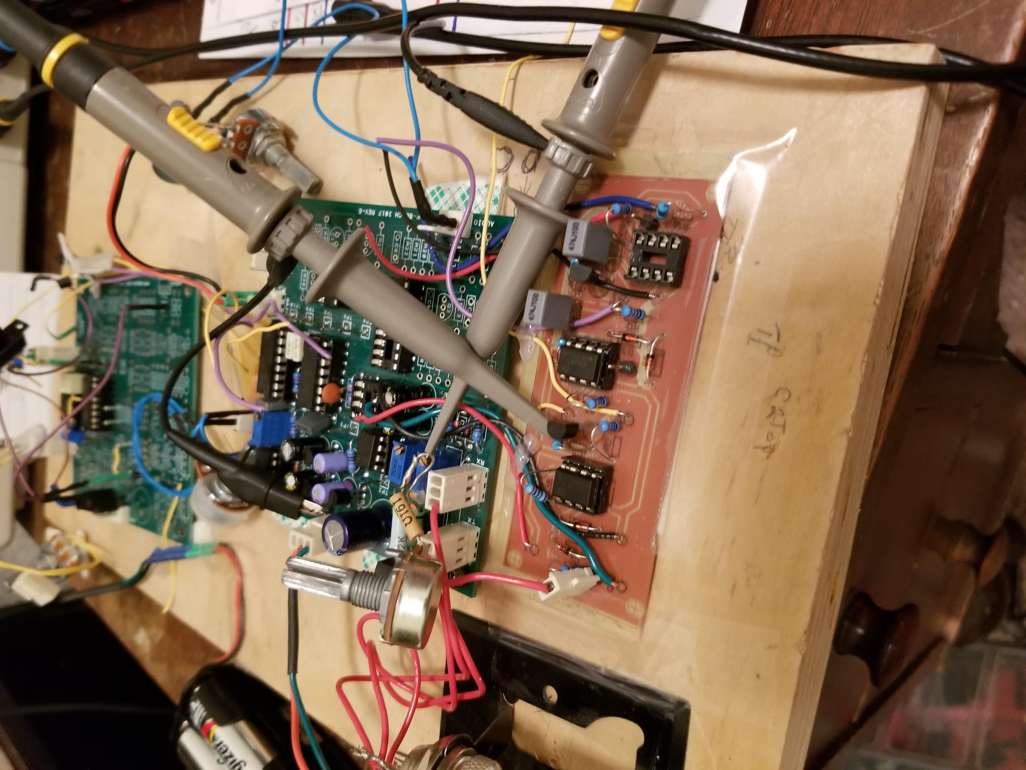

          Hi Teleno,
          Parts will be in tomorrow.
          I was looking at my board and comparing to the rev e schematic and on the +and - inputs for the 5532 there are caps and resistors C4 R24 C5 R 11.
          Should I delet them and tie directly to both rails? Thats what I did on my Pwb already.
          The sample integrator is direct on the current MPP'S.
          Im wondering If I should keep these caps or replace with a metal film maybe?

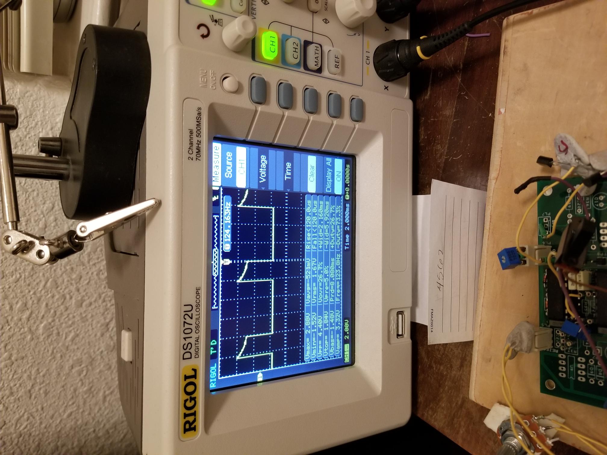

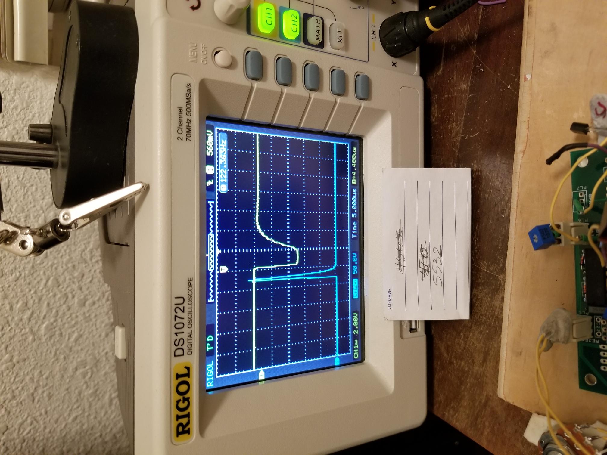

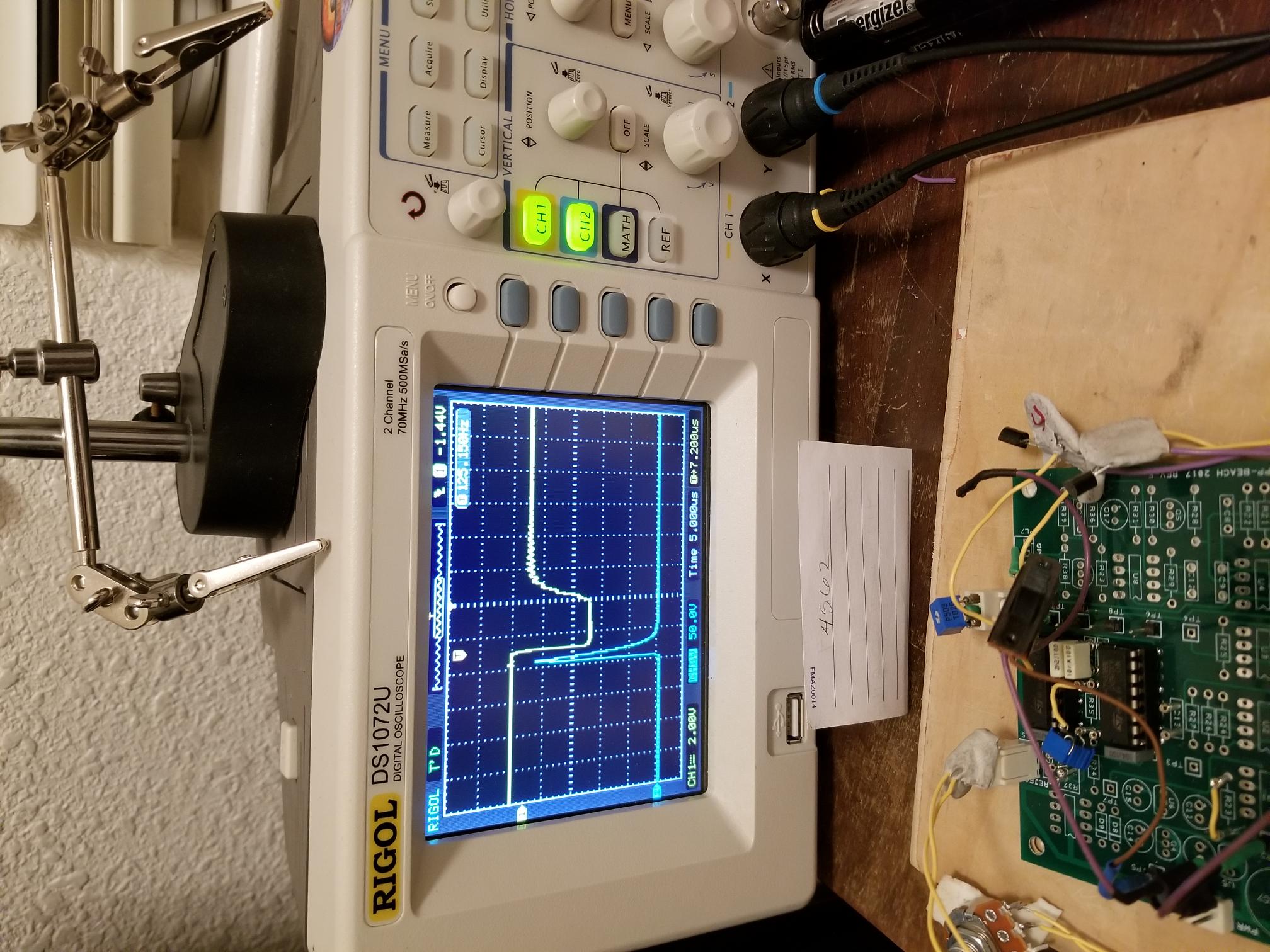

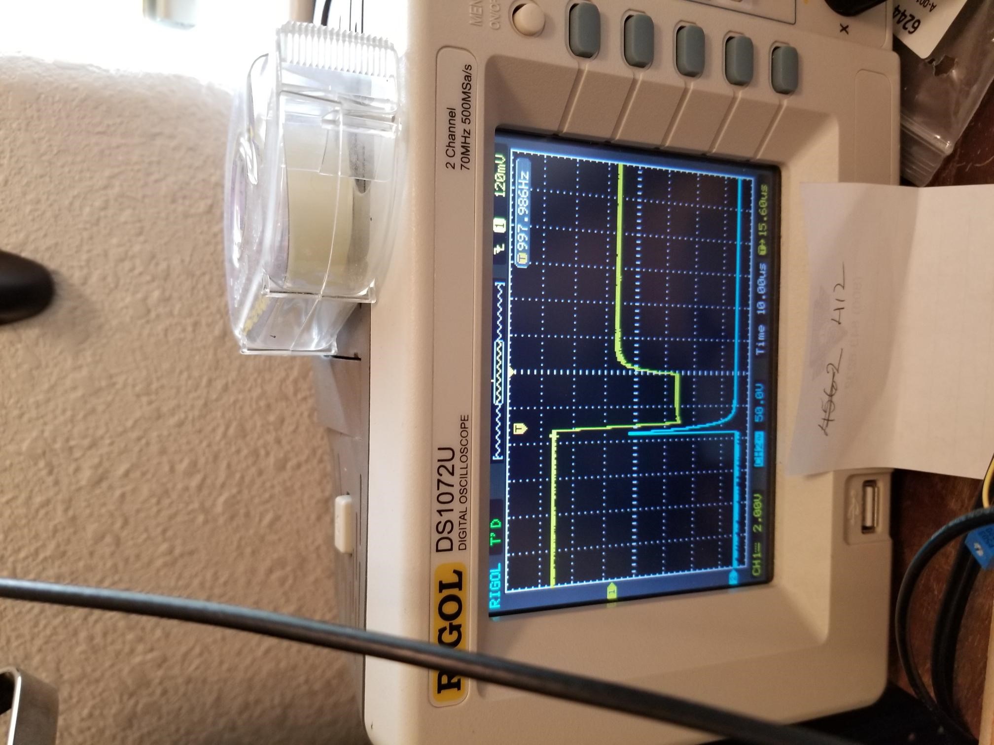

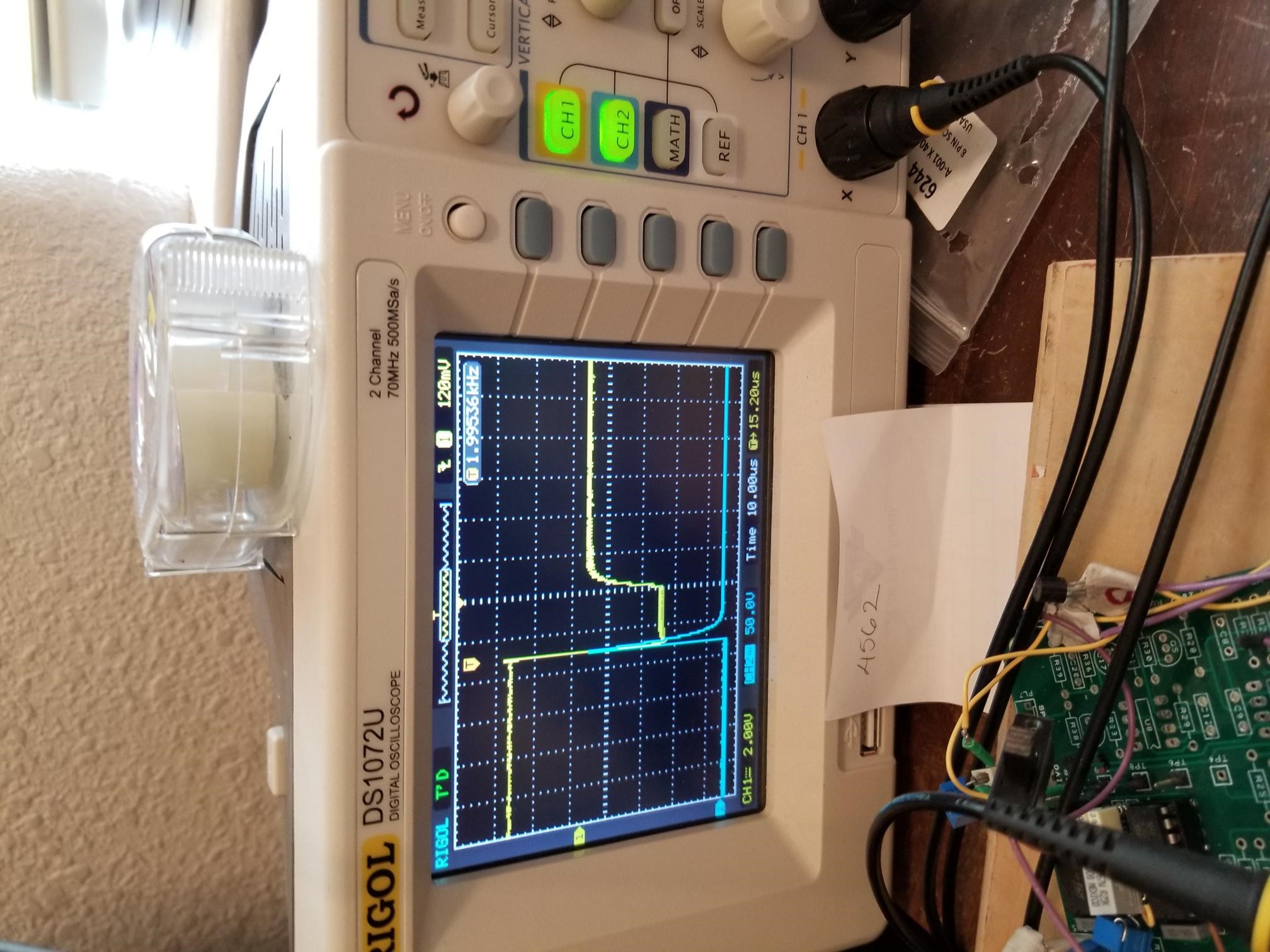

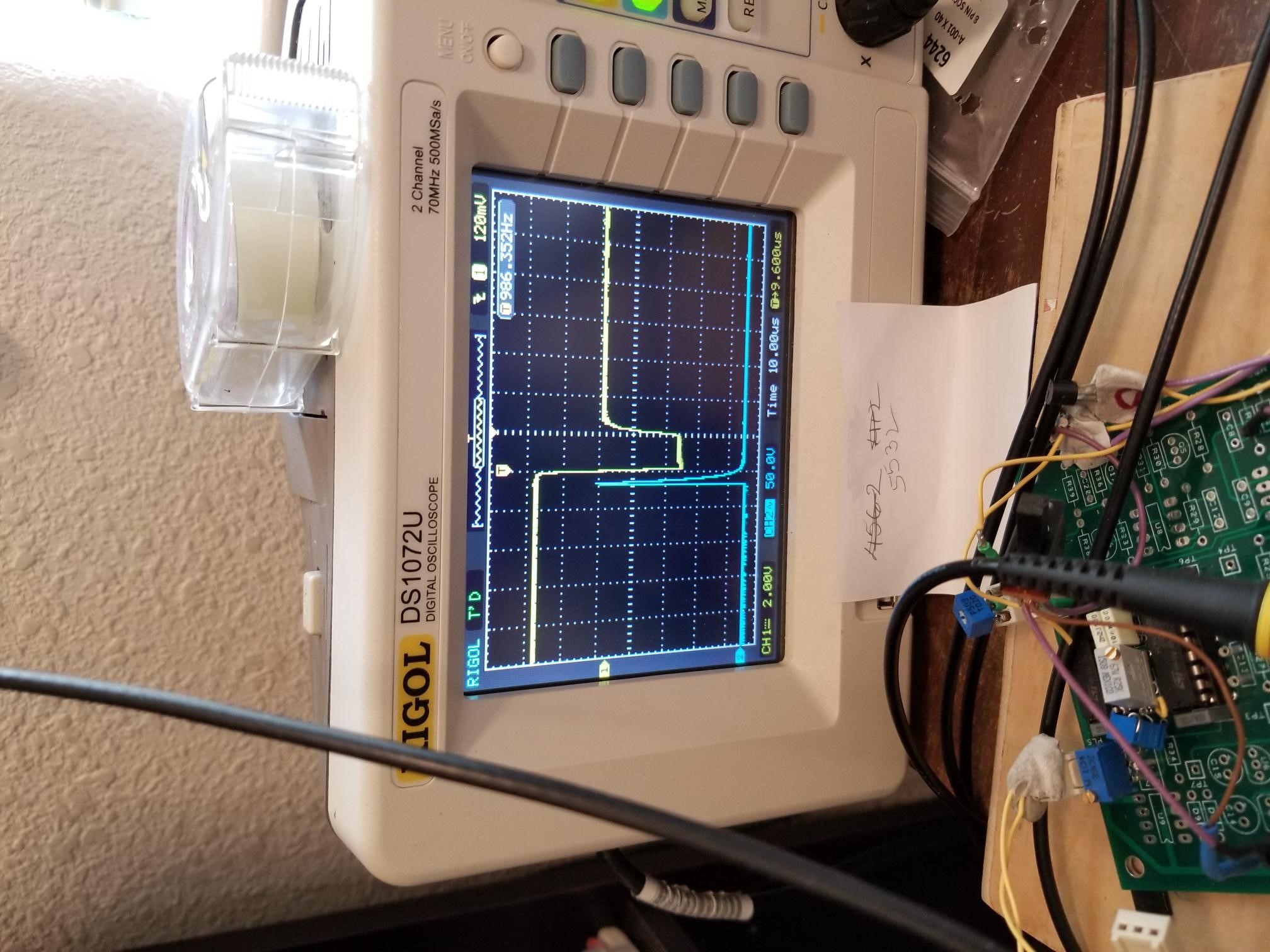

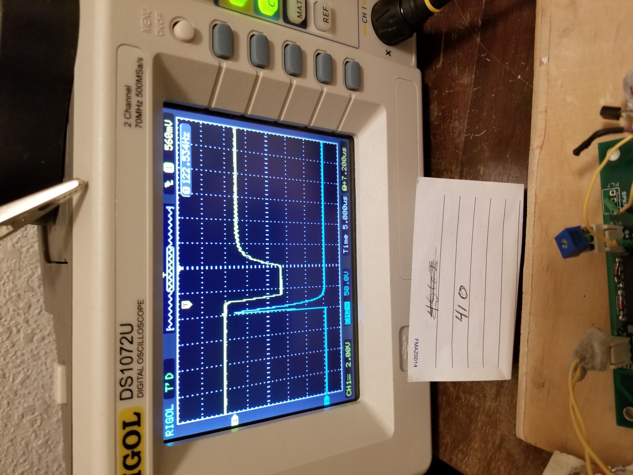

              I have the circut up and running and its a definate improvement but wave forms are a bit different so Im not sure if its totally right yet.
              Suprise is Thhe 5532 is doing the best.
              Ive tested A 410, 4562 and the 5532.
              Started with a MPP beach Just built to the sample integrator.
              Im using a Digger John 6x9 folded mono coil to test with and its not the fastest.
ID:	353556Click image for larger version
ID:	353557Click image for larger version
ID:	353558ATTACH]45667[/ATTACH]Click image for larger version
ID:	353560Click image for larger version
ID:	353561Click image for larger version
              The first three photos are of the stock Mpp Pre amp .
              Each was damped the best I think I can.
              The rest of the shots are of the improved pre amp just after U2. Currently I dont have C6 inserted. Ordered the wrong cap.
              The Square wave is after the added pre amp. Is this Correct?
              You can see a definate time improvement especially with the 5532. It seemed the cleanest as well.
              I dont have too much time now but will get better coil stats and readings later.

                Thank you so much for proving my concept!
                Regarding your measurements, I think you should take the peak of the blue waveform (Tx transient) as the time reference. You're using the left edge of the Rx signal, whis is affected by the slew rate of the op-amp. The left edge of the LM5532 starts later that the other, faster op amps.
                In the mod, the time from the Tx peak to -1V relative to the baseline is 11us for both the LM5532 and the LM4562. This is an improvement of 5us over the MPP, which has 16us delay for the LM5523).
                In any case, the coil seems slow and that's why all op-amps fare similary. I also see ripple in all the Rx waveforms, it would seem the coil is underdamped. You should have adjusted damping by varying R4, leaving R1 untouched at 1K.

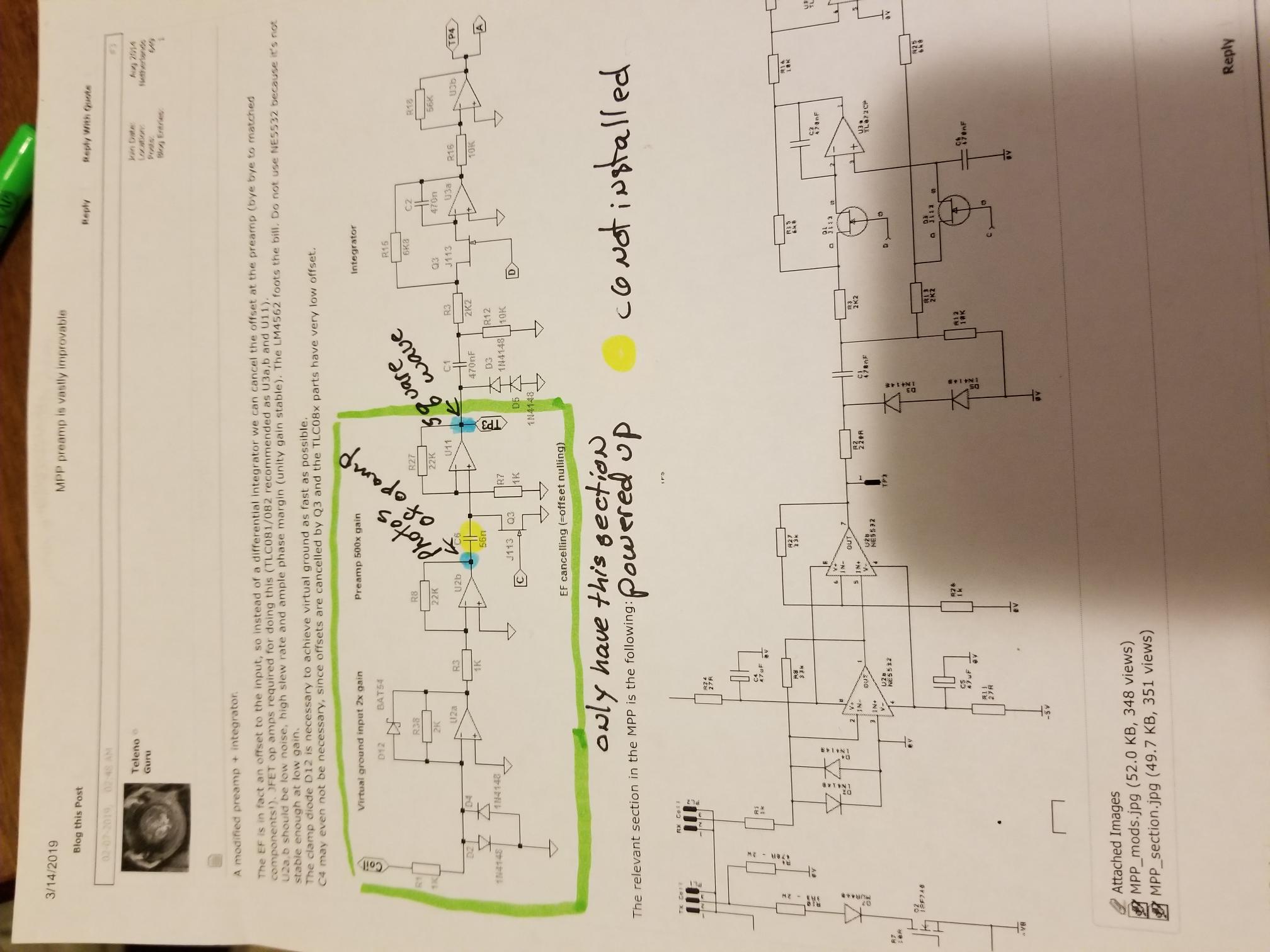

                To which node does the square wave correspond?
                  Hi Teleno,
                  Thank you for the design.
                  This has been a helpful learning experiance for me. .
                  I should redo the before tests so things are apples and apples. In the stock tests I had the Pulse rate up around 1000 pps .
                  When I switched to your new amp I had a bad spike at turn off of the fet. I had it running too hot. so I backed it back to Mpp beach pulse rate at 125pps.
                  The square wave shot is of tp 3 on the new amp board.
                  I will get the rest of the integrator and Mpp board completed and a faster coil and see how it works.
                  Especially curious about moving the Ef sample Integration pulse and how it will effect the ground balance circut ive been trying to get right as well.
                  Thanks you again.
                    The shouldn't have happened, the preamp doesn't affect the MOSFET circuit.
                    The TP3 signal looks weird, as if the coil were drawing too much current and causing the the battery voltage to drop. It looks like the Tx circuit is draining the electrolythic capacitor C7.
                    How does it compare to the TP3 signal of the original MPP?
                      On the mosfet I had it adjusted wrong I was seeing it at the pre amp. The pre amp was not the problem there I was just explaining why I switched PPM rates. Sorry for the confushion on that .
                      The Tp 3 on the original Mpp is the before shots above.

                      I only have the Green section powered up and connected. So the 5us improvement is just coming from the new virtual ground so I think thats good.
                      On the Mpp board I just unplged the 5532 and pluged inputs in there .
                      The coil wire I switched to the new amp.
                      Part on the original circut is still running to give +and _ 5.
                      I dont know yet if thats causing anything yet.
                      I will get a finished Mpp on the bench too so I can further compare waveforms at the integrator amps.

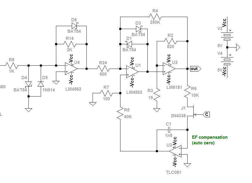

                            You posted this schematic as the one you're working on: https://www.geotech1.com/forums/atta...9&d=1552570244
                            but the mod for the MPP is this one: http://www.geotech1.com/forums/attac...7&d=1549539823
                            U2b should be non-inverting for the MPP.

                              I did actually catch that on my pwb Th e schematic I built to is in post 23.
                              I copied the wrong post, I was trying to show what nodes I was testing. So I think my Pwb is good.
