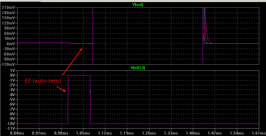

    The square wave at the new test point #3 is wrong. Im not sure whats causing it yet but It carries through the whole integrator and is a constant tone in the speaker.
    The preamp offset has to be cancelled (Q3/C6/signal "D"). It looks like it's in saturation.
    You said you didn't connect C6 in your board. It's necessary. 9mV x 1000 = 9volts!

        My efe sample width is controled by the target sample width I would have to put in another pot to adjust it seperatly.
        If your EF pulse is short then you have to reduce C6 accordingly. 10n should be a ballpark figure.
        At 5000 pps I dont have the room for any bigger EFEb sample before the next TX cycle plus I intend to fit two more signals in there for GB.
        5000 pps seems a bit excessive to me. Indeed there's almost no time to cancel the EF before the signal decays.

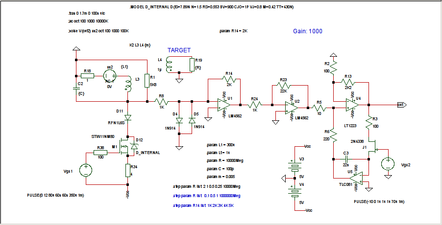

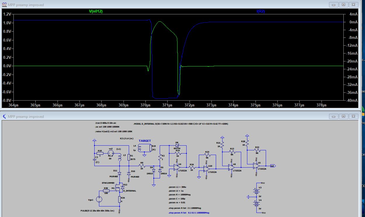

                  diodes question
                  I am a LTspice newbie playing with this circuit. I put a one ohm resistor inbetween the two diodes and the negative input of the first op amp and seem to see ~39mA.
                  Is this correct?
                  Also the circuit is intentionally running past the supply rails with the signal after that. I would think that it wouldn't be preferrable to do this as some op amps will go into phase reversal and other bad things.

                  • #69
                    Is this correct?
                    [ATTACH]45971[/ATTACH]
                    Remove D8, it's not needed for the high slew rate op-amps recomended.
                    The signal never goes past the supply rails, as far as I know.
                    • #70
                      Is this correct?
                      You don't need the 1 ohm resistor in order to measure current.
                      Use a 0V voltage source instead, which is actually a short-circuit, and will have no effect on the circuit.
                      • #71
                        Raise your battery voltages to 10V and you will see.
                        • #72
                          I did. Max signal voltage is 8.1V, minimum is -8.1V.
                          Here's my latest version of the amplifier. Install the file LM4562.sub in directory lib/sub and the symbol LM4562.asy in directory lib/sym/Opamps.
                          LT1223 is a current feedback amplifier with a very high slew rate necessary to maintain the integrity of the signal at high levels of amplification.
                          Other current feedback amplifiers may be used: LM6171, LM6181, LM7171, AD811, AD8014, etc.
                          • #73
                            So that means you are hitting the supply rails on U5 and U6. U10 doesn't clip with +/-10V supplies.
                            Is it your intentional way of clipping the upper and lower signal portions?
                            Are these op amps designed/chosen to perform well doing this?
                            • #74
                              Clipping is a different thing than having the signal going past the supply rails. What's being clipped is the signal portion dominated by the Tx coil decay, where the target signal is indistinguishable.
                              The opamps have been selected for their high bandwidth and slew rate to swiftly recover from saturation.
                              LM4562 is a 55MHz very low noise, low distortion amplifier with 20V/us slew rate. Its U1 half quickly establishes a virtual ground at the input to allow for early sampling while keeping the input noise at a low level.
                              LT1223 is a 100MHz, 1000V/us slew rate current feedback amplifier. Though noisy, its input noise is divided by 43 by the previous stages.
                              • #75
                                Ok, understood.
                                Back to the original question, how about the current indicated through the one ohm resistor?
                                What is happening there?
