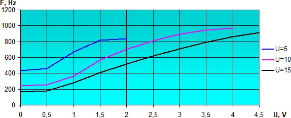

    I will run your simulation and give it a try as you have explained, I always see such graphs (Freq. vs Voltage plots) with respect to VCO circuits. Nice to know how to actually execute such a task in LTspice.

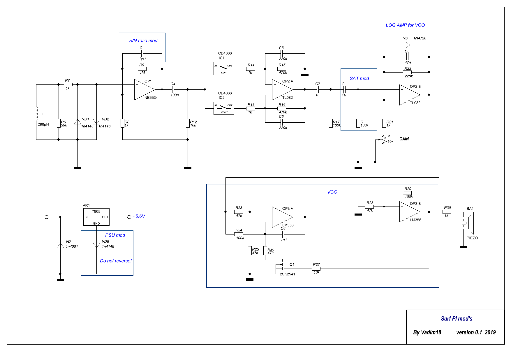

        What would be the preferred way to connect an audio chopper to a PI output, a JFET or an ordinary bipolar transistor?
        I'm going to try the VCO circuit in the above posts.
        I plan to take the input from after the sampling integrator and connect the output via a JFET transistor after the second integrator. I will condemn the 555 VCO section and just add an audio amplifier stage to drive a speaker or headphones.
        I'm not sure about the voltages though.
        Any help or advice please.

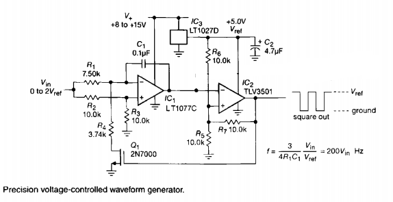

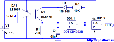

          Would a simple 4046 work for you
            I found this modified vco, works inversely
            The output frequency of the VCO, U1, varies inversely with the input voltage. With a 1 "V input, the oscillator output frequency is about 1500 Hz; with...

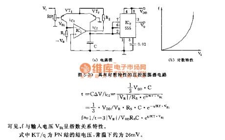

              I came across this VCO circuit with an ltpsice simulation to play with.
                This one looks interesting, I think I've seen this circuit adapted for a surf PI project. Would be interesting to see what the frequency vs voltage plot looks like.
                  " A 555 VCO circuit with logarithmic characteristics"
