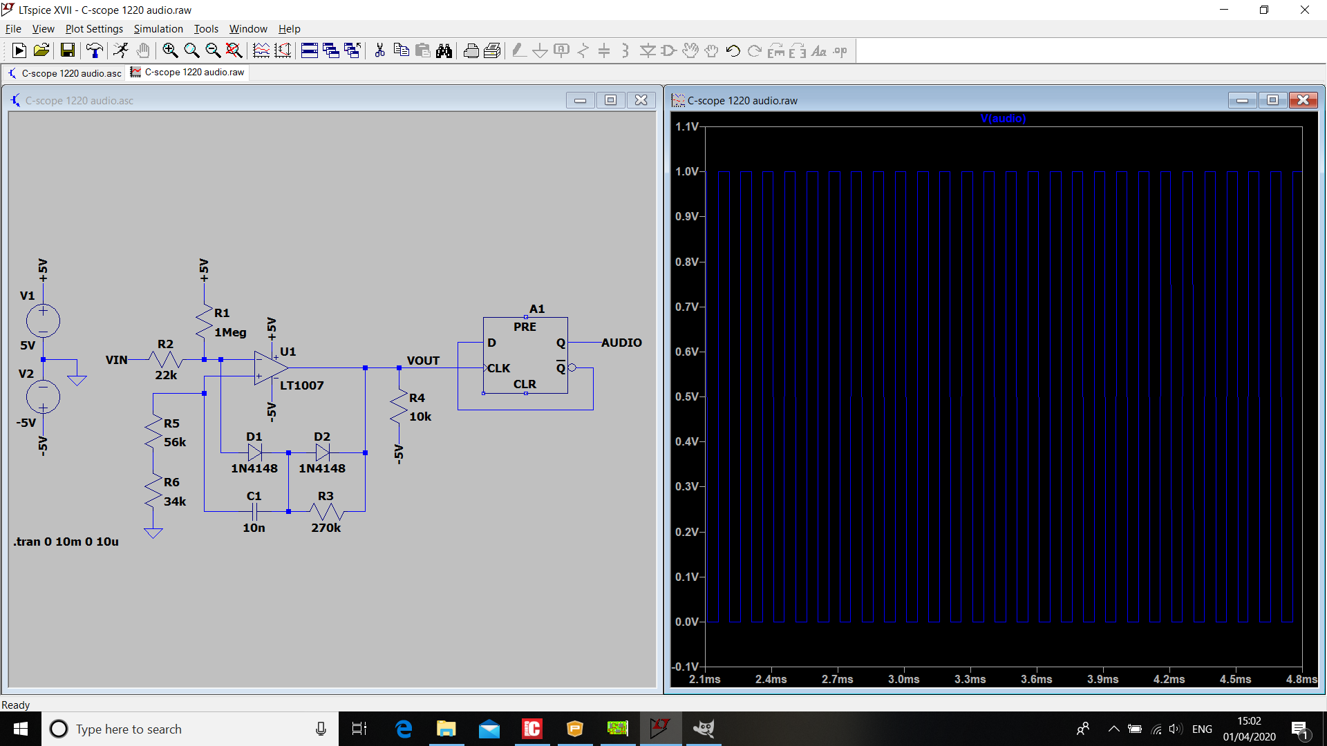

        I stumbled across a fantastic audio circuit used in the cscope 990b/1220b metal detectors. It uses one dual opamp and a dflop (4013), now only if I can figure out how to adapt it to a pi machine. I'll have to do some analysis on just what's going on with that circuit.

            I tried to model the cscope circuit with ltspice. I just couldn't get it to oscillate, no matter what I tried.
            I began to suspect that the original schematic contained some superficial error. But it is correct. (I traced it from photos of the PCB). The problem is likely that I wasn't modelling it correctly.
            I never pursued it any further.
            The real question is whether or not the circuit is a true VCO, ie, does it run off of a control voltage. Or does it run off of a pulse train of varying amplitude.
            The latter would be inappropriate for cut and paste adaptation to a pI.
            The circuit is interesting though, and I'm sure that re-engineering the concept as a basis of a VCO for a pI detector using the 4013 chip is a rational goal.

              I tried simulating the circuit in LTspice, and it worked first time.
              Simulation attached.

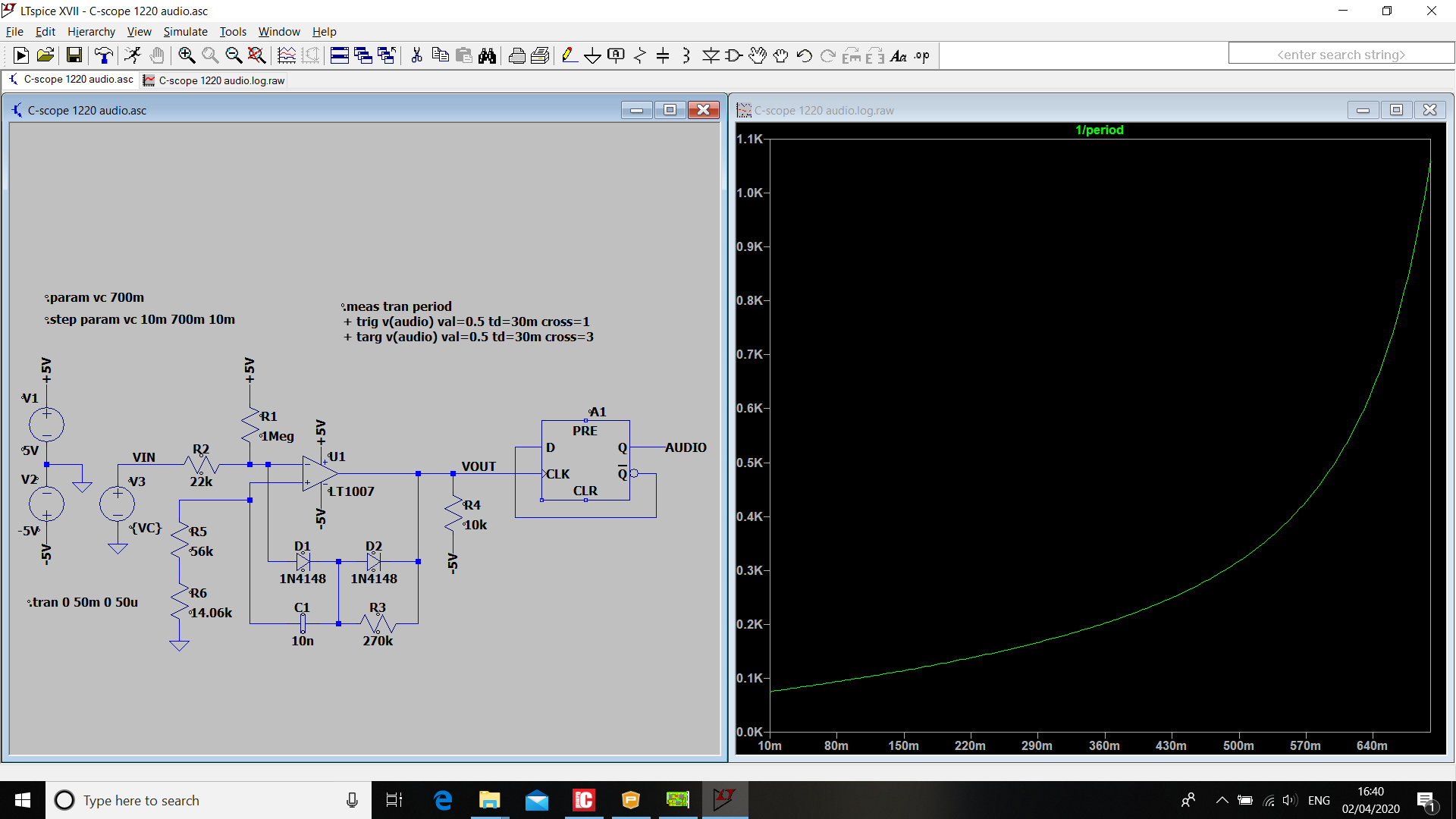

                    I ran your simulation. It works very well.
                    I noted that the control voltage (VIN) must be positive only.
                    I'm not sure what voltage is present at the minipulse output. Maybe with a little tinkering this circuit might be adapted to work as a nice little VCO ad-on. If any diy pulse detector can be made to sound like the Cscope 1220B, that's got to be a good thing.
                    How would I go about plotting the voltage to frequency response of this circuit in LTspice, does anyone know? What parameters for VIN should I use? Should I define the voltage source using PWL?
                    I guess I'd be aiming for a triangle shape waveform for the control voltage with linear rise and fall.

                      Add another Voltage Source and connect to VIN & ground.Mouse over and right click and then ADVANCED to set parameters.
                      Select PULSE. Set to RISE TIME to the period and Fall time very short to produce a Ramping Voltage (saw tooth).
                      A Triangle is done the same way except rise and fall times are the same and half the period.

                        Thanks waltr, I'm going to have a play with the Pulse parameters in the ADVANCED Vsource settings. Should be very easy to set up.
                        Will post a screenshot of the results. I may tinker with the values of the circuit to see if I can get a fairly linear response, or at least to get a feel for what the limits of the circuit are.
                          I suspect what you're really trying to do is to generate a plot of frequency versus control voltage.
                          To do that you need to use the .measure facility in LTspice. Please see attachments.
                          According to the information I have on the CS-1220, you need to adjust the trimmer R71 (47k) in the schematic [R6 in the simulation] so that the audio frequency is 1060Hz when there's 700mV at the control voltage input. By a matter of trial and error, I found that setting R6 to 14k06 gives an audio frequency of 1060.91Hz, which is close enough.
                          This trimmer is obviously setting the maximum audio frequency. Then I set up a parametric sweep of the control voltage from 10mV to 700mV in steps of 10mV.
                          The .measure command determines the time at which the audio output voltage first crosses 500mV after a delay of 30ms, and also where it crosses 500mV the third time. The difference will be the period of the audio signal.
                          To plot the period versus vc, run the simulation (70 runs), and enter <CTRL> L. This displays the log file with the measured results. Click the right-hand mouse button in the log window and select "Plot .step'ed .meas data". This will display a plot of the period versus control voltage. To display the frequency versus vc, right click on the waveform name (period) and change the expression to 1/period.
                          I did try to add a second .measure command: ".meas tran freq param 1/period" to automatically do this last calculation, which displays correctly in the log file, but results in a blank plot window. Don't know what's going on there.

                            OK - I've figured it out.
                            You need to right click in the [blank] plot window and select View>Visible Traces. Then it lists both period and freq.
                            All you need to do is add ".meas tran freq param 1/period" into the simulation.
                            Simple when you know how.
