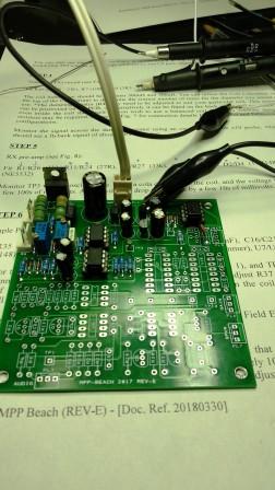

    Hello everybody,as mentioned above I started my Mpp Beach Rev E.
    Im stuck to step 4 because I don't have a coil yet
    Posting some measurements..
    Looking good so far.

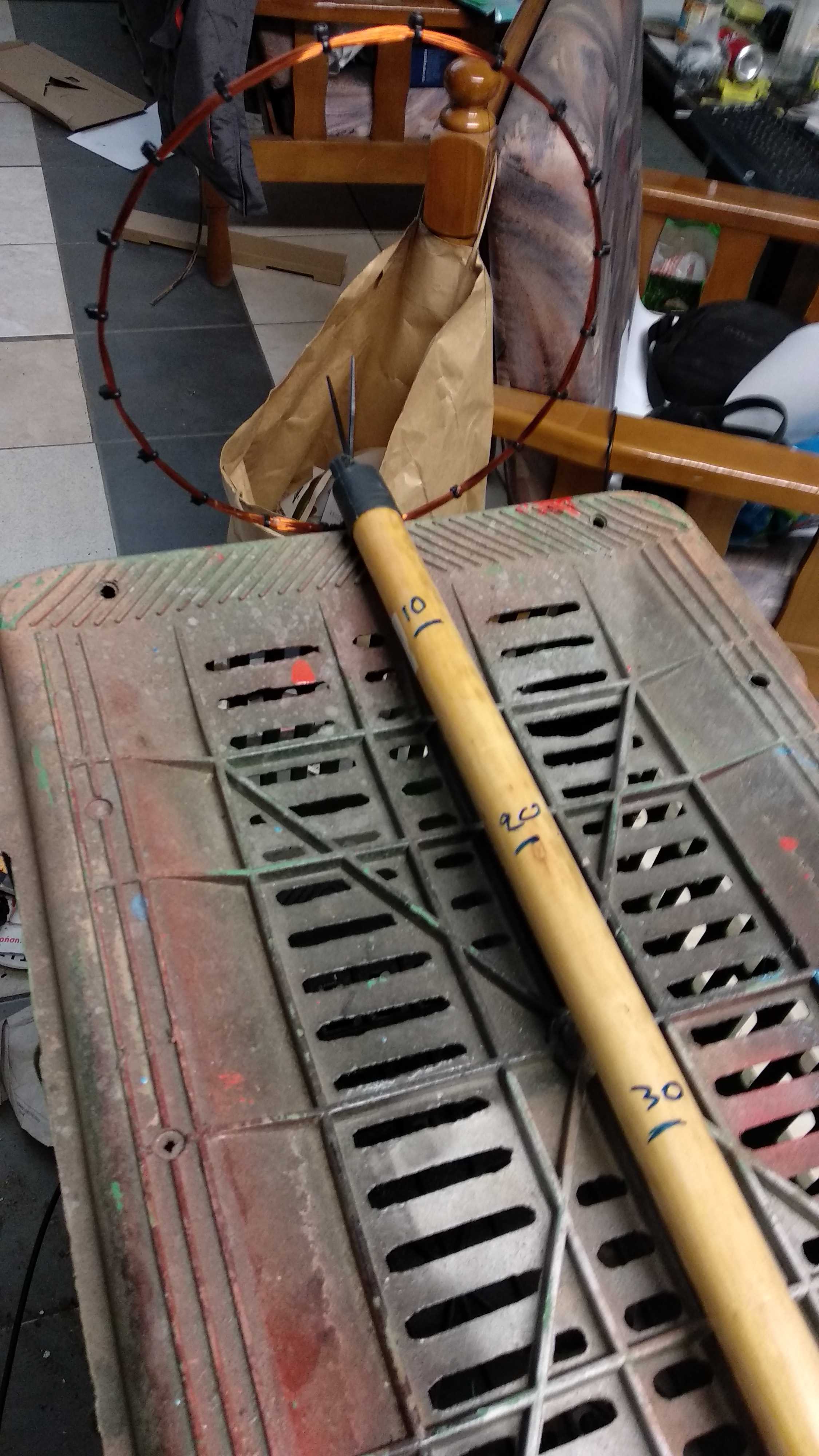

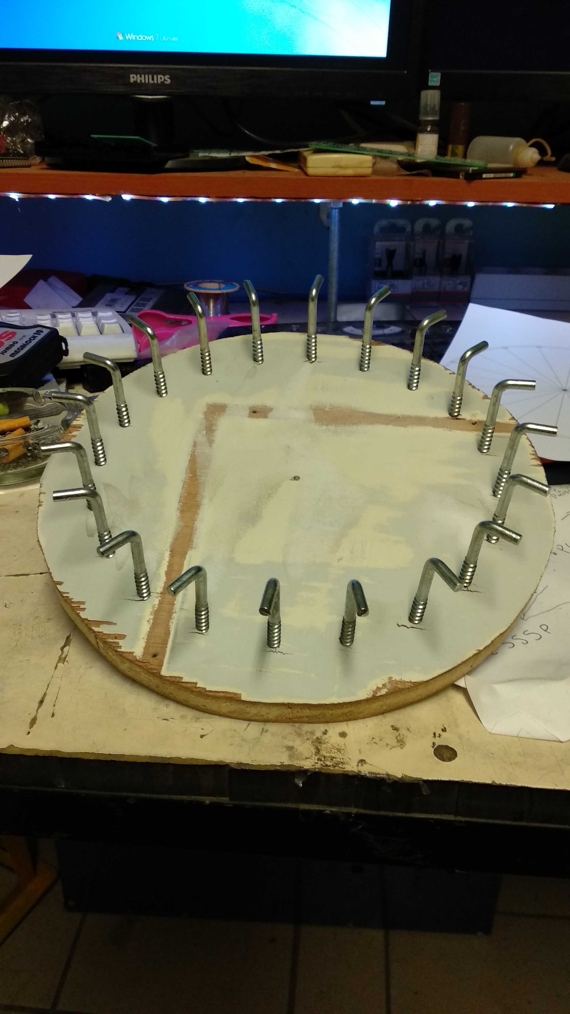

      Made an 8" pattern to wound the coil
Name:	Coil Pattern 8 Inch.jpg
      Made the coil from 0.50mm double enameled wire...Final specs 382 uH 2.5 Ohms unshielded.. Im using 390Ohm damping resistor.

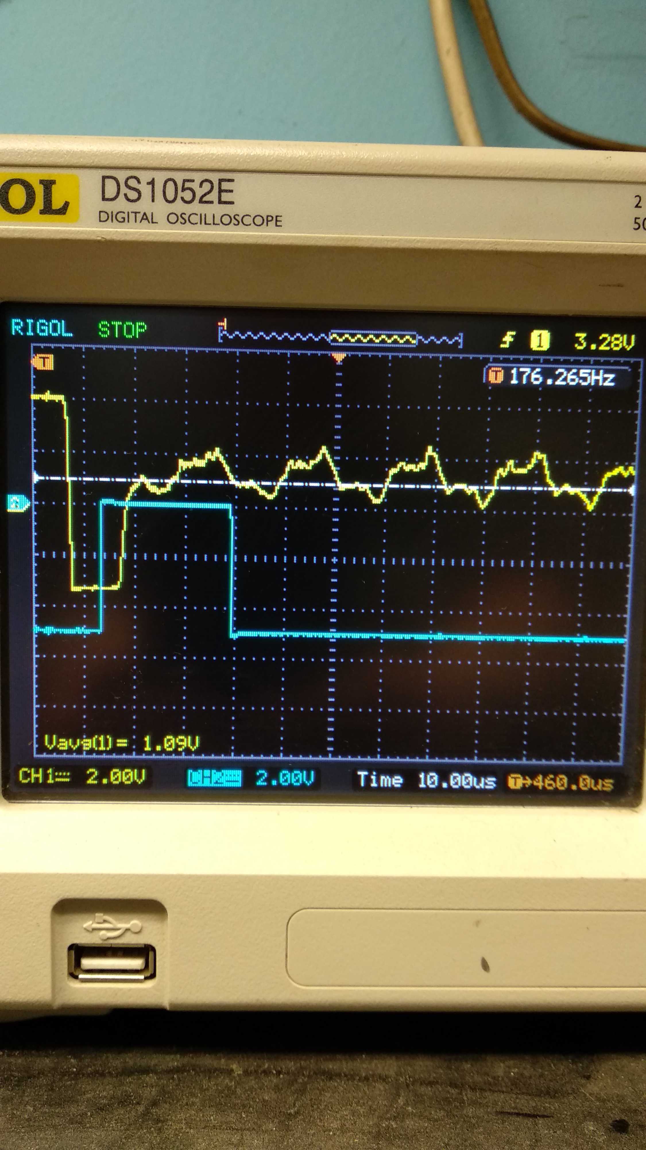

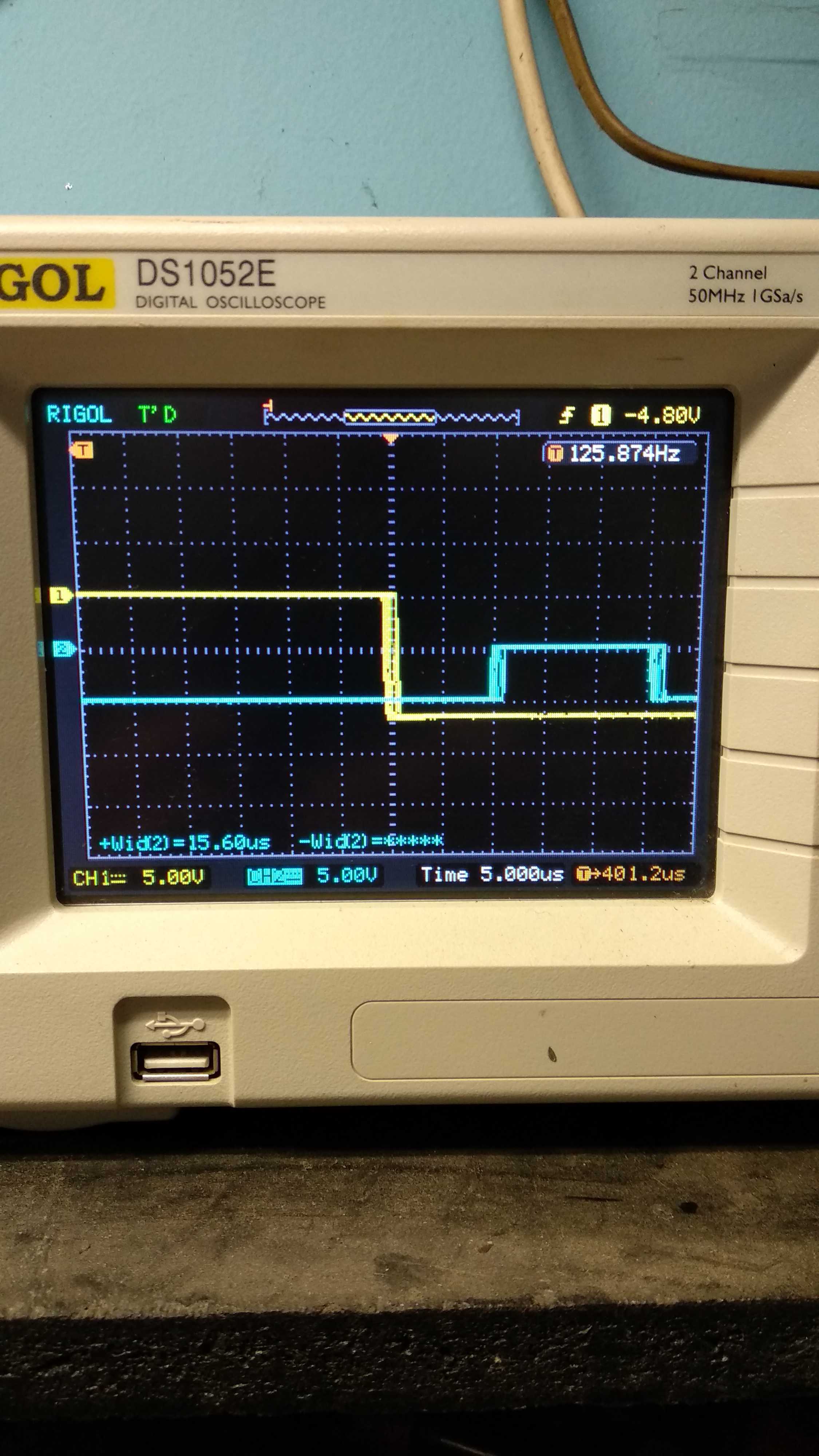

      Step 6
      adjusted the minimum sample delay of 10us.
Name:	Step 6 - Minimus Sample Delay 10usec.jpg

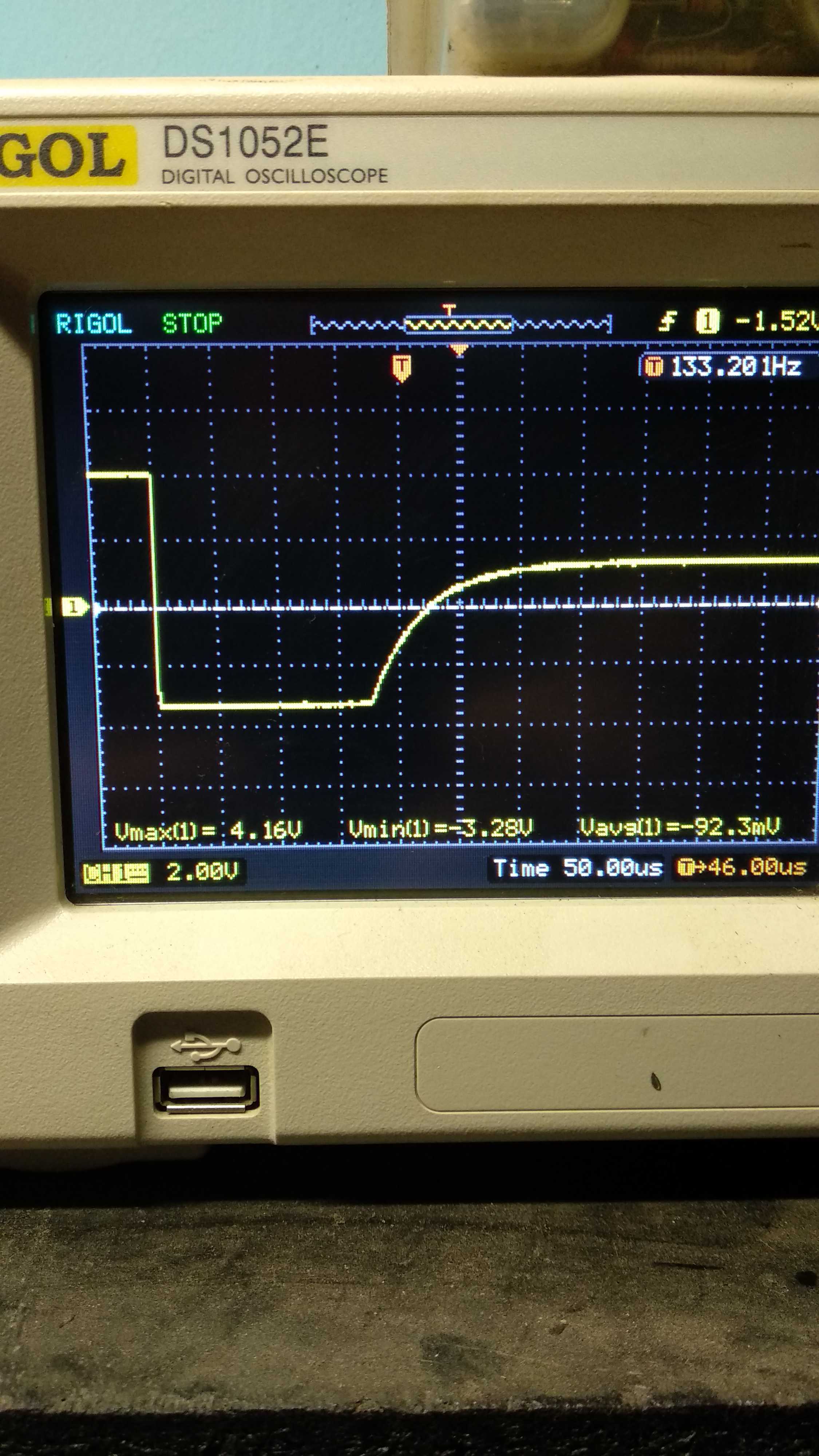

      Probe to TP8 the EFE delay pulse width i measure 114us not 100us as the documents says,is that right?
      Probe to TP9 after PL6 shorted (i turned the pot to one end) the pulses are 15,6us not 10us...With gain pot i adjust from 15,6us to 30us....
      Am i doing anything wrong??

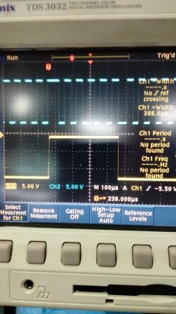

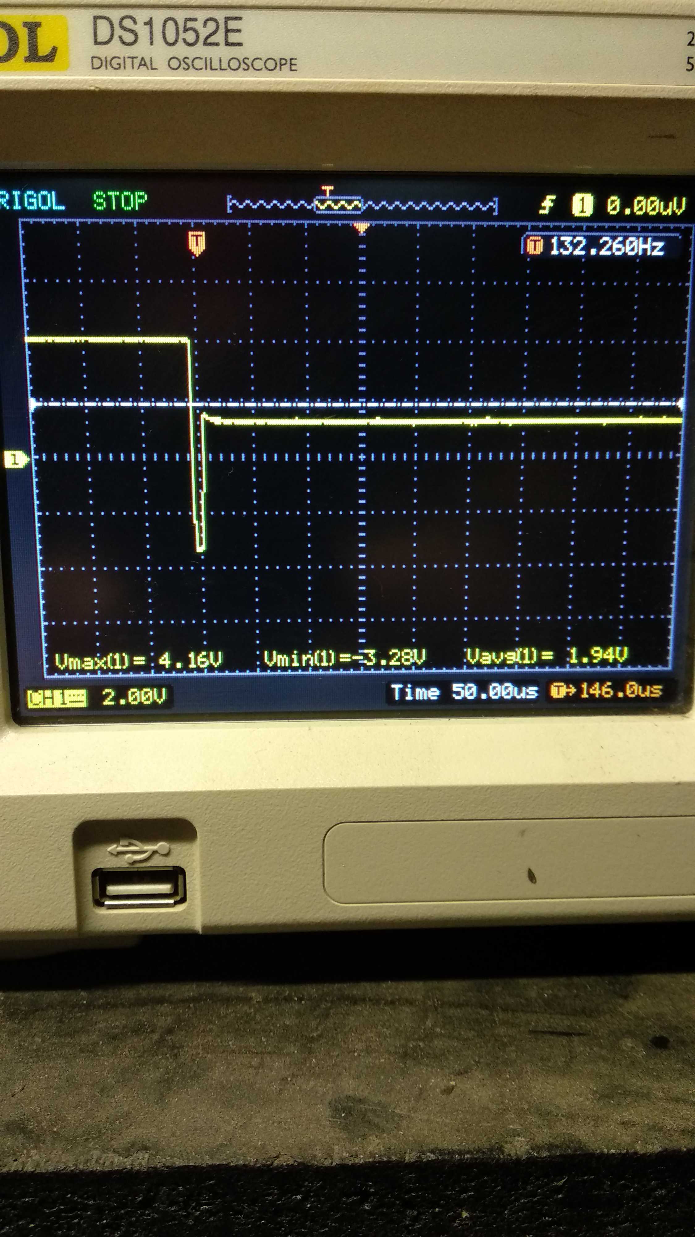

        Probe 1 TP3 and probe 2 at TP9
        There is a lot of noise or ringing,is that because my coil isnt damped as it should?
          Try turning off any florescent lights anywhere near or other electrical equipment maybe.

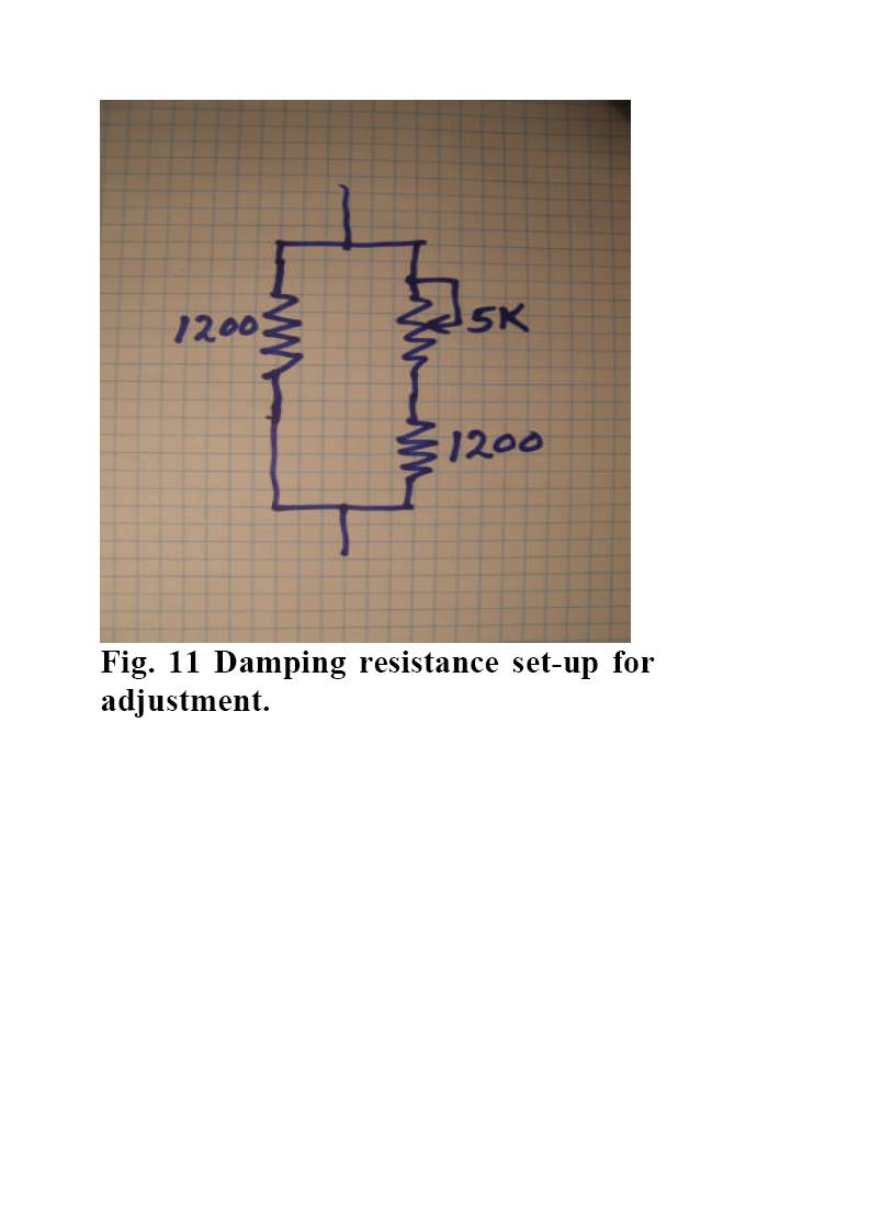

            What is the correct way to damp the coil.I saw a schematic with 1,2Kohms in parallel with 1,2K and 4,7k in series,this should make it flat?
            It detects a can of soda at 40cm,the weird is that it can't detect anything gold..
              Yeap,the coil is not properly damped because i dont know how it looks the output waveform on TP3.I'm gonna try put instead of the R4 the damping resistance setup i found on "Making a Fast Pulse Induction Mono Coil" by Joseph J. Rogowski.

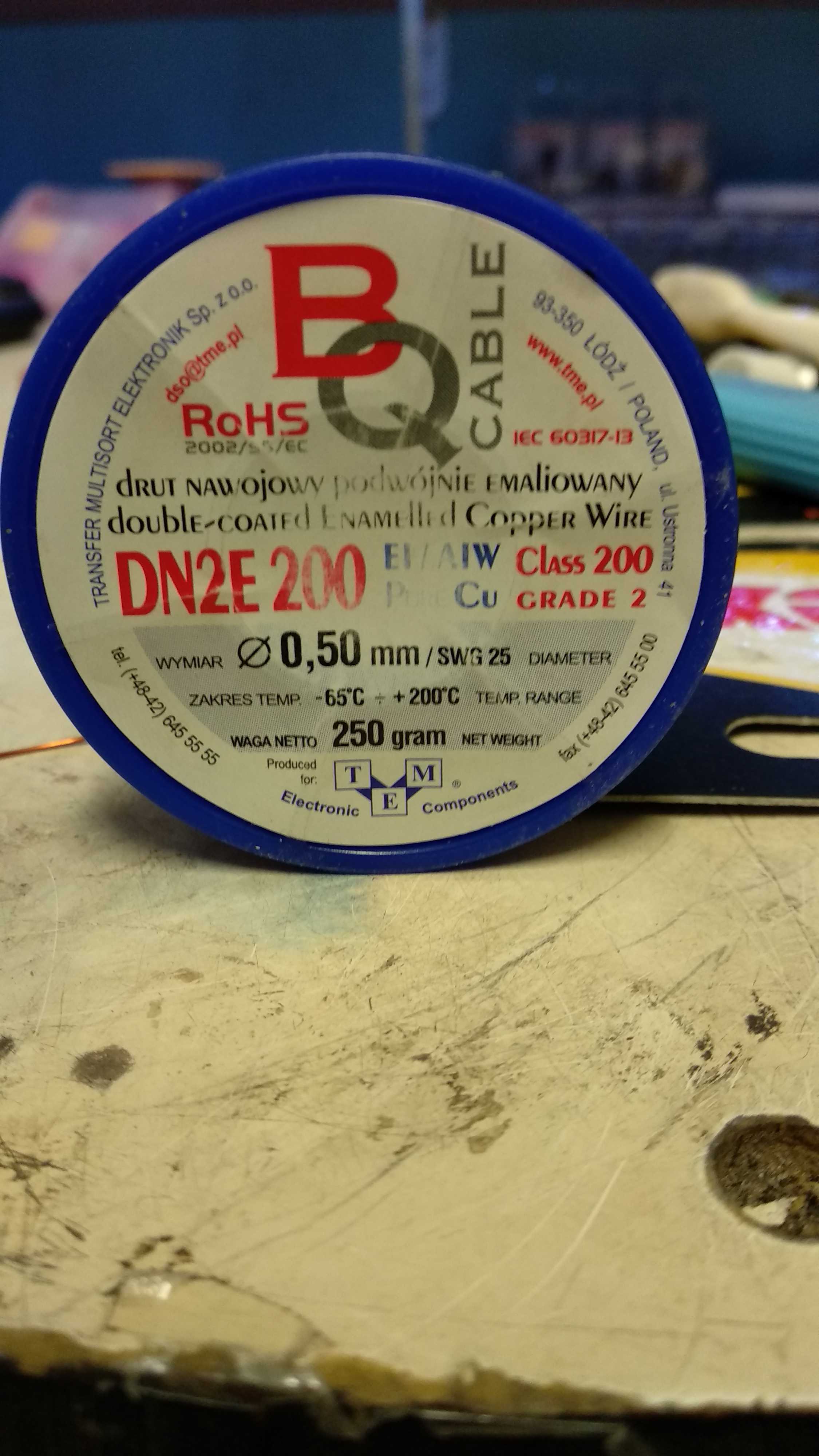

              Also the specs of my coil wire are:

                Try rotating your coil to see if the noise on the pre-amp output signal changes. The noise is usually lower when the coil is in a horizontal (rather than vertical) position.
                You need to adjust the damping resistor to critically damp the signal. The noise you can see on the scope is not the "ringing" you are trying to eliminate. After the pre-amp comes out of saturation, the signal will exponentially decay towards the 0V line. If the damping resistor is too small, this signal will overshoot the 0V line before settling down. This is what's called ringing.
                To reduce the noise pickup, you also need to shield your coil.
                  Ok
                  What do we mean by "damp"????Not so good with this term
                  In my case i do not see this happens,am i right?

                    If you remove the damping resistor and look at the pre-amp output, you will see lots of oscillations that will gradually die away. The damping resistor "damps" these oscillations so that the pre-amp output transitions smoothly from saturation to 0V. The key thing here is to achieve "critical damping". If the signal is slightly under-damped, it will overshoot the 0V line before settling back down. If the signal is over-damped, the exponential curve will move to the right. What you are trying to do is remove the huge signal induced by the flyback when the MOSFET opens in the most efficient way, leaving enough time to sample any target signals before they disappear.
                    Try fitting a higher value damping resistor, such as 2k. You should see it then.

                    I would suggest comparing the pulse widths at TP9 and TP10. They should be the same width, but occur at different times.
                    Do you have Q1 and Q3 inserted correctly?

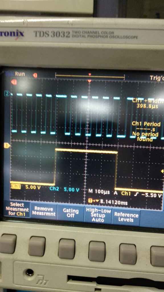

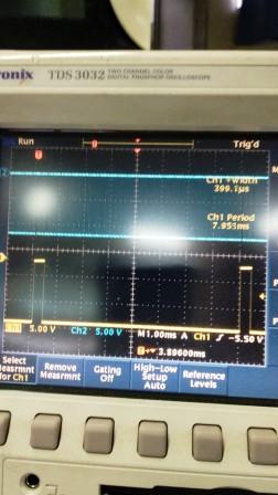

                      Think i found the root of my problems..
                      At first i dumped my coil near 990 Ohms

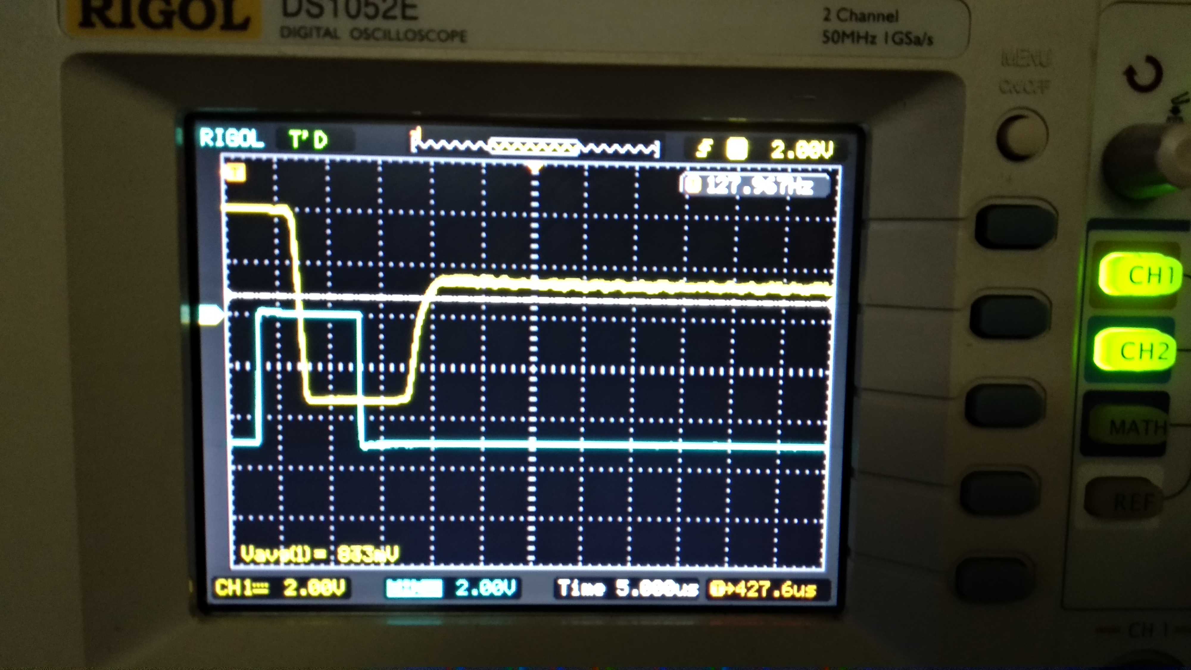

                      Now,at Step 6 says 1ch at TP2 and 2ch at TP6.According to Fig.10 there should be a delay (Main Sample Delay) of 10us.As you see from the photo below the two curves have no delay between them...Thats probably why i dont sample gold right?
Name:	Step 6 Minimum Sample Delay.jpg

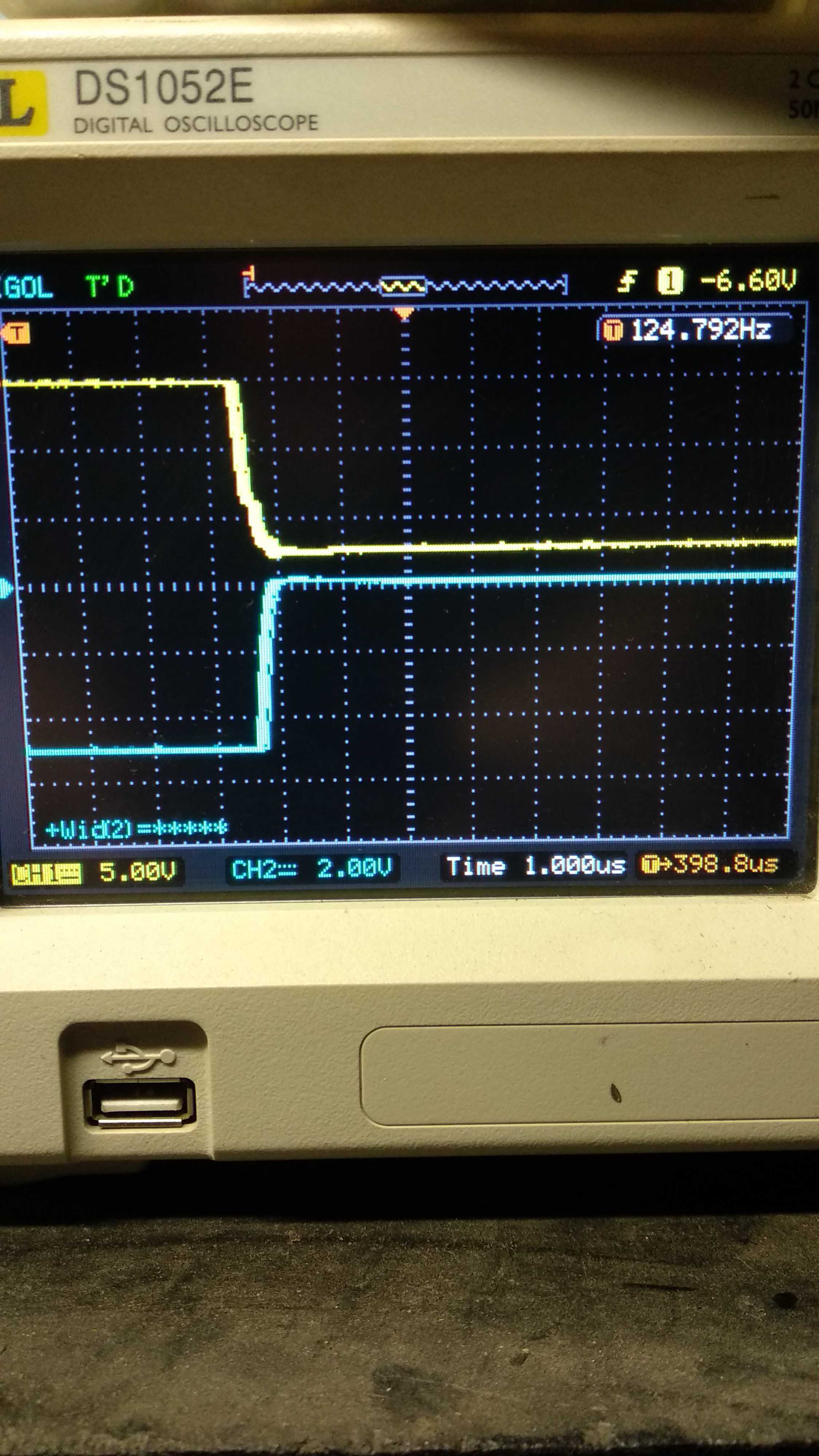

                        Also found at Step 5
Name:	Step 5 Without Soda can Near Coil.jpg
Name:	Step 5 With  Soda can Near Coil.jpg
                          Your coil Is under damped a bit. One reasone you are not seeing gold beacuse you are using a small chain. Even a good VLF has a hard time with this target. A metal detector only sees one link in the chain and the one closest to the coil. Your coil is 20 guage wire thats a bit thick in my opinion
