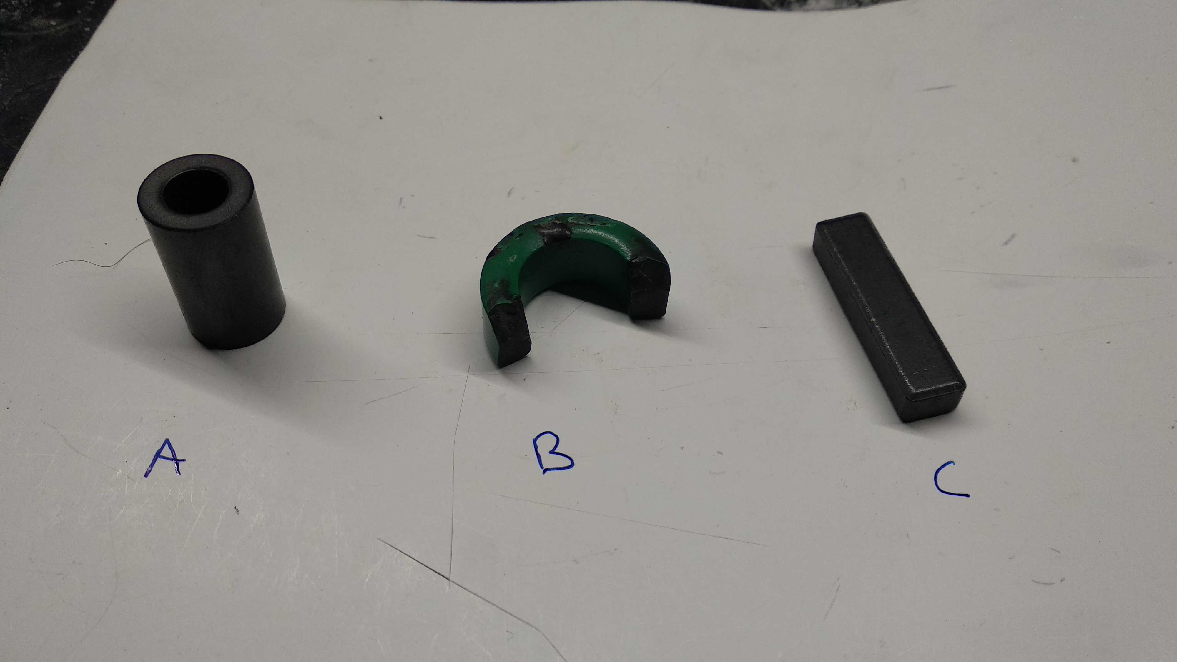

          For sure there are lots of iron filings from grinding and lots of little pieces of metal..In the air tests i made i can detect a 0.1 gr lead weight i use in match fishing at about 5-6cm..It is supposed to be that sensitive?Sorry George might be a false alarm by me but i've never used a detector that sensitive.I only used Garrett GTI2500 and a Minelab Explorer SE in my hole life,but as they are VLFs i thought the response should be like them..In other air test in my workshop i detect a normal size soda can at about 70cm a gold coin at 28 cm(25 cm clear signal) my only worry here is not the MPP doesnt work but maybe i made something wrong with the coil.
          The EFE only occurs when you wave the coil quickly from side to side. Try waving the coil in the air away from the ground, and if there's a signal at the end of each swing, the EFE is not working properly.
          I've just tested the way you describe at about 20 cm off ground,no signal except only above targets..
          You can also check EFE in an air test by waving a white board magnet across the coil a few inches away. Don't get too close or the material of the magnet will be detected. Air testing whether the detector reacts to ground can be done with a ferrite pot core. With default timings, the ferrite will not be detected.
          Sadly i dont have a ferrite pot core on my workshop,i do have a ferrite out of a laptop PS, a broken ferrite out of an iverter welder PS and a soft magnet.The first two are not detected at all.The soft magnet when i bring it near the coil no sound at all but when i take it away there is a little audio sound..I attach a photo below

          • Originally posted by mushaba View Post
            In that case the EFE seems to be working perfectly.
            [ATTACH]46266[/ATTACH]
            Again, from your description, there doesn't appear to be any problem with ground response.
            I don't think you have a problem with shielding in your ground conditions. If you were searching in wet grass without an electrostatic shield, then you might have some issues.

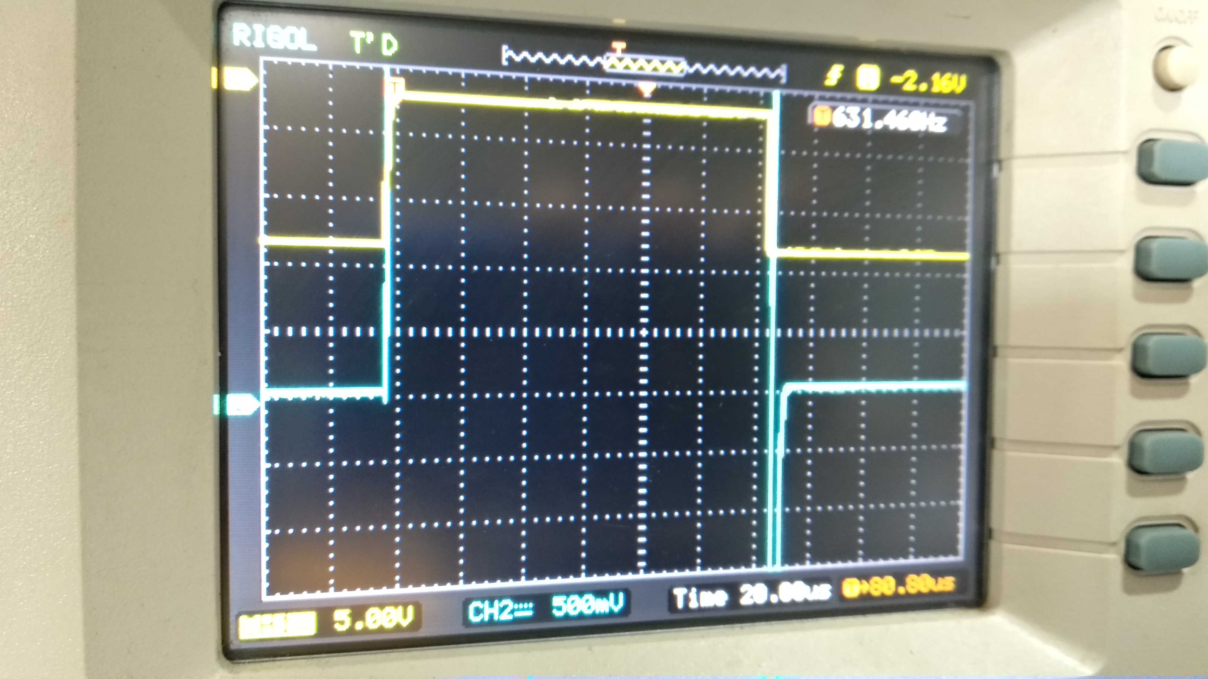

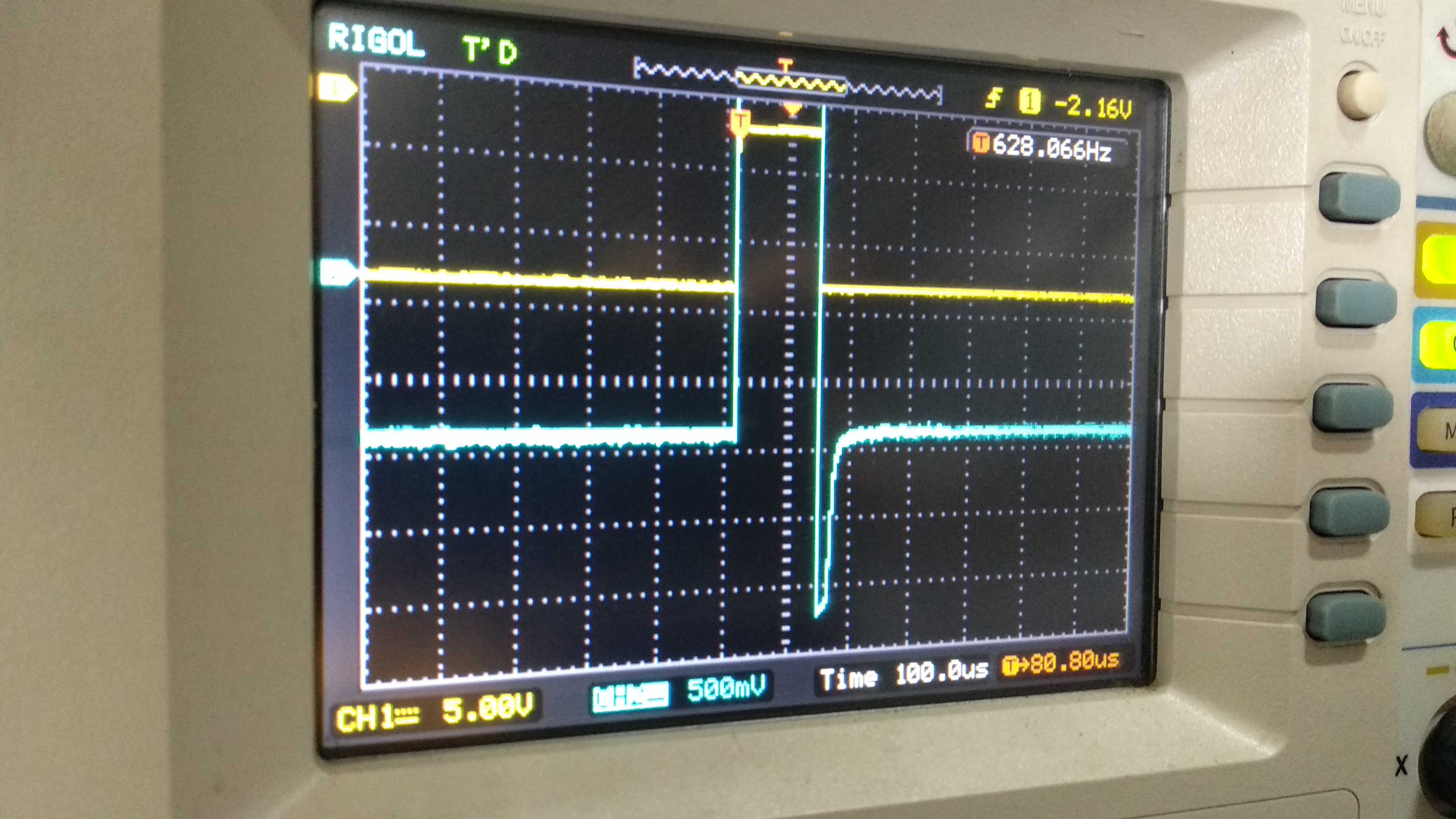

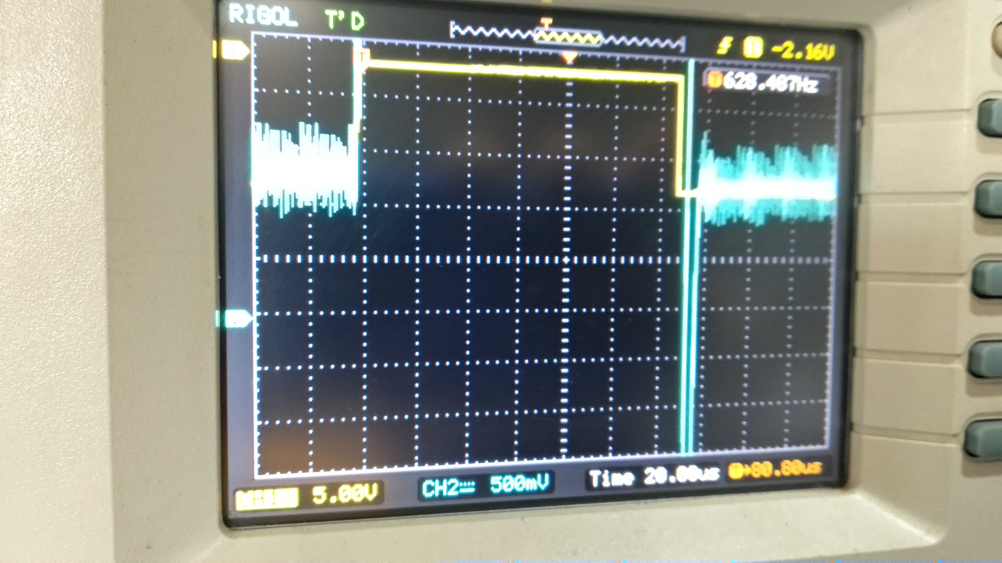

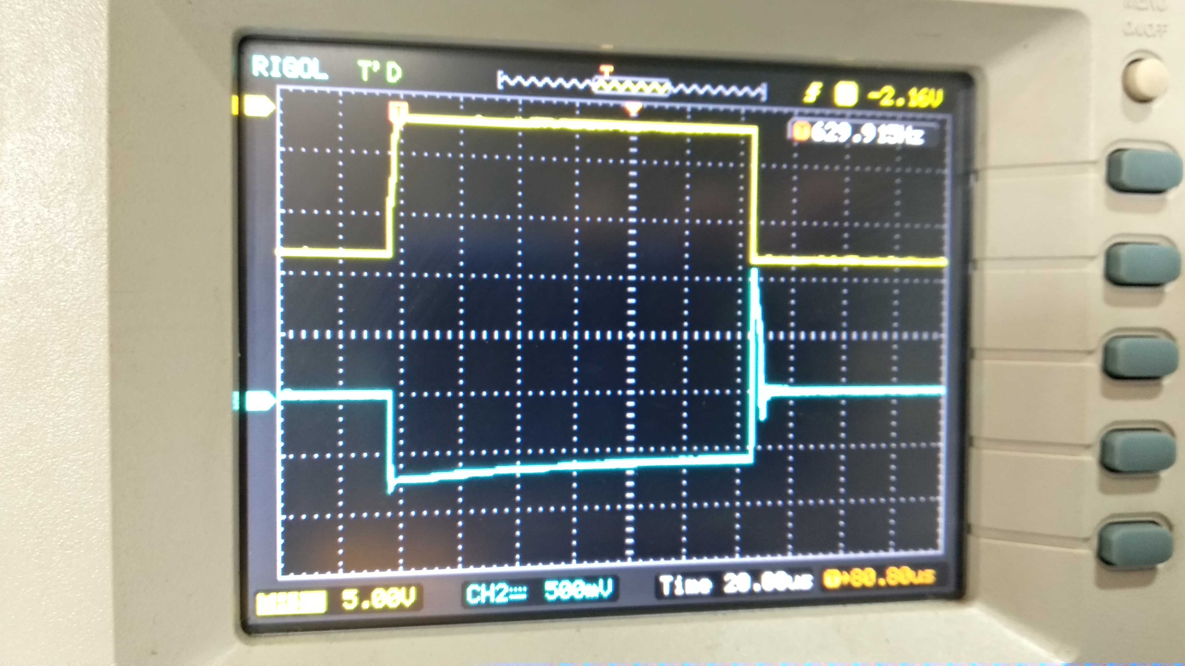

              Ive just came back from a field near my house,an agricaltural field sand soiled,there i realise how iron-trashy my backyard is..The detector was as suposed to be,i found some pieces of fence wire and other stuff.Came back to workshop placed detector on the air test position,calibrated the timmings frequency at 1KHZ and the first sample not before 10us and took scope readings from the Rx Preamp..First stage all looking good (to my eyes) pin2 as attached photo,pin3 at zero,pin 1 as photo (same with pin5) but at the output pin7 i think there is lot of noise,should be like that???No electrical interference near the detector

              • That looks like external noise pickup. Try changing the orientation of the coil (horizontal and vertical) and see if anything changes.
                  No change George..I dont have a spare NE5532 to see if there is a problem with the ic..If is an external noise pickup shouldnt show on input pin?

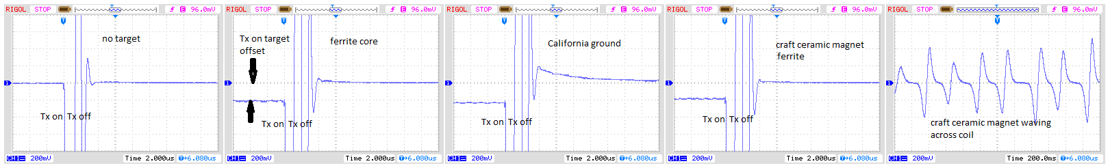

                        I think it was 6666 suggested using a fridge magnet. I tried one awhile back and thought it worked good, not detectable and would cause a signal when pulled away from coil. Tried one this morning, not detectable but didn't cause a signal when pulled away from coil. Tried a craft ceramic(ferrite)magnet. Thinking ferrite core and ceramic magnet not detectable as a Tx off target, lot less signal than ground(maybe none except for a shift right when coil is decaying). Target distance was adjusted for 200mV change when Tx on. Last picture is sweeping the magnet across the coil a few times. Wondering what your white board magnet is made of. Would your ferrite pot core look closer to a ground signal decay than the one I used? They would look similar to ground with a VLF.
                        • Hello green.At left of the photo the waveform is preamp out?Is it from a MPP?
                                No, preamp out from my target response tester. Don't have a MPP.
